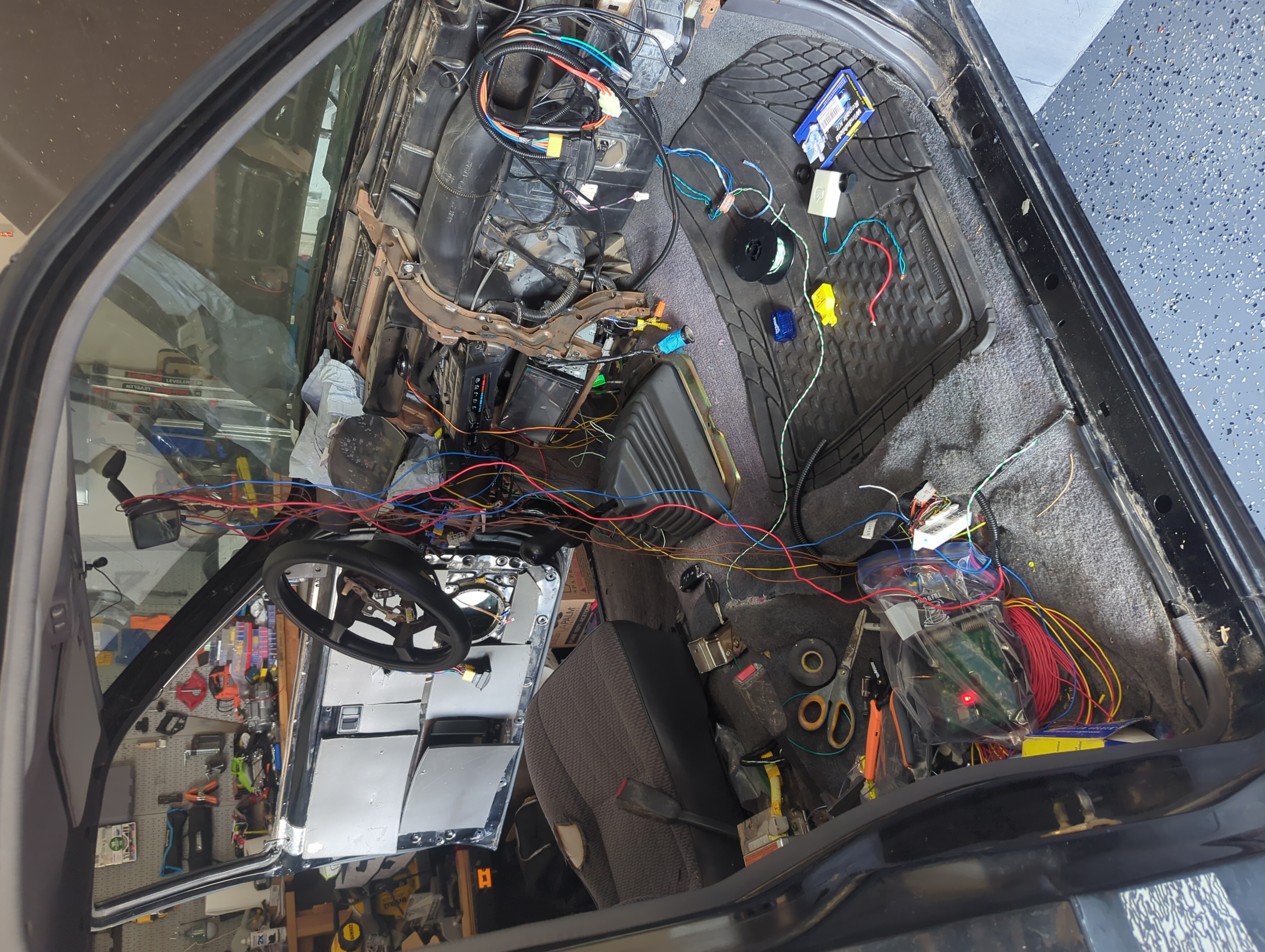

I finally got the Nissan to charge with the Leaf PDM with the help of J0hannes. He kindly provided me with his fork of the ZOmbieverter code for testing. I took the Nissan for a 5 mile trip to the gas station for snacks, and the only issue I noticed is a drive shaft vibration.
The speedo works!!! I added first 5 EV miles to the odometer. 🥳
Before I loomed the wires in the cabin
After looming most of the wires
It's taking a charge!!! :D
Charging. I don't have the fan installed yet, so I'm being cautious.
