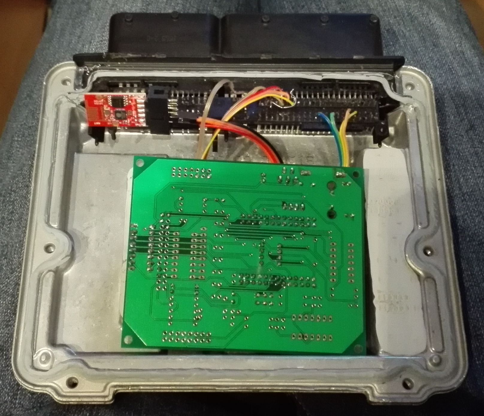

So I'm planning to put either a BeagleBone or a small embedded MCU into the original ECUs case. That way I have access to quite a few relevant signals and a nice waterproof case.
Hmm, to be honest maybe it's a bad idea to have throttle processed by a Linux machine?
EDIT: just thought about it further, I think I'll just use an Olimex STM32-H103. I have a good code base for it.

Well, here's an open ECU :D Seen that board before ?
So far I've hooked up throttle, vacuum sensor and CAN bus. It runs almost stock inverter firmware ;) I can play around with the rev counter and more importantly I can put throttle on CAN bus.
Now I have to find out why it throws a low oil pressure error as soon as revs exceed 1000rpm or so.
I'm thinking it's either a bit on the CAN bus or the oil pressure switch is looped through to the display unit. Anyone?

Yes the Dashboard receve the oil pressure information as on the old vw.
I think if there is no information you may have an alarm over 1000 rpm.
Been thanked: 1913 times
Yes, found it today :)
The alarm indeed starts only above some rpm. But there is also a reverse alarm: if you pull the signal to ground (=oil pressure ok) at 0 rpm you get a STOP! message also. So I either have to live with this or pull the signal to ground selectively with my custom "ECU"

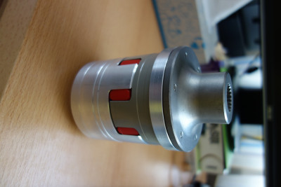

zippy500 wrote: Thu Apr 25, 2019 9:04 pm What are doing for a leaf coupler ?

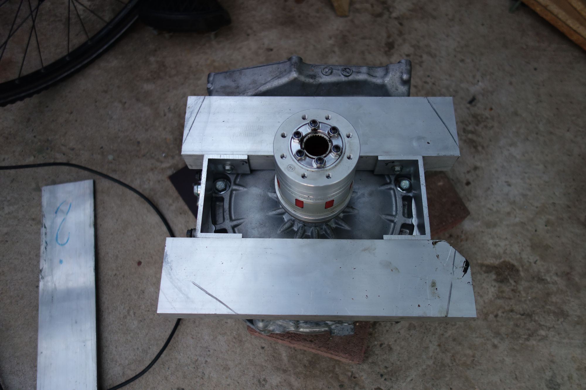

Finally I can answer that, bottom to top
  • Custom fitting that adapts the VW spline that I cut out out of the clutch to the KTR coupler
  • KTR Rotex 38 GS
  • Adapter ring that adapts the KTR coupler to the next piece
  • Nissan Leaf spline from New Electric

I too would like to get more details on the source of the Leaf spline part.
Also would it be possible to get another picture of every component separated? This is by far the cleanest example of a Leaf motor adapter I've seen (Excluding Damien's of course). Bravo.

that is a very nice coupler :D

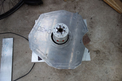

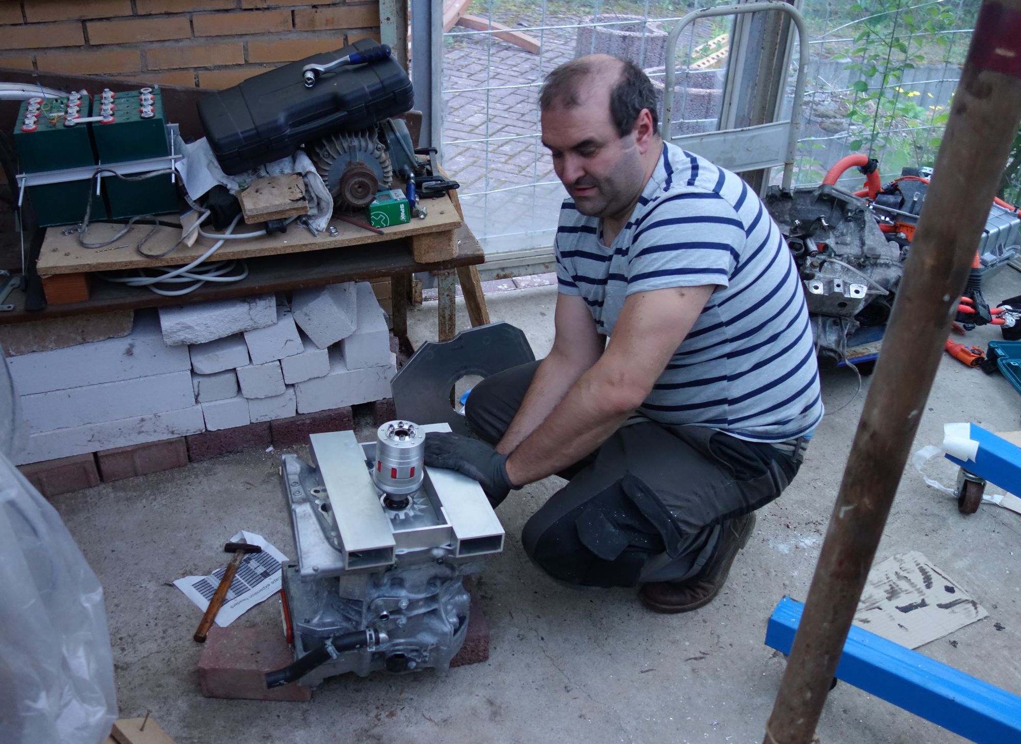

So this weekend was great. I had both Arber and his family and my father over to help me get back on track with the Touran conversion.
We test-mounted one battery brick (1/2 Leaf pack) under the car with no greater problems. The other half is residing in the boot right now. My dad could not stop working until we had this done at 23:00 :D
The adapter plates between motor and transmission are pretty much sorted. I use two 300x80x40x4 profiles to cover most of the distance. They are connected by U-profiles mainly for water proofing. Then comes the actual transmission plates which we made with the jigsaw :) It is only 15mm and we found out the hard way that it better be 25mm - the shaft coupler is about 5-8mm too long. So I went to a random steel working company today and found a 100x460x8 aluminum plate in the scrap. Will saw it in half and thereby add the extra distance.
Mechanically I just need to make a motor mount and the drive drain is in, yay :D
EDIT: maybe I should mention that Arber came from Slovenia which is 900km away - so: thank you very much :)

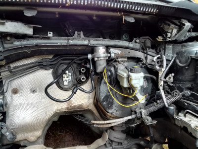

Vacuum pump is in :) Used the original rubber mounts

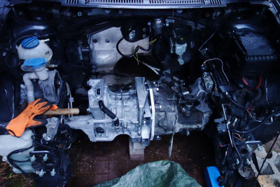

And transmission is in.
Now need to make a motor mount, connect up the drive shafts, make some temporary DC cables and off we go :D

You can cut that mount near the hole and make a hole higher up. As long as mount is flat under. Then buy one 6mm flat piece of steel cca 100mm x [whatever vertical] and get it bent under bottom. Fit one end in the mount and another down at the motor mount in such a way it will carry motor even if a bolt falls off.
Side mounts are only to stasbilize motor. Real bi*$#h it to fit the rear mount in. Does your rear mount come with transmission?
A
Well I believe I've sorta done just that, see below :) He who can't weld uses profiles and screws ;)
Yes the rear mount is attached to the transmission, easy peasy.

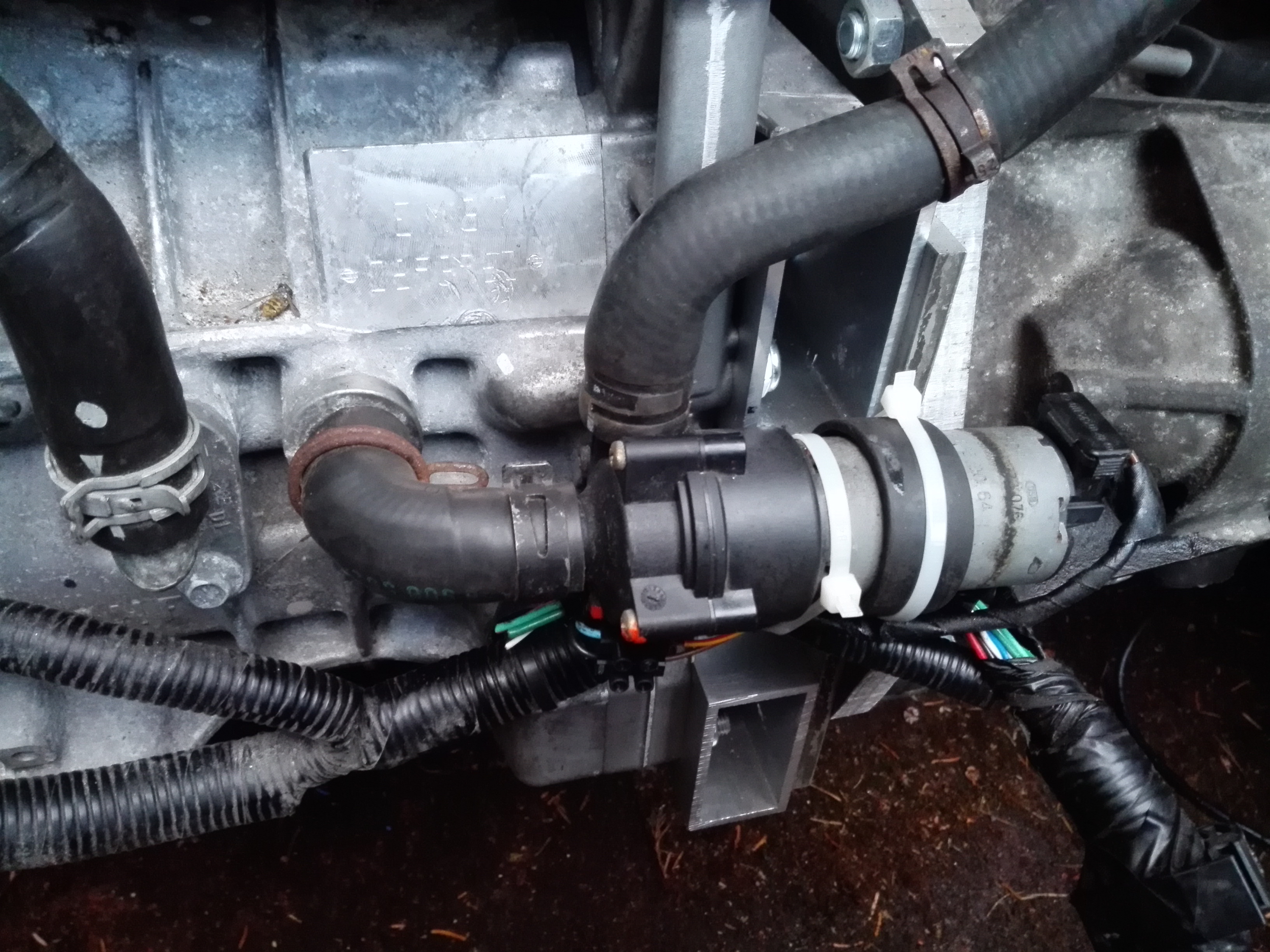

Also installed a coolant pump from Mercedes, it starts to run with the key switch. Haven't decided on what radiator to use yet.
