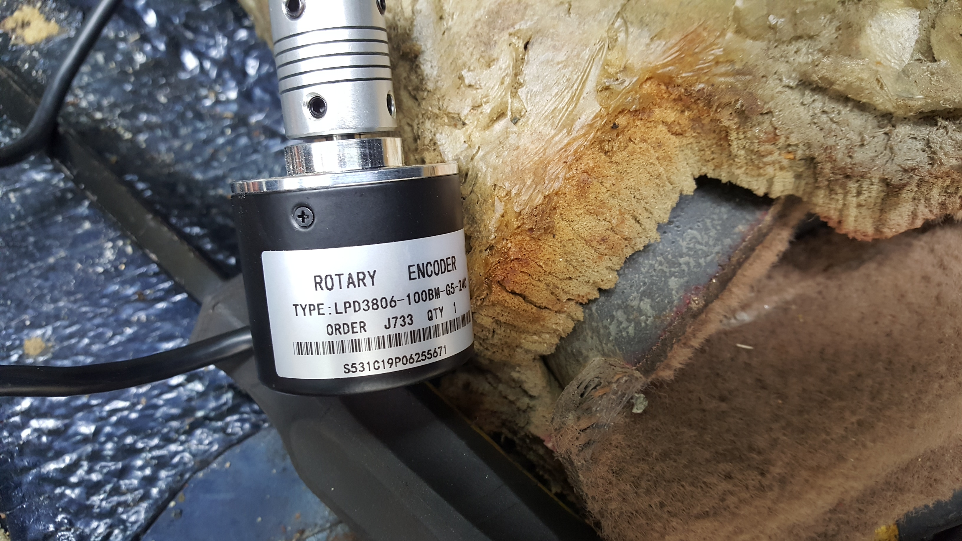

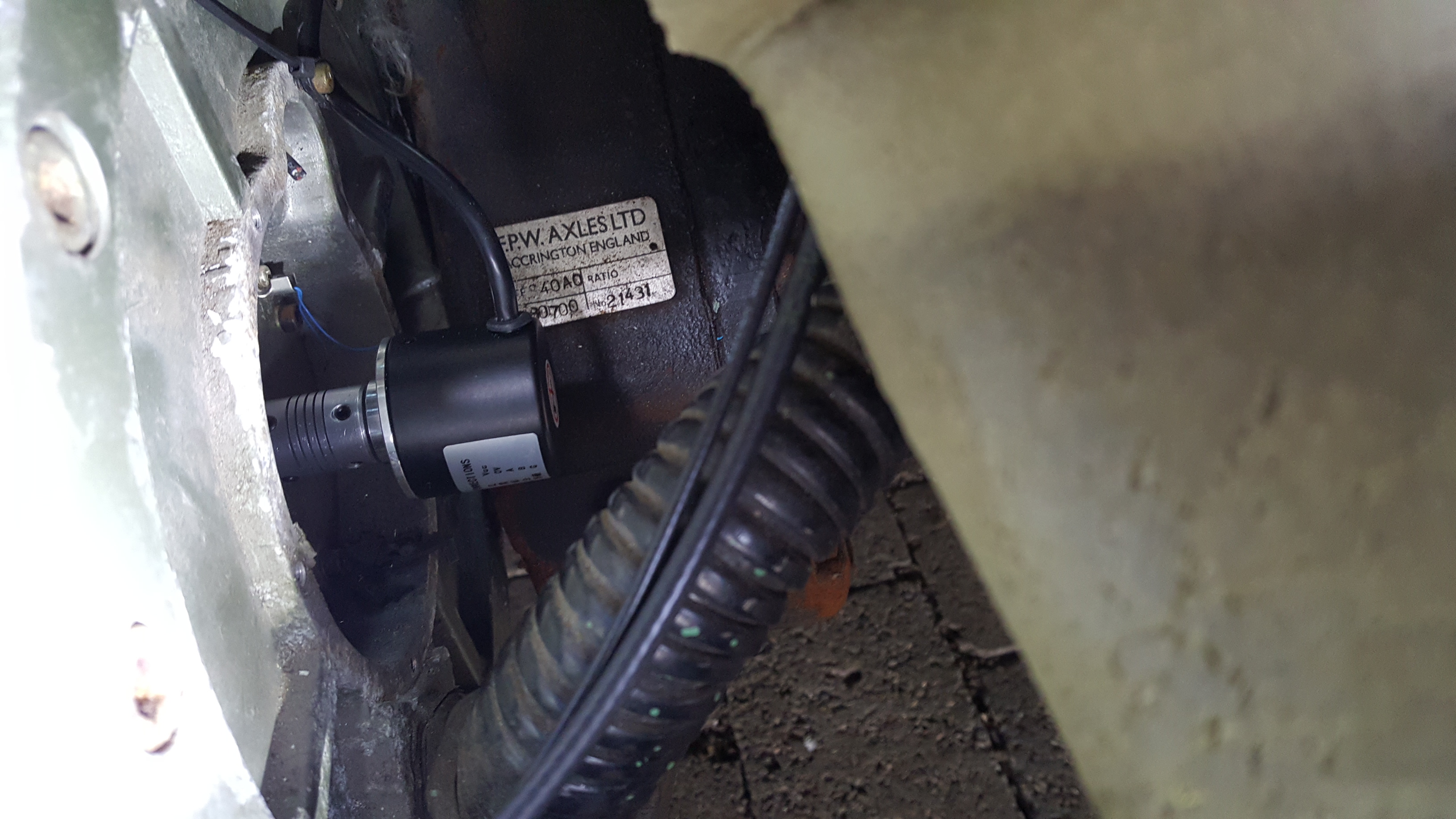

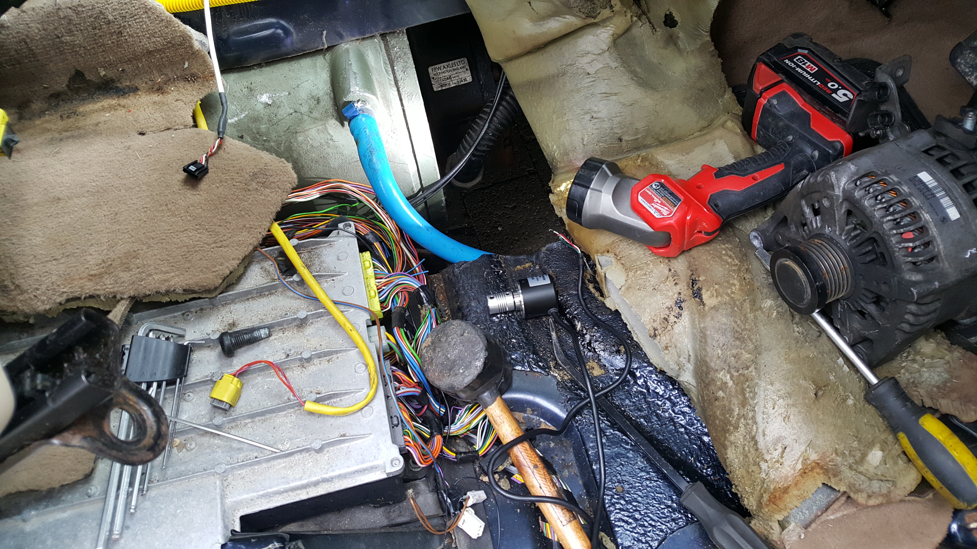

Ripped out the original encoder today on the rear drive motor on the range rover and replaces with this thing from ebay. Very big improvement. Not perfect, but much better. Never thought I'd be thanking the clown who cut out the floor...

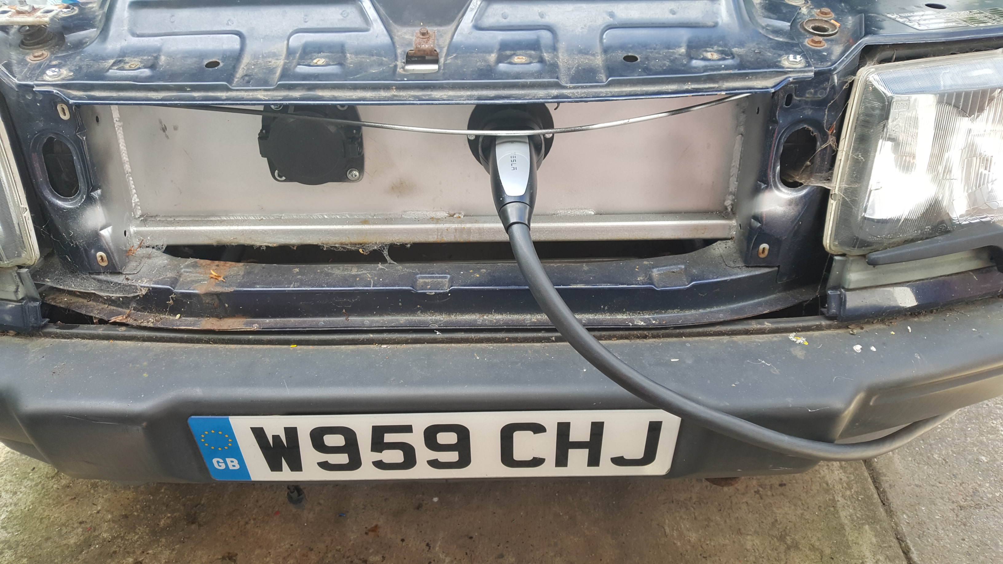

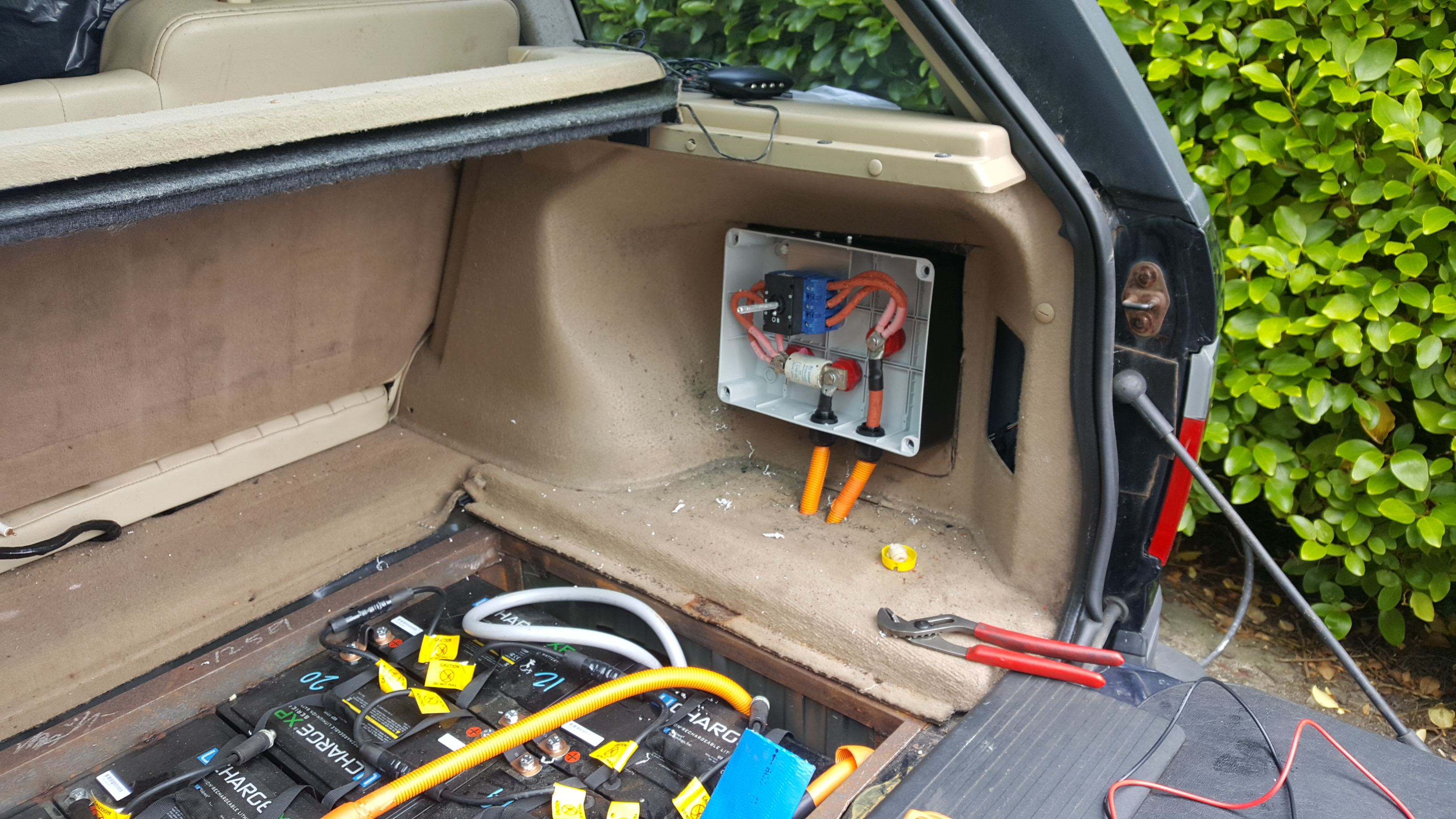

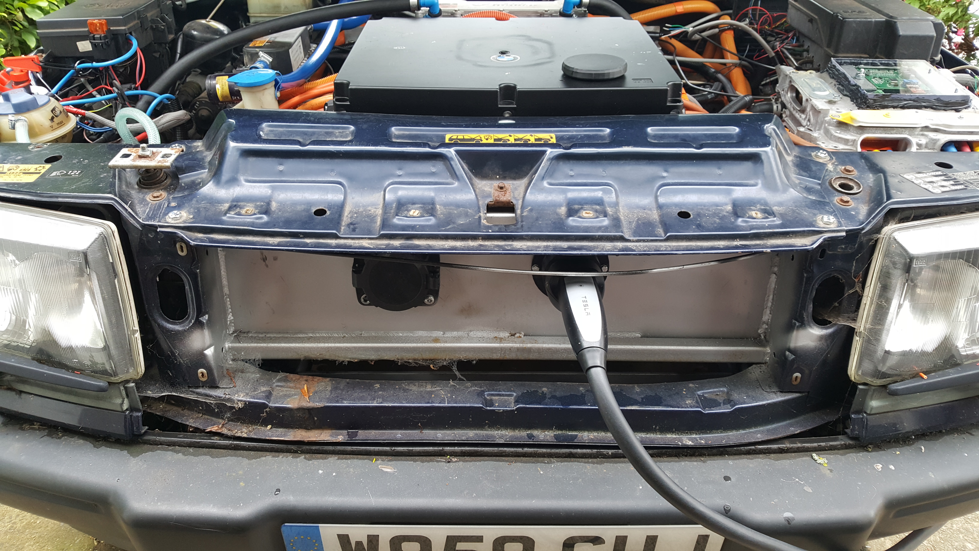

DerangedRover now charging on AC with the Coda/Lear charger. That's the last piece of the puzzle folks. Few days of snagging and she's back off home.

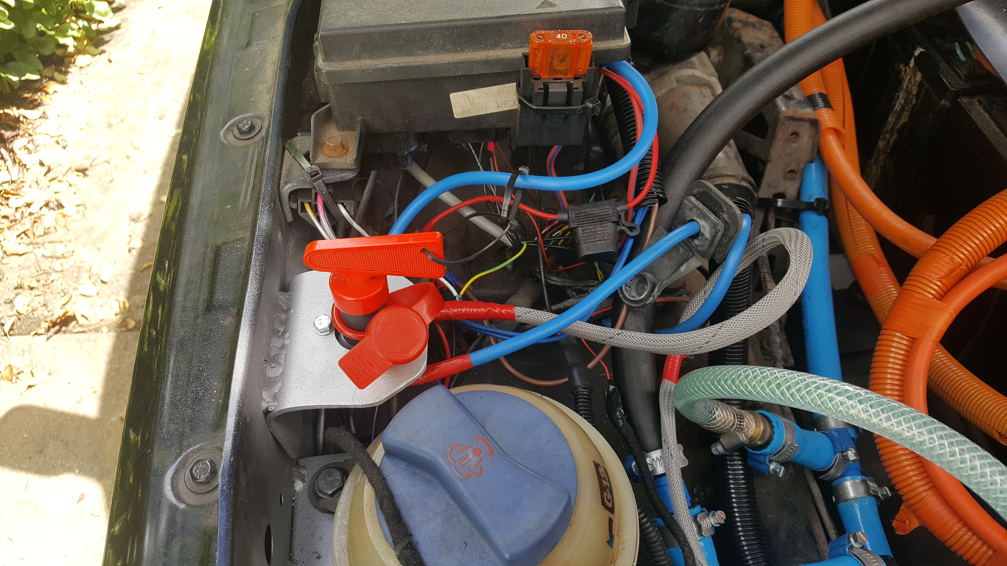

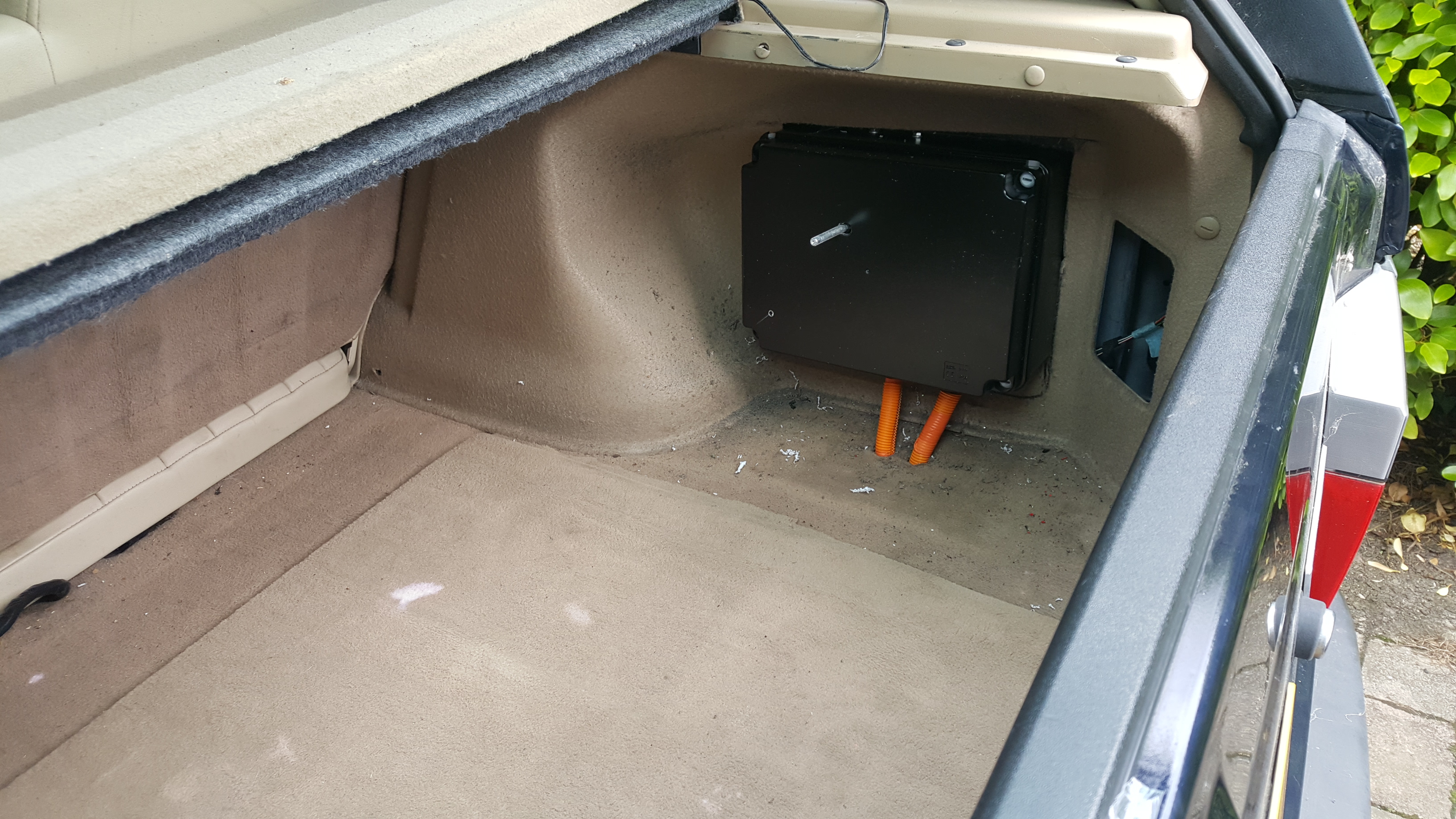

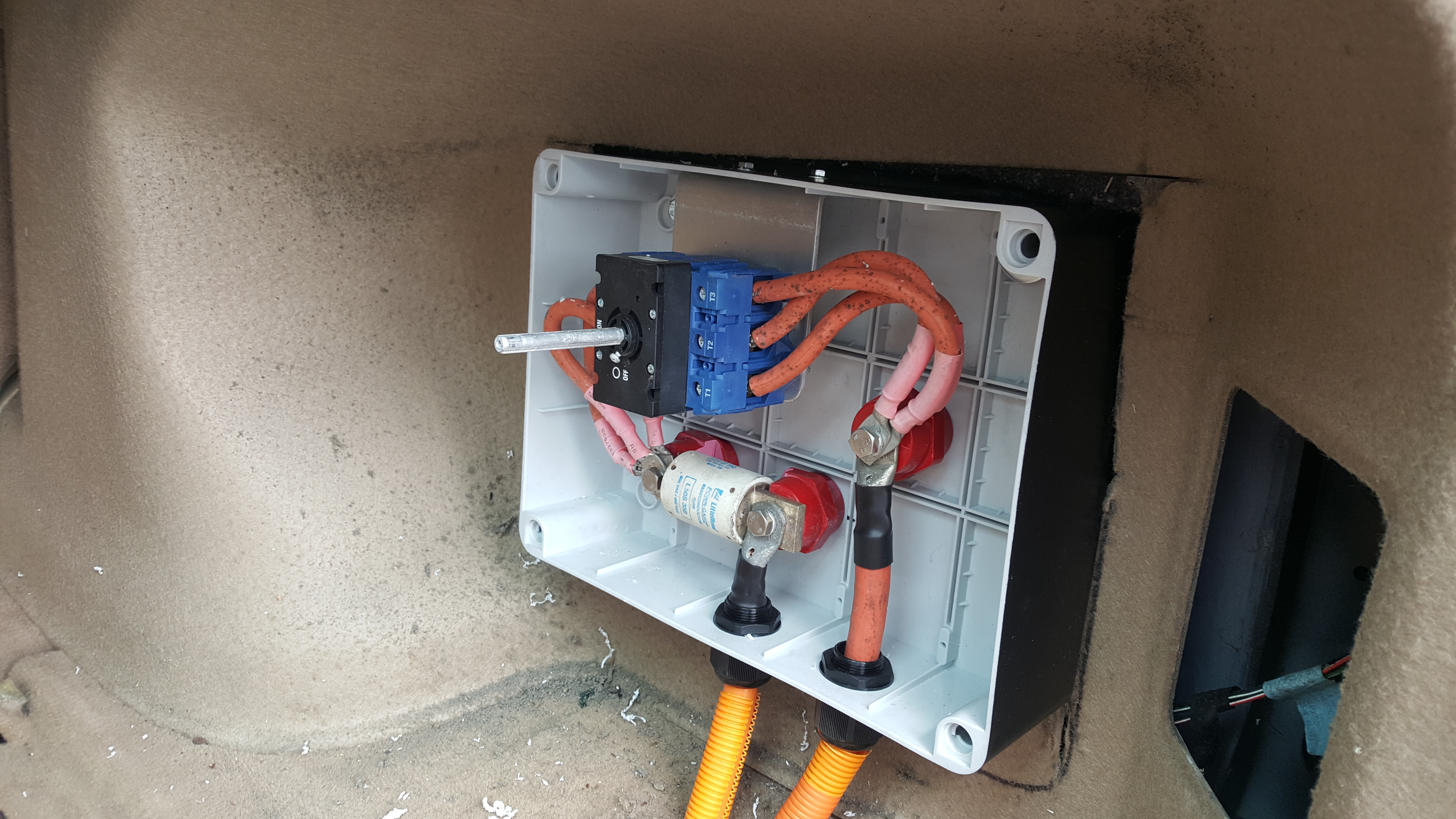

Snagging jobs. 12v and hv shuttoff switches fitted.

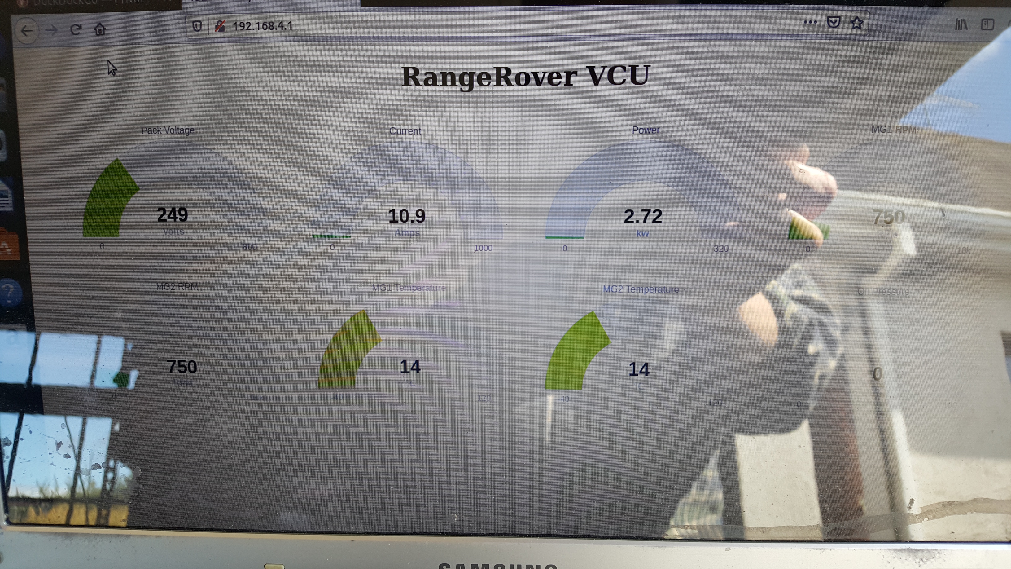

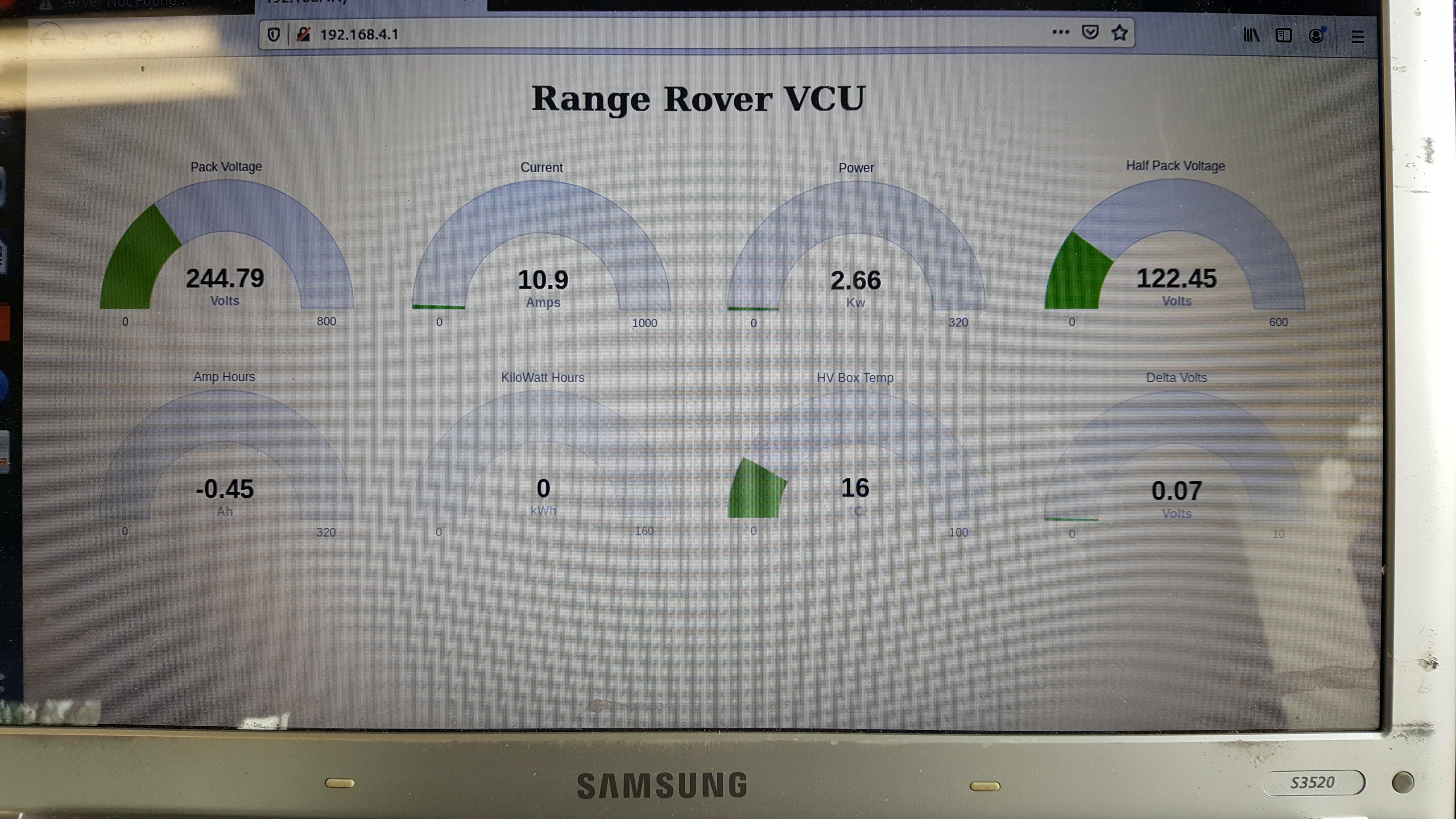

Lear / Coda charger up and running. New web front end for the vcu. Wrap up video in the works as departure date approaches:) It will of course be titled "All Over Range Rover".

Ampera heater. Will be in a few more of my cars :

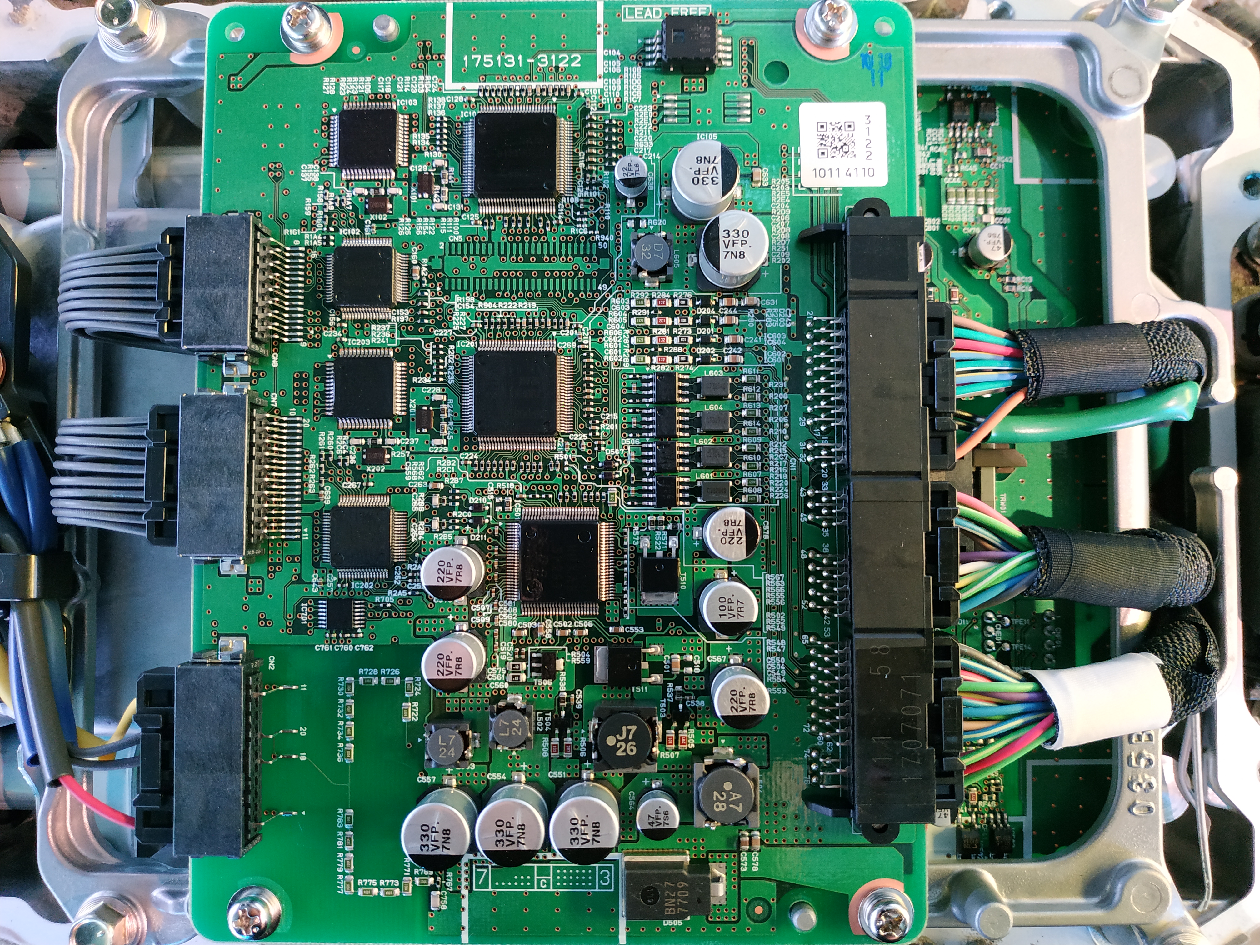

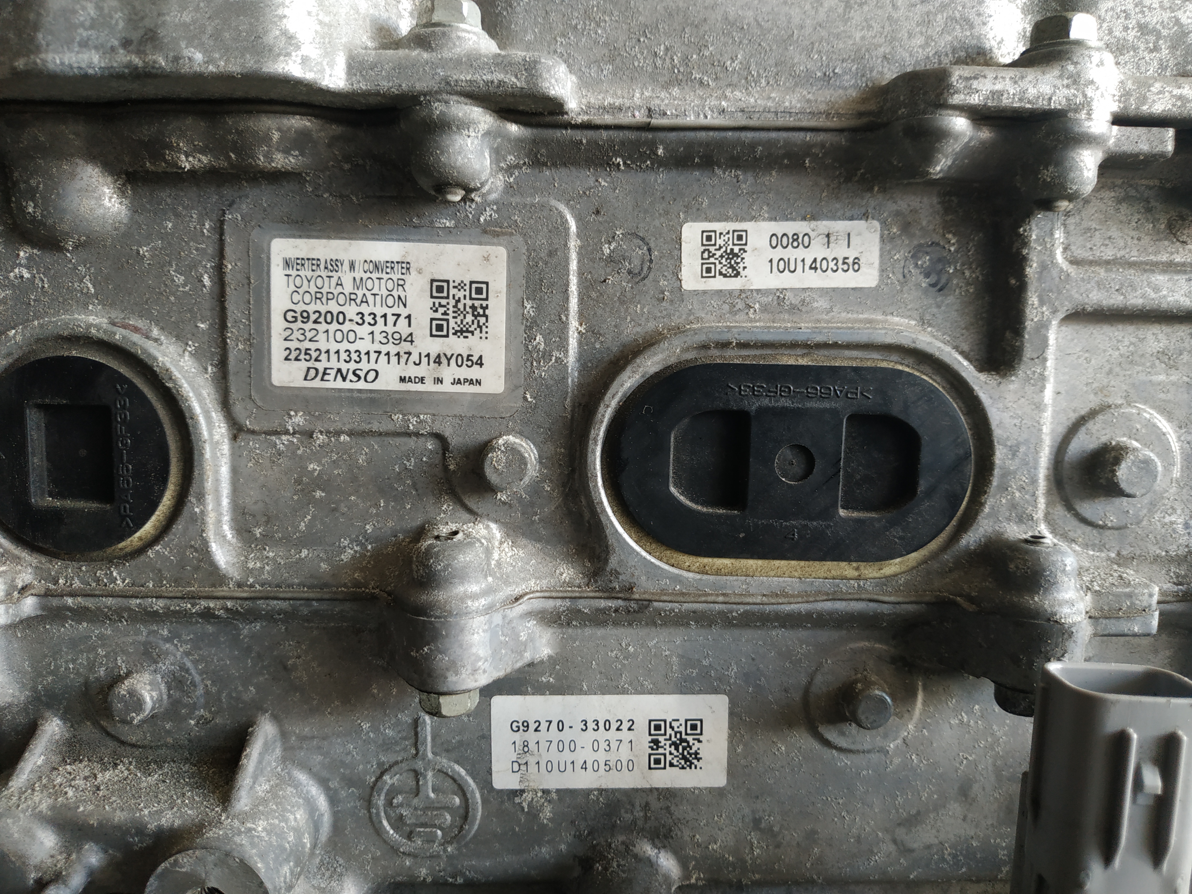

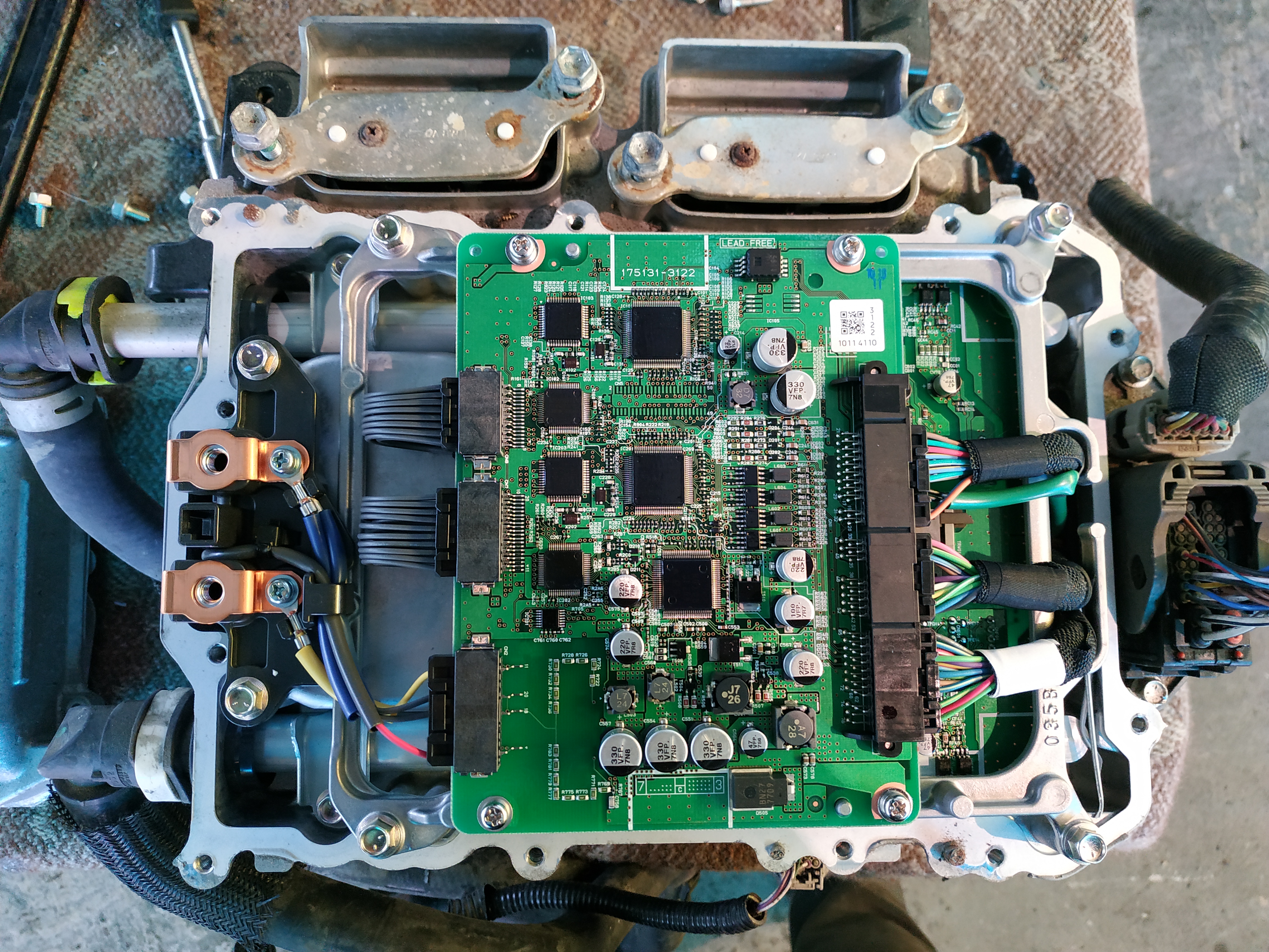

Excellent. I probably have the same Avalon - Camry inverter for the American market, the same as the ES 300h Lexus. If it suits me, then sell it to me for such a fee. There are many such invertors in Georgia. How much does the computer board cost and is it suitable?

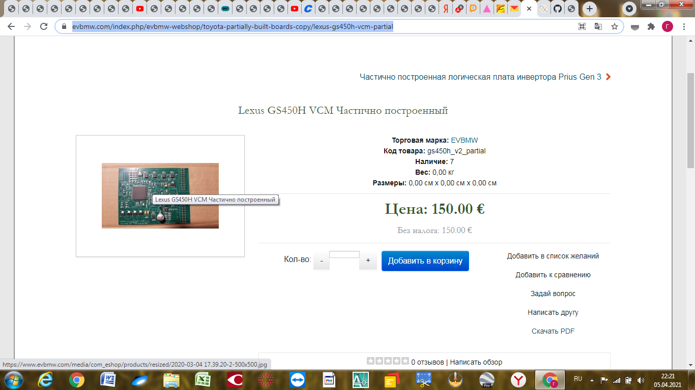

Lexus GS450H VCM Please tell me, is this board suitable for the Camry-Avalon inverter
? You can buy it, can't you, Damian?
