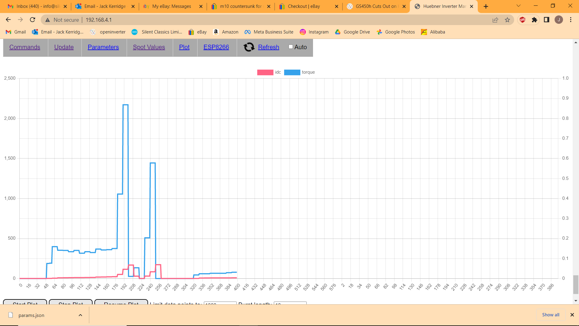

To get to the bottom of this is going to require some slow and steady diagnostics and information. Please do the following in this order and post the information here :
1)Use unmodified code straight from github
2)Post your parameter file here
3)Run a plot of the the "torque" paramater from spot values. Trigger the cutout, post the plot here.
4)If the plot shows "torque" drops to 0 and jumps back up etc during the cutout then its the vcu commanding the cutout
5)If its the vcu commanding the cutout , add paramater "idc" to the plot and run again a above. Post plot here.
6)if idc shows very high spikey values in time with the cutout then the vcu is receiving erroneous data from the isa shunt.
7)If neither torque drops nor idc spikes then its the Lexus inverter either loosing comms or losing rotor position or exceeding some factory presets.

by Jackk
Hello,
Firstly thankyou so much for looking into this!
Please see attached parameter file...
Here is the first torque graph. I booted it only once and you can see the torque cut clearly in the graph... It seems while the pedal is depressed after the cut it applies no torque. You have release throttle completely to get it to move again.
Here is the second plot showing torque and IDC... I'm not sure what you mean exactly by spiking values....
What are your thoughts??
I'm still yet to change my encoder wires to shielded. I can do this if you think its necessary.
Many thanks again!!

Jackk wrote: Tue Feb 14, 2023 2:34 pm Here is the first torque graph. I booted it only once and you can see the torque cut clearly in the graph... It seems while the pedal is depressed after the cut it applies no torque. You have release throttle completely to get it to move again.
I use older gs450h board so I do not know zombie software that much.
In your graphs there are two torque request ramps, was throttle pedal pressed all the time? You said it need to be depressed to get torque back, but depress is not included in these graphs?
If depress is not in your graph, then I started to think that isn't Torque value only a request, not what inverter is supplying = not a feedback. If it's torque request, as in older gs450h software, there is something dropping your torque request and inverter is doing what its supposed to do. Torque value being request also should eliminate resolver wiring problem. So it could be current sensor spike as mentioned before, but it could also be noisy TPS sensor value. If your TPS value drops for some reason it will drop torque request.
Someone might know better what all inputs could cause torque request limitations on zombie, for me doing graph torque, tps and idc would be interesting.
Edit: looked the source code. If TPS input value would be over its limits (from noise), tps will be limited to min/max. Your TPS is calibrated correctly and works linearly?
If your brake signal is noisy, it would cause tps value to be zero, but it should not feel that aggressive?
There seems to be also limits for Udc and temperature derates.
Anyway, aggressive torque drop points me to EMC problems somewhere, but all things that might alter torque request are another interest.
