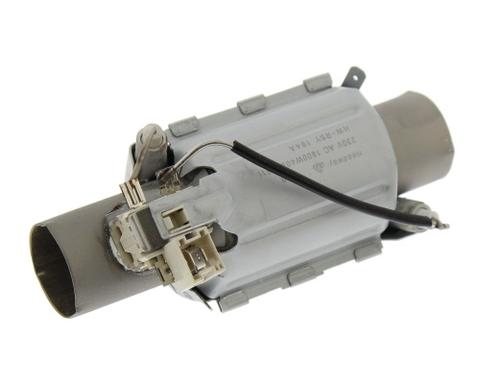

There are engine block heaters which I think are designed for use with trucks and machinery operating in cold climates to prevent them freezing up between uses. Also the electric Smart car uses an inline water heater.
Image Smart Fortwo electric inline water heater
If I want to reuse the existing HVAC system without modification, I need both warm fluid and cold AC gas.

Have been looking more closely about the cabin heating issue. I think I will be willing to put AC cooling into a later phase. I can open windows in summer, but heating in winter is going to be more important.
Initially I was thinking about keeping a coolant circuit running through the original heat exchange core in the HVAC system, and using a heater to warm this fluid. My intention was to avoid modifying the HVAC and just continue to provide what it was expecting (warm fluid from the engine bay).
Now I'm not so sure about the efficiency of this approach going through several energy conversions when you could go more direct using a PTC heater core. There is also tubing, insulation, reservoir, pump and the fluid itself to consider all adding to weight and the thermal inertia of it all. One benefit of that idea is that you could have the coolant heated up when on the charger and then might be able to stay somewhat warm for awhile after disconnecting if your reservoir is big enough.
The Positive Thermal Coefficient heater cores are remarkable things. I wasn't aware of there self regulation and safety features. Basically the hotter they get, the more resistance they create, thereby limiting current flow and setting their temperature. If there is no airflow across the core to cool it, the power consumption drops right down.
Question: would it be best to use a high voltage unit (say 220-600V) or a 12V system?

sfk wrote: Wed Feb 27, 2019 7:17 pmQuestion: would it be best to use a high voltage unit (say 220-600V) or a 12V system?
I wouldn't go for a 12V heater. I assume you need a 2kW heater to be able to heat the cabin and consequently you'd need a 2kW DC/DC converter.

Righto. That would be a better idea. The PTC I'm considering is 200-600V 1000W AC or DC input. Just need to check the dimensions which will be the limiting factor as to maximum output.
So this means it could be powered directly from the battery pack?

sfk wrote: Wed Feb 27, 2019 8:18 pm Righto. That would be a better idea. The PTC I'm considering is 200-600V 1000W AC or DC input. Just need to check the dimensions which will be the limiting factor as to maximum output.
I am still trying to start 5kW Ampera heater. It would be ideal choice. In the meantime i made do with normal 2kW water heater from dishwasher.
Once connected to 360Vdc it can produce 5kW of heating power. This is enough to vaporize 2L of water-glycol mixture we normally use in EV cars.
Also i noticed this heater made for AC uses thermostat switch to control temperature. This is regular bimetal switch which would stick with HVDC voltage.
So i took one AEV52012 20A 360VDC 12Vdc controlled relay from Nissan Leaf precharge system and bypassed the switch on the heater. https://www.components-mart.com/product ... 52012.html
I put another 85°C thermostat switch inline on the hose after heater and wired it so that it controls DC relay operation. I operate +12V side to relay by a switch in cabin, while thermo switch cuts path to GND in case fluid gets over 85°C. System works good, but is bulkier than Ebspracher 5kW heater in Ampera. Of course 12V switch also switches on pump that circulates fluid to the exchanger.
I expect 2KW would be a mild effect in any case. You have to consider you need to heat up the air tunnels also and 2kW did not provide enough power when i tried it on 230VAC voltage. I was so much happier when i saw 5kW on DC!
Also to consider with 12Vdc is amperage. You would need 150A supply at 2kW!!! Even Ampera DCDC converter has trouble with that.
Right now i am considering Webasto Thermotop V diesel for primary heater in winter with 5kW inline heater for transition period if i have space left in my car.
