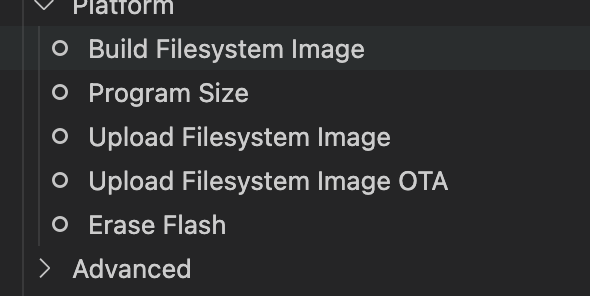

Ok ive managed to connect to the wemos but it wont let me connect to any web page? is the page the default 192.168.4.1?Bigpie wrote: ↑Tue Feb 01, 2022 8:58 pm I was missing "sta_tick.update();" in the loop, so the ticker never executed, that's a commit message.
Are you using Platform.io and not Arduino IDE? It's a Platform.io project.
Are your libraries the same versions? Also be sure you're connection to the serial output the nextion display would connect to.Code: Select all
Dependency Graph |-- <WebSockets> 2.3.5 | |-- <ESP8266WiFi> 1.0 | |-- <Ethernet> 2.0.0 | | |-- <SPI> 1.0 | |-- <SPI> 1.0 | |-- <Hash> 1.0 | |-- <ESP8266WebServer> 1.0 | | |-- <ESP8266WiFi> 1.0 |-- <Ticker> 3.2.0 |-- <ArduinoJson> 6.17.3 |-- <LittleFS> 0.1.0 |-- <ESP8266WiFi> 1.0 |-- <ArduinoOTA> 1.0 | |-- <ESP8266WiFi> 1.0 | |-- <ESP8266mDNS> 1.2 | | |-- <ESP8266WiFi> 1.0 |-- <ESP8266mDNS> 1.2 | |-- <ESP8266WiFi> 1.0 |-- <ESP8266WebServer> 1.0 | |-- <ESP8266WiFi> 1.0 Building in release mode
Some parts of it won't work with stock simpbms, like updating the settings and override ac present.

Yes, you need to also upload the spiffs (Filesystem) image
So after struggling like mad with this and getting very frustrated at my own inability i discovered this issue:
https://openinverter.org/forum/viewtopic.php?f=5&t=2001
I figured i needed to apply the same sort of fix to the platformio code so i modified the main.cpp file like this:

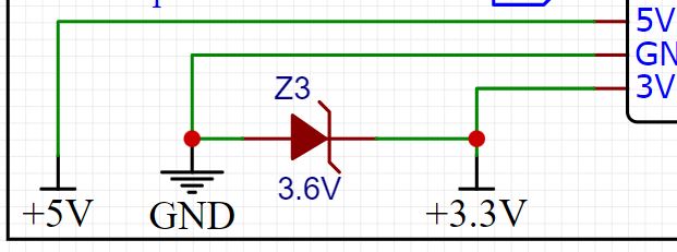

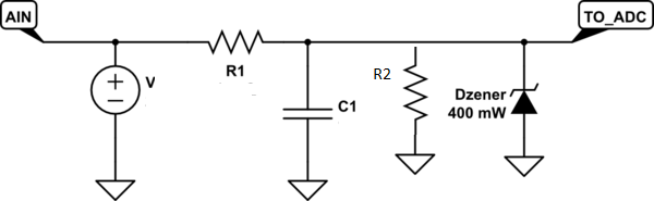

@aot93
Can you explain the function of D1 - D4 zener diodes on the VCU?
Would it be ok if i used zeners with threshold of 16V?
tnx
A
tnx
A

Hi Arber,
The aim here was to to provide a bit of input protection to the teensy.
The diodes make a simple clamping circuit limiting the voltage to the vcc rail.
From what I understand the value of the diodes is not too important, but I'm not an exert on this!

What would be the overvoltage threshold you are trying to protect?
tnx
- aot93
- Posts: 212
- Location: UK, West Sussex
- Has thanked: 8 times
- Been thanked: 49 times
in theory this should protect even high voltages like static discharge.
But mostly I'm trying to protect against 12v or even 5v from from mis wiring or accidental contact.
Teensy board does not like more than 3,3v for even a moment, I learnt this the hard way more than once!
That's also another reason I chose to opto-isolate all digital inputs.

OK, dont get me wrong, i only want to know the reason behind some of the features and help improve them.aot93 wrote: ↑Tue Feb 15, 2022 8:57 pm in theory this should protect even high voltages like static discharge.
In any case zener diode will conduct from one end as any other. However after specified threshold it will also conduct in reverse. That is the protection feature we want since this will drain overvoltage to GND. But if you want to protect against 18V you need to select 16V zener. Likewise if you want to protect against 7V you select 5V5 zener and so on.
Since i use 5V pedal I would rather put 4K7 inline and 10K for divider and reverse parallel a 3V6 zener with it. That should block any OV on the analog side. Like this:
I noticed you mention 0.1uF elcaps next to analog input. Normally i dont use elcaps for decoupling but rather ceramic caps. No polarity, faster response and much higher voltage. I recommend you use them...

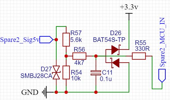

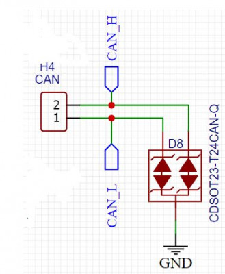

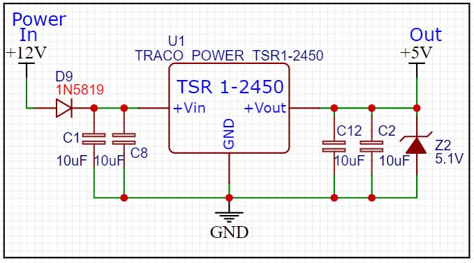

That is great work aot93, thanks for sharing everything. I'm doing something similar for my Panda and did quite a bit of research on automotive protection for controllers after having similar bad experiences blowing up micros. I'm with arber, you need quite a bit of protection in the circuit to prevent smoke for car applications. There is so much noise there and we often make mistakes when wiring!
If it is any help, this is what I ended up with for a 5V analog input where you can't easily use cheap opto isolation: SMBJ is a chunky TVS diode that protects from ESD and big nasties
R57 and 54 are just voltage divider to 3.3v (you can change this for a 14.5V input also)
R56 is input current protection and part of a filter with C11 to smooth the inputs
D26 is Schottky diode that clamps the input to the processor's supply rails
R55 is the final current limiting protection to mean if anything gets through that, the processors own protection has a chance
The goal is, whatever you throw at the input, the mcu never goes out of its safe input range.

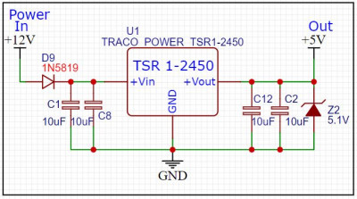

This rejects that energy to the supply rails, so you need to protect those also with a zener to not exceed the max voltage limits on those rails: I always stick a Schottky diode on the power input just in case also.

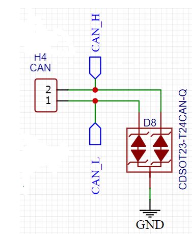

Same on the 3.3v rail: Finally, I think the CAN transceivers also need protection, so double TVS on there is the minimum that is advised: Its all a bit of a faf but probably worth the effort. If opto isolation shares the same ground (which I guess it will do in the car wiring) I don't know if that is fully effective? Much better than nothing I'm sure.
Just thought I'd share that. You can get similar bits in through hole and smd.

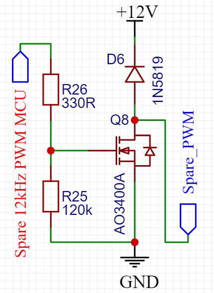

I've found this cheap and effective mosfet output works really well also. If you are using PWM, you need a Schottky diode across the load if it is a coil. A normal diode will get very hot, I found out! Its great seeing all the different ways people are developing their own stuff and getting things on the road. Really inspirational. Its amazing what people in this forum are achieving. I'll post my Panda progress one day. I switched on the HV for the first time yesterday and got the bms, battery, contactors and DC-DC working. Charger next. First steps towards getting the motor turning on the bench before the power saw comes out!

Thanks for the suggestions, all very good and interesting.
I know some people like to use op-amp drivers for analogue inputs, which is also a good approach.
Of course board space and component availability come in to this as well.
The capacitors are tantalum, not sure where the EL reference is coming from, agree you EL's are not ideal for this job.
