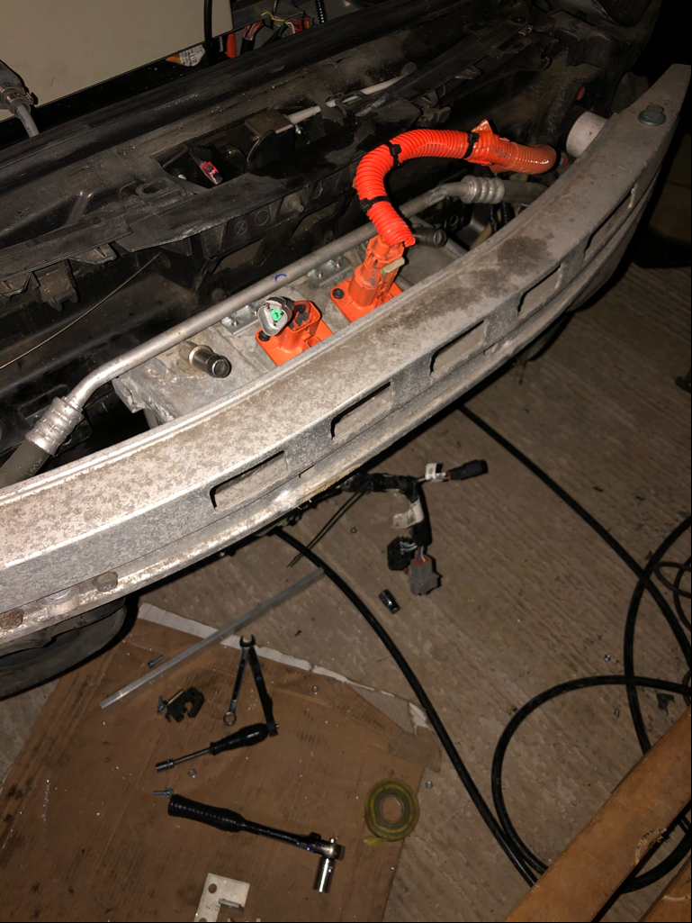

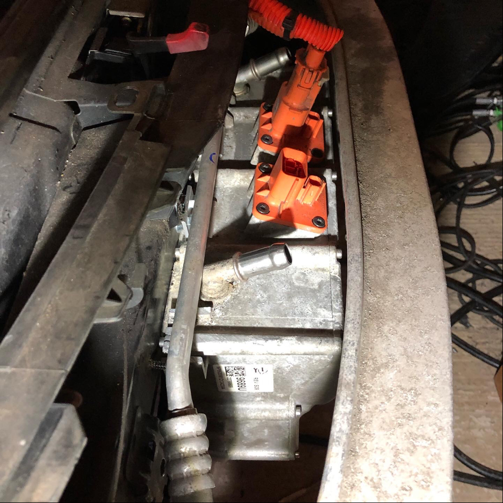

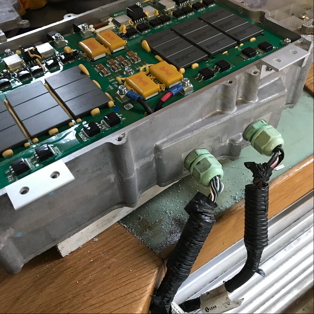

A little update on the charger and DCDC modules.
I bought these items for just £350, but the charger was in a particularly bad state following a front end collision from the donor car. It took some work to repair and hopefully it'll work.
If anyone has a spare orange Delphi/Aptiv male AC input connection plug for the charger then please let me know. They seem to be NLA. I need this one (it has three inputs L1 - Ground - L2):

Hi, good find.
I wouldnt bother with connectors though. You can make your own flanges from plastic and new cables.
I am interested in what happened to DCDC that you had to open it.
What is your solution for BMS?
You can see my blog for control of DCDC and charger.
https://leafdriveblog.wordpress.com/201 ... a-charger/
https://leafdriveblog.wordpress.com/201 ... dc-or-apu/

Thanks - I'll replace the flanges/connectors as you suggest if I cant find another connector.
Regarding the DCDC, I just wanted to replace the HV wires to the correct length for my conversion and fit crimped eyelets. That's all.

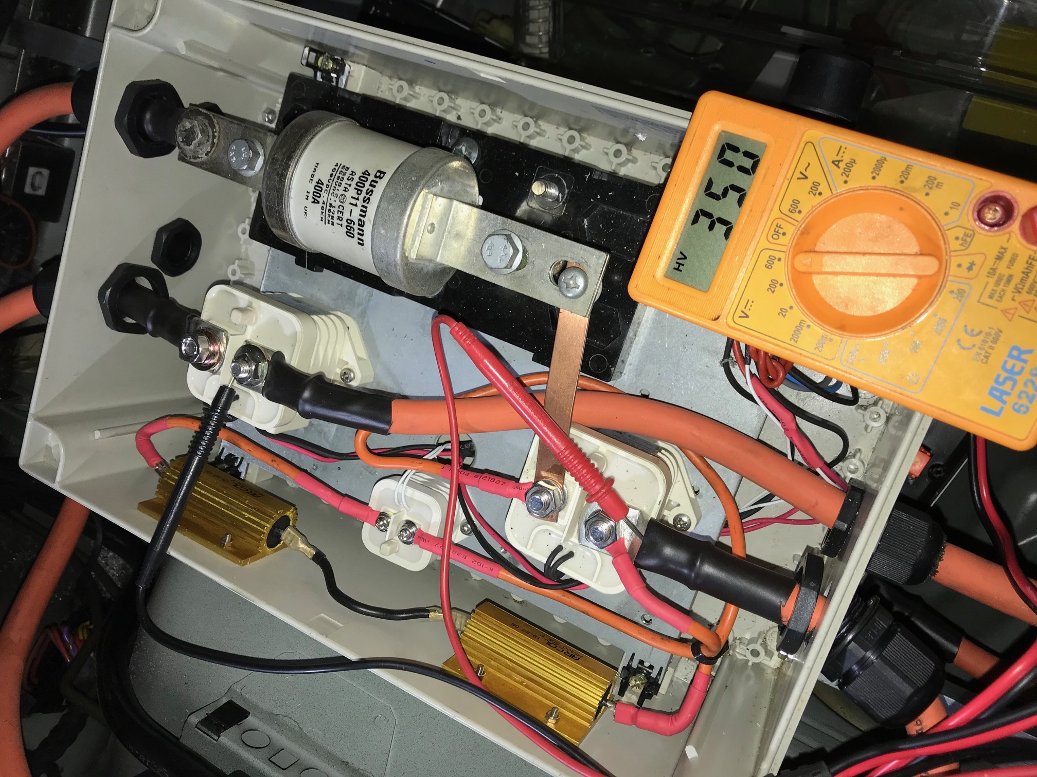

Jobs to do this week:
1) Finish off the LV wiring and test system at full HV.
2) Start wiring in BMS

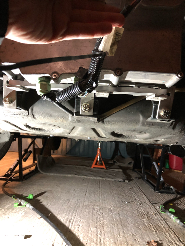

A few pictures repairing and modifying charger and mounting it into the car:

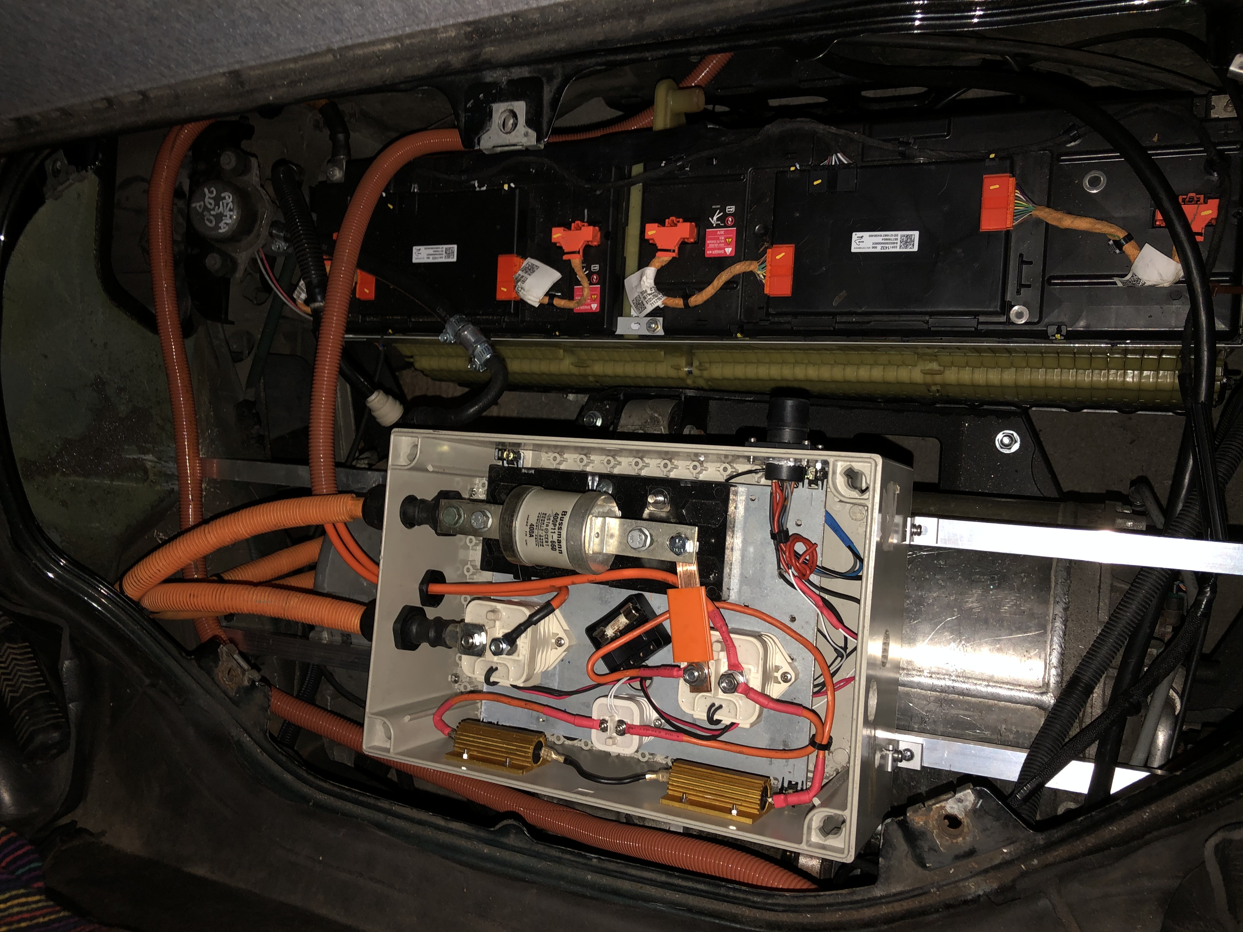

Looking Great! In your contactor box, would you mind sharing the part numbers of both your 2 large contactors and the 1 smaller one used in precharge?
Also, what size are the 2 resistors?
Boxster EV
Posts: 489
Location: UK
Has thanked: 57 times
Been thanked: 49 times
Re: Porsche Boxster 986 Tesla conversion
Post by Boxster EV »
bulletbug wrote: Mon Mar 02, 2020 8:39 pm Looking Great! In your contactor box, would you mind sharing the part numbers of both your 2 large contactors and the 1 smaller one used in precharge?
All purchased through zero-ev.co.uk. They're available in their webshop. Not cheap but the quality seems excellent.

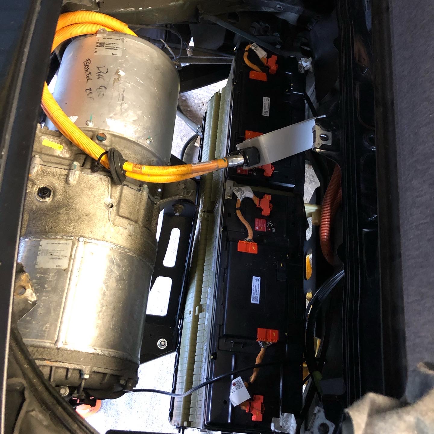

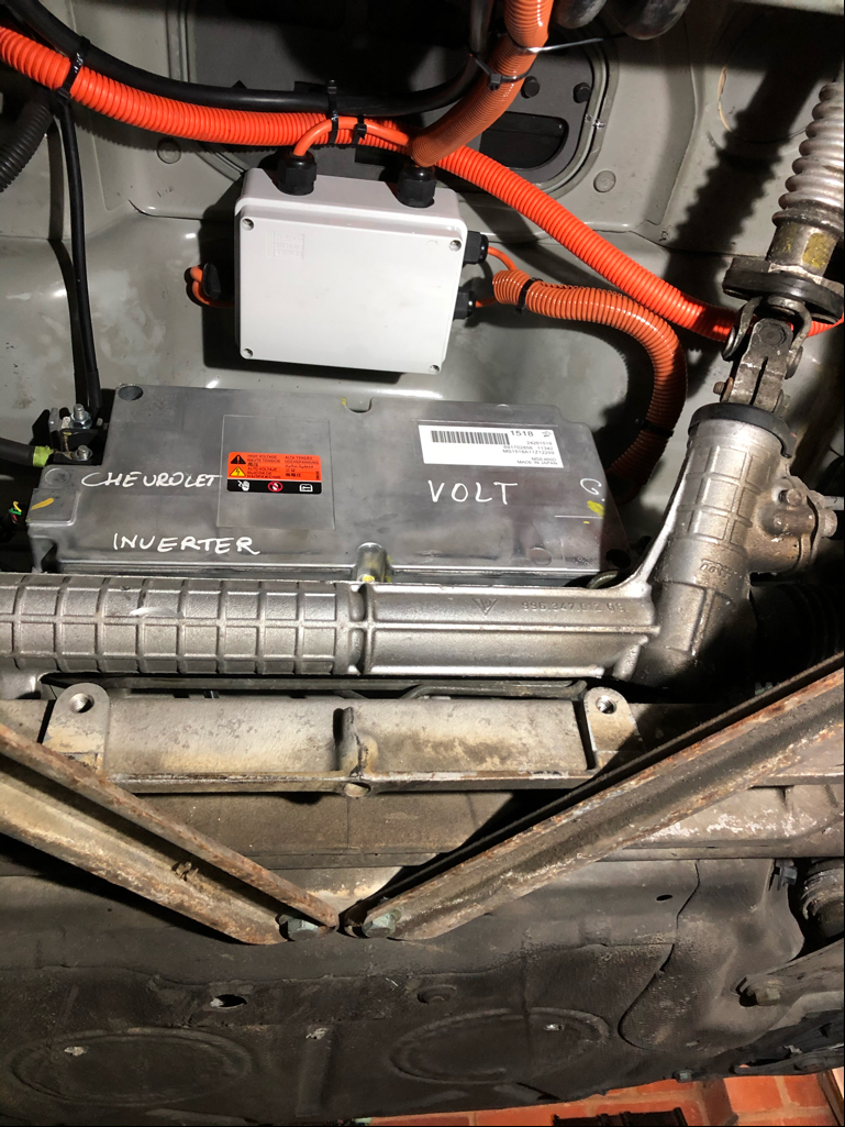

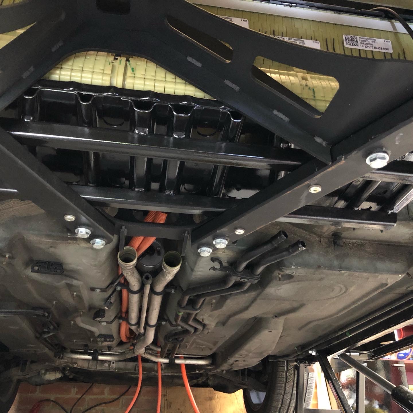

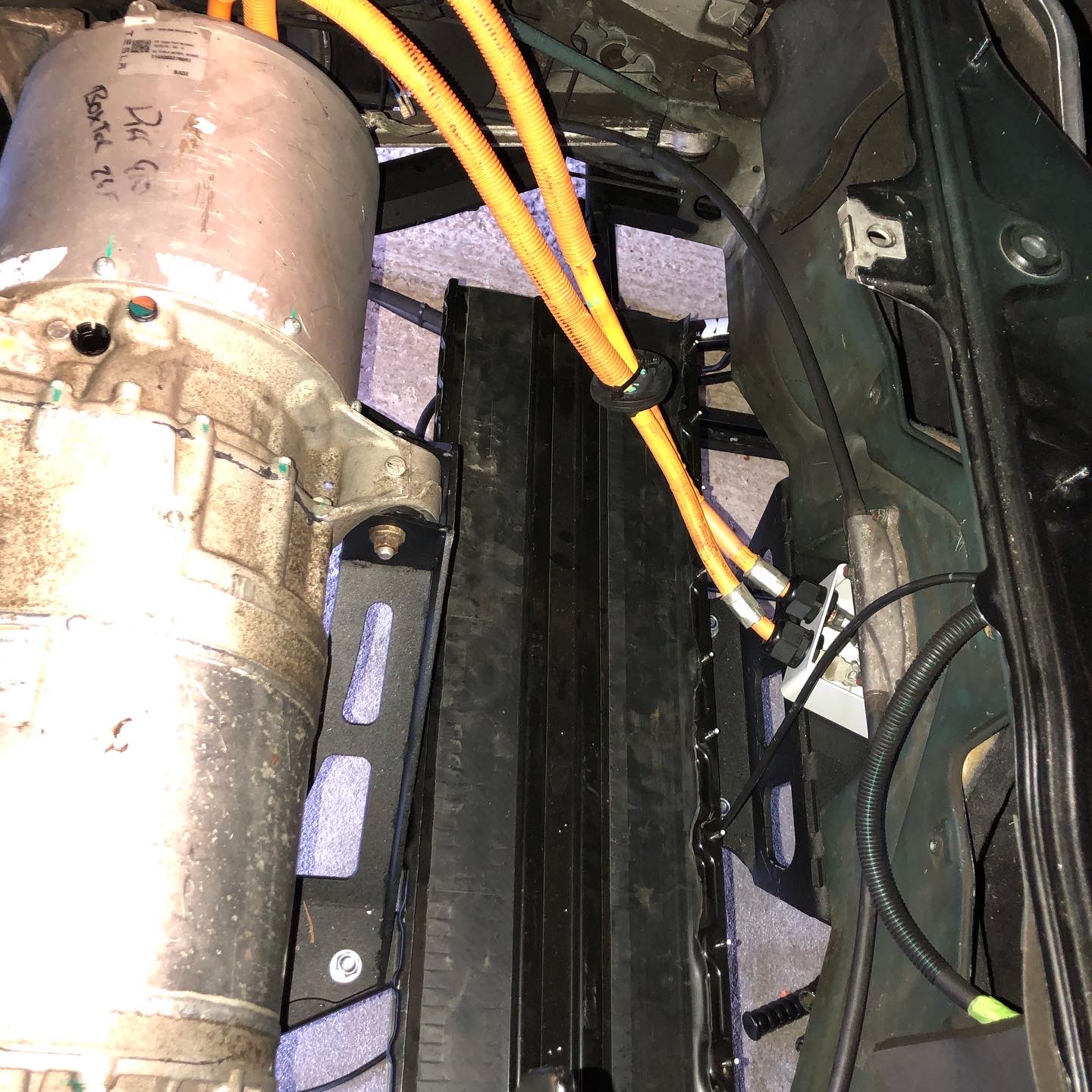

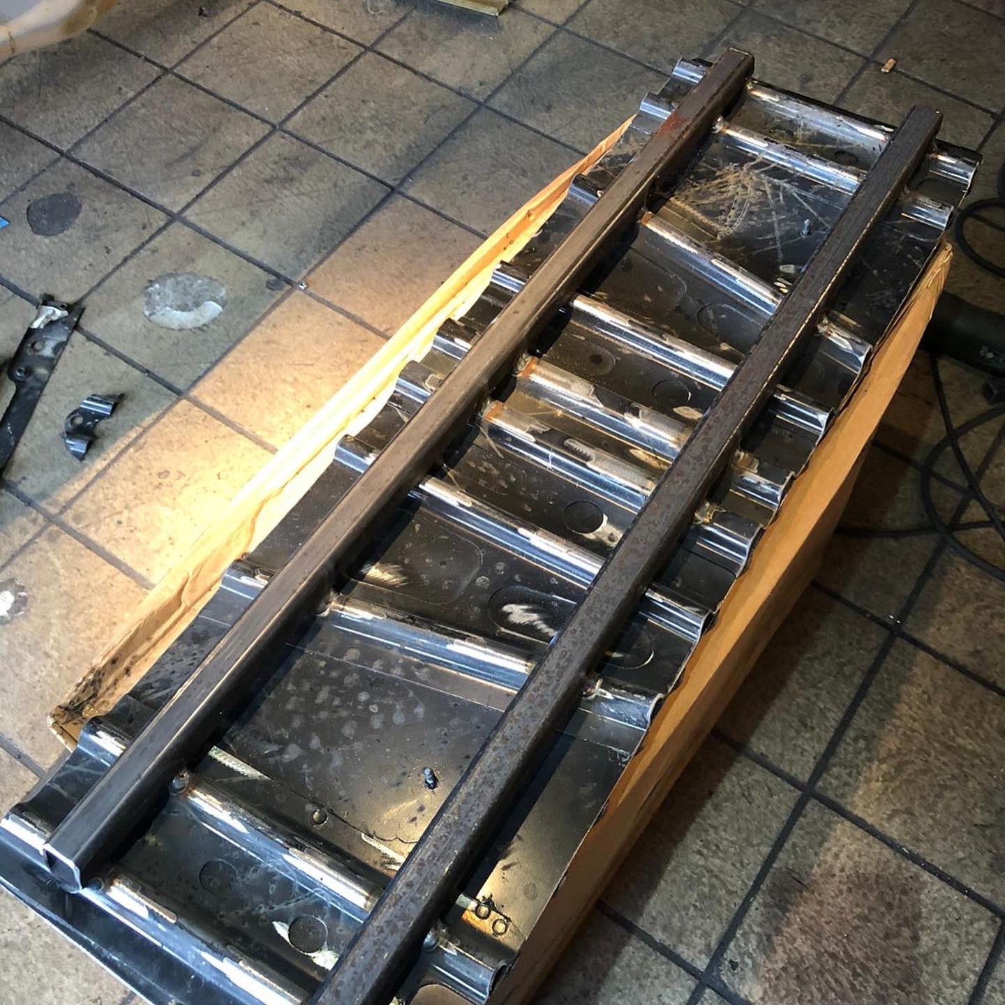

Small update: The layout and position of the batteries and HV junction box has been bothering me. With the existing design, there’s a huge amount of unused space in the mid-engine bay, frunk and boot and in reality some consolidation was needed. Last Friday evening I put the thinking cap on and quickly starting ripping out many weeks’ worth of work to review the design. I’m so pleased I did as the revised solution works so much better in space efficiency and technical terms. Here’s a summary:
• The bulky HV junction box is now mounted inside the mid-engine bay. It hovers above the drive unit on two 25mm aluminium box sections and is secured to the car’s frame rails. This is a major improvement electrically too. It means I don’t need to modify the Chevy Volt BMS harness at all, the battery HV cables are a fraction of the length making them safer, and the drive unit can connect directly to the HV box without extending its cables.
• The small and medium battery modules are now be mounted in the boot – they just about fit with the use of some custom brackets and rubber bases. In time this may change again as there is space for them to hang under the boot.
Presently I don’t have the inclination to do the fabrication work. It’s something I can come back to if it bothers me, but I doubt it will. It means the boot can now be used for two batteries and most electrical services including LV junction box, BMS junction box and LV bulkhead connectors that run to the front of the car for the charger integration and DCDC communications.
• The frunk is now completely empty and free for luggage once again – back to OEM. The charger will remain behind the front bumper and the DCDC in the fuel tank area – perfect locations for these items on the Porsche 986.

I see your DCDC mounting. Good use of space available. However if you read Volt manual this APM(DCDC) was considered IP51 protected, that is why they put it inside the cabin. I would advise you to make a screen in front of DCDC that would repel moisture.
Boxster EV
Posts: 489
Location: UK
arber333 wrote: Tue Mar 17, 2020 4:58 pm I see your DCDC mounting. Good use of space available. However if you read Volt manual this APM(DCDC) was considered IP51 protected, that is why they put it inside the cabin. I would advise you to make a screen in front of DCDC that would repel moisture.
Thank you for the advice.
Hopefully it wont be a problem as all the under-trays still need to go back on the car and it's hidden behind the frunk bulkhead, and reasonably high up comparatively speaking. I've also fused it.
In all honesty I probably wont use the car too much during the wet.

The larger of the three banks sits across the frame system inside the engine bay. It rests on the original volt battery tray which has been cut to size and reinforced with some steel box sections welded on. It's then bolted onto the frame.
The weight of the Tesla drive unit and battery bank that the frame system is supporting is connected to the bolt holes of the original front engine mount (and rear mounts). The whole system is still less than 100kg lighter than what the same bolt holes were supporting with the OEM ICE.
It will be very tight to stack another bank of volt cells on top. It's doable but not without more fabrication and grief.
Hope this helps.

Yes that is very helpful. As I've retained the original transmission I chose not to mount the batteries to the engine mount, instead I have a frame member under that area connected to the diagonal braces. Incidentally I was looking at your previous pictures; I seem to have a similar power steering pump. However I placed the vacuum booster in the frunk just to have a shorter run.
How are you cooling the LDU? Will you use the original radiators?
