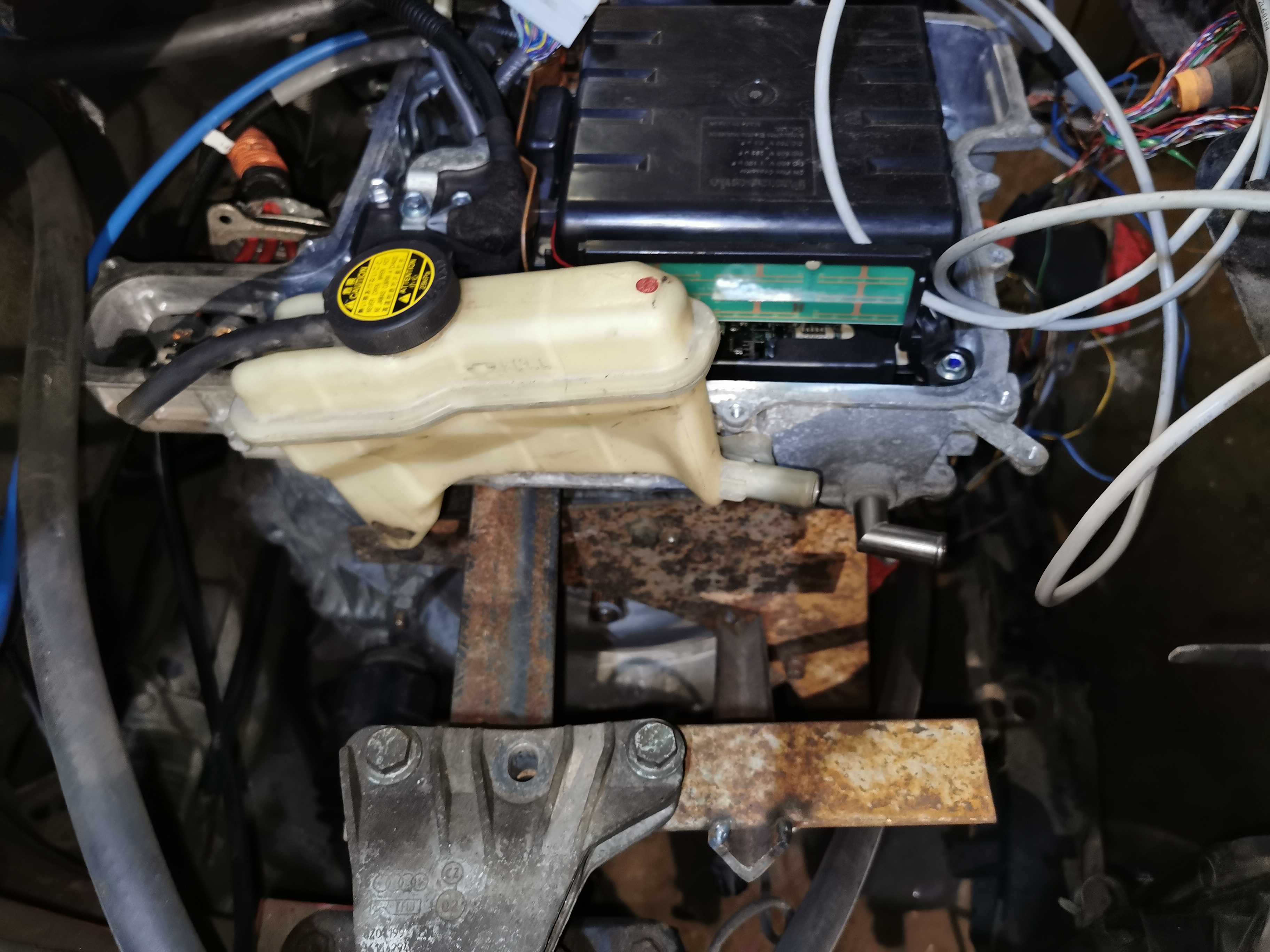

Our family (with parents and sisters) own 5 A2s. Two of them are 1.2TDI 3L versions. At first i wanted to use 3L version, but it had ABS placed almost in the middle of engine bay and also it is too rare to destroy :)
Been thanked: 1918 times

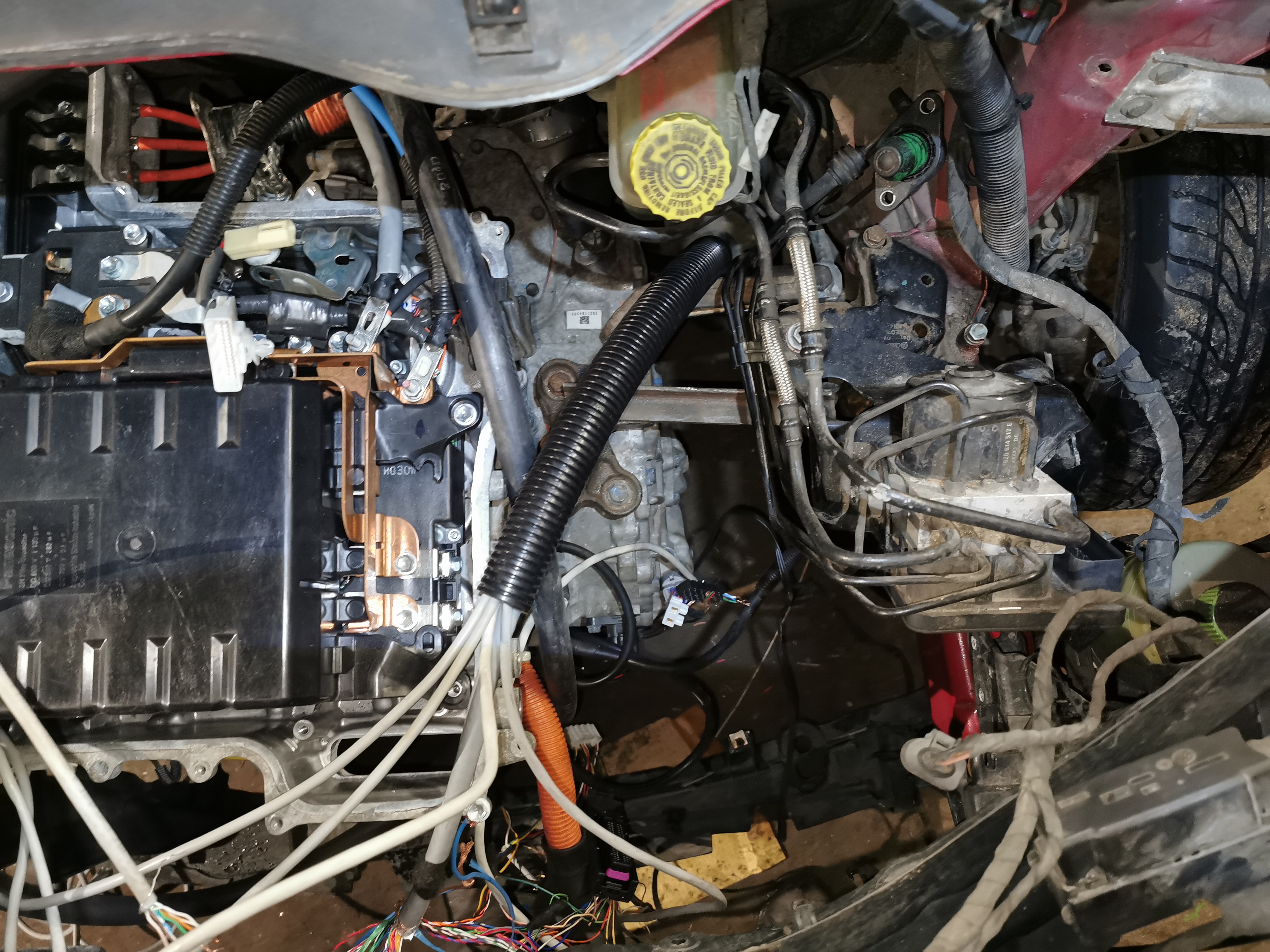

Re: Audi A2 with Prius Gen2

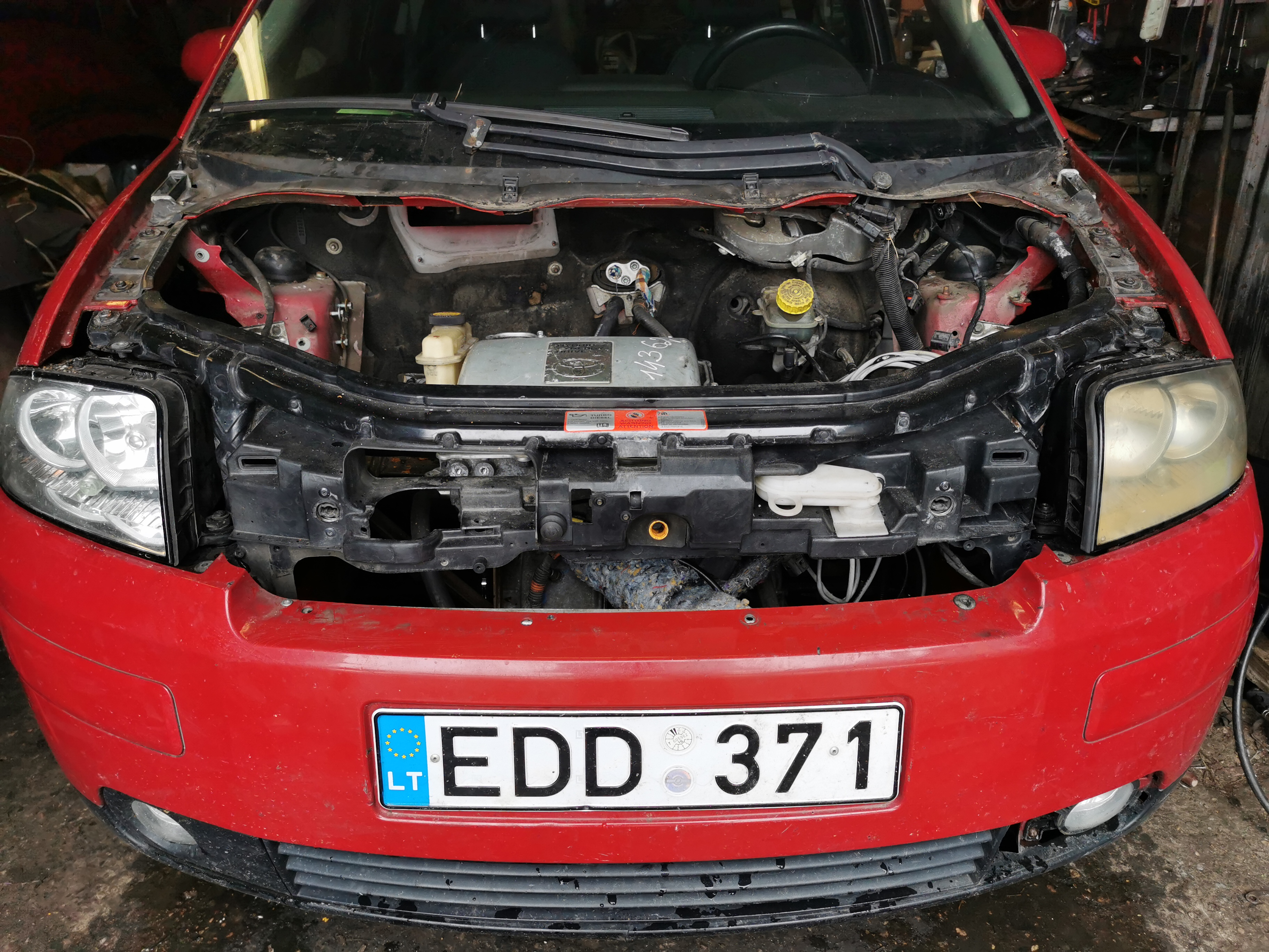

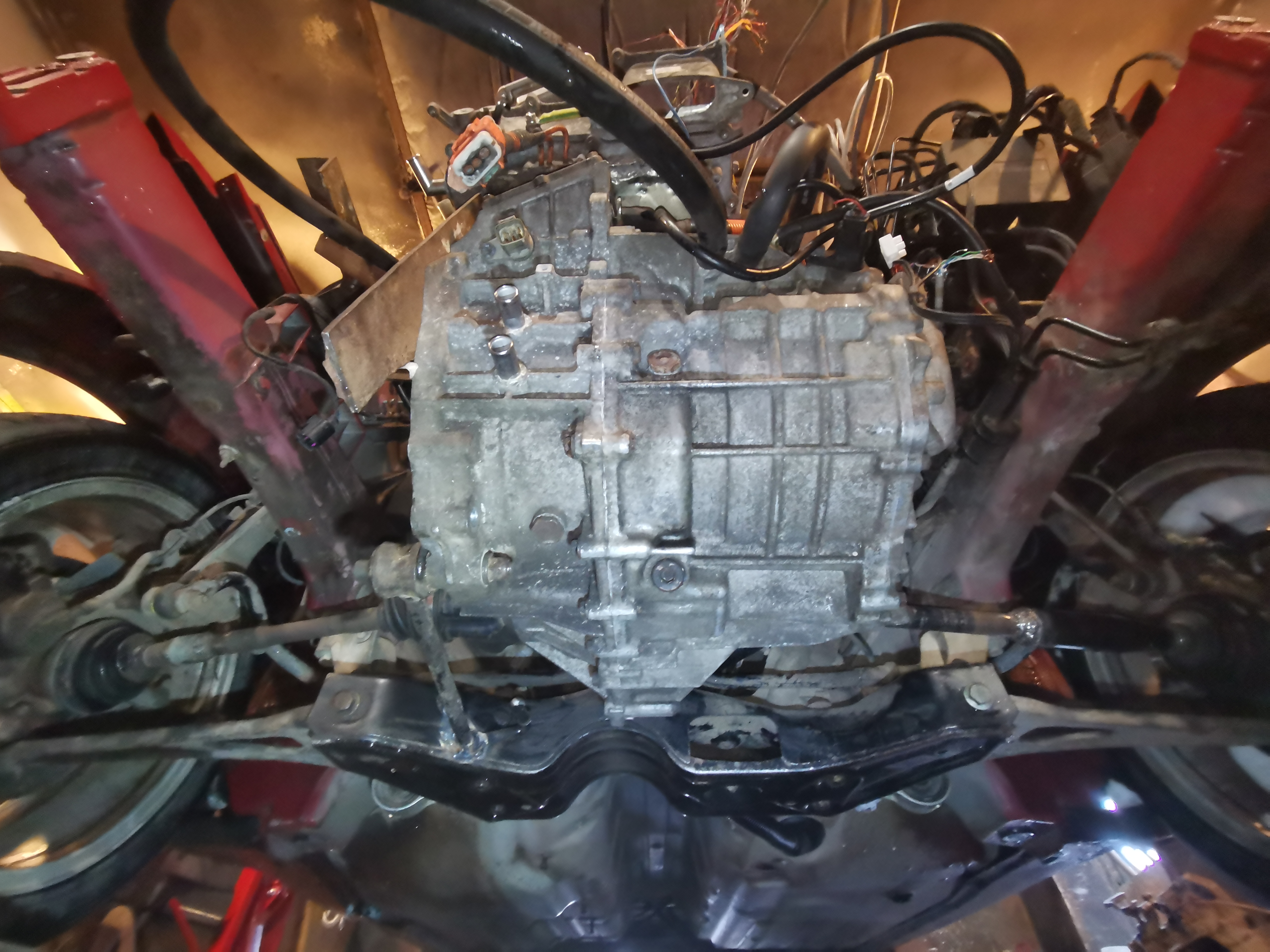

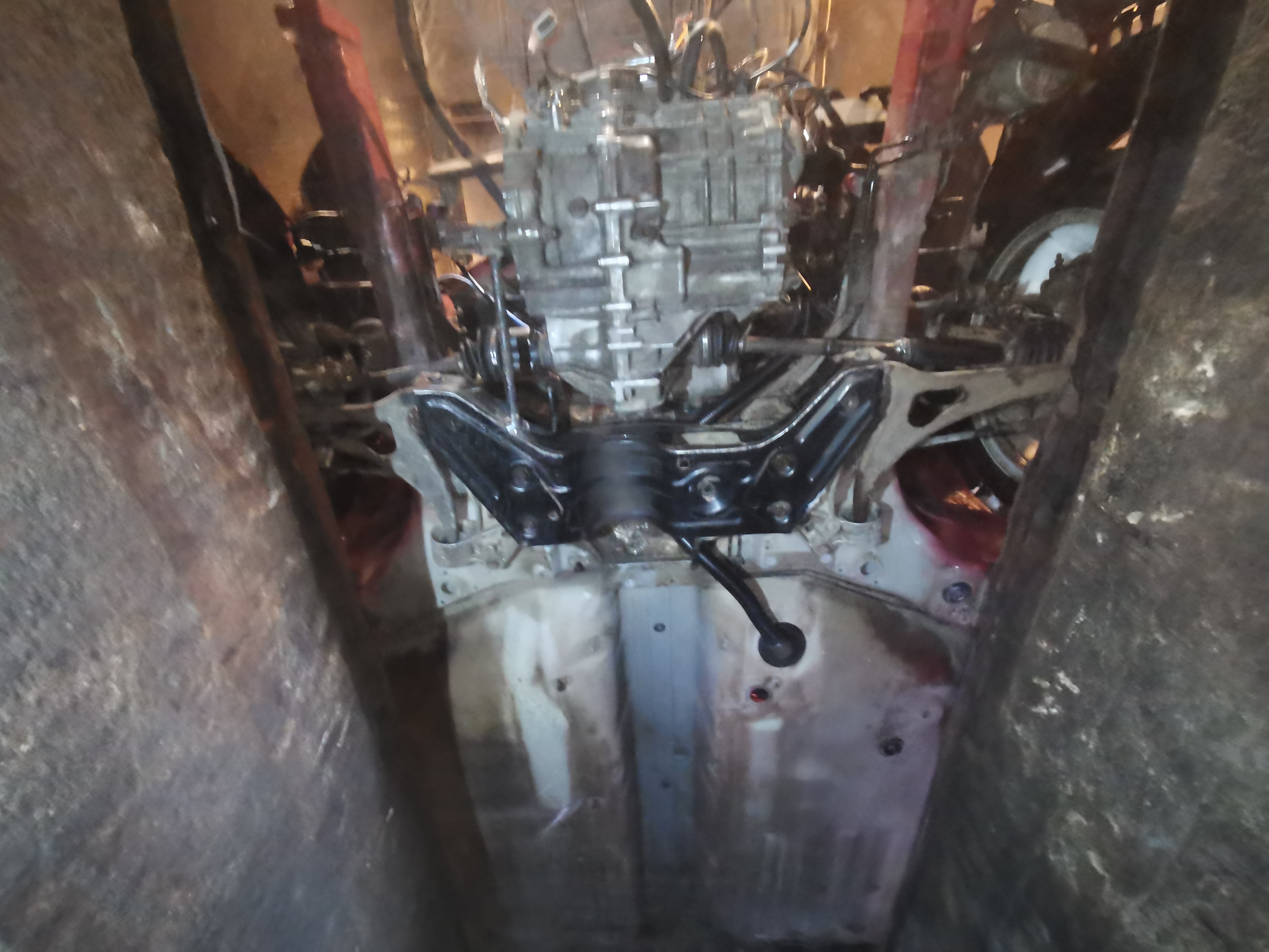

Oh, missed that one so far. Looks good :) I see you have the transmission mounted almost in the centre. Can you post an overview picture of the engine bay from above?

johu wrote: Thu Feb 10, 2022 9:11 pm Oh, missed that one so far. Looks good :) I see you have the transmission mounted almost in the centre. Can you post an overview picture of the engine bay from above?
Tomorrow will work with the car. Will make more pictures

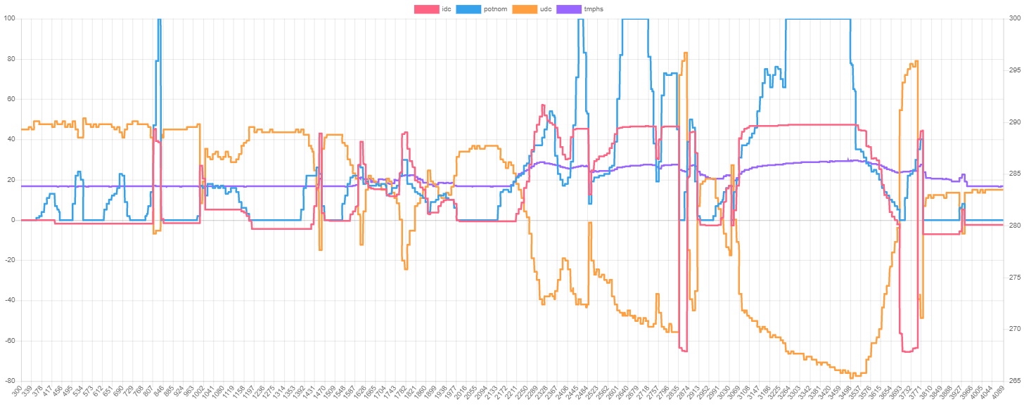

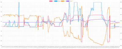

Test ride on solid road.
After that more questions when answers :D....
1. Max 80 km/h. Can reach it and after that cant get faster. Load on battery only 50-60A.
2. After max speed letting throttle goes into big regen. All is off in config. But it is only after max speed (80kmh). If i let go throttle at 60 kmh no regen.
3. Good acceleration from start but get weak after 30-40 kmh. It does not take more current. I see 50-60A, but current limit is set to 200A.

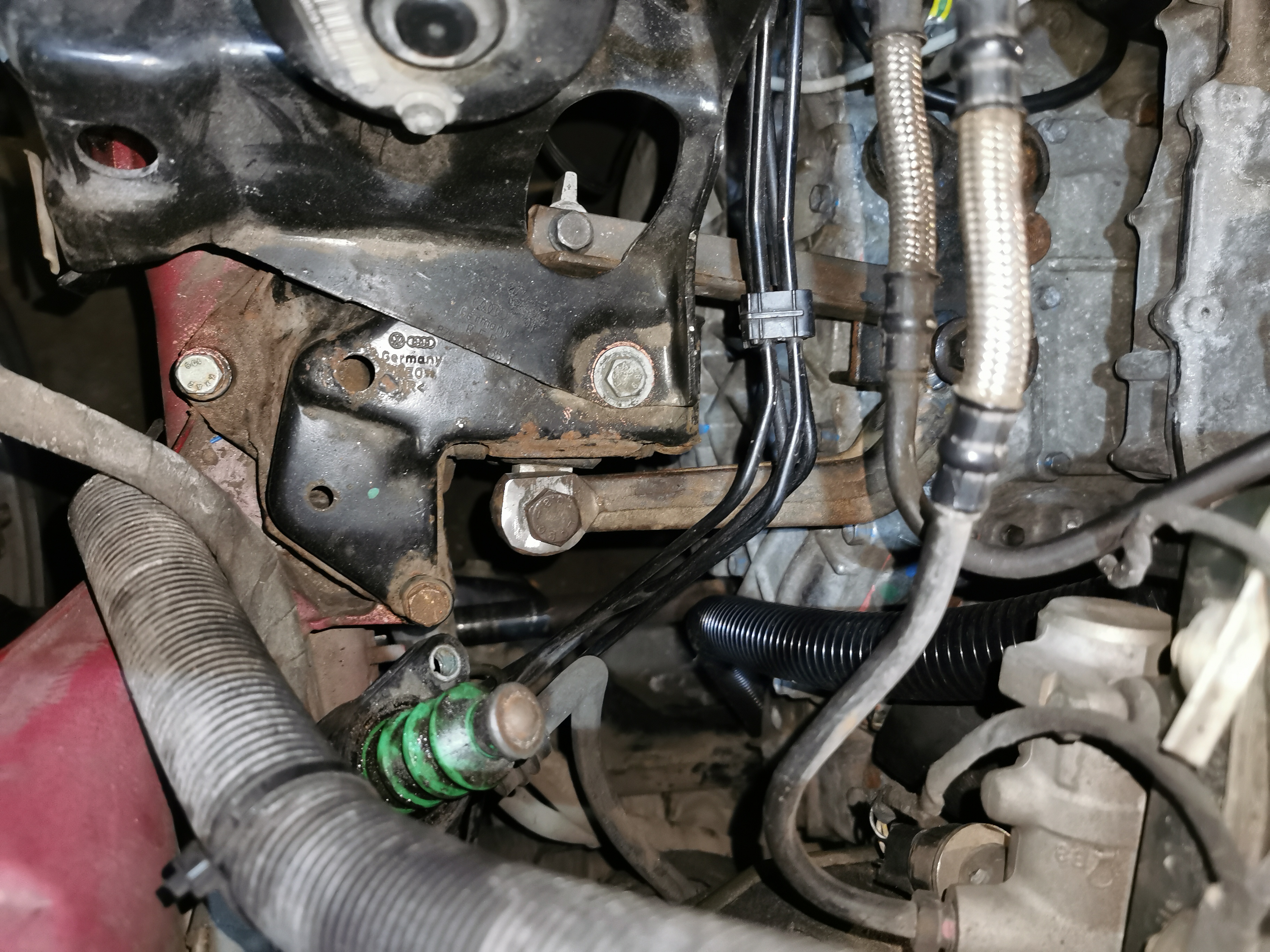

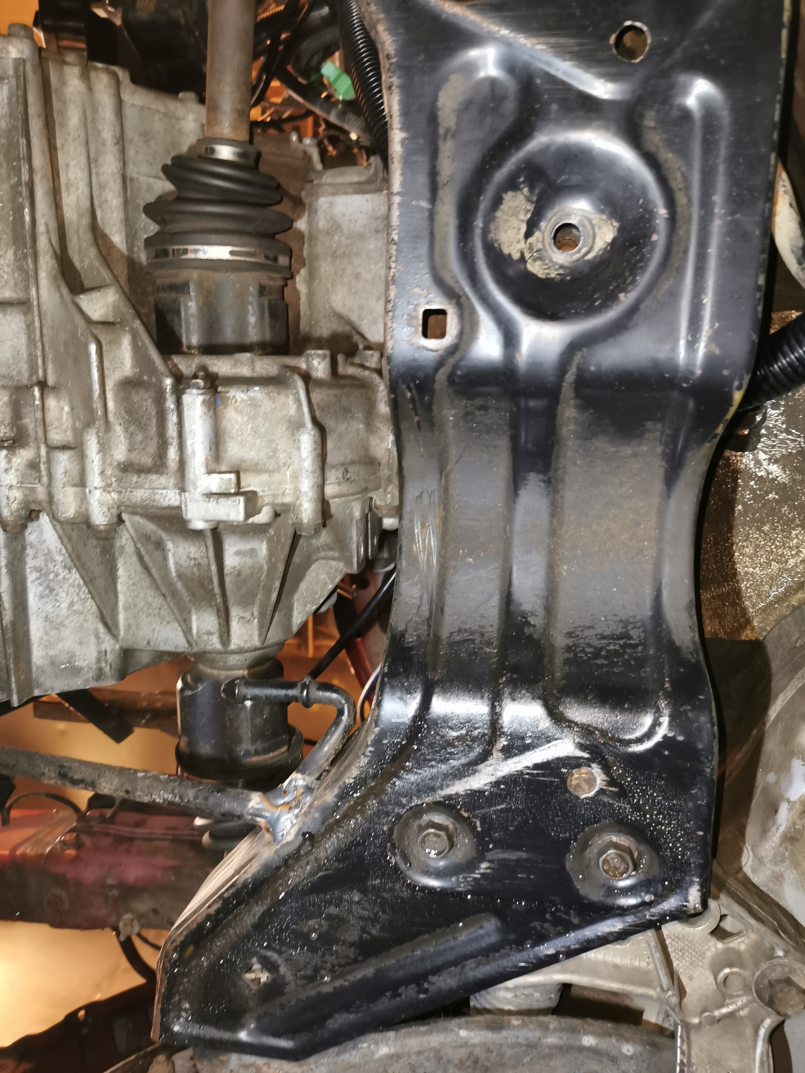

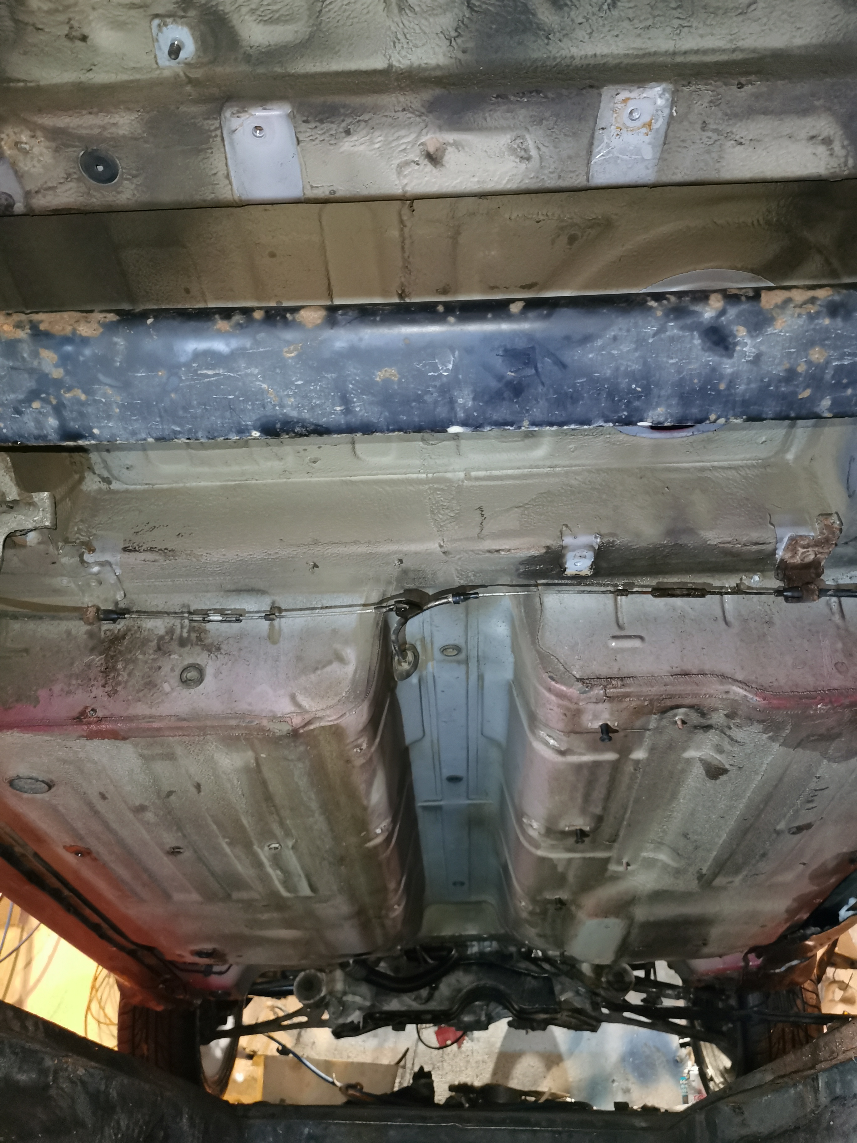

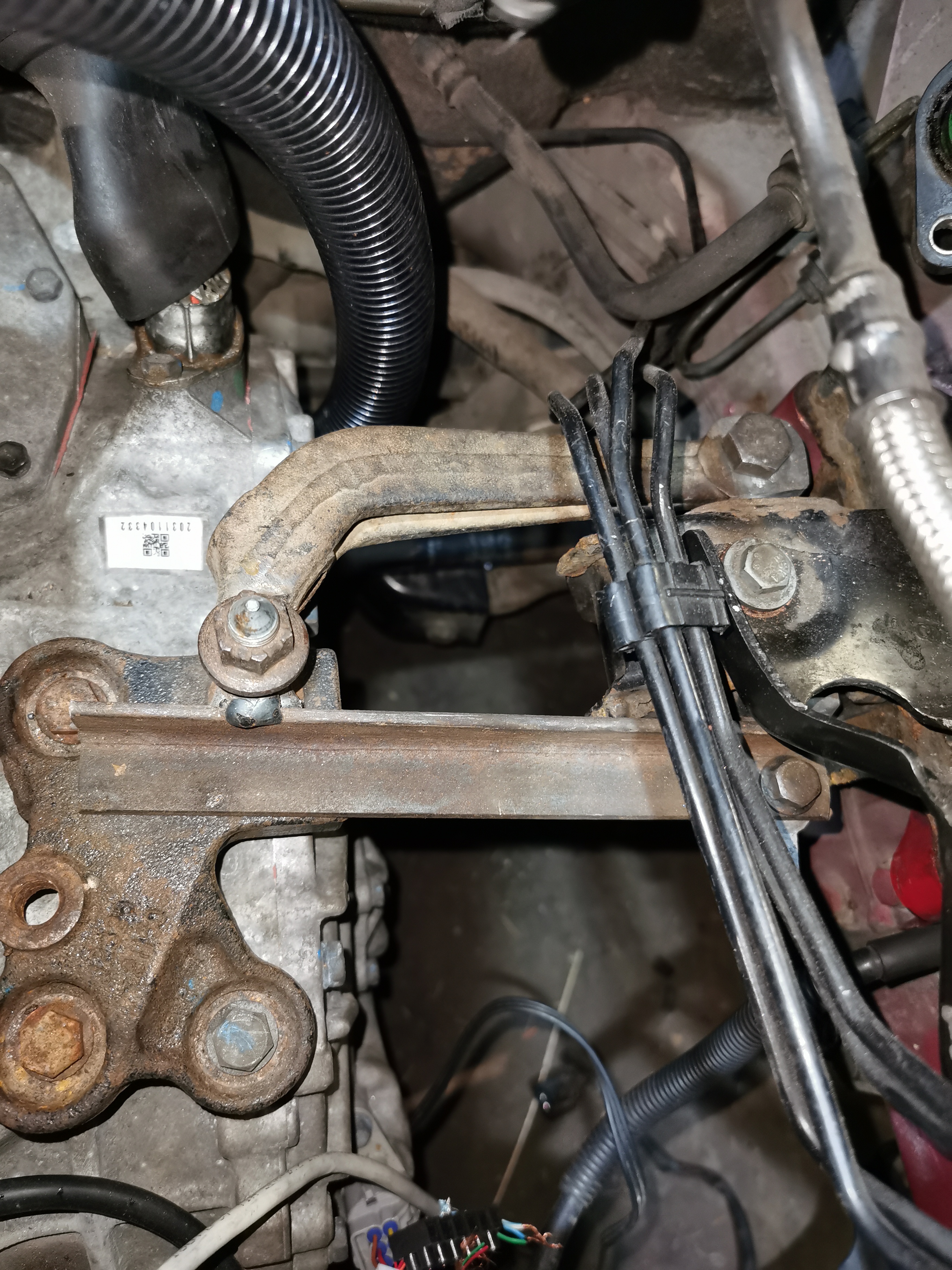

Some photos of mounting points

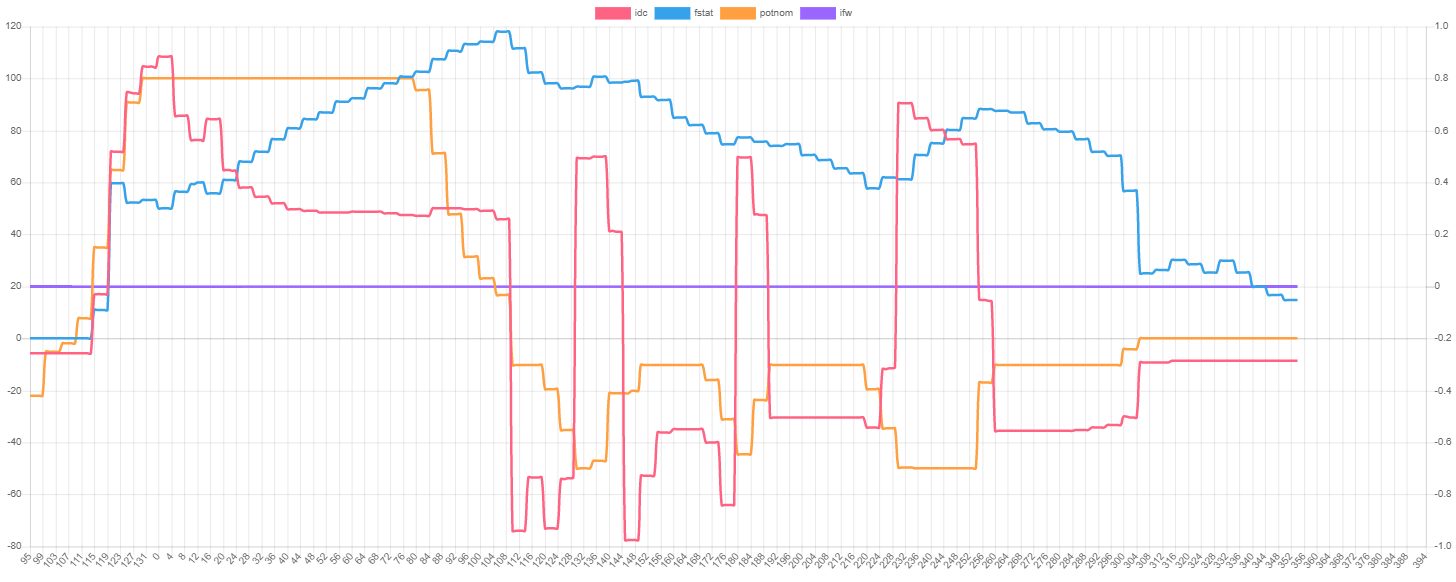

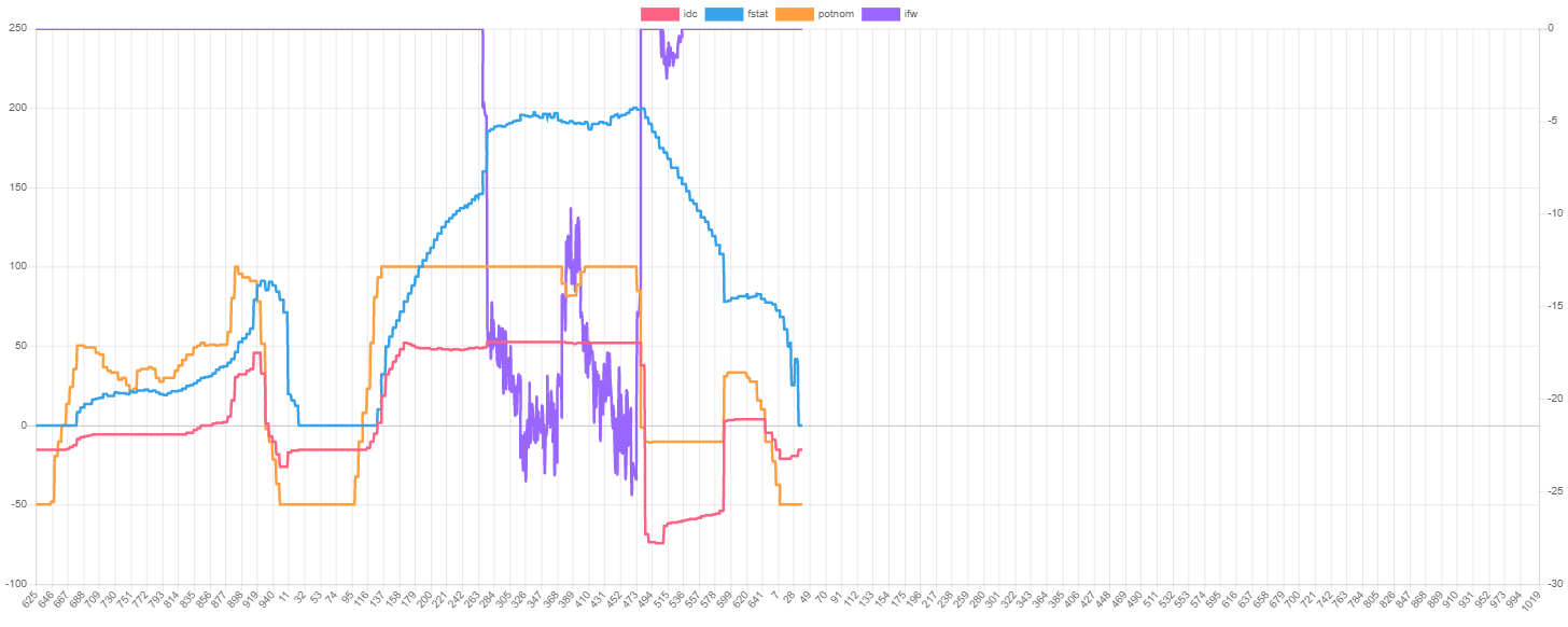

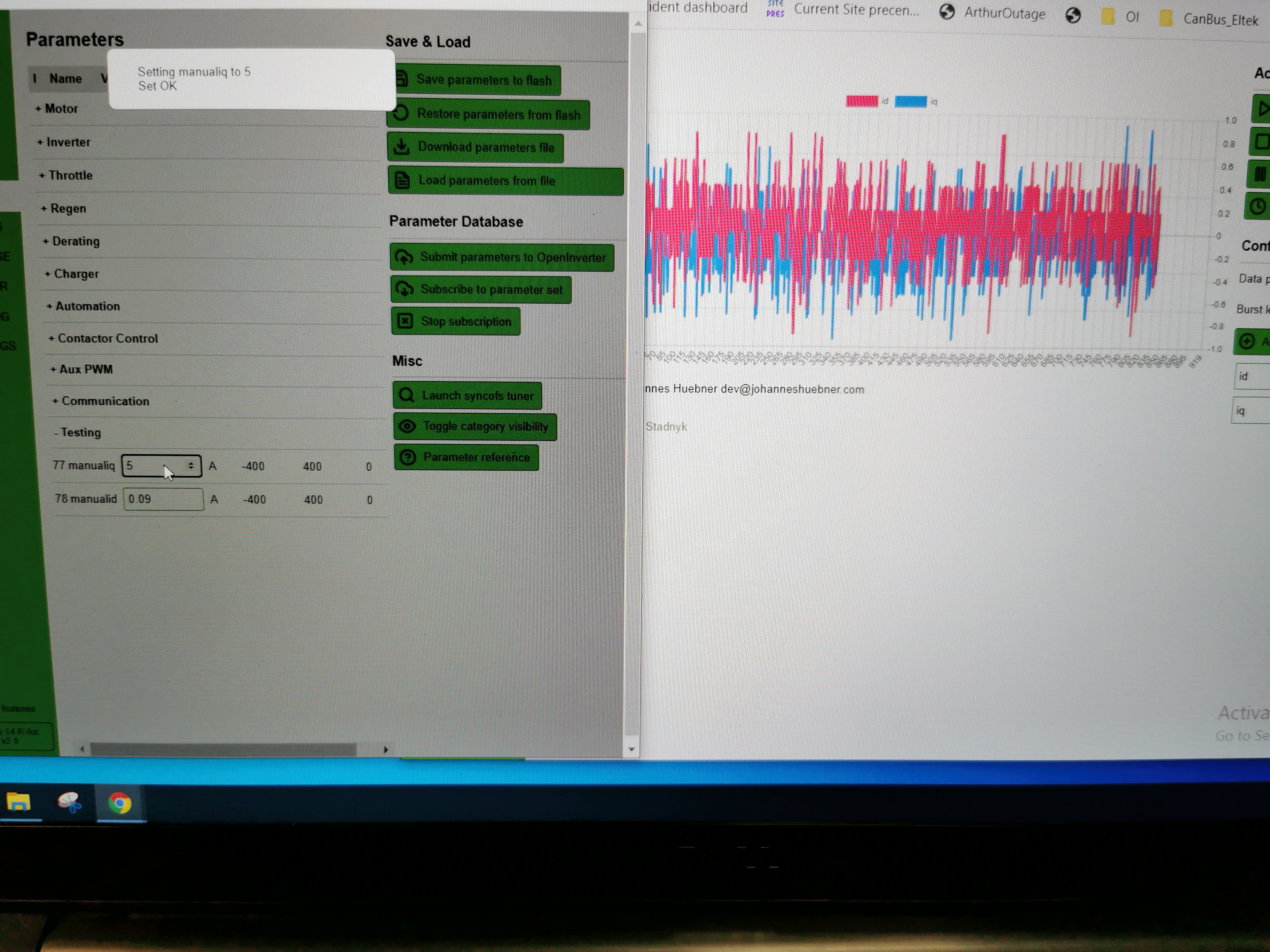

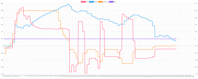

I had a chance to visit A2 today for some hours to make test runs. It is very difficult to do tuning when I hit many problems with tuning/system not responding as expected also not feeling brave enough to do many tests in live traffic..
1. Tried to retest syncofs and found that Manualid 0.1 and Manualiq 5 does not do anything... SW BUG? (Picture 3)
2. Driving and PRESSING ON BRAKE got me to accelerate! (Picture 2). POTNOM is negative!
3. Syncofset setting procedure. I can find different behavior as expected, said in instruction. Example SyncOfs 9000 with manualid 20 i get slow turn forward and with 120A fast turn backwards. so these manualid values overlap at same syncofs. what value to believe?
plenty of space for hood to close and air duct
Runaway on brake
Runaway on brake
Not spinning at manualiq 5
Can help you when I'm there. Yes with Wong syncofs motor tends to do silly things

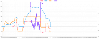

You mean acceleration on brake?
Also this was only visible when I make Throtcur more like 5A.
To have nice easy ride i put Throtcur 1A. If I put more it is almost impossible to drive on snow as it gets wheels to spin too fast.
Also I cant get past Fstat 200hz. it is set to 300hz.
PotNom is 100%, IDC is not rising and Fstat not rising. Where can be my limitations?
200Hz=~80Km/h
As this testing is almost impossible i am planning to bring it back to my living place. It will be 80km of driving. Still need to make cooling to be safe.

Some more tests. Went onto longer ride. Got to 100+Km/h. For more I believe I need more Volts. Freq is not rising. Tops at ~220Hz. Also Idc is not getting more that 50-60A.
Still not happy about unwanted regen on top speeds after letting the throttle. No regen is set for that. Only regen is foot on brake pedal.
Driving without cooling system. Did like 10Km at 100Km/h and saw Inverter temp going up to 40+C.
Power steering is not needed for such car. I can happily drive it without PS and save some battery juice.
Definitely points to an issue with the field weakening. If you come off throttle very slow it does not happen, right?
