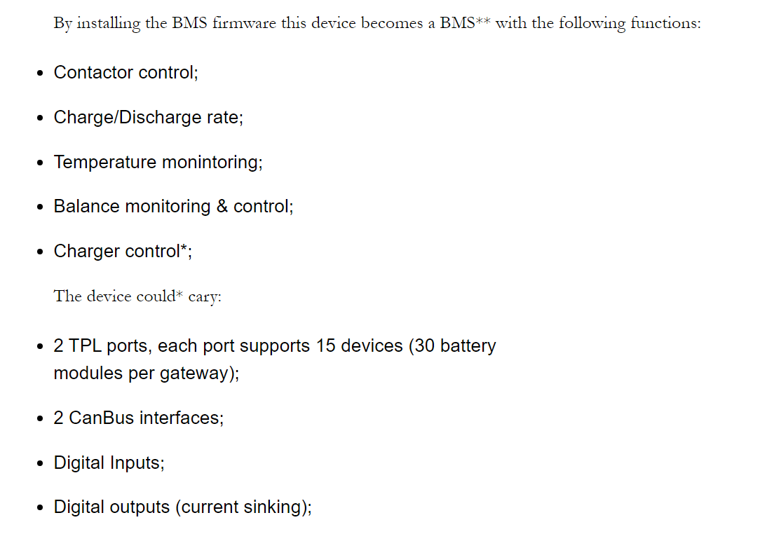

Hello every one! I just registered because of this thread:) Quick questions to you guys, as i'm planning to make DIY powerwall using Taycan modules. The plan is to make a HV (high voltage) pack in order to use HV inverters (like Fronius, SMC and others). The issue is all HV inverters need communication wiht HV battery and as far as i know most of them use CAN.
Do you know resources about Taycan battery packs? I can see 4 pins connector only and i saw only two pins need to be connected for communication (CAN H and CAN L?). Are the daisy chained together to get module status info of all daisy chained modules? I plan to use two battery strings (some inverters allow for that) so it will be i.e. 2 x 18 battery modules. In this case each string will be independent so each string needs its own CAN comm module to talk to its batteries and to talk to inverter.
Is your board suitable to gather cells infos and trigger balancing ect. of Taycan modules?
How about NXP board? I can see here:
it's working with Taycan module, however i don't know if it can retrieve info from many modules connected in daisy-chain fashion.
Regarding connecting batteries together: is it the reason the header has 4 pins? Two for incoming CAN bus and two for output CAN?

Re: Remote IO / Taycan CMU Master for Zombie VCU / SIMP BMS
Read his product page I already pointed you to on youtube.
https://wdrautomatisering.nl/product/cm ... 4_gateway/

Yes; it is!
@tom91 thank u
