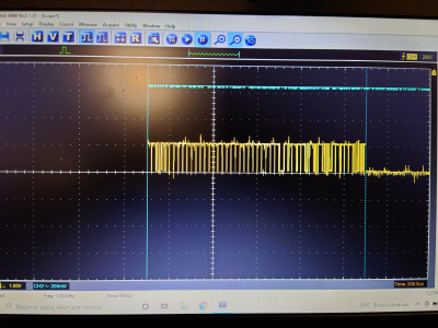

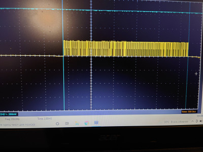

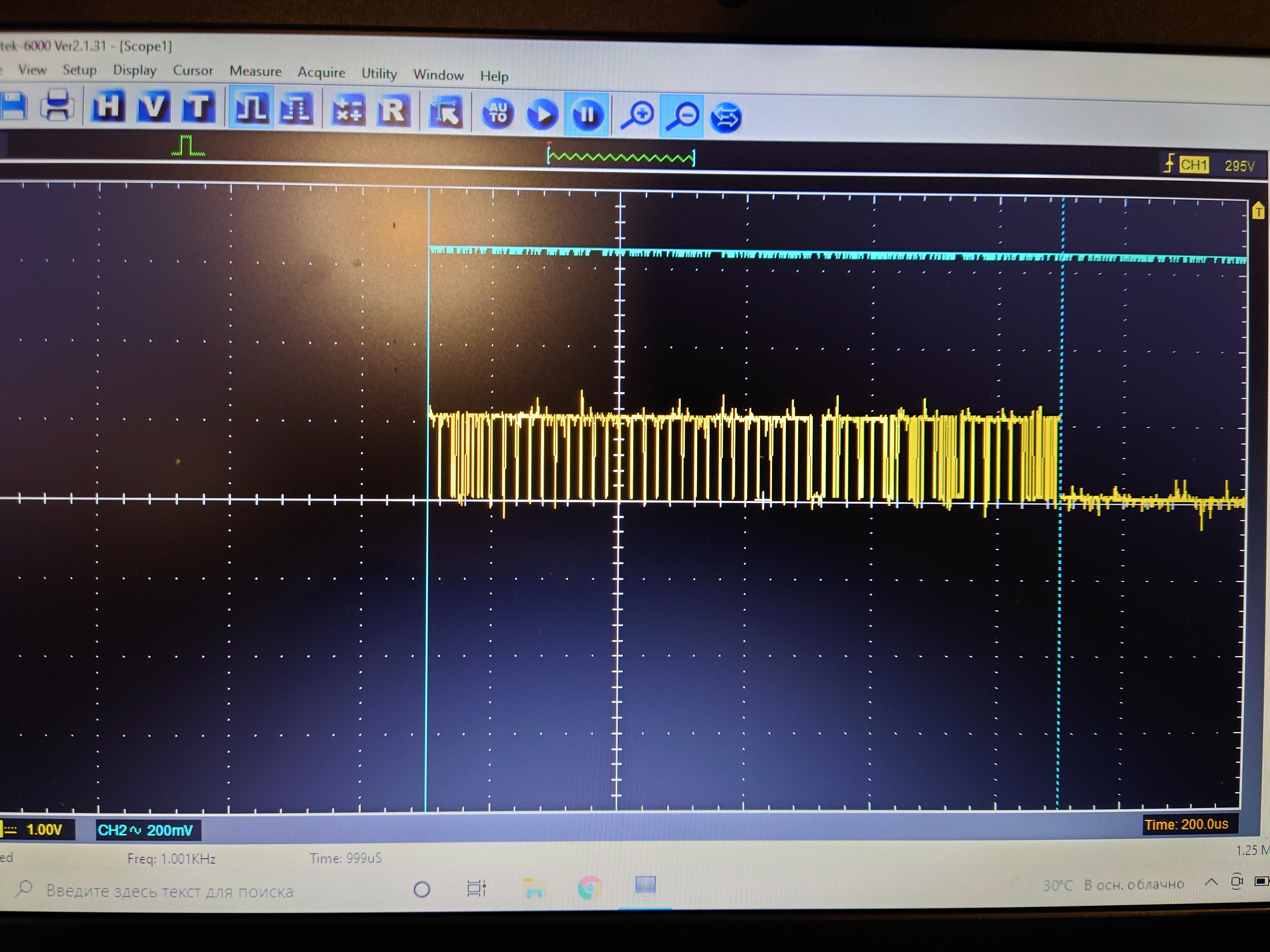

Re: ZombieVerter VCU Support
I've captured the MTH pulse with a good scope.
My GS450h gen1 inverter has 1ms length of the packet.
and Camry AVV50r gen3 (2012+) inverter has 2.8ms length of the packet.
I don't know how to count the length in bytes yet.
GS450h inverter is transmeeting with the VCU well, but it can't run the L210 gearbox (2012+) right way. Something like syncofs errors or resolvers misunderstanding = jerky moves etc.
Camry gen3 inverter has no transmeeting data with the VCU both in "GS450h" and "Prius gen3" modes.

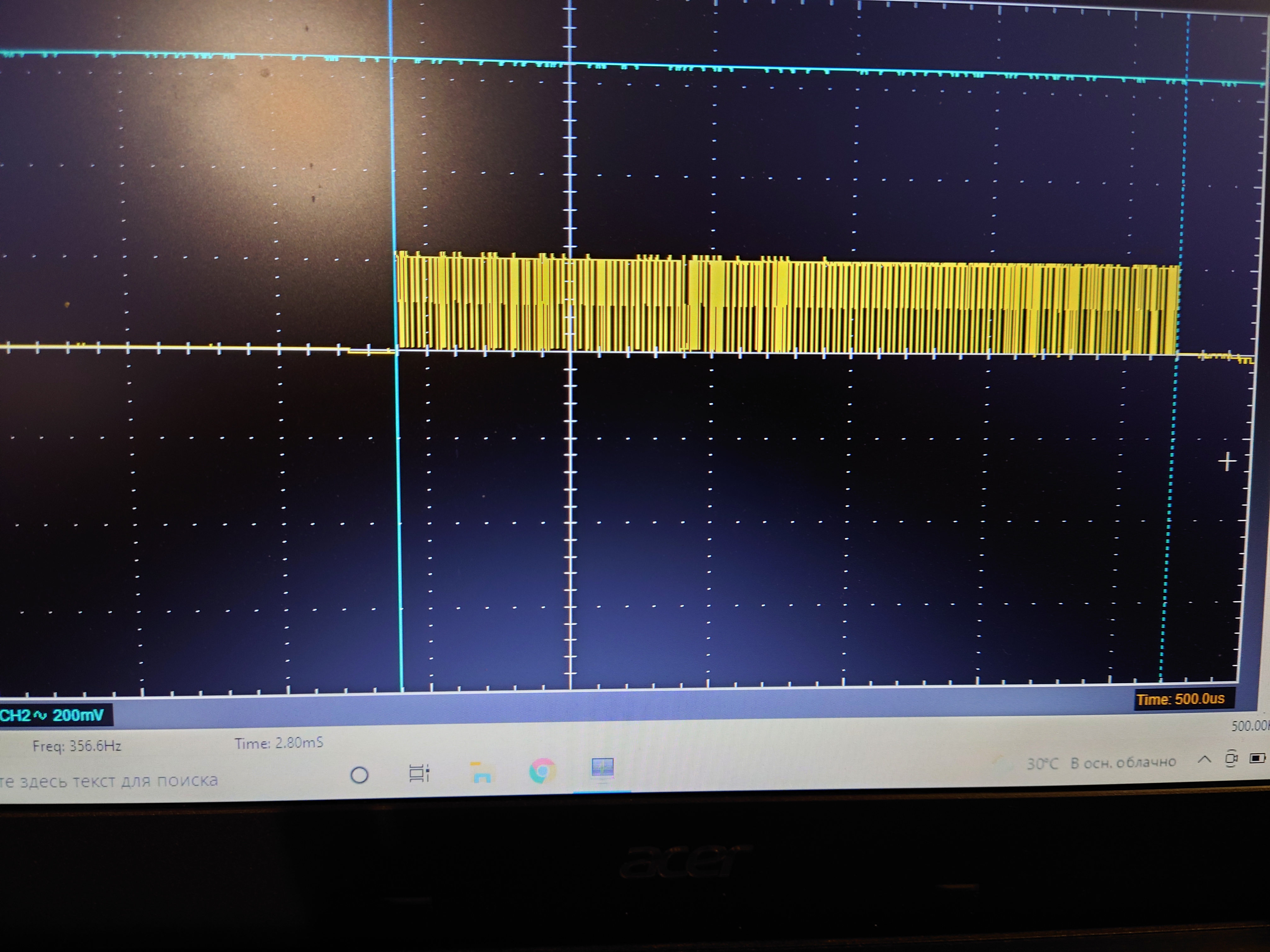

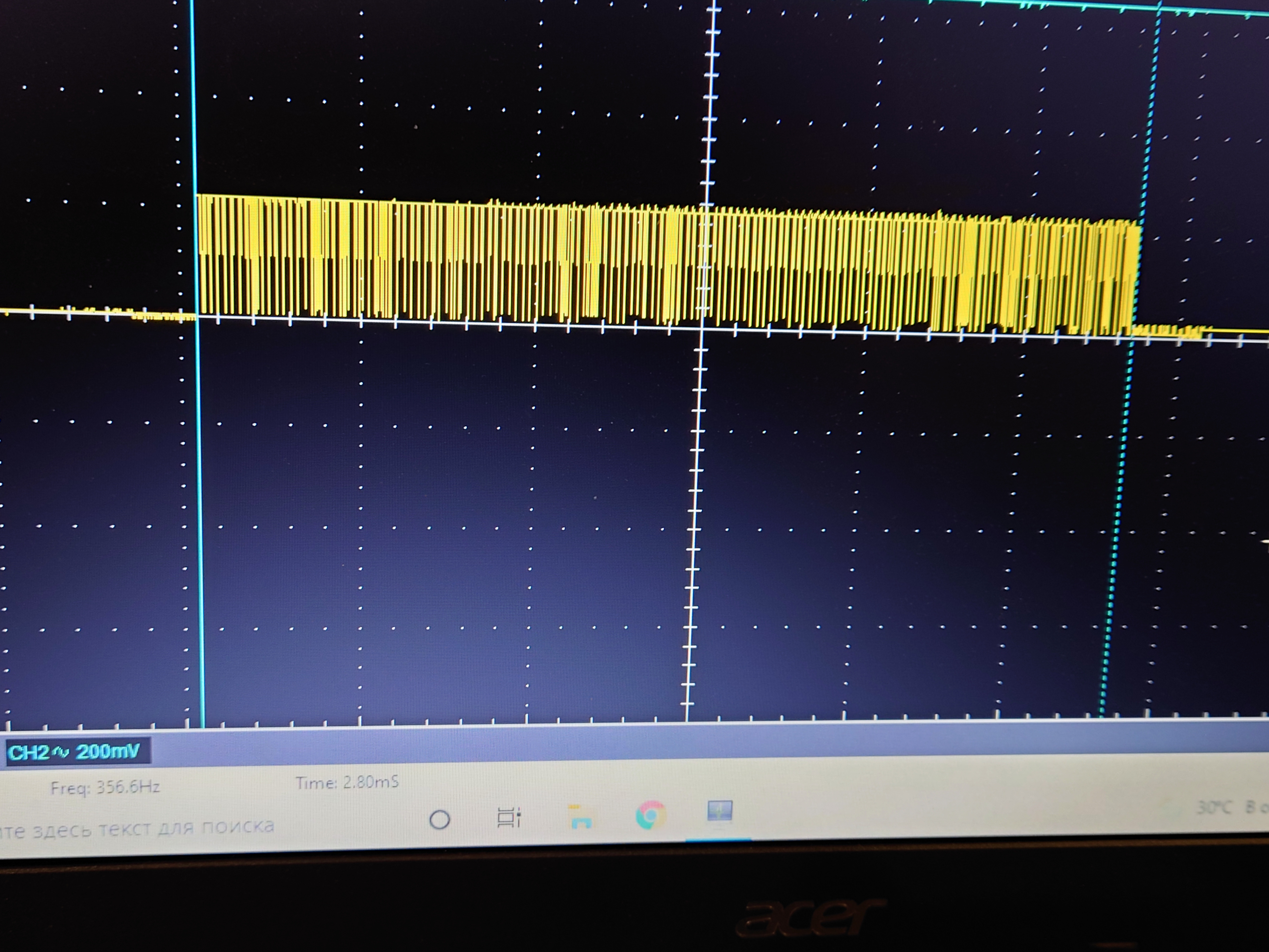

And I've also captured the MTH pulse from Aqua NHP10 inverter (G9200-52010 Gen3).
It has 2.8ms length of the packet again and no transmeeting data with the VCU in "Prius gen3" mode.

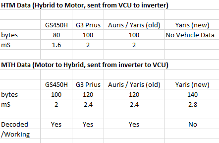

For reference I'm keeping a spreadsheet (will add part numbers) of the different frame sizes to expect. I will be adding these to the WIKI page:-
- HybridFrameSizes.PNG (11.1 KiB) Viewed 15848 times

The newer Toyotas seem to have these longer 140 byte mth frames. I have verified that these have the standard checksum etc...
We also believe that the htm frames have increased in size too, but we have no proof of that yet.
Possibly Toyota have standardized the frames across models, so increased the sizes possibly for 3 motor variants etc....
