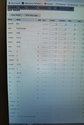

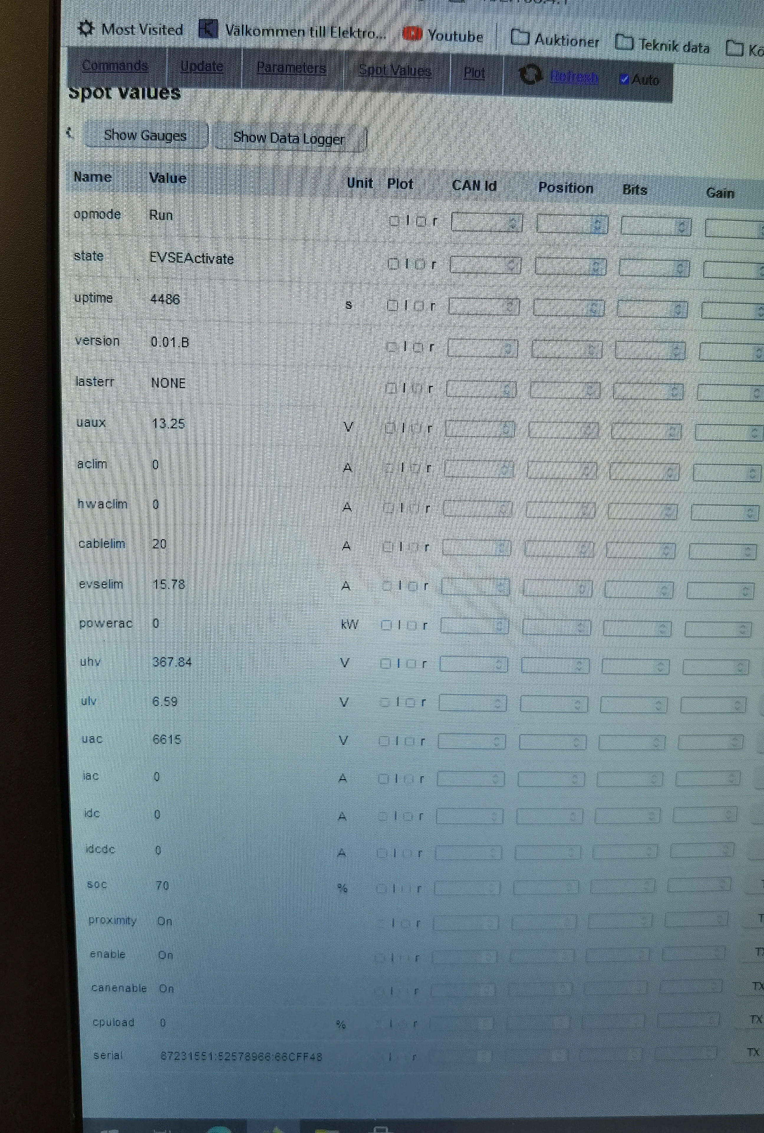

Everything wired up according to the pinout supplied at first post.
Can't get any pcs values from Web interface, connecting and logging in went great
I have selected eu version,
Is there any more changes to get things working?
Got 5v at pin one and pcs is mounted in penthouse,
Also got 13v at pin6(pcs-enable) with or without communication cable connected.
Attached a picture of my pcs:
My pcs controller came presoldered so this is my first test,
3v3 led is on and the other one is flashing.
I have also solder for external can but that's not yet connected.

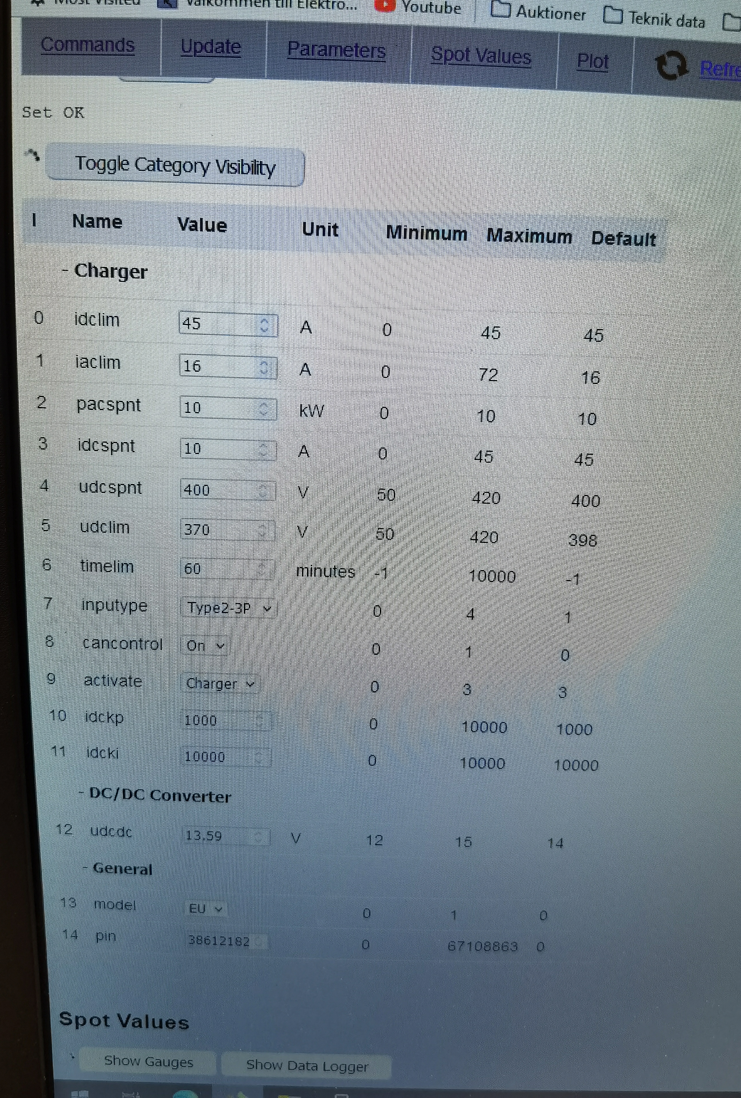

Edit number 2: After some experimenting i got the dcdc charging to work, works perfekt.
Now got ahead trying with controlling via canbus, Read the manual to gen 2 controller, but it seems that can message is shifted a bit.
0x102 b0: 0x0 b1: 0x78 b2: 0x1 b3: 0xA (idcspnt 10A) b4: b5: 0x1(enable) b6: 0x46(soc 70) b7: 0x0
Bit 1 and 2 results in udclim @ 376vdc
When enable Di1/Input 1 and can enable i got my smart charge adapter to apply 400vac 3phase.
Proximity: on enable: on canenable: on
The only thing i get really confused about is the parameter: uac, it is around 6600V
Think i have read everything on wiki but i don´t get it to work, anyone else that got it to work, besides Damien? =)
Another thing i read i the manual, can it be so simple that my unit not are registered correctly and my 5 minutes of charge is finish? i did buy a "full" kit

Did not get my EU pcs to work correctly yet...
Is there anybody that got things going as planned?
The problem may be that the multiplexing canbus is wrong.
I still got around 6000vac when evse enable 3phase.
Otherwise the most of parameters seems to be correct
I did buy an extra charger from a Mitsubishi in the mean time to get things going
Best regards Fredrik

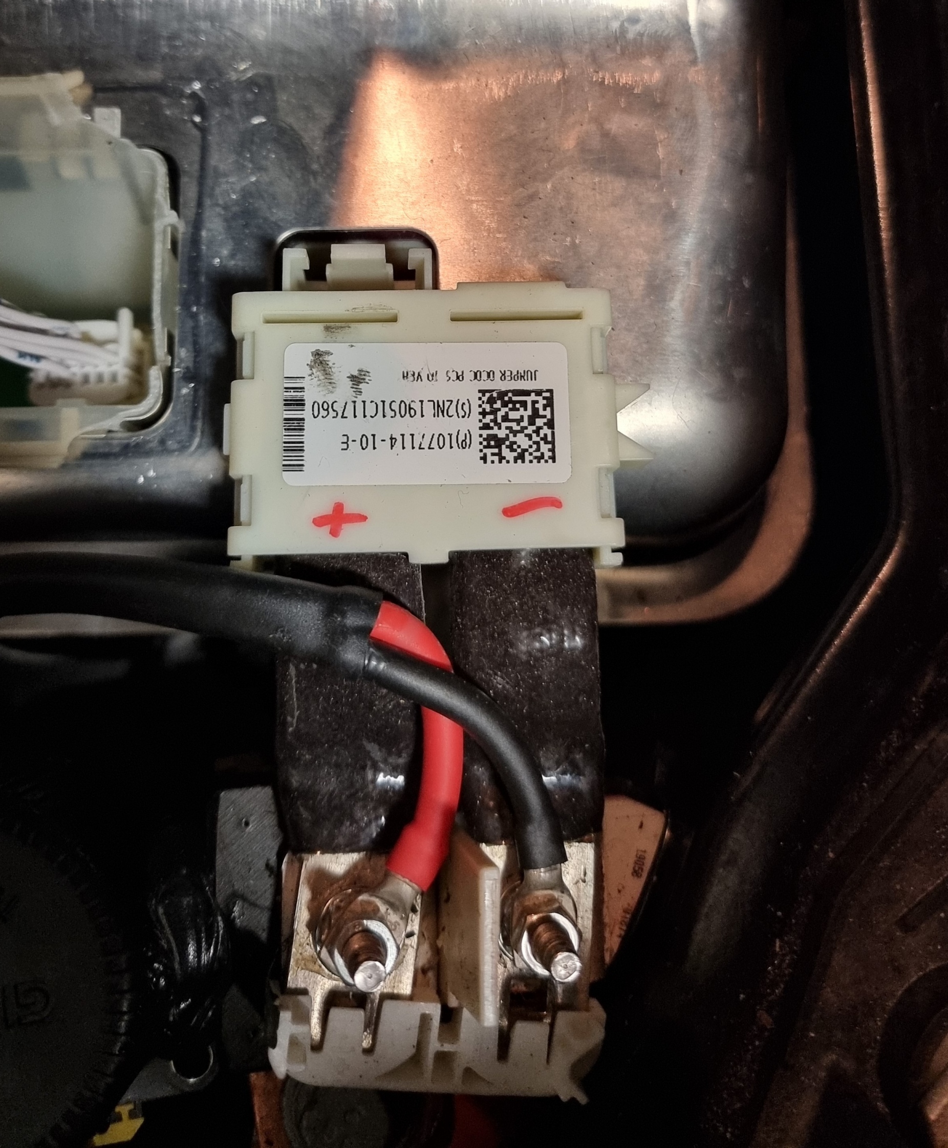

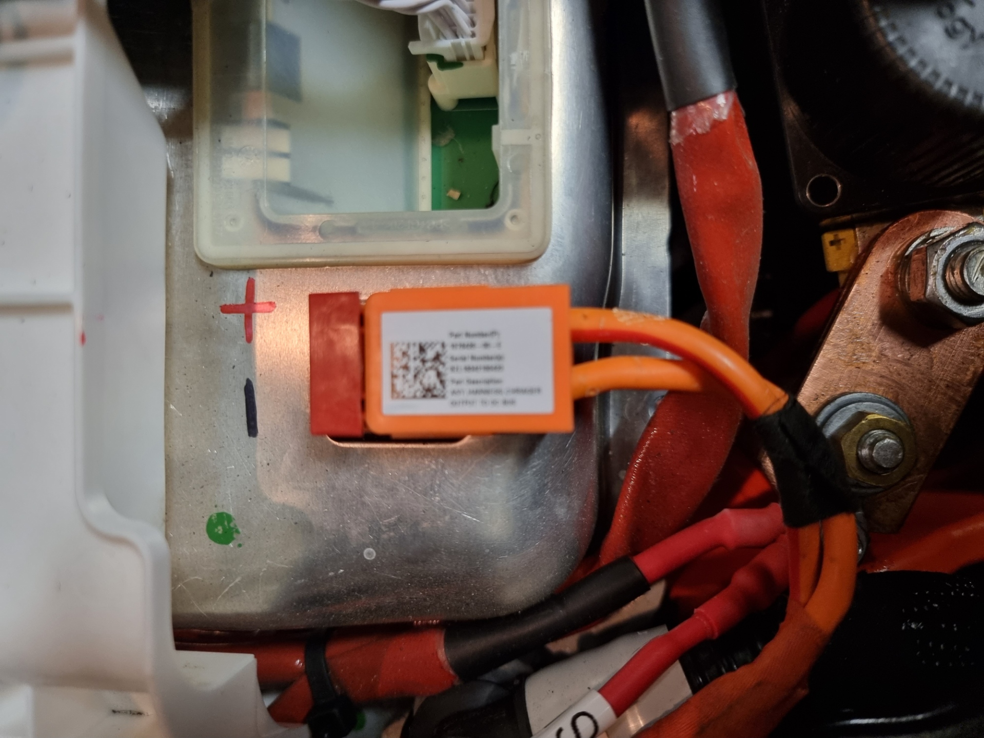

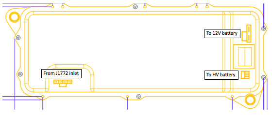

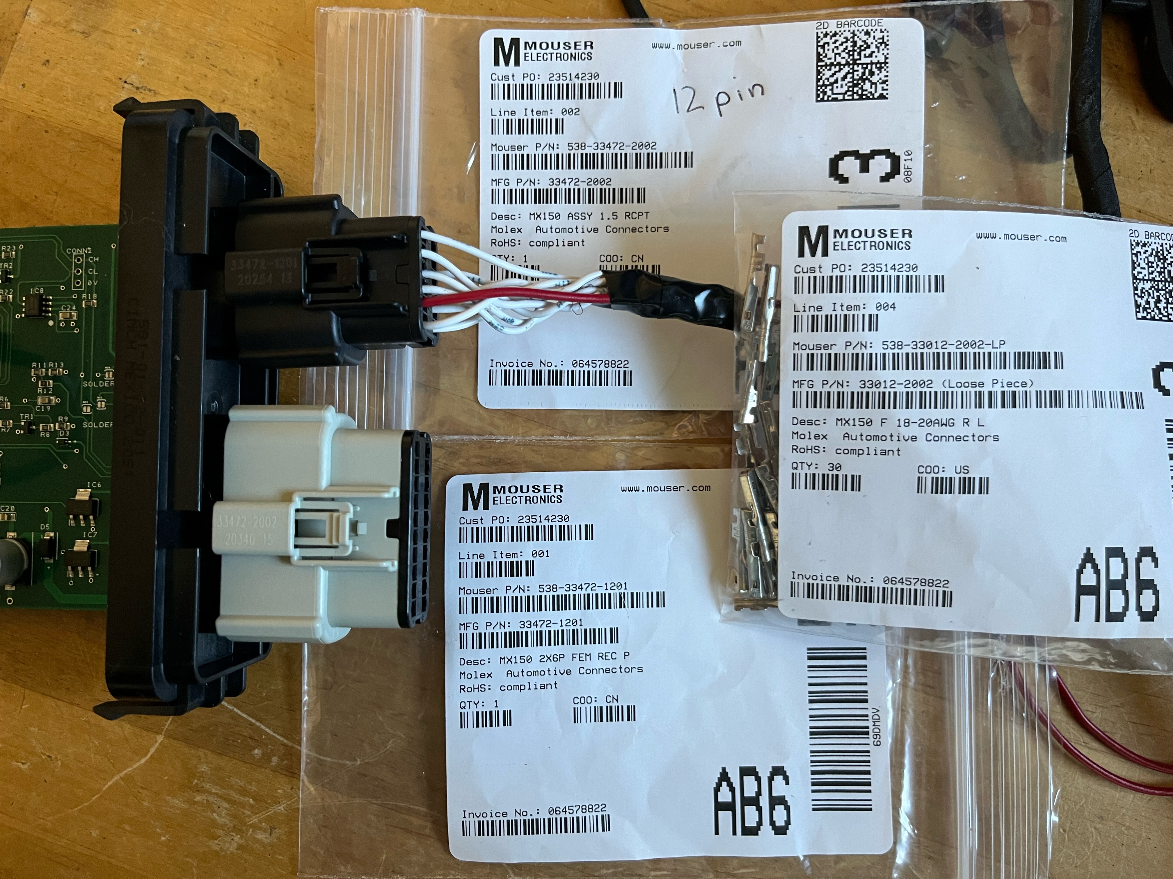

Can someone please clarify the polarity on the J1772, HVDC and 12V connections on the PCS?
I'm using a US Model 3 PCS.
In exchange here's the info on the PCS controller connectors and terminals. Connectors already come with seals.
Thanks in advance.
12pin connector:
Molex 33472-1201
https://www.mouser.com/ProductDetail/Mo ... C56Q%3D%3D
20pin connector:
Molex 33472-2002
https://www.mouser.com/ProductDetail/Mo ... S35ttbg%3D
Terminals
Molex 33012-2002 (Loose Piece)
https://www.mouser.com/ProductDetail/Mo ... 5LpA%3D%3D
Thanks in advance.
12pin connector:
Molex 33472-1201
20pin connector:
Molex 33472-2002
Terminals

I also have this question. Can anyone provide the HV pinout for the PCS?
Hello here is some info
3Phase Connector LVDC Connector HVDC Connector (Plus connector via 63A 600vdc fast fuse)

Alright so I've got my PCS wired up and no luck yet. Question: Do I need to change the PIN setting, and if so where do I find what my PCS needs?
Do you use software from Johu or Damien?P.S.Mangelsdorf wrote: ↑Sat Dec 11, 2021 7:34 pm Alright so I've got my PCS wired up and no luck yet. Question: Do I need to change the PIN setting, and if so where do I find what my PCS needs?
Have you followed the pinout in pdf at page one of this thread? I did my work on an original batterypack so i got the original cable with markings on each line.
Seems like the US and EU version got the same pinout.

Yes I have the correct wiring.fredd90 wrote: ↑Sat Dec 11, 2021 8:40 pmDo you use software from Johu or Damien?P.S.Mangelsdorf wrote: ↑Sat Dec 11, 2021 7:34 pm Alright so I've got my PCS wired up and no luck yet. Question: Do I need to change the PIN setting, and if so where do I find what my PCS needs?
I'm not referring to the pinout. In the web interface, under the Version heading, there is a setting labeled PIN with a string of numbers. Does that setting need to be changed for each PCS?
