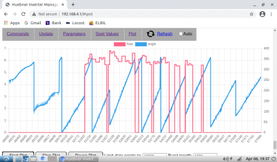

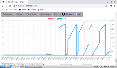

I did find something else which I don't understand. Why does fstat go from 0 to 5 in one step, can't get anything in between. I can get the car moving but 0 fstat. Could this have effect on stuttering at very low speeds?
- fstat on the left and angle on the right
Also, there are some disturbance noticable on angle at least when I drive slowly, seen in above picture as well. Hard to see if I go any faster.
A note on having averaging over more than one switch pulse, this could lead to instabillity as you can have changes in output without correspoding change in feedback signal. In this case there is only a small overlap so should be ok for testing.
EDIT: added one more plot to better illustrate the jump in fstat.
Above fstat 5 there looks to be any value possible.

frequency calculation happens every 10ms. But only if the rotor has moved more than 10 resolver degrees within 10 ms. By my calculation it should pick up at 2.7 Hz but maybe I forgot something. fstat is used in a few calculations, like regenramp and dynamic integral gain. But since you already tried disabling the latter, it's not that.
