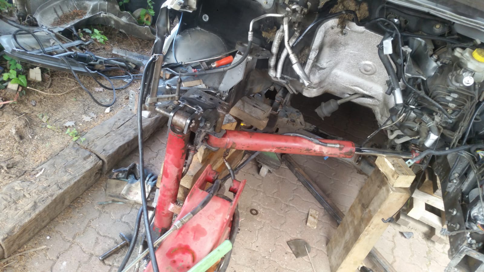

Posted: Sat Apr 03, 2021 10:14 pm
by tollerteppich
Hello
I wanted to keep you up to date about my conversion.
First I disassembled the front axle because everything was badly rusted.

I had some time again to continue working on the project. Now the straightening of the body was on the plan.
At first I pulled the beam with a 1.5 ton chain hoist. This direction alone was not enough. i then fetched my excavator, dismantled the arm, and welded a massive bracket around the beam and attached the hydraulic cylinder to it.
the whole fun lasted a day the straight pulling 30min ...
Most of the time is spent building tools ... XD
