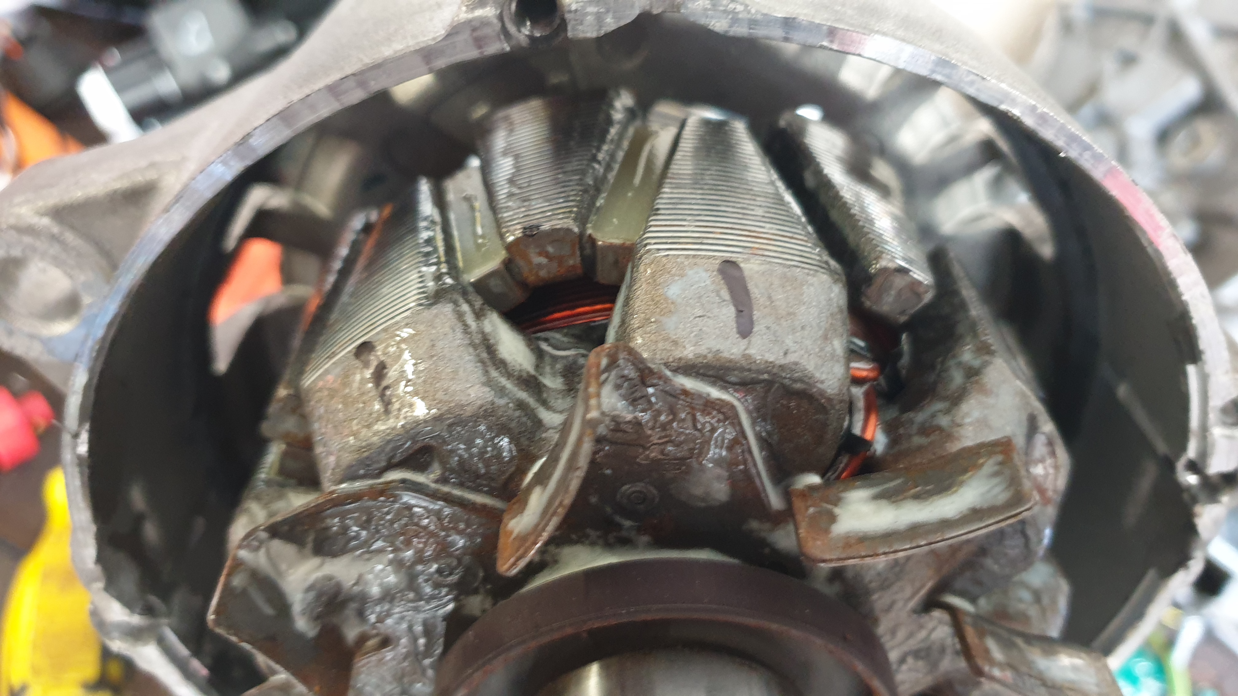

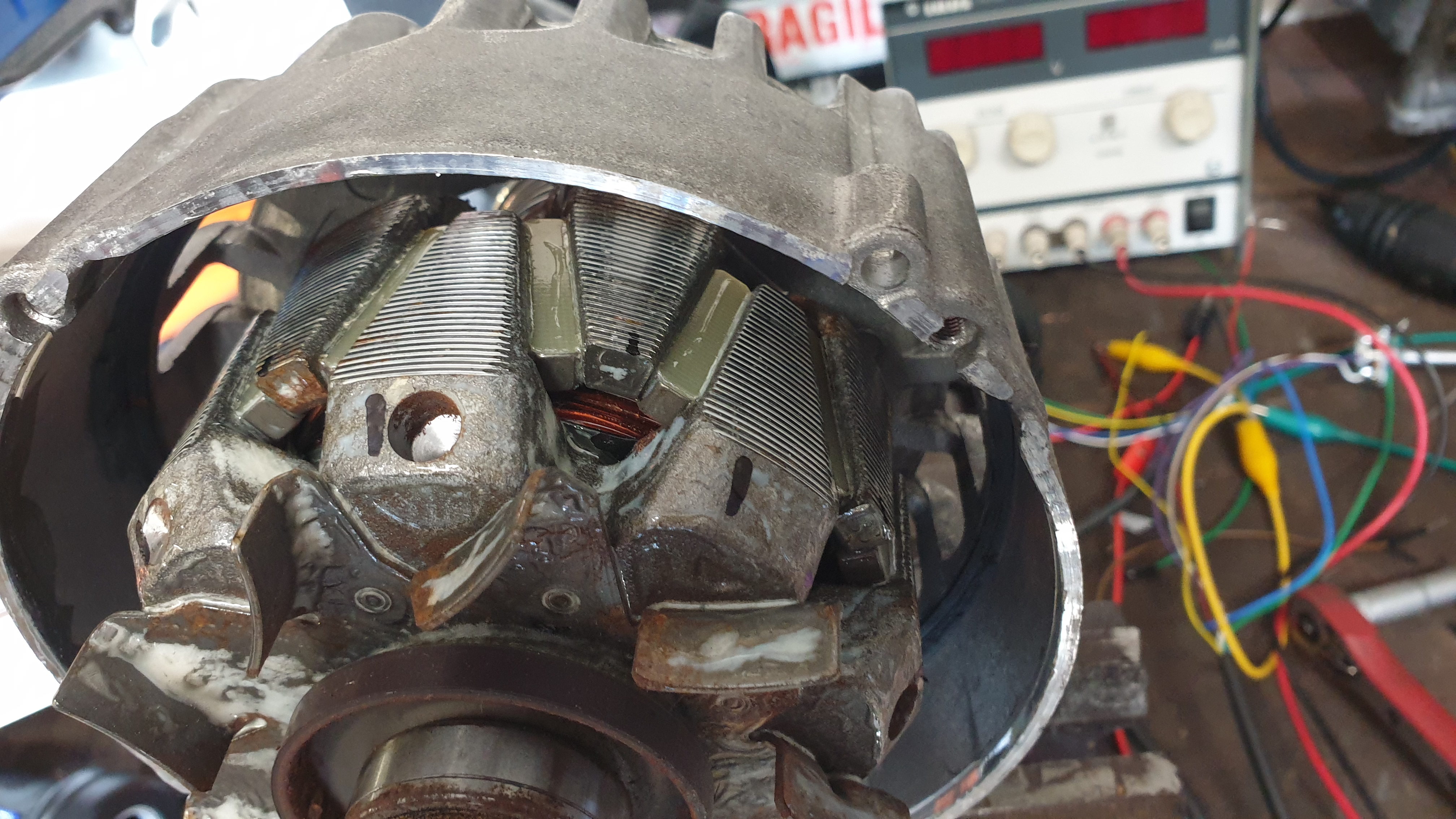

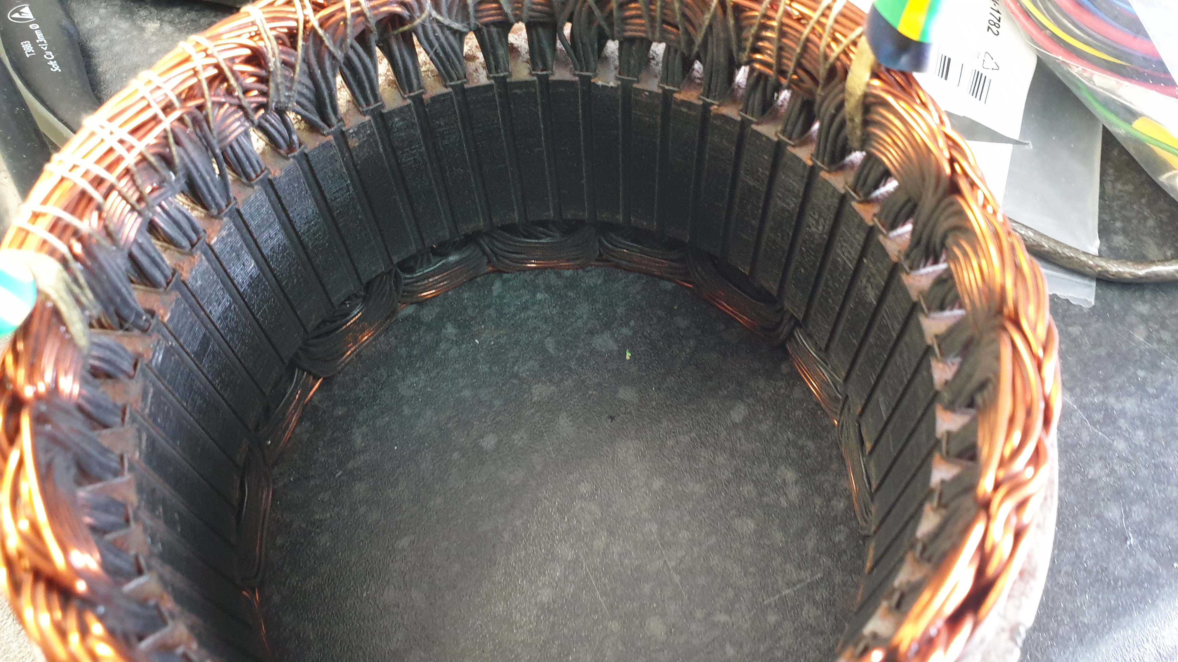

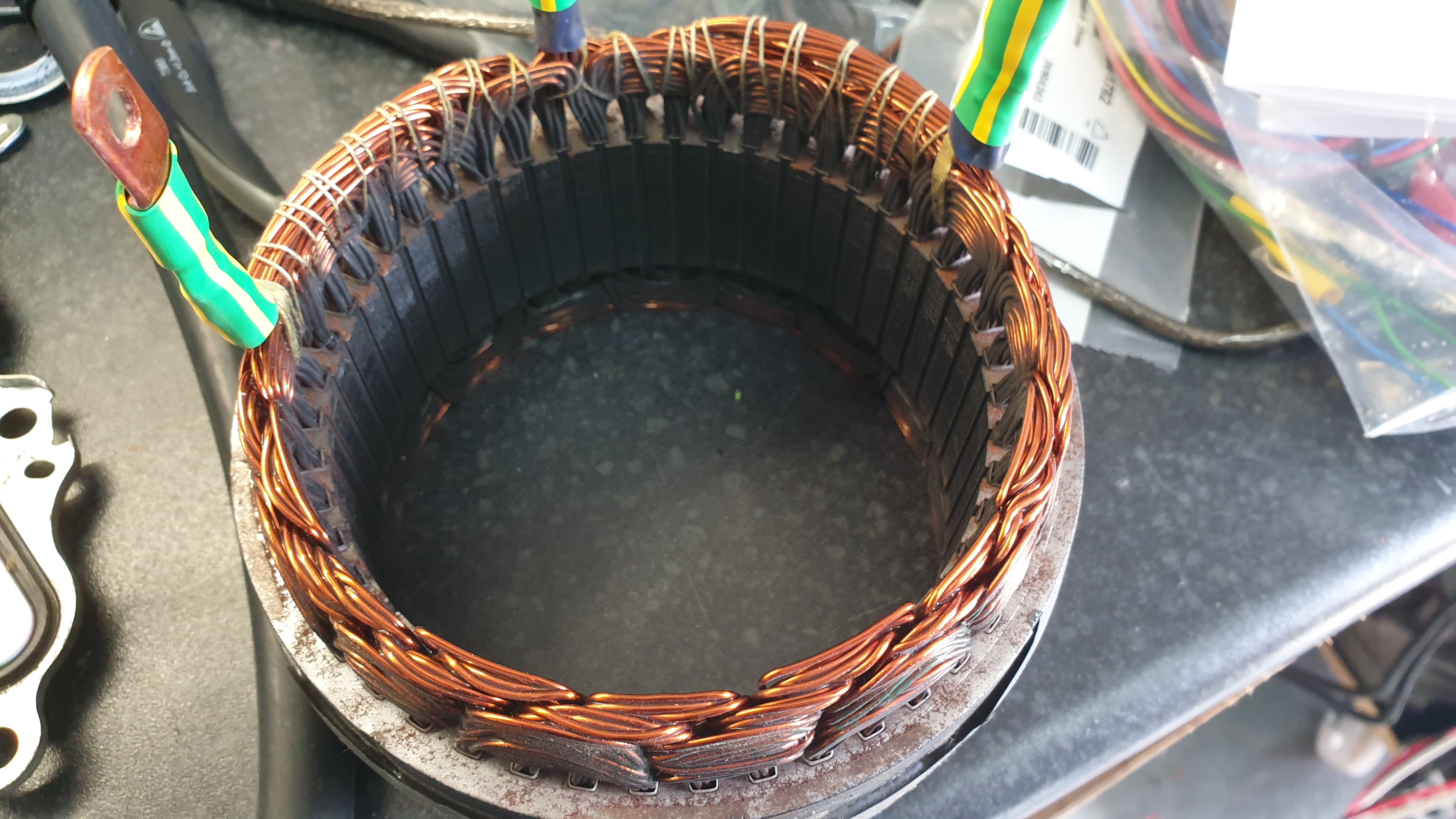

Posts: 3999
Been thanked: 1114 times
Re: '13 CRF250L motorcycle
Pulled the istars apart for a look. Most interesting thing seems to be much finer stator lams and bar magnets in between the poles of the rotor.
mjc506
Posts: 343
Has thanked: 30 times
Been thanked: 29 times
Post by mjc506 »
I keep trying to count the poles and keep losing count :-)
Strange rotor, bar magnets not in all the gaps? Or did you remove some? My rotor has no magnets, but does exhibit some residual magnetism.
Posts: 3999
16 rotor poles. 2 slots at oposite sides have no bar magnets.

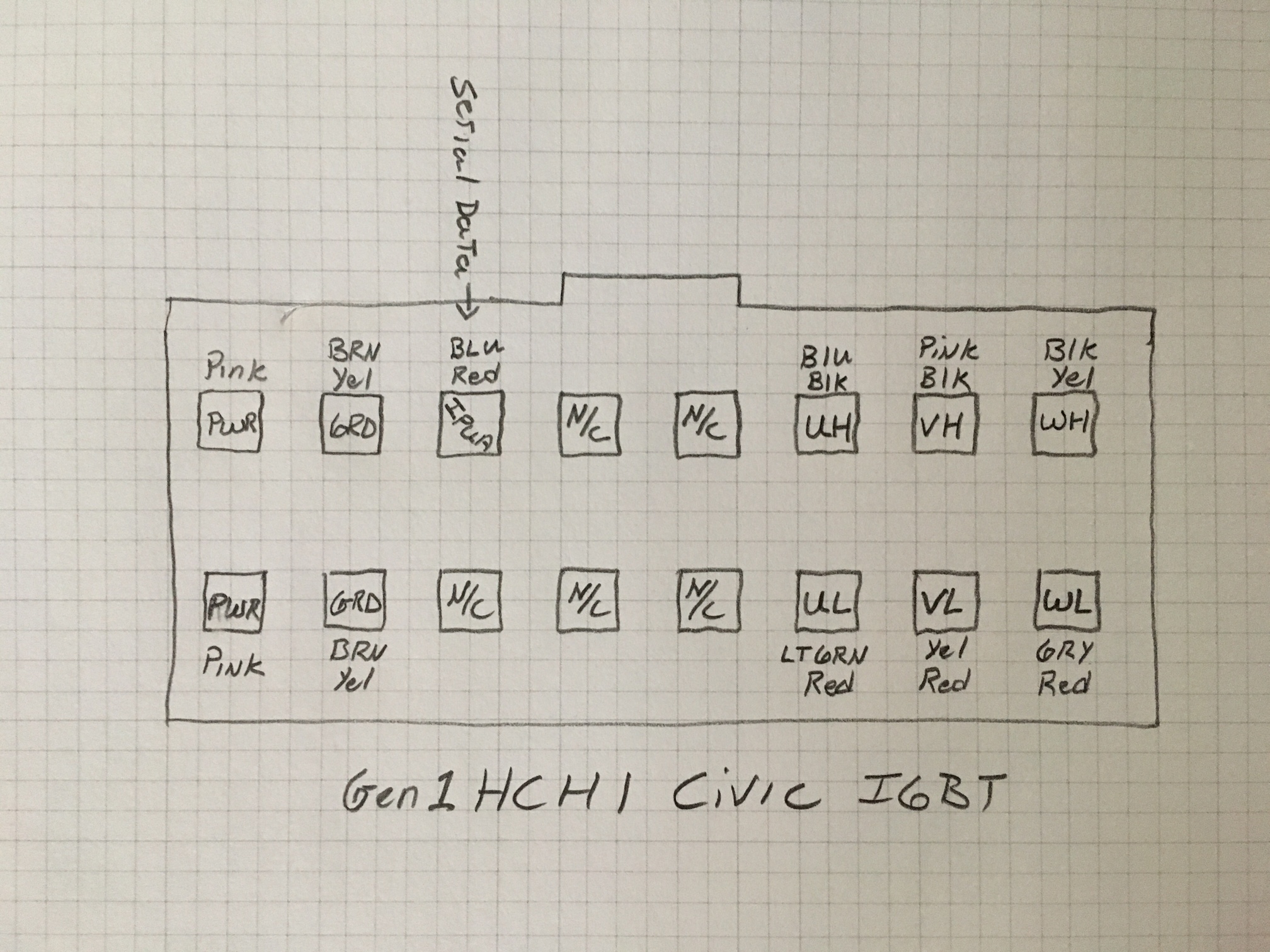

Would you mind sharing the wiring info for the honda ima or what gets hooked up where to the driver board. I have a spare insight mdm or whatever want to call it. Would like to get it spinning something outside of a car.
Im on the insight forum and have searched snd yet to find the pinout for the igbt or its controller
Mouse
Posts: 142
Location: Wales
Been thanked: 9 times
Post by Mouse »
slociviccoupe wrote: Sat Mar 26, 2022 3:27 pm ...what gets hooked up where to the driver board.
I've got this pinout for the standalone IGBT you're got from https://www.diyelectriccar.com/threads/ ... ut.183690/
I've successfully controlled one from an arduino with direct connection from the arduino pin out to the UH / UV etc pins.
PWR = 12V feed
GND = Ground
IPUA = Serial feed of things like IGBT temperature and HV bus voltage. This has been hacked but I dont have it to hand.
UH, VH, WH = High IGBT feeds 5V logic compitable.
UL, VL, WL = LOW IGBT feeds 5V logic compitable.
The colours are relating to the main connector loom to the IGBT module.
If you're getting into the later self contained unit this is a valuable document from diyelectriccar,com about where you need to tap into the main PCB for control of the IGBTs.
Honda_IMA_Rev_Eng.pdf
(1.78 MiB) Downloaded 364 times

slociviccoupe
Posts: 34
Joined: Fri Mar 25, 2022 10:29 pm
Post by slociviccoupe »
So this is the hch1 igbt can the gen 1 insight igbt be driven similarly or does it need the mcu with it. Ive tried google searches and even on insight central. I cant find anything for the gen 1 insight igbt. If i have to ill get a hch igbt.
slociviccoupe
Posts: 34
And do you happen to have your info of an arduino or an stm32 running a honda igbt. Im just tinkering trying to get a prius compressor to run on my insight since i have the pack for it. I have a honda compressor controller on the way with the accord ima motor but seing what i can do in the meantime.
