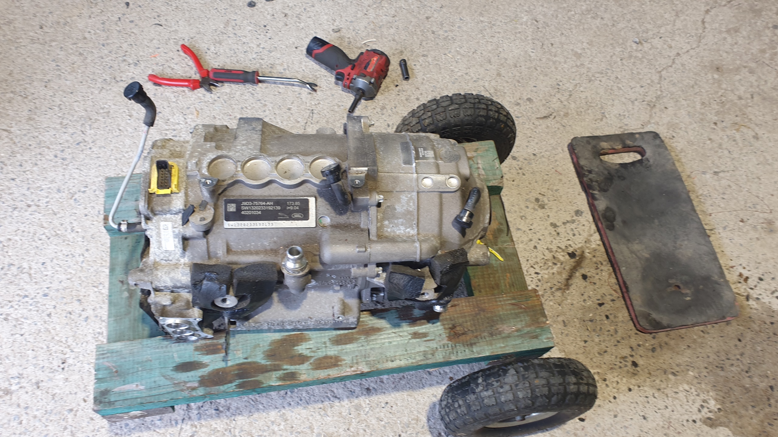

Looking at the I-Pace parts catalogue - the same part numbers listed against the front and rear inverters. Looks like the latest OE number for both front and rear inverters supersede to:nkiernan wrote: ↑Sun Aug 08, 2021 5:10 pm I know there have been a lot of other projects on the go so the big cat project has been on the back burner. In the last video there looked like good progress on the inverter reverse engineering and the next step might have been some test drop in boards. Wanted to check if there were any test boards in the end or if the new Zombieverter has any relevance to these? (I'm presuming the project got paused just before this)
I've been looking back at the I-pace motors vs the Tesla Model 3 front and rear motors, as the I-Pace size and shape fit where Tesla won't. From what I'm seeing though, it looks like limited slip diff function is achieved through the brakes and there isn't a LSD option in or for the I-Pace setup, which makes them a less use for 4x4. Wondering if anyone can confirm if they've played with one? The concentric gear/motor design gives only a basic diff function.
Also wondered if its known if the front and rear inverters are the same, and if there was a drop in board, the same board would suit both? I know this thread is for the front, but seems the front and rear might be the same?
T4K20014 (J9D314G138AL) so yes front and rear inverters are the same.
Seems good value for 200hp? with some less than £500 - but that is without inverter. Inverters seem to be starting at £150 - 1/3 the price of a used M3 motor.

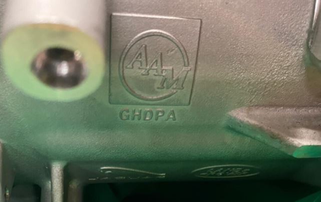

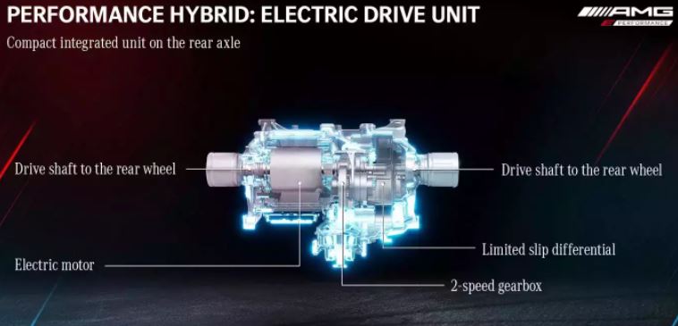

I agree a mechanical LSD would be difficult - AAM also make the rear motor for the AMG GT 63 E which is the same power! and same inline/axial configuration - with an LSD! I Pace motor:
Gear ratio =9.04
Max rpm 13,000
Axle torque peak 3150Nm
Torque peak 348Nm
Power peak 147kW
Weight 73.8kg
There is also AAM casting branding - which is American Axle Manufacturing
Designed in Sweden, Manufactured in Poland.

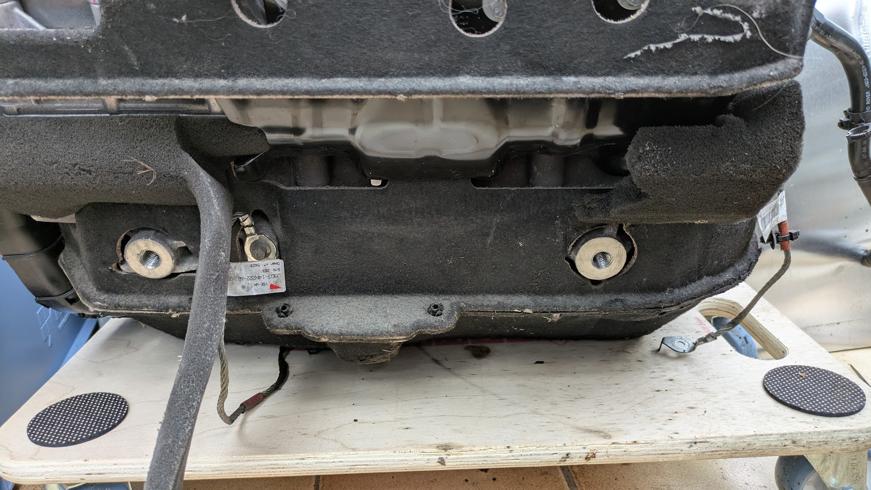

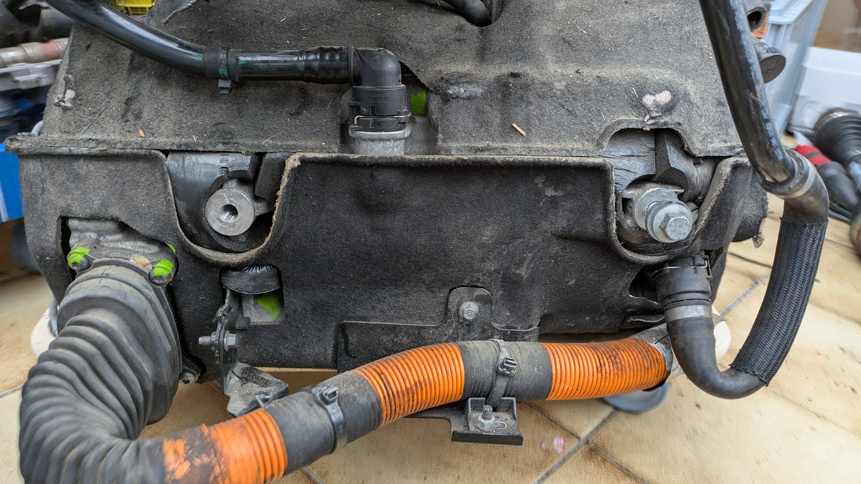

I started a wiki page about the drive unit(s): https://openinverter.org/wiki/Jaguar_I-Pace_Drive_Unit
Any contributions are welcome, it needs a lot of work still.

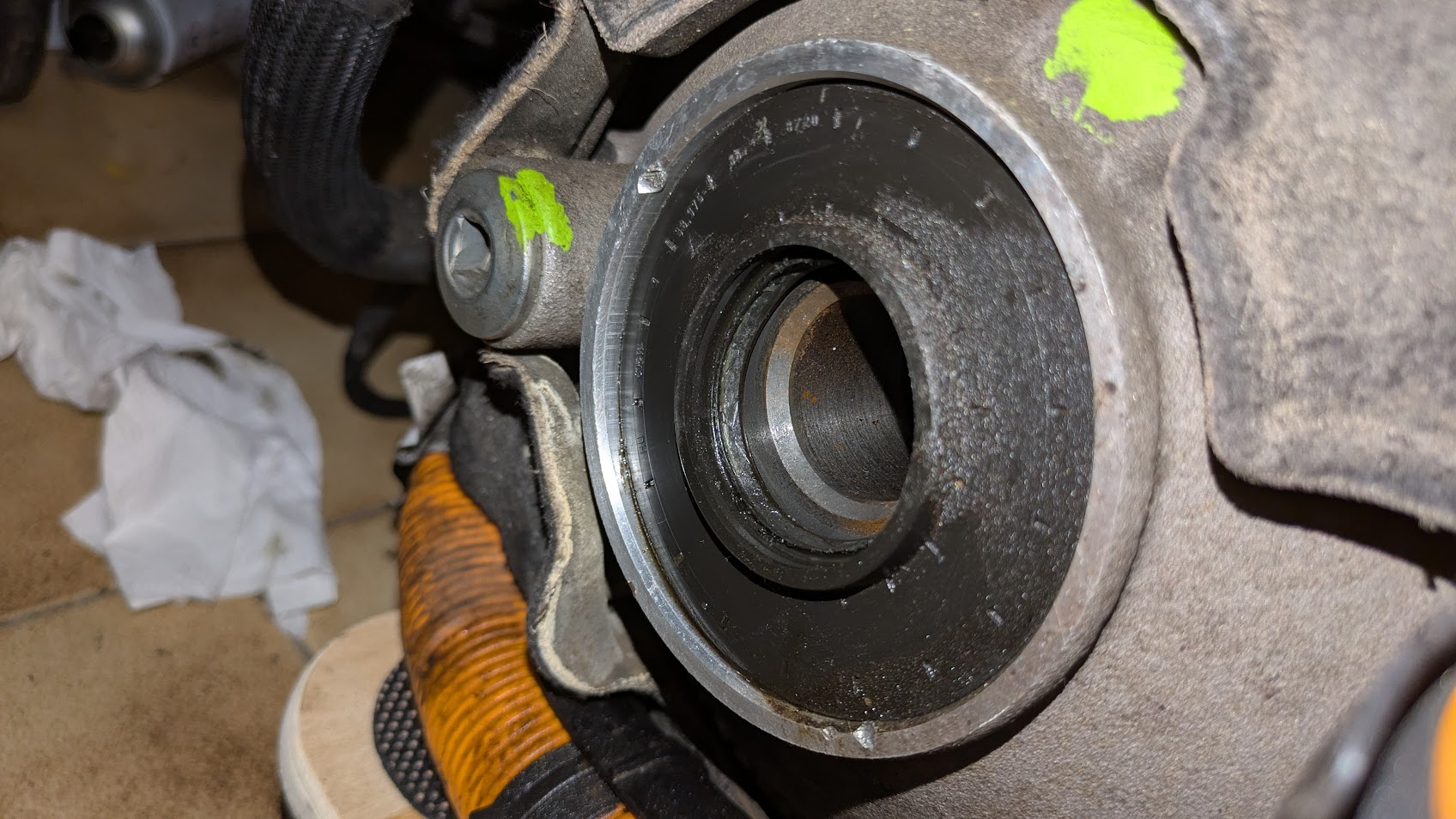

The rear drive unit only has four mounting holes, two at the front and two at the rear. I'll try to get some measurements soon, also in relation to the CV axle locations.

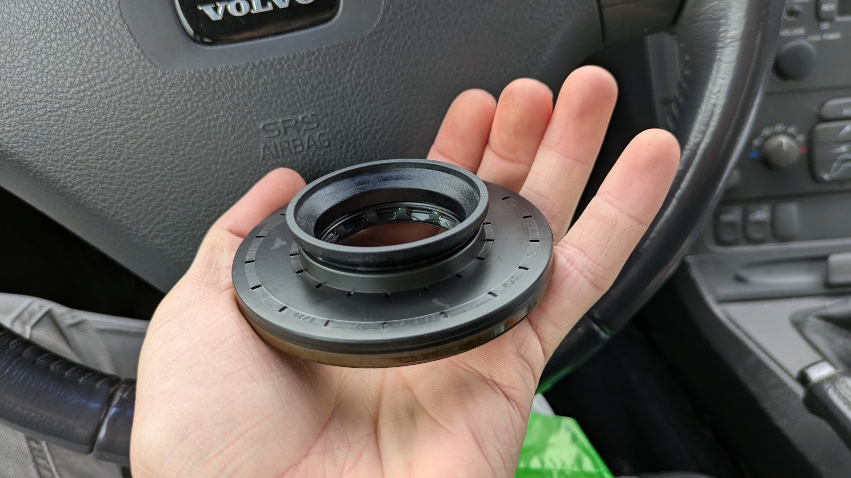

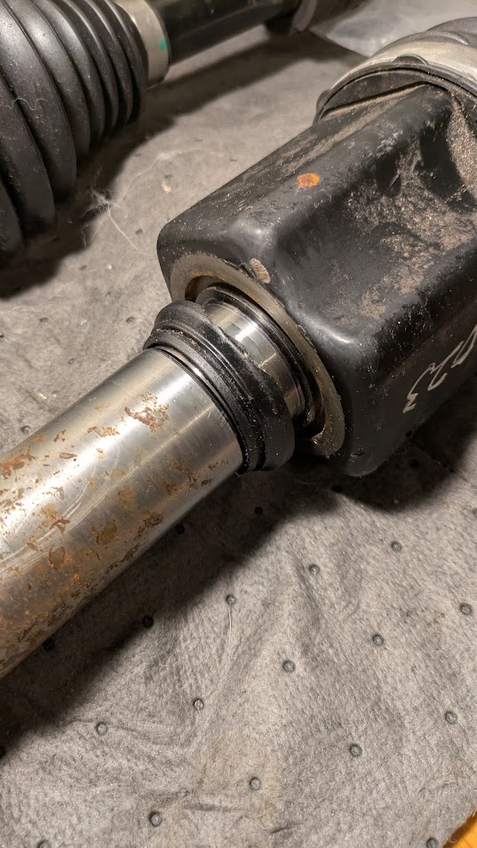

Perhaps also interesting: The CV axle seals are often incomplete, there is a plastic ring that is part of the seal and on the long CV axle it gets stuck because the sealing surface has 1mm thinner diameter than the part further out and on the short CV axle it sometimes gets lost too.

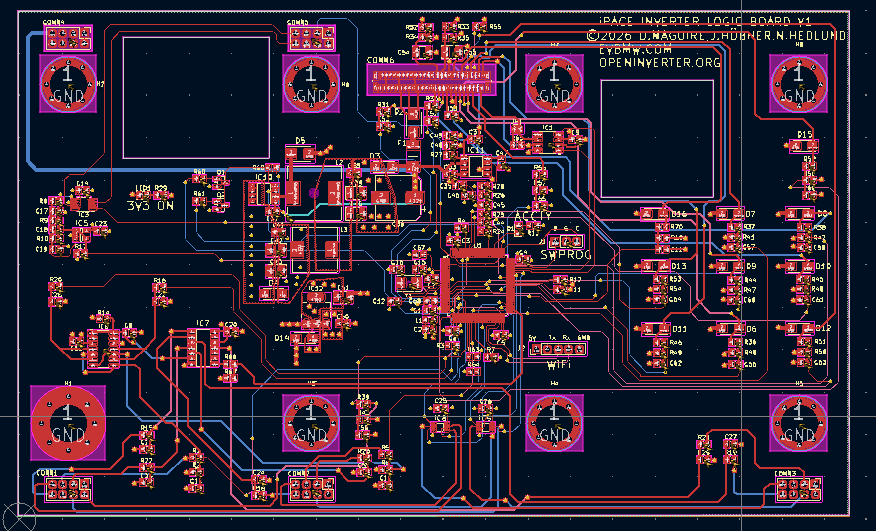

- Posts: 3999
- Been thanked: 1114 times
Re: IPace Front Motor Hacking

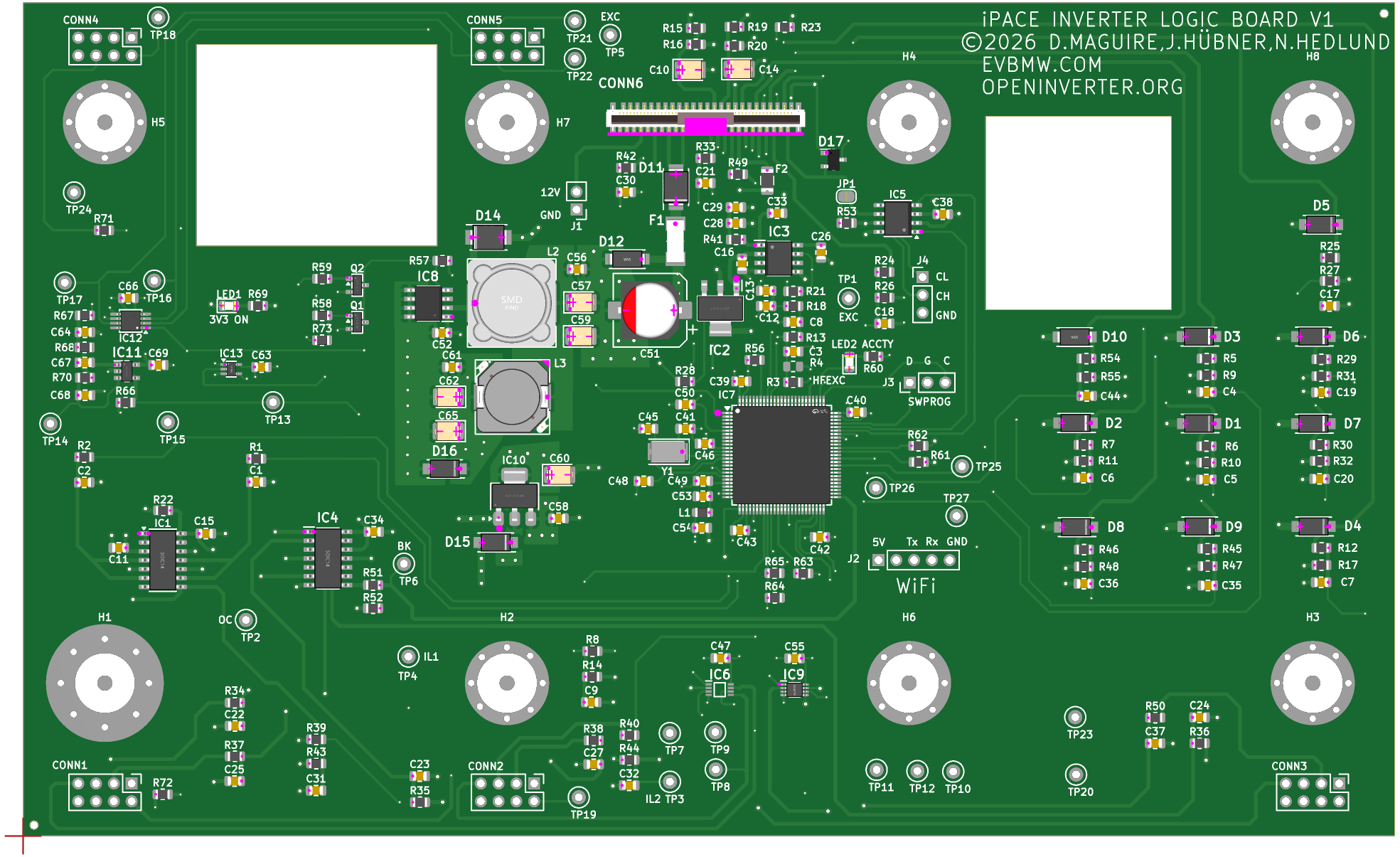

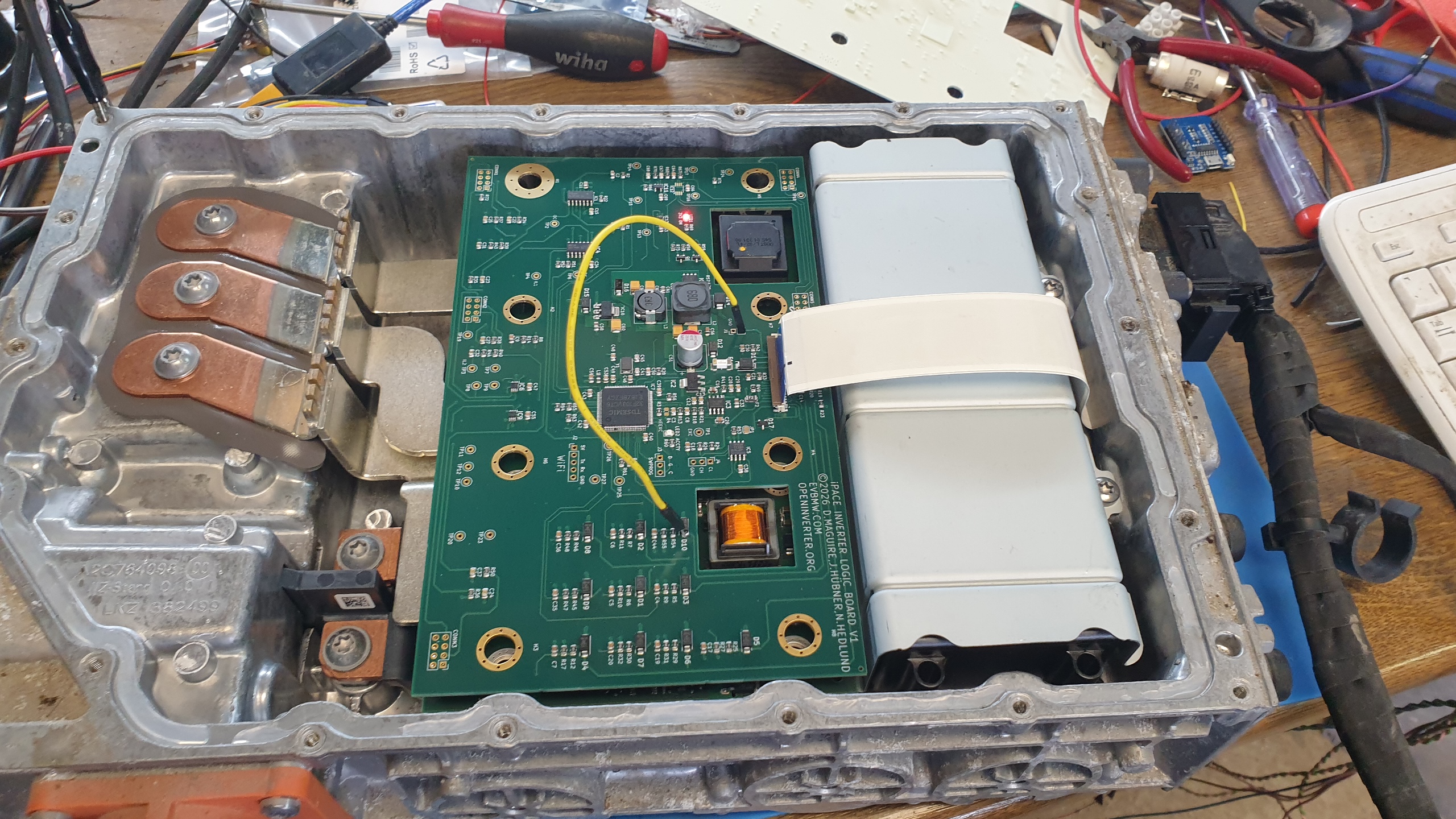

PCB placement complete. Now gotta start tracking.

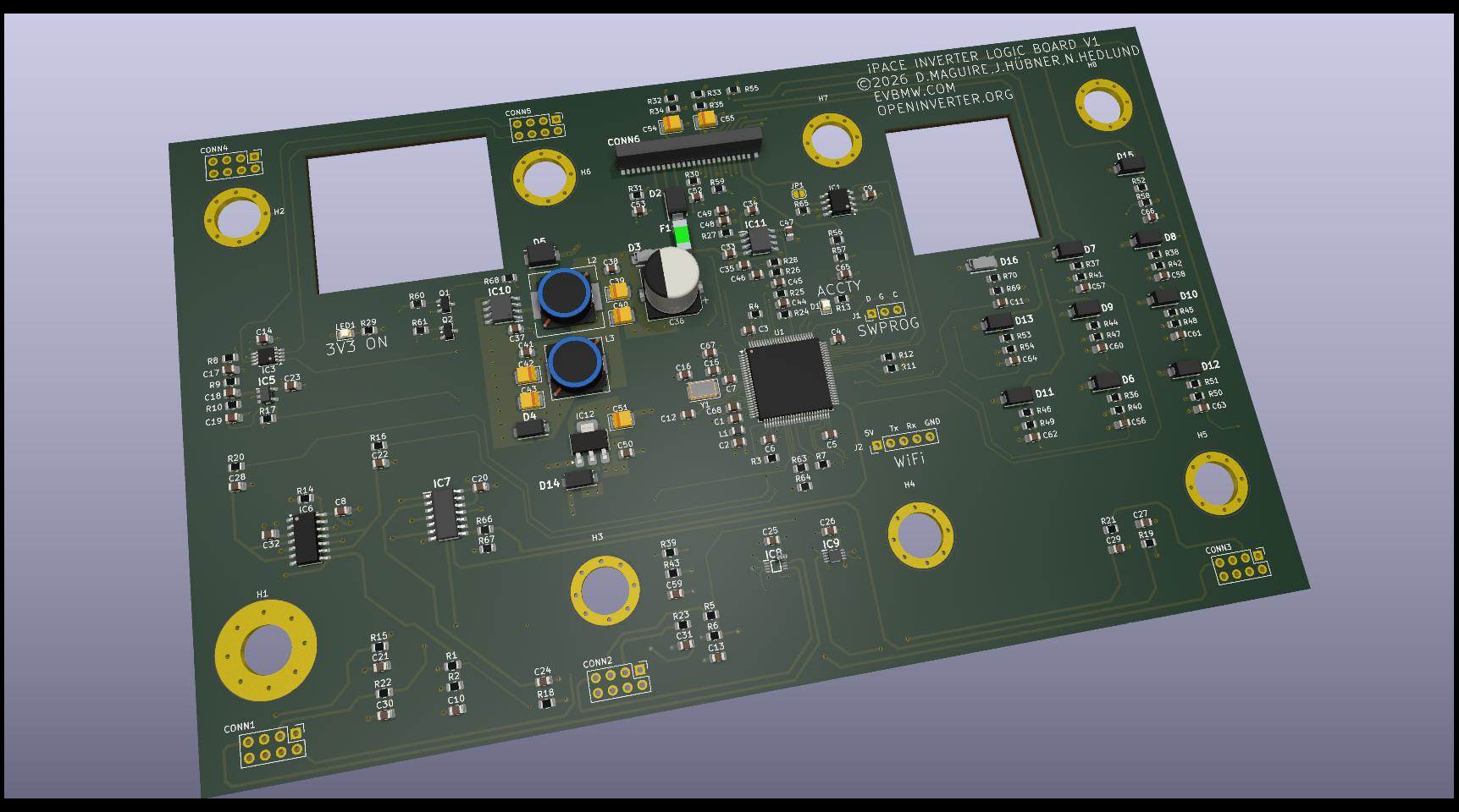

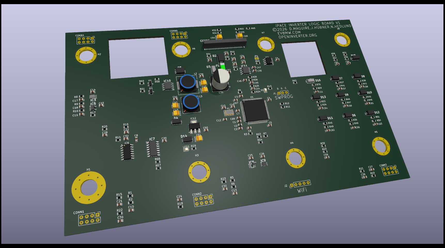

- Posts: 3999

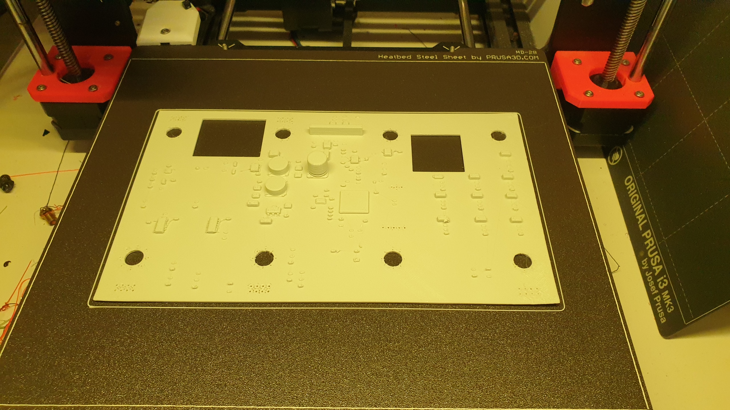

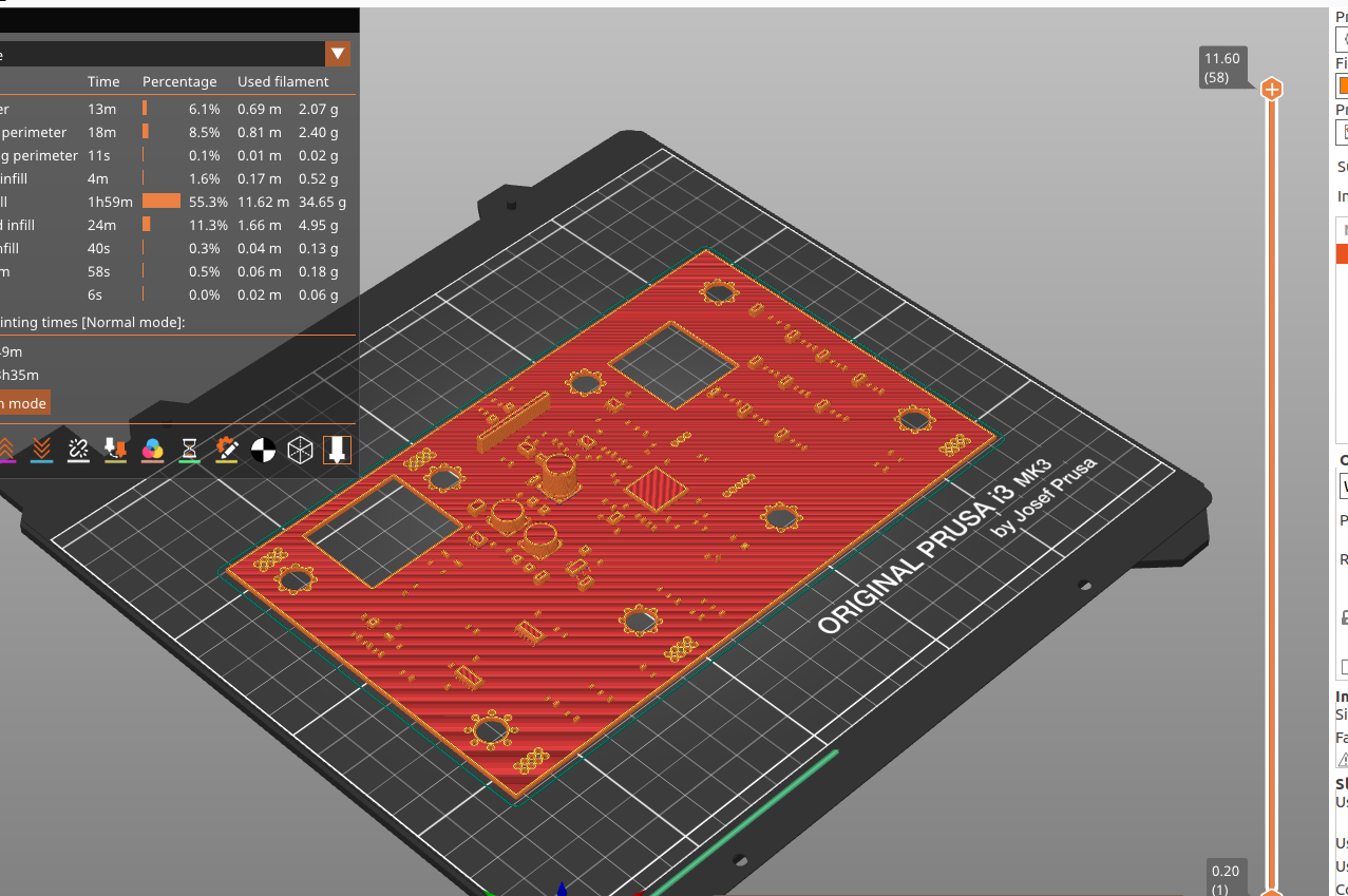

Board tracked and passed basic drc. 3d printing a test piece for physical fit checks.

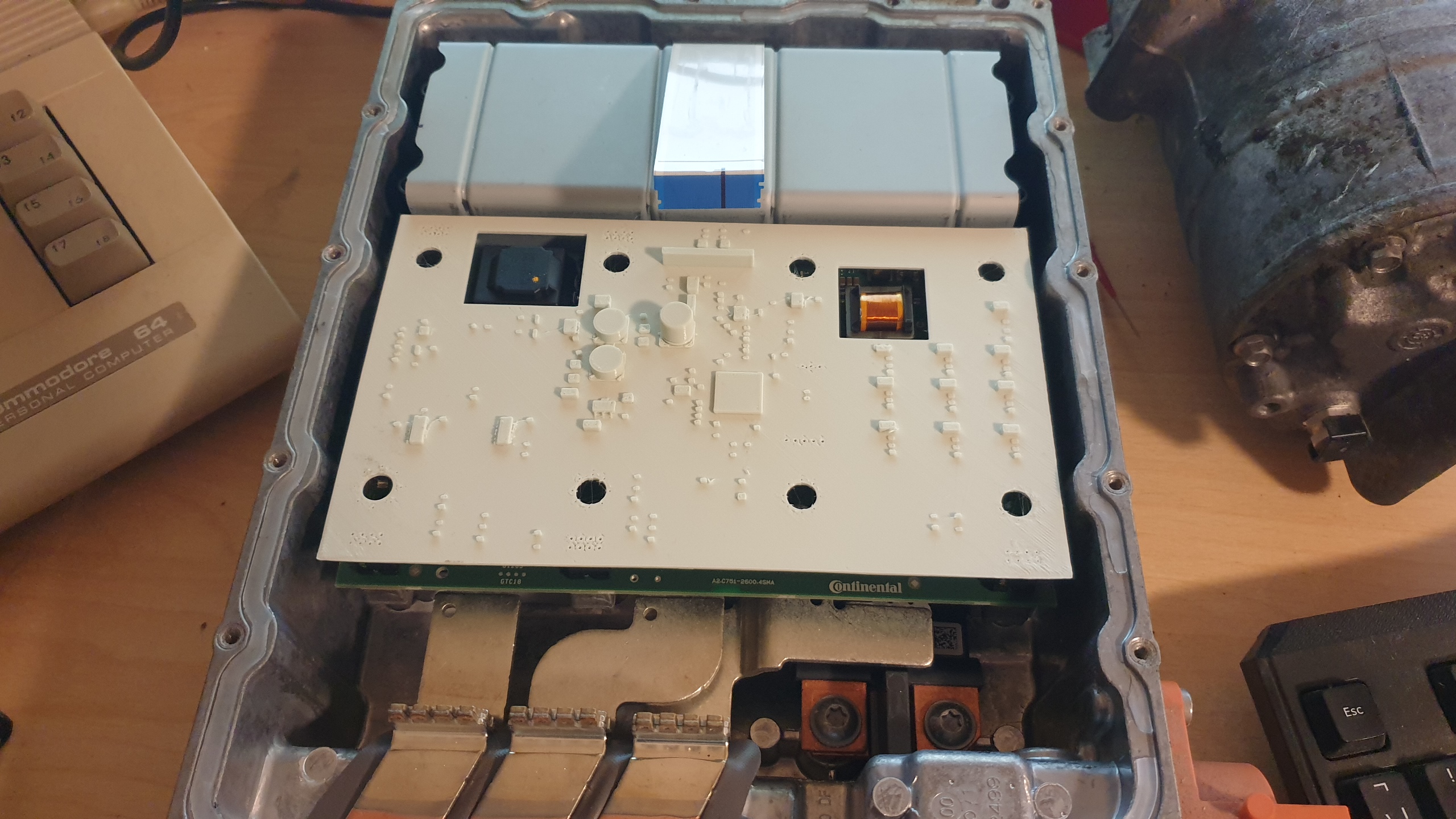

- Posts: 3999
V1 design now on github : https://github.com/damienmaguire/Jaguar ... ont/FDU_V1
I'll order some prototypes tomorrow.

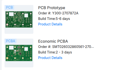

- Posts: 3999
On the basis of zero feedback I take it to mean the design is perfect so proceeded to order 10 pieces.

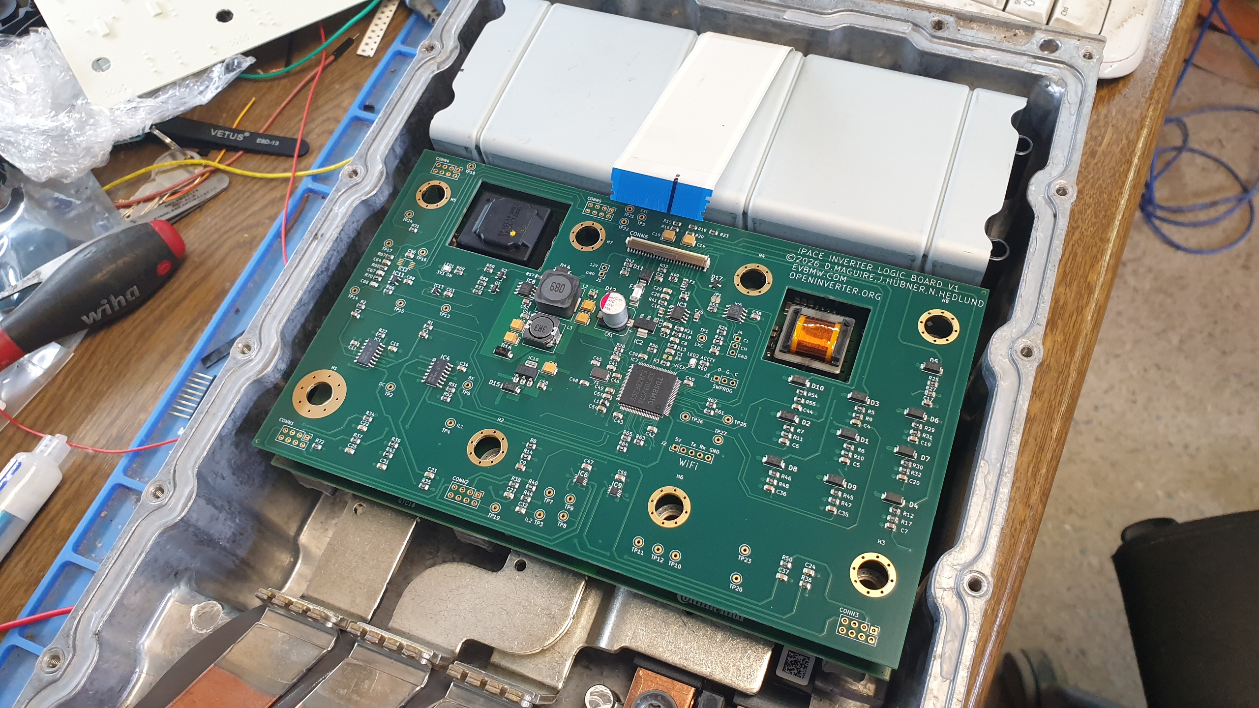

- Posts: 3999
- Posts: 3999

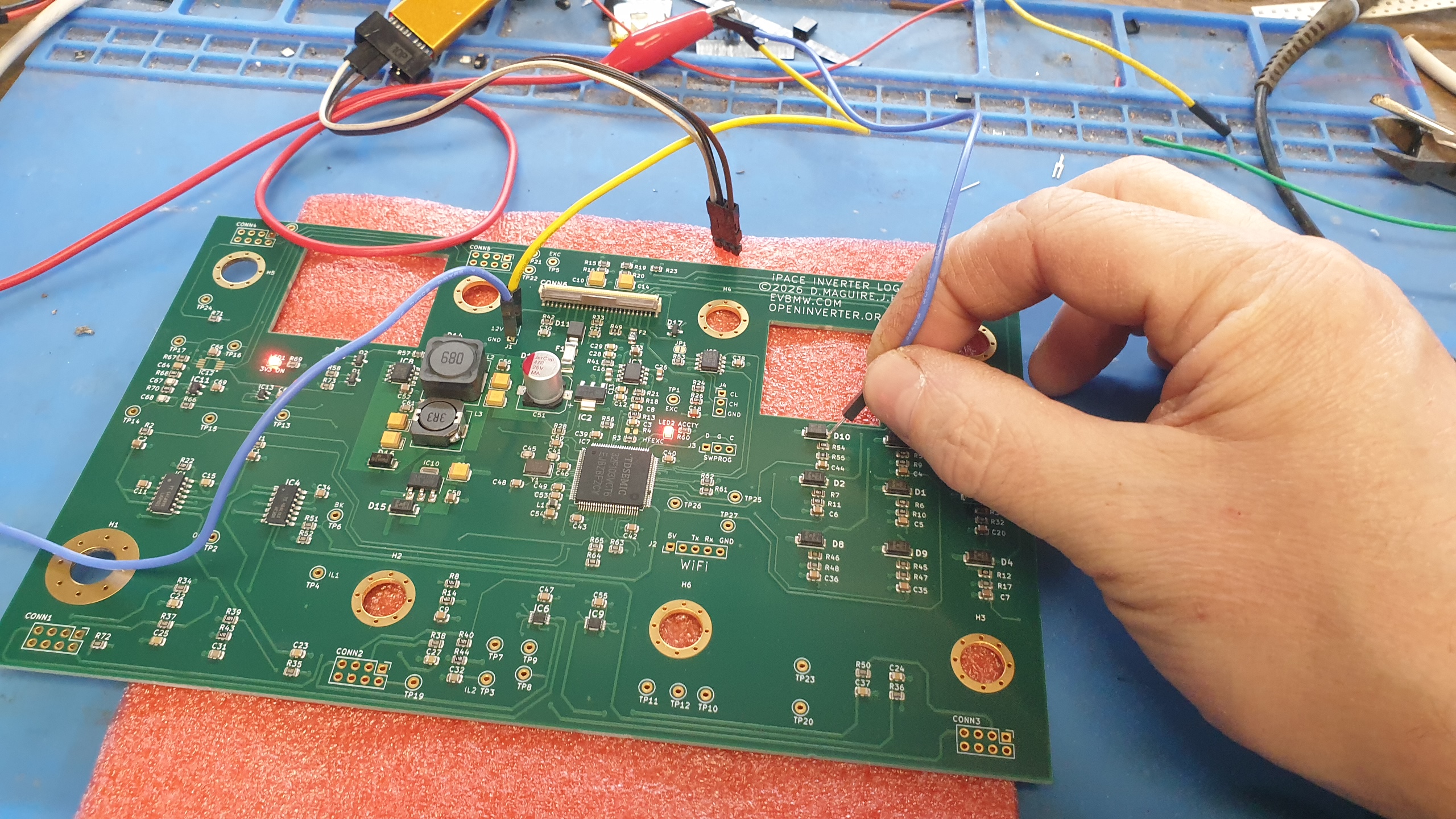

iPace boards arrived. Testing in progress. Will try and write some sw soon to do a bit of basic testing of pwm etc

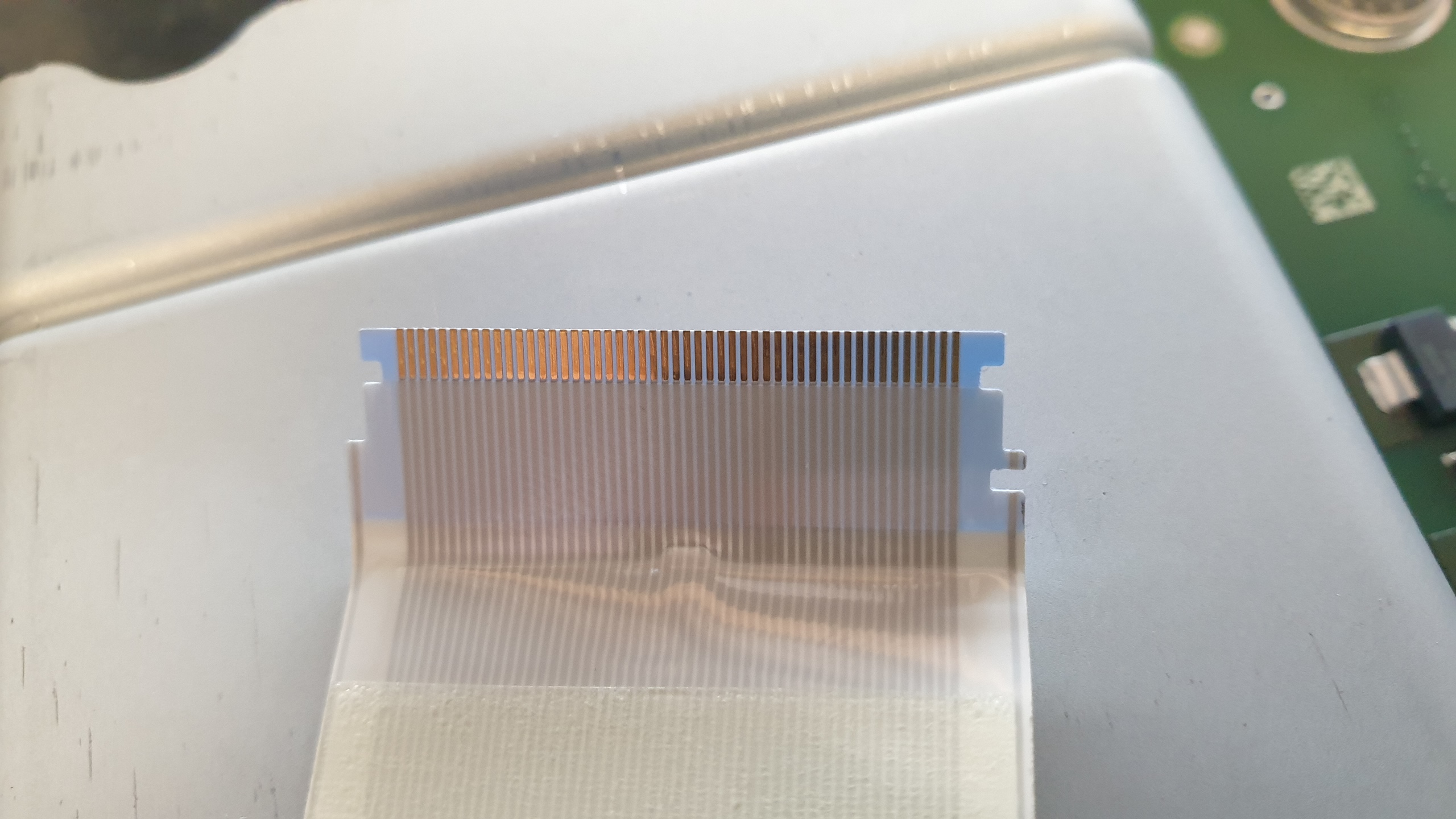

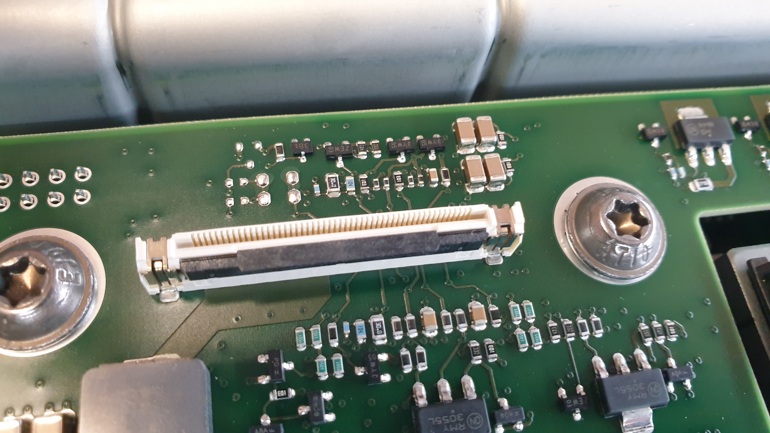

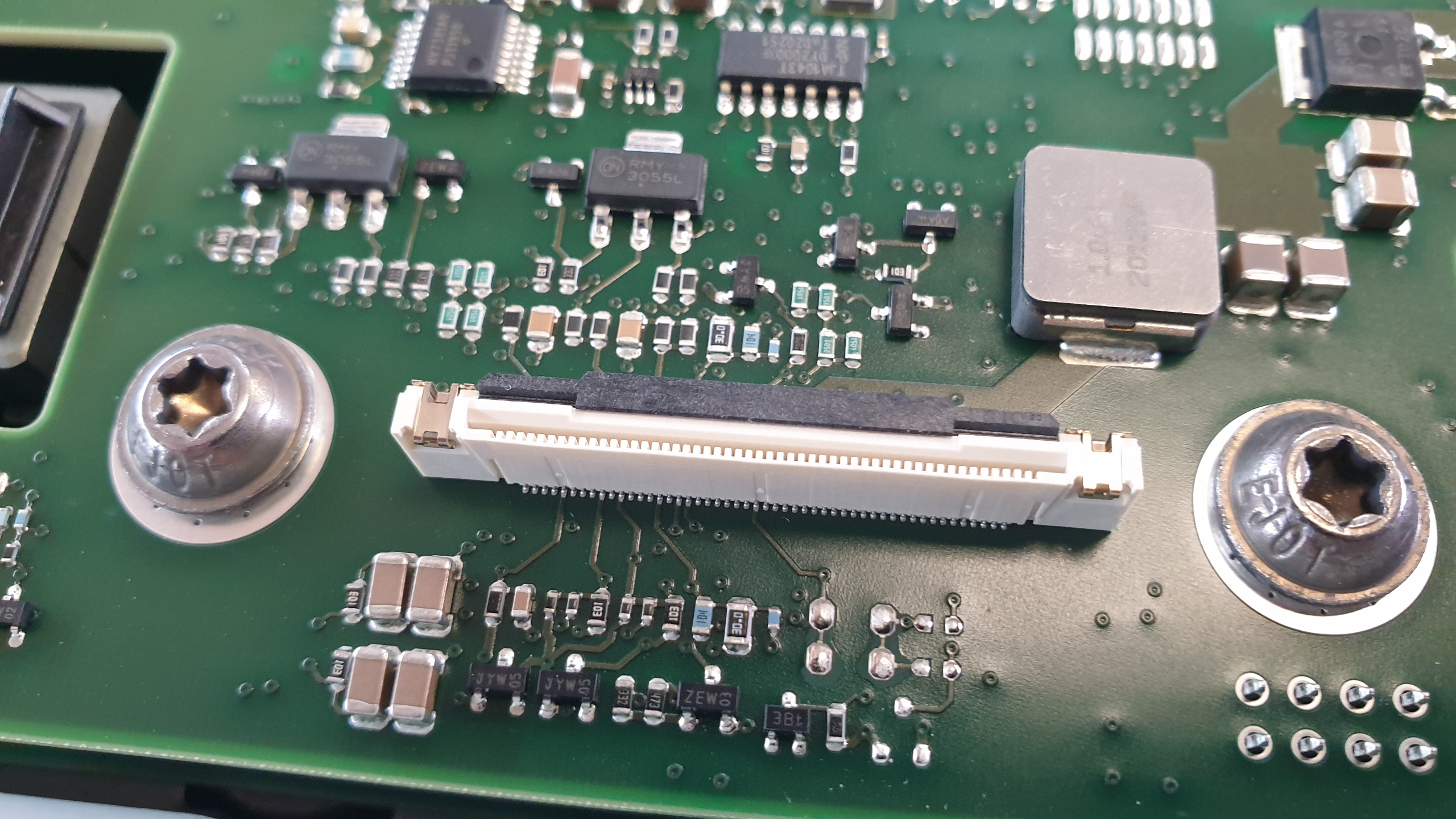

Time for some more bad news. The correct ffc connector is the Kyocera 046810650020846+T
https://www.mouser.ie/ProductDetail/KYO ... IFjA%3D%3D
