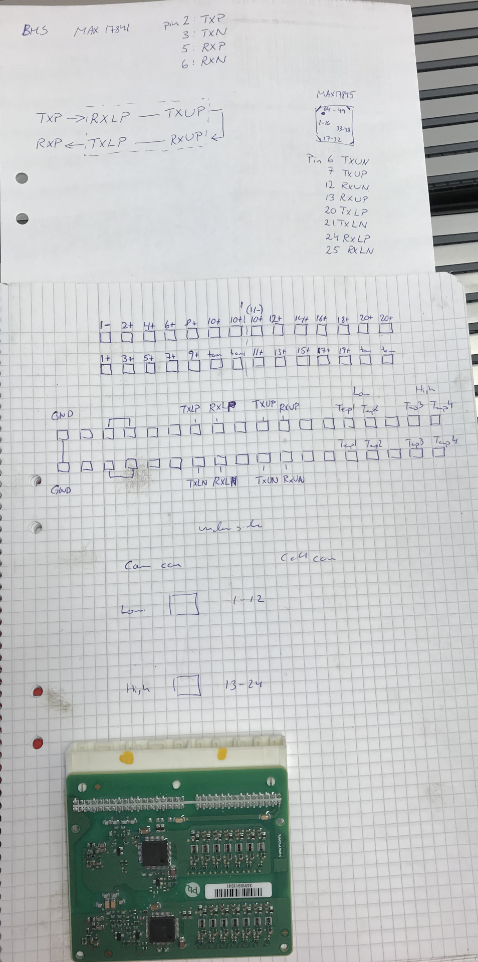

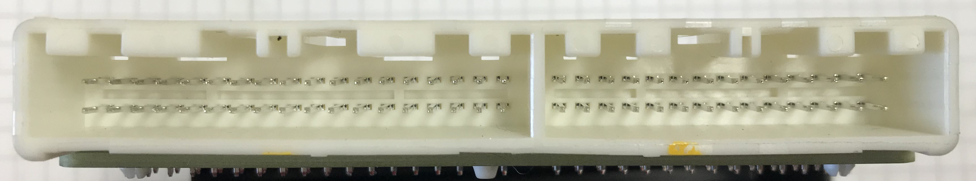

Did some reverse tracing and measurement today.
Looking at the connector as shown in below picture.
The pinout as I could trace it.
Very similar to the Kia Niro PHEV modules that is described in the start of this thread.
Also, when viewing from the bottom side, the chip closest to the connector is the lower voltage chip. Everything seem to be mounted so the boards should be possible to use up to 12S on each chip, 24S in total per pcb.
Each chip can handle 2 temp sensors per piece but usually only one temp sensor is connector and the used postion in the connector varies.
There is a kind of loop going on with pin column 3 and 4. I never figured out how to use this for the PHEV modules but looks very similar for the e-Niro as well.
Regarding cell connections, where it says "tom" in my notes, it's swedish for blank/empty. The most left blank pin (under left 10+) should be 11+ and the right 10+ is the 12+ or highest cell pin used (if only 9S is used it would need to connect to 9+). Hence 10+ in this case as only 10S is used.
Have done a setup, only needs code tweaking, to test communication with the chips. Will report back when tested.

Wow! That's quick! Top job, txs for sharing.
EDIT: When i can i check the connections with the real 10S and 9S packs (20S and 19S). At the moment a bit of between house moving etc.

I've checked on a 20S module from the e-Niro pack. The 19S module has one less cable.
I'm able to communicate with the slave module and read out the cell voltages, die temperature as well as external temperature sensor, all while using the same hardware as mentioned in the start of this thread so I call this a big win!
@EV_Builder: Thank you for pointing out that the Kona slaves use this chip. The board I looked at first was hard to read the chip marking on and I did not find that marking and I then assumed it was a Kia/Hyundai specific chip.

Hi there,
Firstly many thanks for the information and code posted here. This has allowed me to progress a long way already towards using the MAX17841b IC.
I am working on a communication interface so I can get the BMS data from a bank of 6 Land Rover Samsung SDA modules which use this interface. I have generally used the circuit diagram published here with some changes to suit my application. The main change in the BMS interface is that I recovered the isolation transformers from the original BMS controller rather than buying new - these are 2 x Sumida CEP99 devices. I have tried to communicate with a single battery module for the time being but the chain initialisation is failing. As such I am now checking the hardware first and notice what may be the problem. The Rx back from the battery on the MAX17841 side of the isolation is AC. I doubt this is correct so ask if anyone can please assist and let me know if this is the problem? My circuit is below and I have marked the scope test points as TP A and TP B. They are both ref to GND. Many thanks.
Image Image Image

What step of the initialisation is failing? Have you made the correct adjustments to the SW to use only one slave? Is the slave wired correctly?

bexander wrote: Thu Nov 17, 2022 4:03 pm What step of the initialisation is failing? Have you made the correct adjustments to the SW to use only one slave? Is the slave wired correctly?
Thanks for getting back to me. The chain initialisation failed, however I scoped the signal at the Rx of the IC and it was a distorted triangle wave. I'm going to reduce the 1.5k resistors as maybe the RC combination with my different xfmrs is slowing the rise / fall. I checked the Maxim schematic for their dev board and they use 470R so I'll change these first and see if I can get the waveform clean. The plots pictured on my previous post are on the xfmr side of the resistors.
I'll post when I've tested and hopefully will work. Luckily the pin out is marked on the battery module bms PCB. I cross referenced to the original cables so expect this is ok. I'll share once I got a working system.
I've made quite a few adjustments to work for 1 X test board and then the 6 modules in my pack. Your code has made this much more possible for me and I understand most of it now so I think if the hardware works I can debug from there.

inkubate1981 wrote: Thu Nov 17, 2022 11:09 pm Thanks for getting back to me. The chain initialisation failed, however I scoped the signal at the Rx of the IC and it was a distorted triangle wave. I'm going to reduce the 1.5k resistors as maybe the RC combination with my different xfmrs is slowing the rise / fall. I checked the Maxim schematic for their dev board and they use 470R so I'll change these first and see if I can get the waveform clean. The plots pictured on my previous post are on the xfmr side of the resistors.
To summarize, the signal at TP A and TP B looks resonable and the signal received back at the max17841 looks terrible, correct?
How does the signal look at the low side receiving end of the first slave? At the high side output of the first slave? Might be a good idea to check the signal trought the whole chain, if possible, to narrow it down before starting to change components.
