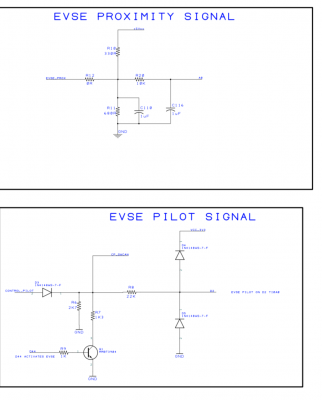

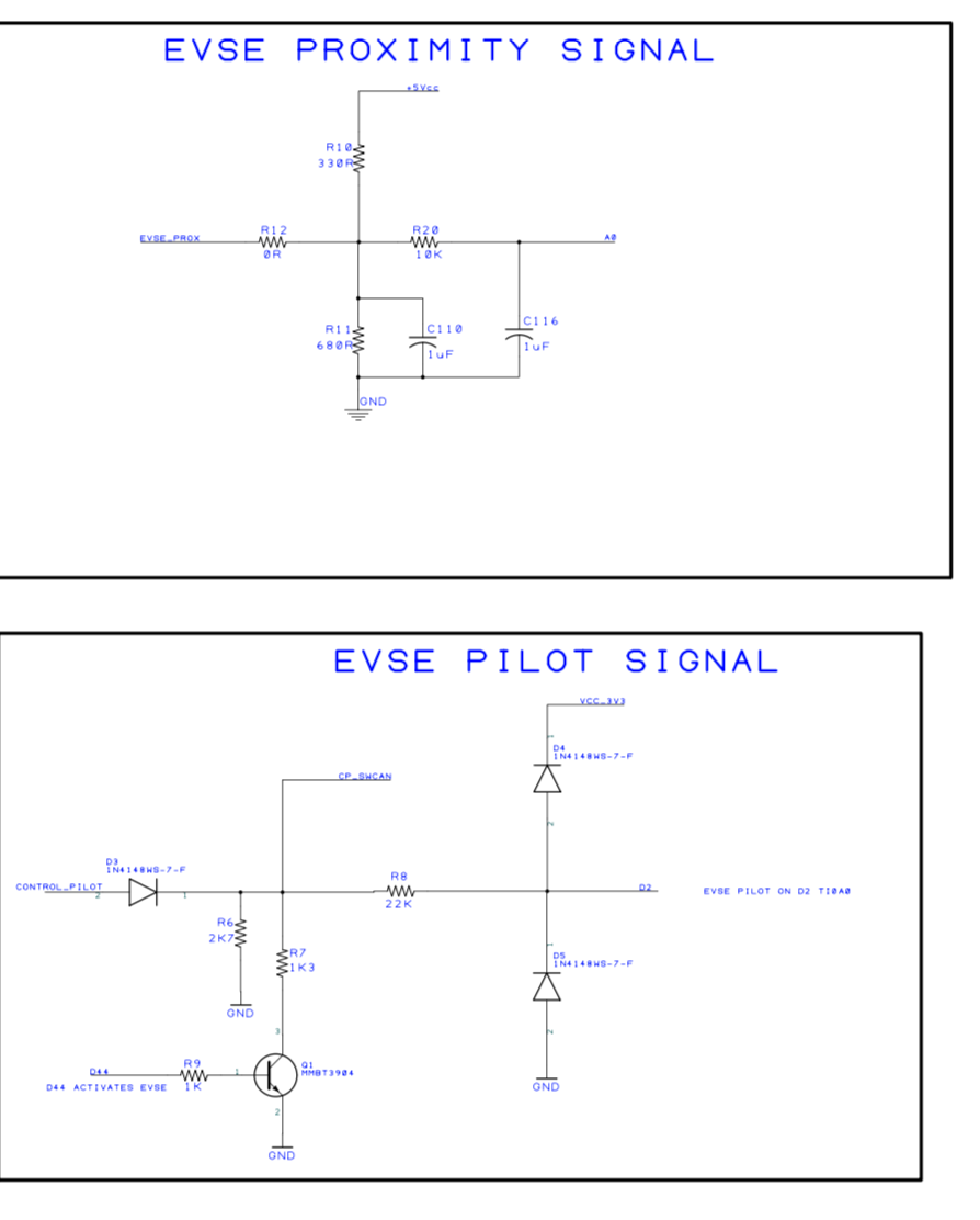

arber333 wrote: ↑Thu Oct 21, 2021 11:40 am I posted new document on my github with 4.1 schematic in pdf.
https://github.com/arber333/Arduino-Due ... ematic.pdf
Are you sure this is latest schematic? For example CP seems to be routed to D7 instead of D8 as in schematic?

evMacGyver wrote: ↑Mon Nov 29, 2021 6:39 pm Are you sure this is latest schematic? For example CP seems to be routed to D7 instead of D8 as in schematic?
There are only 2 diodes on that board. First one is power diode to protect 12V positive from reverse polarity and the second one is 30V schottky diode to rectify Cp signal for later transistor edge counting. The second one could become D7 or D8 through various design changes because i was not attentive enough. I will try to correct it...
V4.1 to V4.2 has almost no difference.

arber333 wrote: ↑Mon Nov 29, 2021 7:03 pm
I was referring to Due pin D8 in schematic being D7 in real board. Also after CP transistor there is place for resistor that I cannot find in the schematic, have not verified is bottom copper flood ground or 3V3, so might be either pull down or pull up, for that resistor to have some sense it should be pull up - I think? Therefore just thinking PDF schematic might be different version than real v4.1 board, but I can handle.
Posts: 3795
Been thanked: 411 times
Re: Arduino DUE VCU with analog and CAN control
evMacGyver wrote: ↑Tue Nov 30, 2021 3:16 pm I was referring to Due pin D8 in schematic being D7 in real board. Also after CP transistor there is place for resistor that I cannot find in the schematic, have not verified is bottom copper flood ground or 3V3, so might be either pull down or pull up, for that resistor to have some sense it should be pull up - I think? Therefore just thinking PDF schematic might be different version than real v4.1 board, but I can handle.
Yeah... you are correct. I have made an error in digital pins for PWM. Correct transistor output pins are D2, D6, D7 and D8.
I have made schematic before i checked which timer to use for my PWM code so those pins would be to the correct timer. It was not the case in the start.
Top copper is GND, lower is 3V3.
Pin D9 is the input pin to measure state changes for CP signal PWM duty detection. I havent written the code yet though i have an idea how to measure CP duty. Resistor (R25) just before sense transistor is gate current limiting and the two resistors after transistor are pullup/pulldown. I havent decided on how to detect PWM yet so i like to leave my options open... I think i will decide on transistor pulling down D9 internal pullup thus sensing the PWM top and bottom and measure time between both in us. With 1kHz signal i should get good enough % duty value.
In any case resistors after CP diode are there to pull the signal down with a relay. R3 (2K7) and R4 (1K3) via relay. I am sure there are more pullup resistors on the board that i havent accounted for. I put them there to have more options in experimenting. Also there are several "resistors" as jumpers to make or break a signal, such as either analog pot signal or direct digital signal presence on the same line without the code change.
Also you can populate all the caps if you want, they are mostly for decoupling.

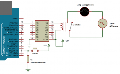

Arber, how would you go about switching on 3v and 5v signals with your shield? Just need to turn on these as enable signals for a charger.
Posts: 3795
900 wrote: ↑Tue Mar 01, 2022 5:14 pm
That depends if you need to sense a signal or just output a signal to close a relay...
I have used ULN2008 chip as relay driver. This means i pull relay winding to gnd.
Then i use 4 NMosfet that i run via pwm outputs. But with N channel you need pullups so you get weak voltage signal when transistor is off. DUE is 3V3 logic and i use mosfets to run 12V logic on the other side.
If you want safe inputs from 12V to 3V3 though you can use resistor divider. Not too elegant... But if you want protection use optocoupler chip. Use 1k resistor with 12V line and turn opto on. On the other side you pull internal chip pullup (10k) to gnd.
You can also use a relay and toggle gnd to the chip input. In that case you can use whatever logic as long as they have common gnd.

Arber, could you please take a look at this schematic. Is it possible to modify your shield so it would be according to the schematic? How would you suggest to do it? In this case I think Tom's code would work.
Why would you want to complicate things. I explicitely setup one Nmos to fire on PWM signal. The best thing would be just to count the millis between pulses to get the Cp duty. That was my plan.
evMacGyver wrote: ↑Mon Jan 31, 2022 4:08 pm Toms code on SimpBMS or at least TeslaBMSV2 does work quite nice for CP duty detection, just see the interrupt code. You need to change calculation polarity as shield board uses NPN or NFET for grounding IO pin. Additional optocoupler decade of 35ms needs to be removed.
Did you see my previous post, current circuit on this board does work, relay and nmos for CP, I've tested and proof it already. This does 'waste' a relay for CP, FET doing that would be nice.
V5 ideas for my personal needs would be that another CAN transceiver could be used for LIN transceiver with remote wakeup function, now I'm using separate board for this. Another would be two 0-5V analog outputs which I've done using opamp board. Also few more AD channels with resistor dividers. Aanyway these are just my current working modifications. Casing with proper connector is a really good idea!
