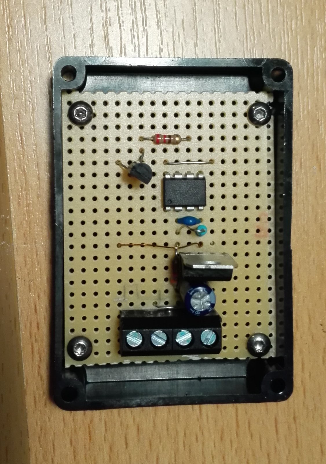

PWM circuit done :)
Runs on an attiny13 and simply attempts to keep the battery voltage above 13.2V with a P-controller. So turn the lights off for some extra heat ;) It will also counter the PTC behaviour to some degree. When sending 50% to the PTC element it will start out at 50A and drop to 40A. Now with the voltage regulation it will receive a higher duty cycle and remain at 50A.
main.c
(878 Bytes) Downloaded 151 times

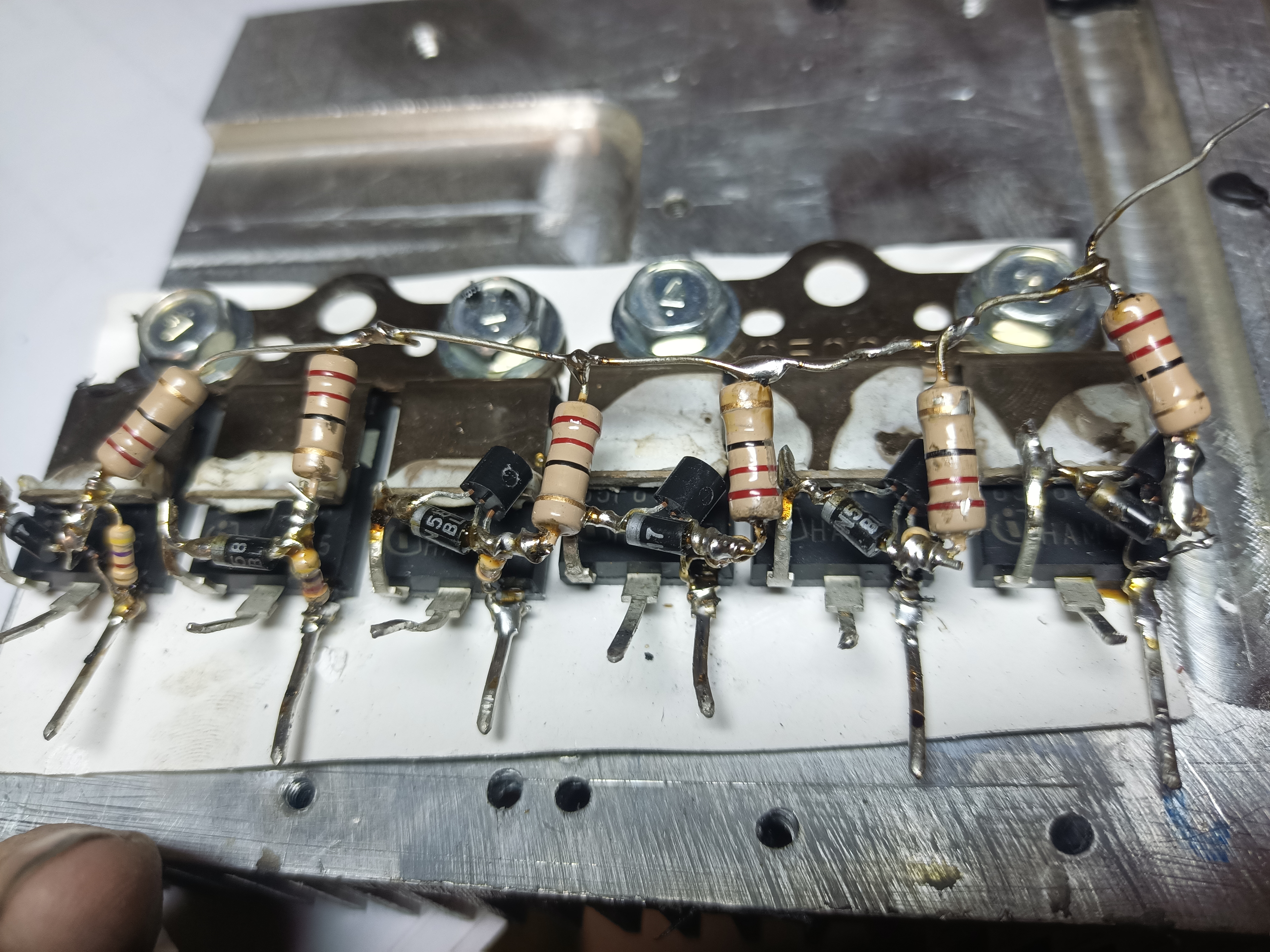

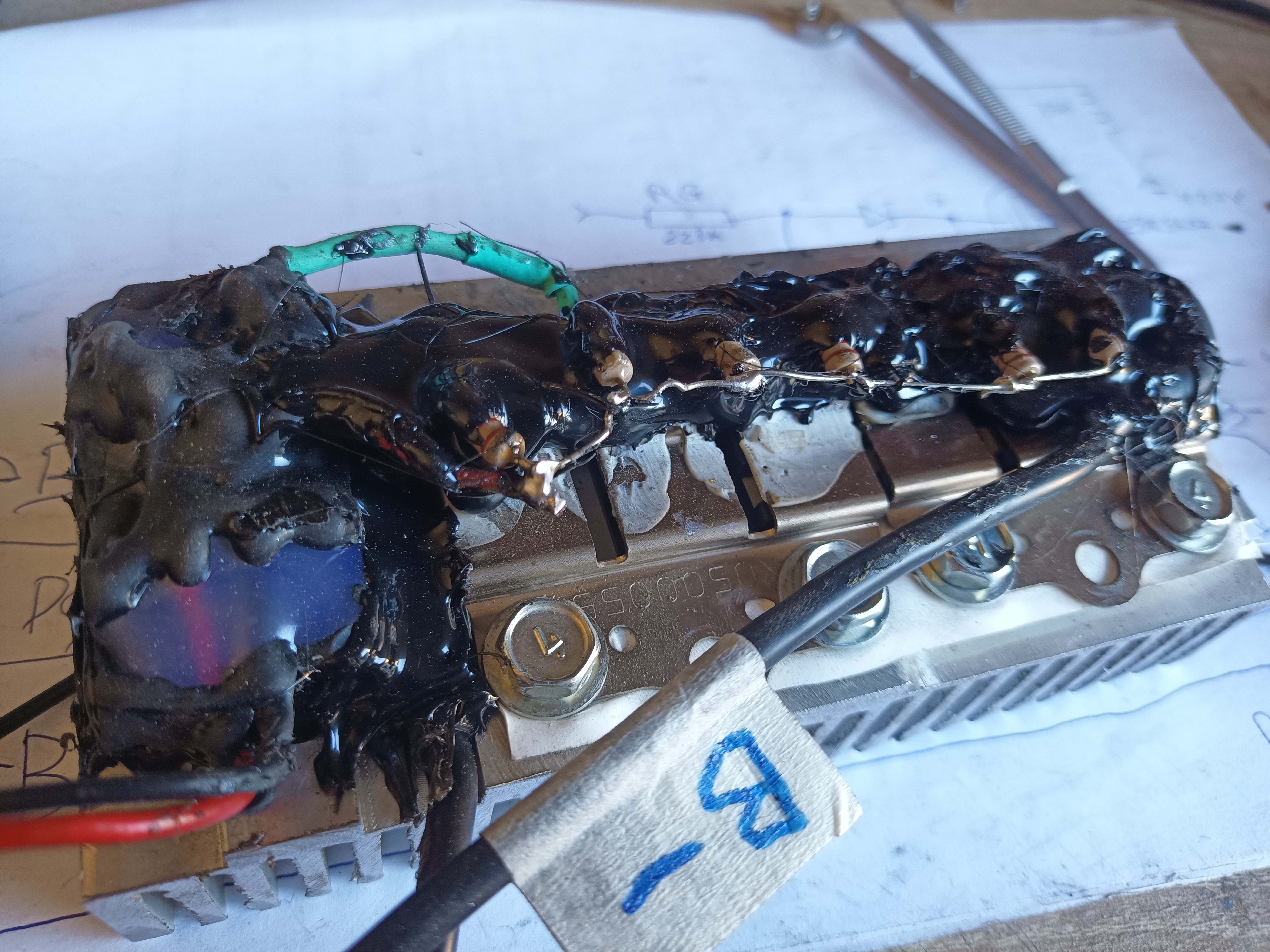

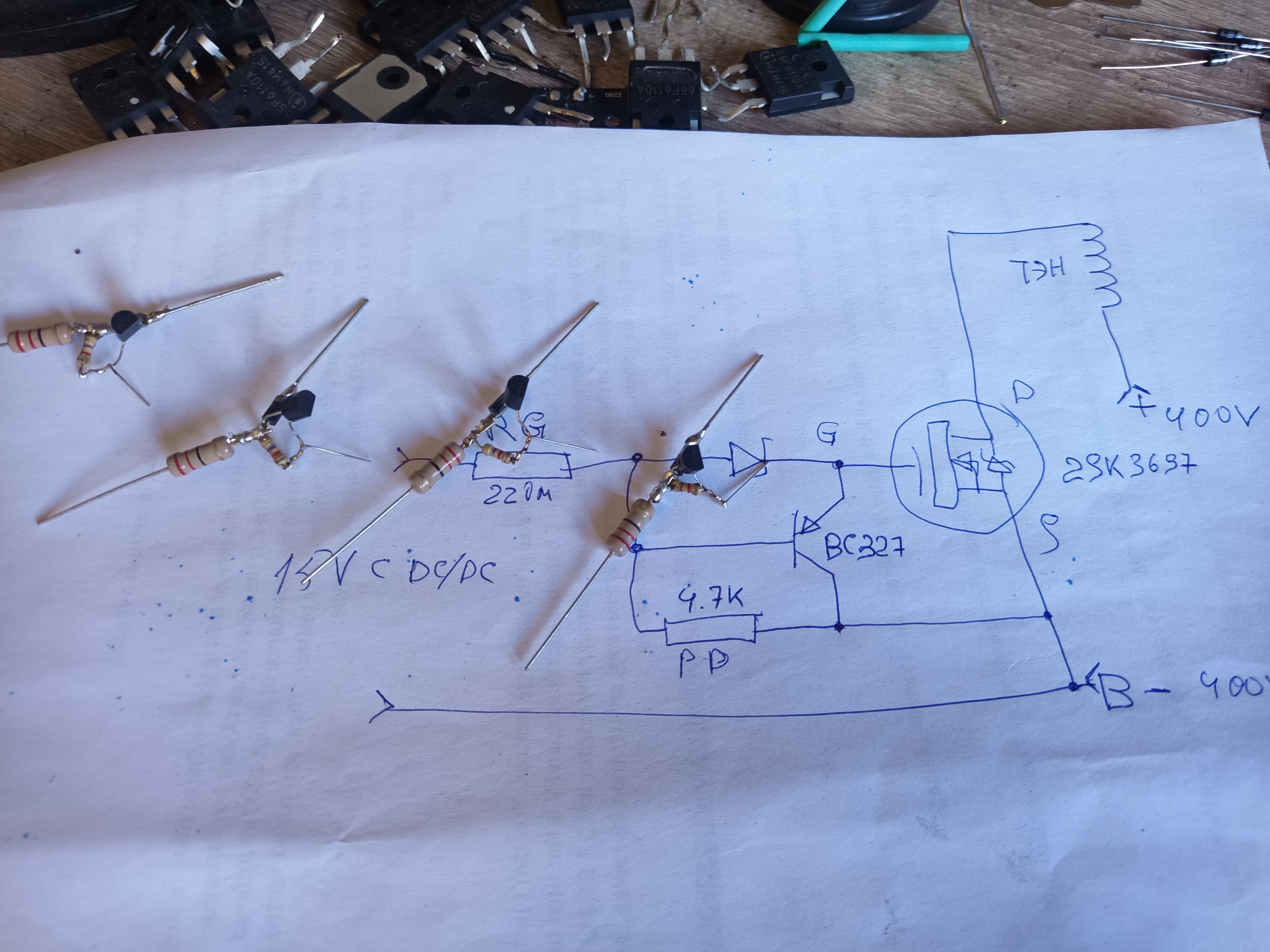

once I assembled a similar thing "in a hurry" from 600 volt 37 amp igbt transistors installed in parallel. with conventional current limiting resistors, the power keys did not close completely in a simple key mode and were very hot, so I added a locking driver from a small transistor to each and controlled the whole unit by simply feeding 15 volts controlled by a cheap temperature control controller from an incubator whose temperature sensor was inserted into the radiator of the heater. the setting was to turn on on demand and turn off when heated to 90 degrees, and turn off and turn on again when lowered to 75 degrees. thus, the temperature control made sure that the water in the heater was always between 75 and 90. this case was managed by a regular Nissan leaf heater, which I got for free when buying the engine. I took the native control board out of it, connected all the shades in parallel and got a 96c battery heater with a maximum power of 6kW. the water itself (antifreeze) was driven by a 12-volt Bosch pump system from some Mercedes (I use the same pumps to cool the inverter), the result was a very fast warm-up and it was very warm in the car even at -30 outside.
I took 15 volts from a small isolated dc / dc 12/15, which I left on the common radiator. I glued the walls to the radiator and filled the whole thing with a thermal compound, leaving only the input b- and output - for the heater and two thin wires for supplying 12 volts from the thermal control relay.
all this has been working perfectly for two years in one car
