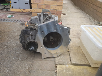

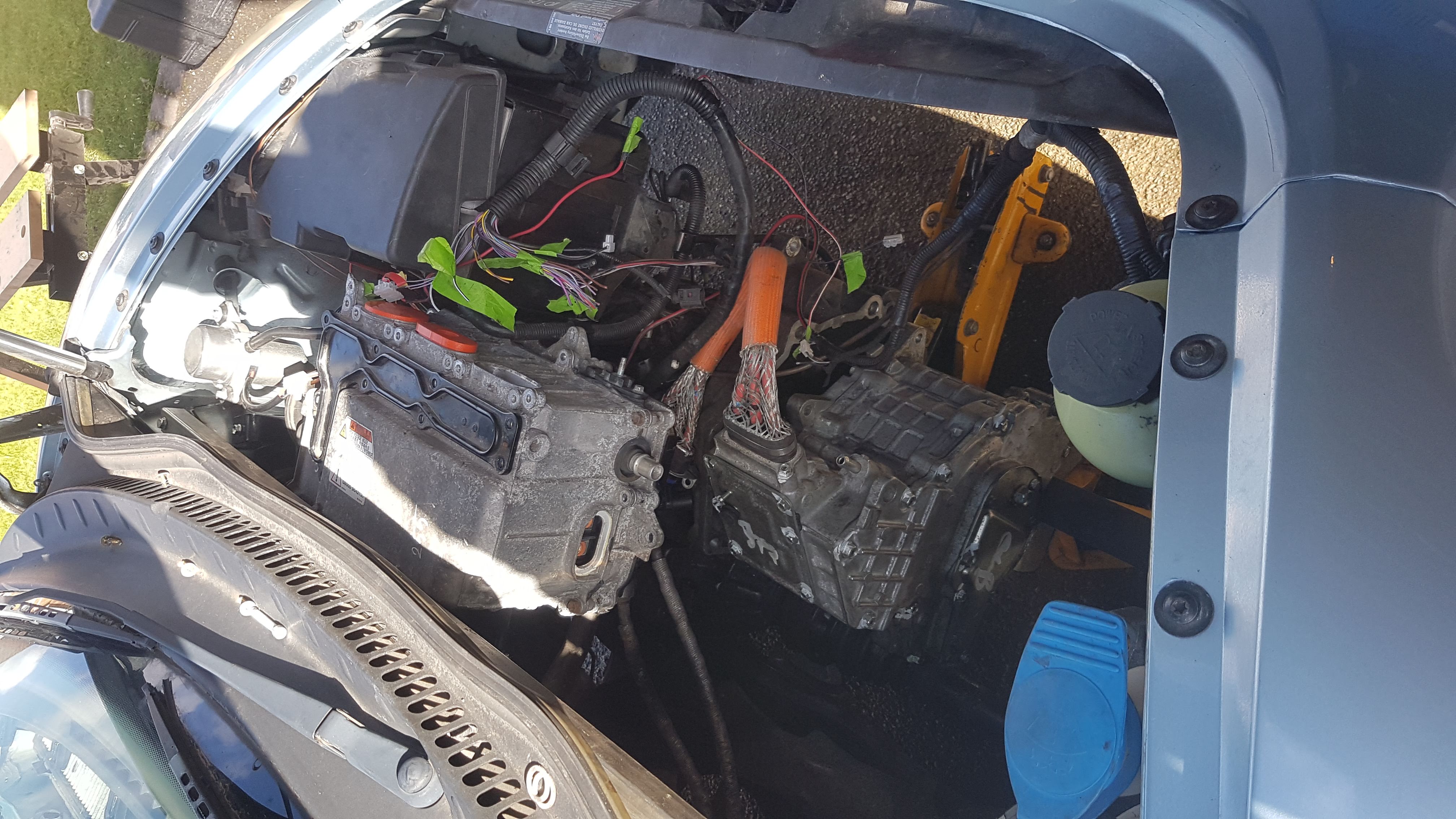

Coupler and adaptor plate seem good.
Pressing a long screwdriver on to where the gearbox input shaft enters the box and the other end on to the ear while spinning doesn't highlight any excessive vibration when spinning.
Couple more holes to drill and then I can test fit to car

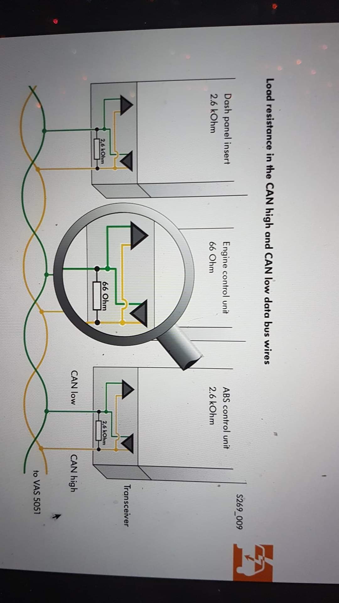

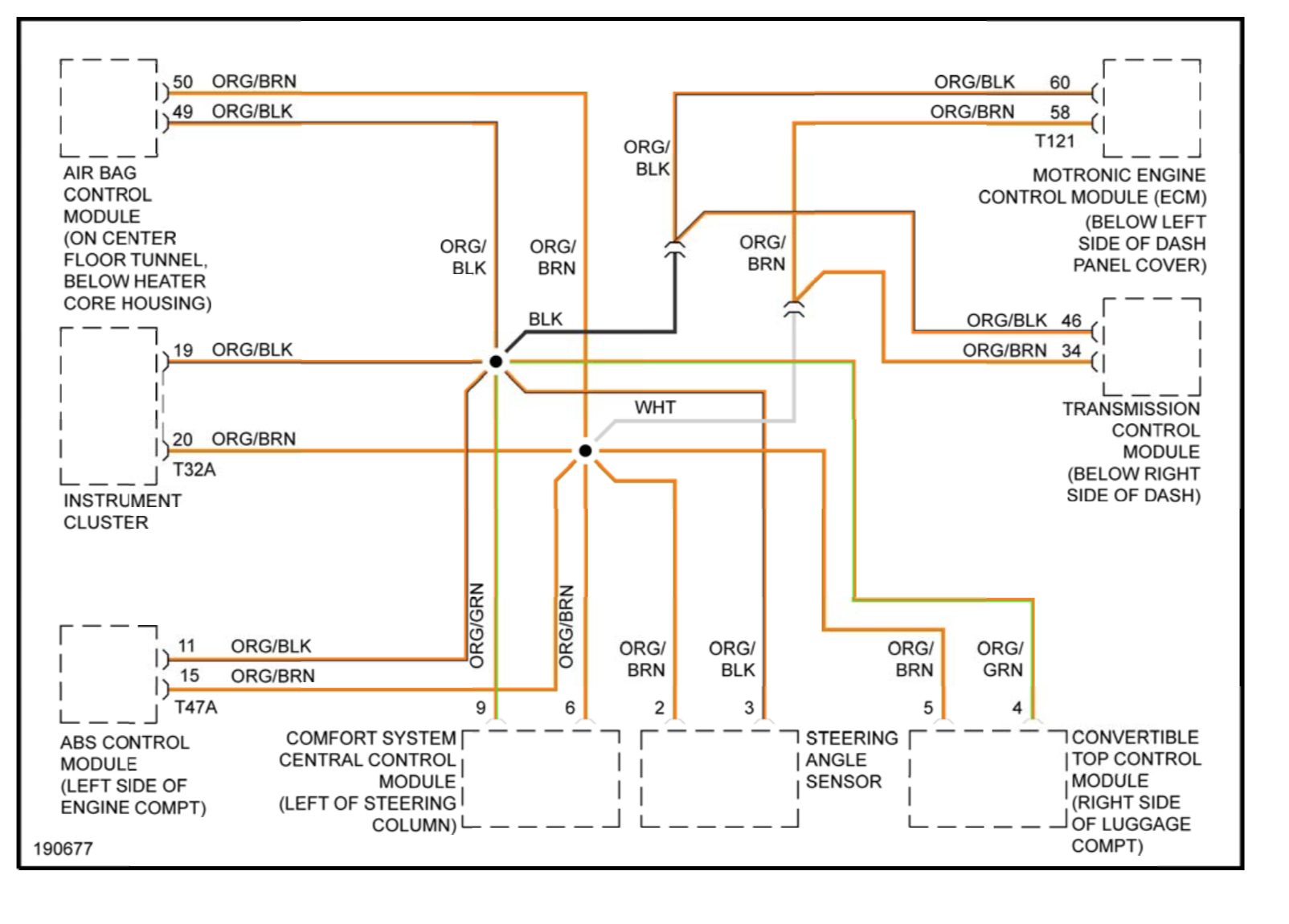

So I've pull it from the car, put a 120ohm on the cluster end and on the stm32 end.
With the one can bus map, for id 640, 16, 16, 4, plus the hardcoded message in stm32-car.
Seems stable now at 10ms, it twitches occasionally, 100ms still rising to ~700 then dropping, so will stick with 10ms.
I'm thinking the old ECU must have had a termination in it and the other is somewhere else in the car as it doesn't appear to be in the cluster.
The diagram doesn't make it obvious where the 2 ends are.
Thanks for the help.

It is, I merged all your changes in, will experiment further. I've just put 120ohm on the stm32 end but documentation I've found suggests the ECU has 66ohm resistance.

Going way back in memory here, but if I recall my coursework correctly, BOSCH "invented" the modern CAN bus for automotive applications and there are essentially two critical measurements, key on, engine off & at the diagnostic port...
Resistance between CH & CL = 60 ohm +/-2 ohms; and secondly CHv + CLv = 5.00 +/-0.2v
From your diagram, it seems VW is essentially using internal terminating resistors for each module, a clever way to detect a missing one.

I think that's more implying the effective resistance of the transceiver. Usually the ECU is one end of the bus, I'm not sure what's usually on the other, but whenever messing with them I've always had to put a 120 ohm resistor on the bus where the ECU was. That _should_ be all that's necessary here. And your memory is right regarding the relationship with Bosch and CAN.ZooKeeper wrote: ↑Mon Dec 28, 2020 2:37 pm Going way back in memory here, but if I recall my coursework correctly, BOSCH "invented" the modern CAN bus for automotive applications and there are essentially two critical measurements, key on, engine off & at the diagnostic port...
I'm not sure about that voltage measurement. That would imply an idle bus I think?

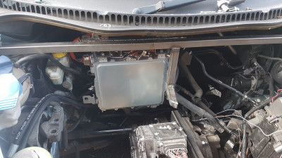

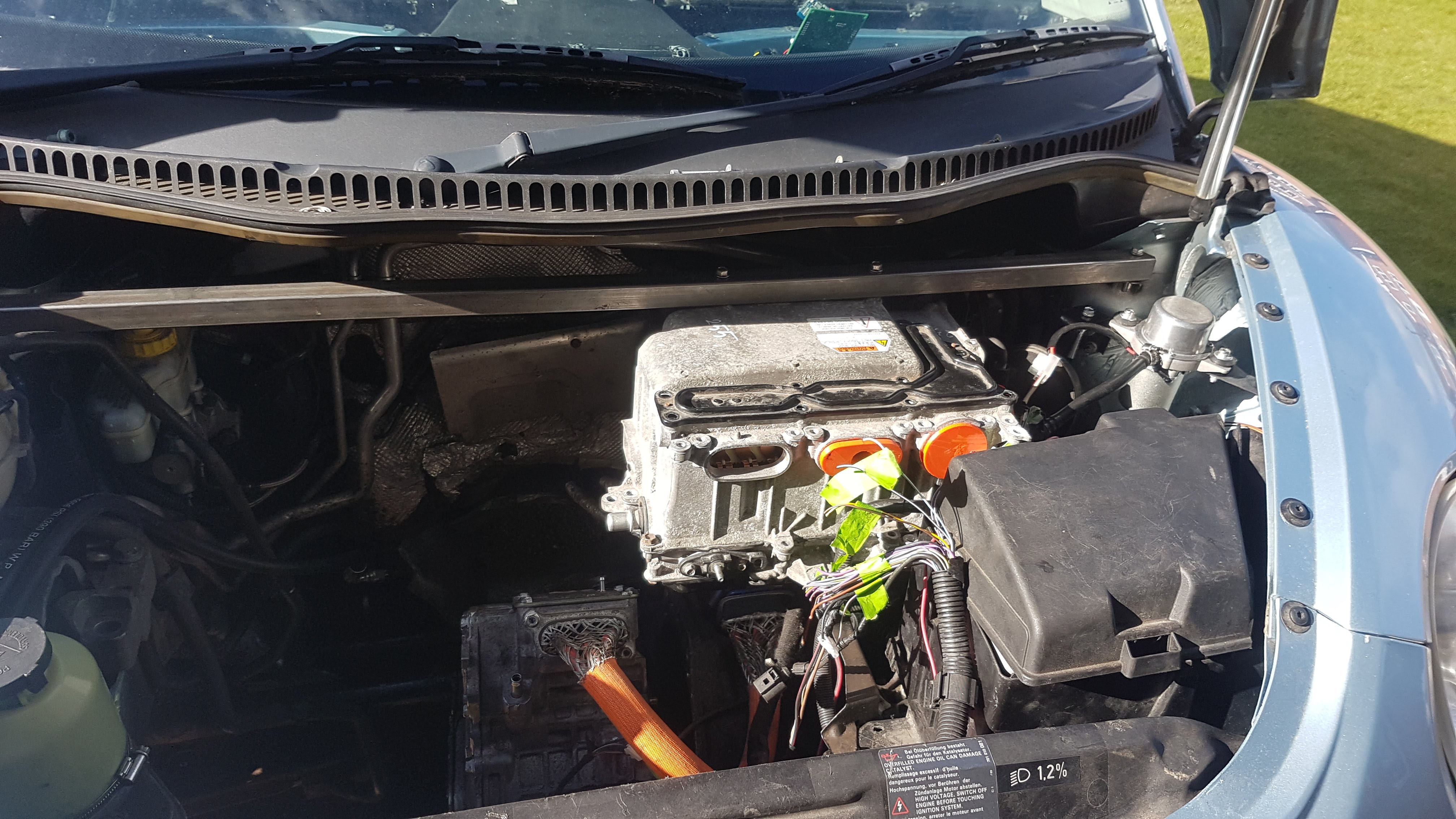

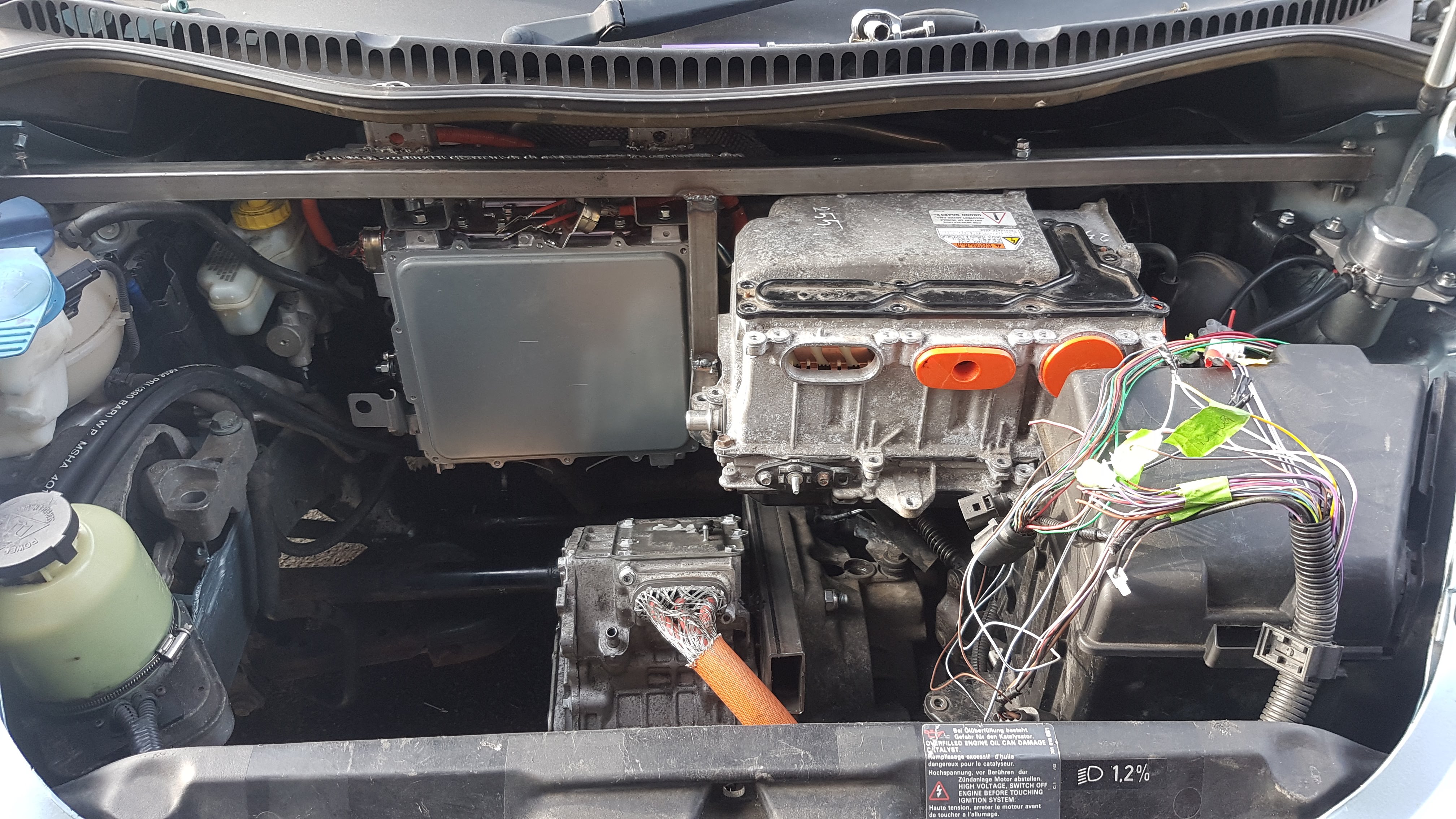

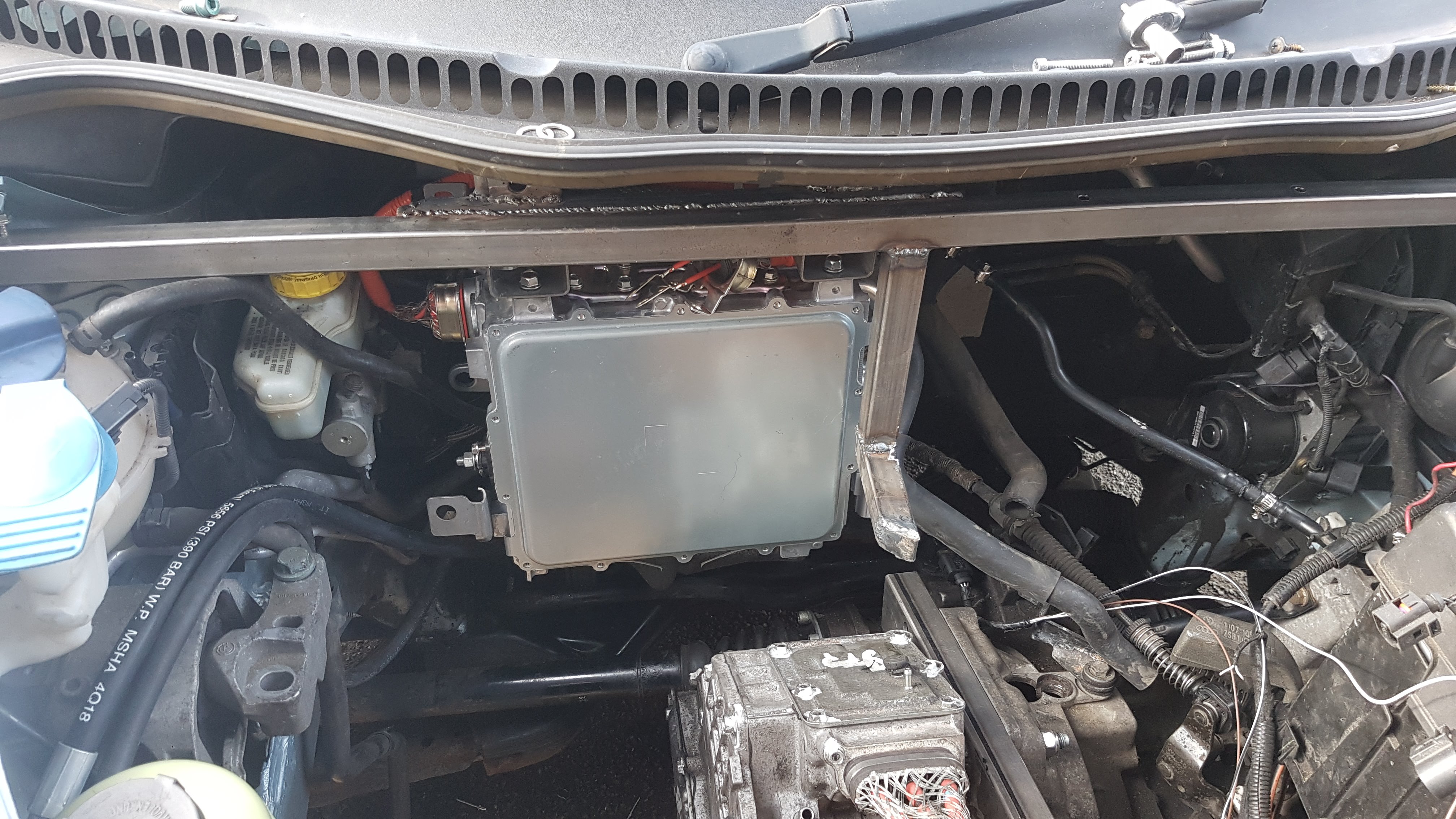

Made some more progress this weekend. I now have brake assist, though the pump is just rammed in there at the moment, so I need to make a bracket up. It comes on and off as required. Very pleased with this. Power steering also fires up when the key is turned to 'start'.

In Touran, ASR light was a matter of sending the right CAN messages as denoted in the stm32-car readme. My airbag light went on when I plugged the "front bumper sensor" into the reverse output of the transmission
- Posts: 1884
- Has thanked: 91 times
- Been thanked: 517 times
Re: VW - Beetle 2003
I'll have to check those out. I think the airbag light was on before I removed the engine. Apparently the loom under the passenger seat is a common cause.

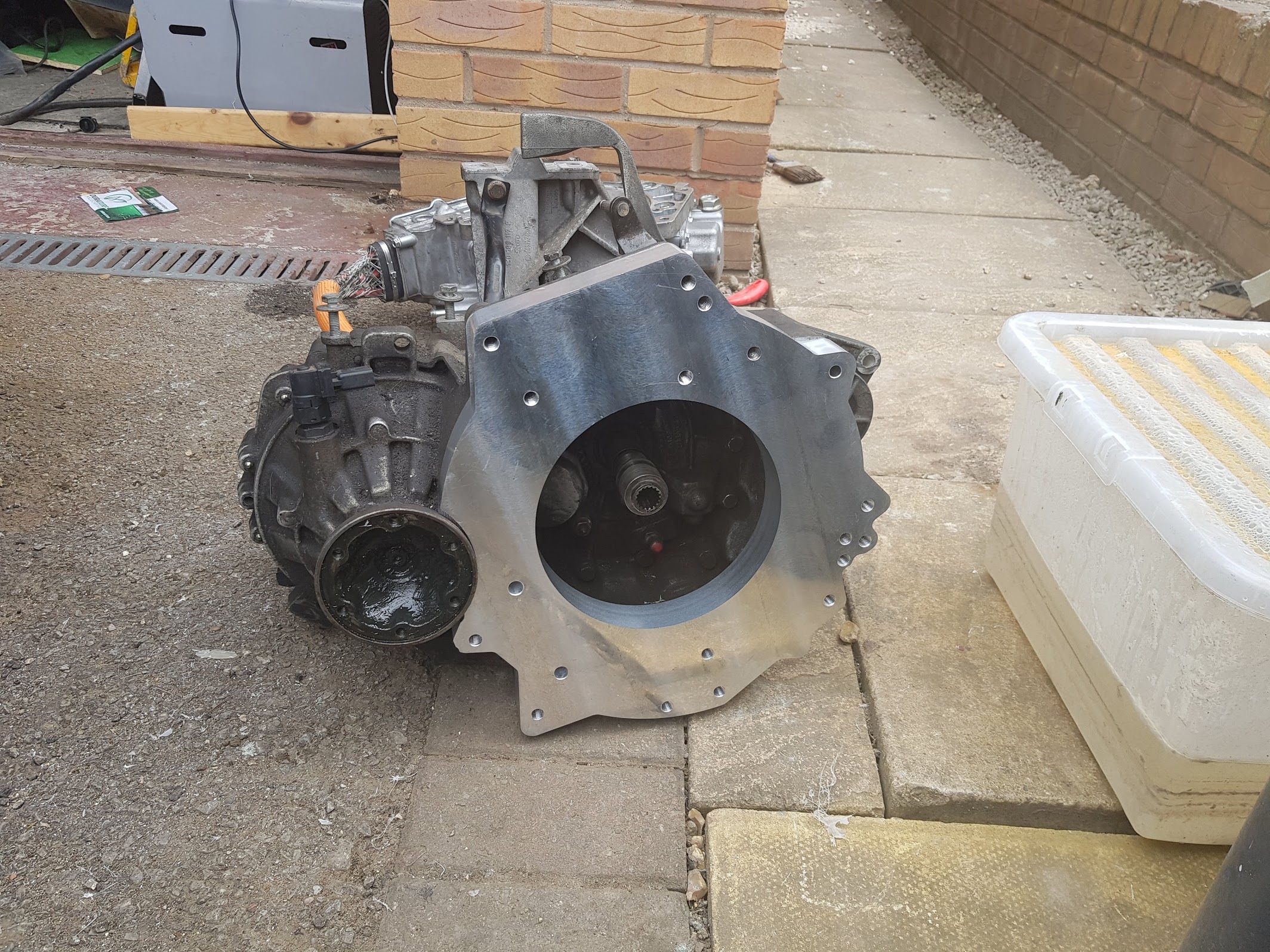

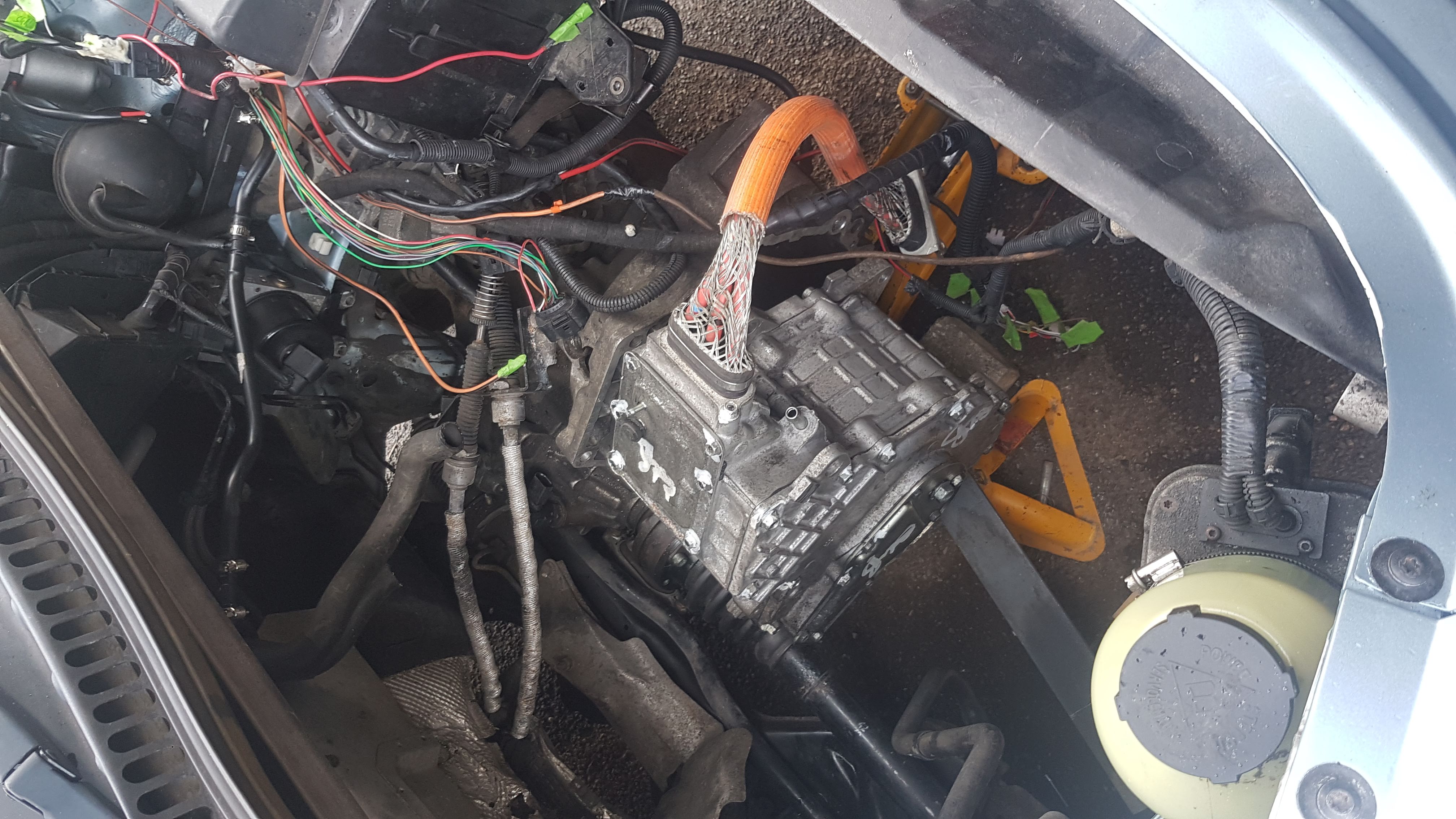

I've not got the gearbox back in yet. I had some runout on my coupler and I've made friends with a cnc machinist who is making me a coupler and adaptor plate. So looking forward to seeing what he comes up with.

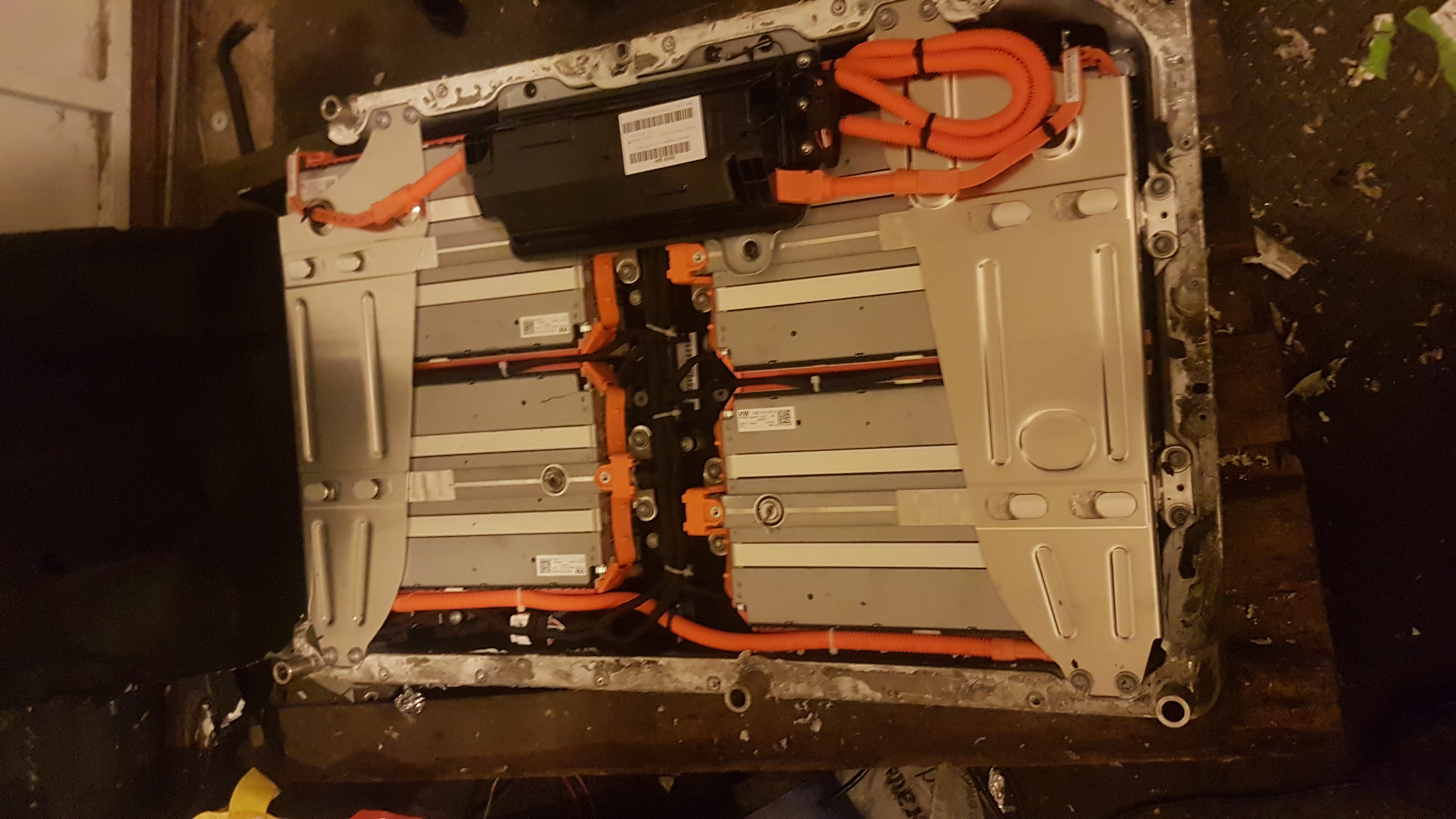

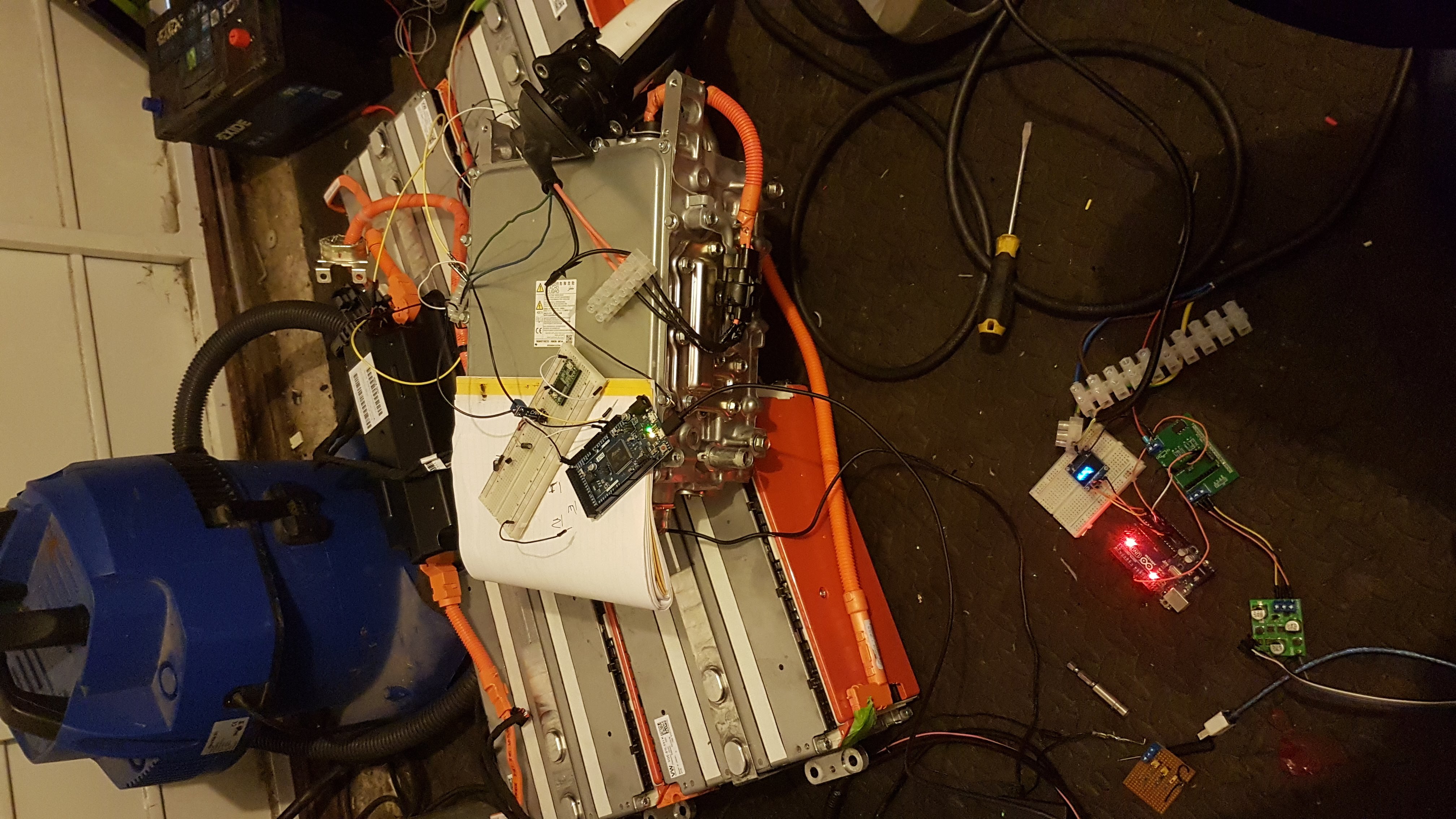

Battery pack arrived. It's 8.8kwh from a Golf GTE
It took some opening. The top was plastic and must have had a full tube of silicone round it.
The pack is sitting at 350v.

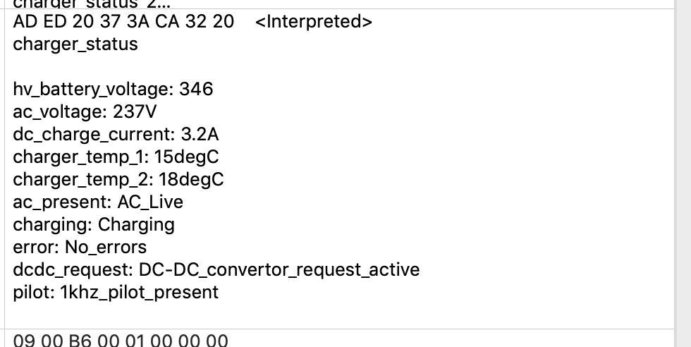

I've now got my pack charing with an outlander charger, current savvy can is sending the frames, but looking at integrating in to simpBMS

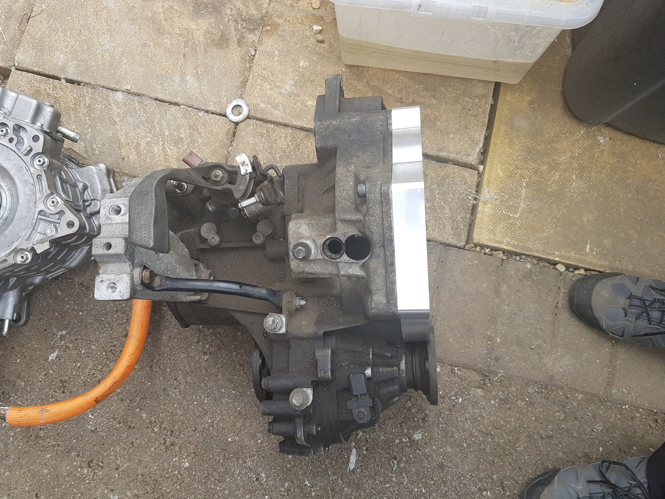

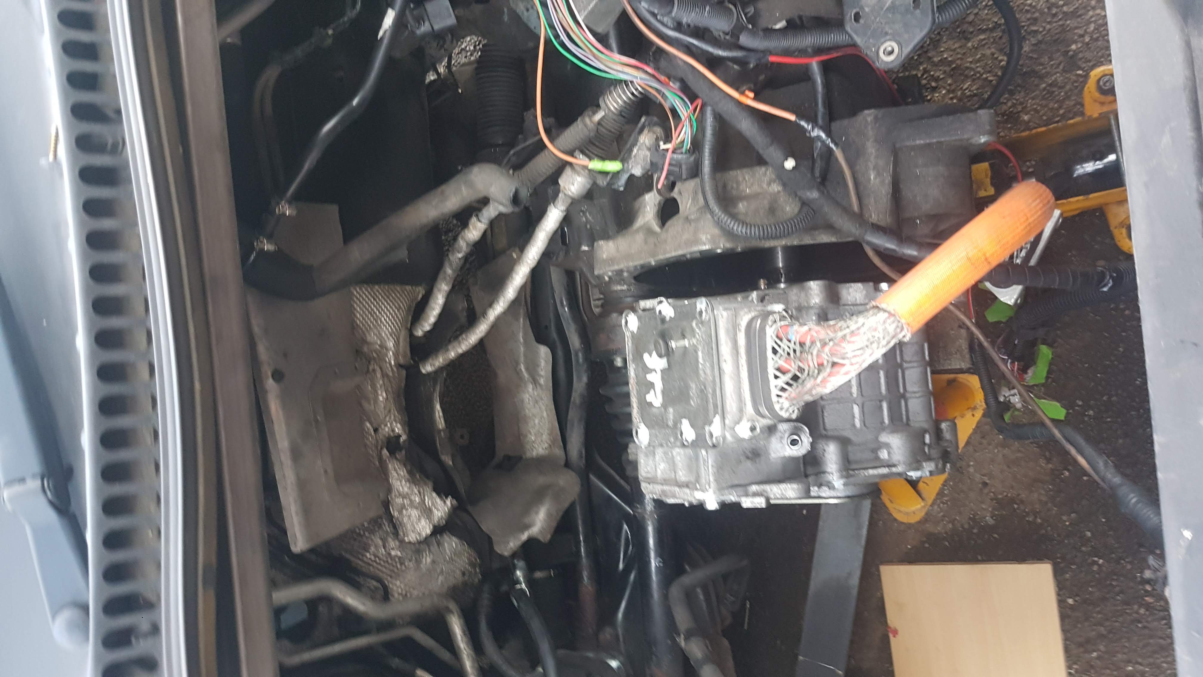

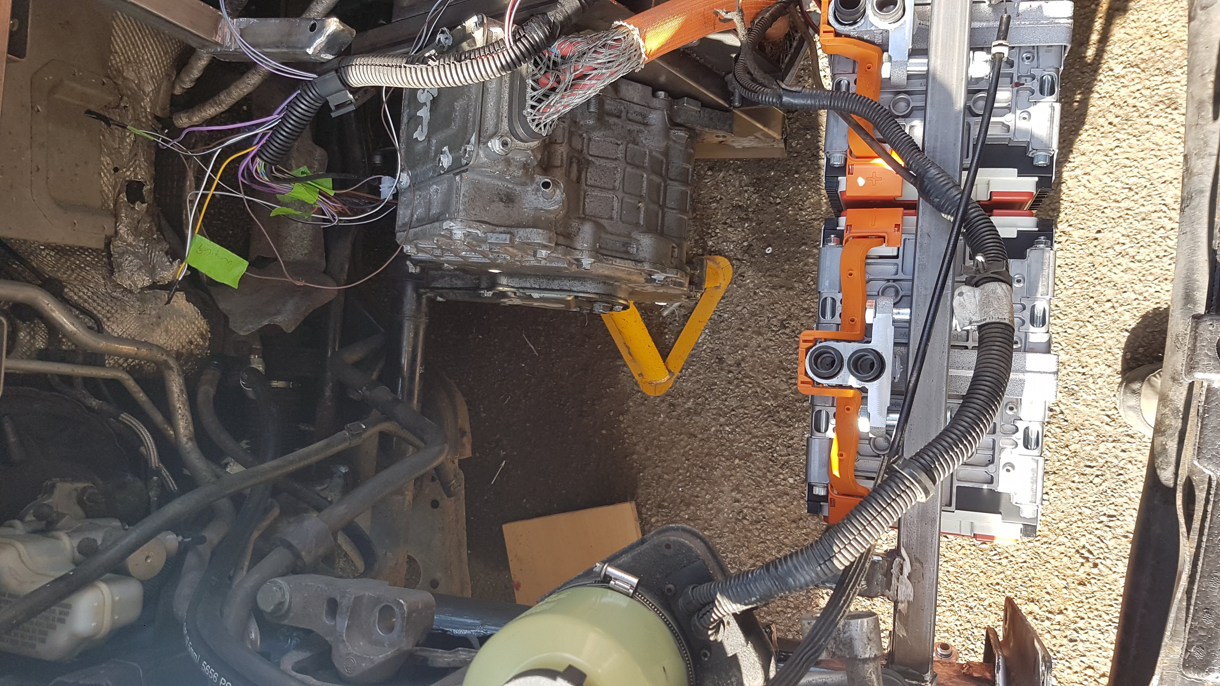

While I'm still waiting on the adaptor plate from the CNC bloke, I did get my coupler from him, so I've got on with re-mounting the gearbox and positioning the motor, and starting on getting the inverter in place.

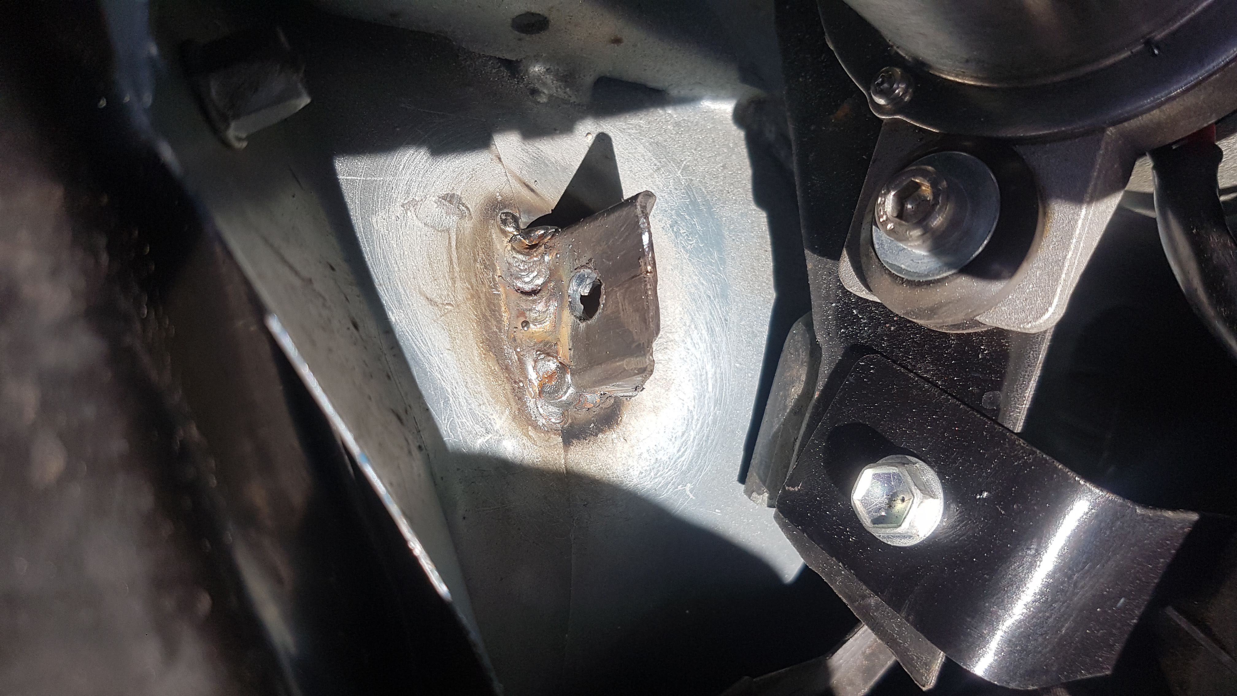

Outlander charger is mounted now. Battery modules next. Hopefully my CNC'd adaptor plate will be done soon so I can get the mounts finished for the motor.

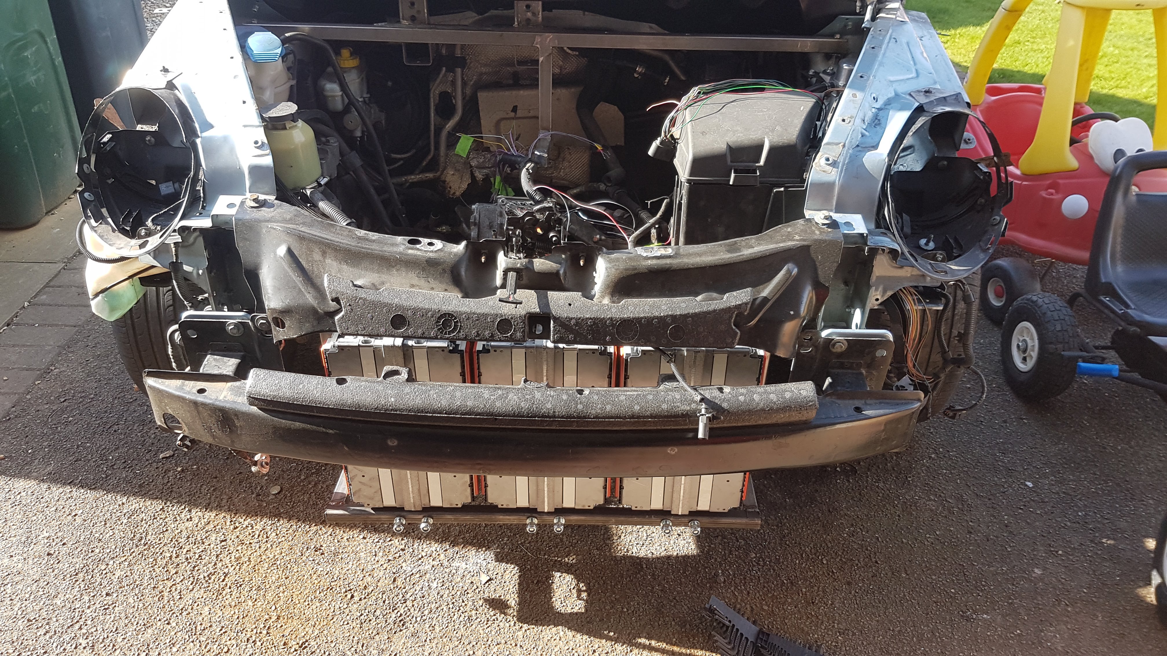

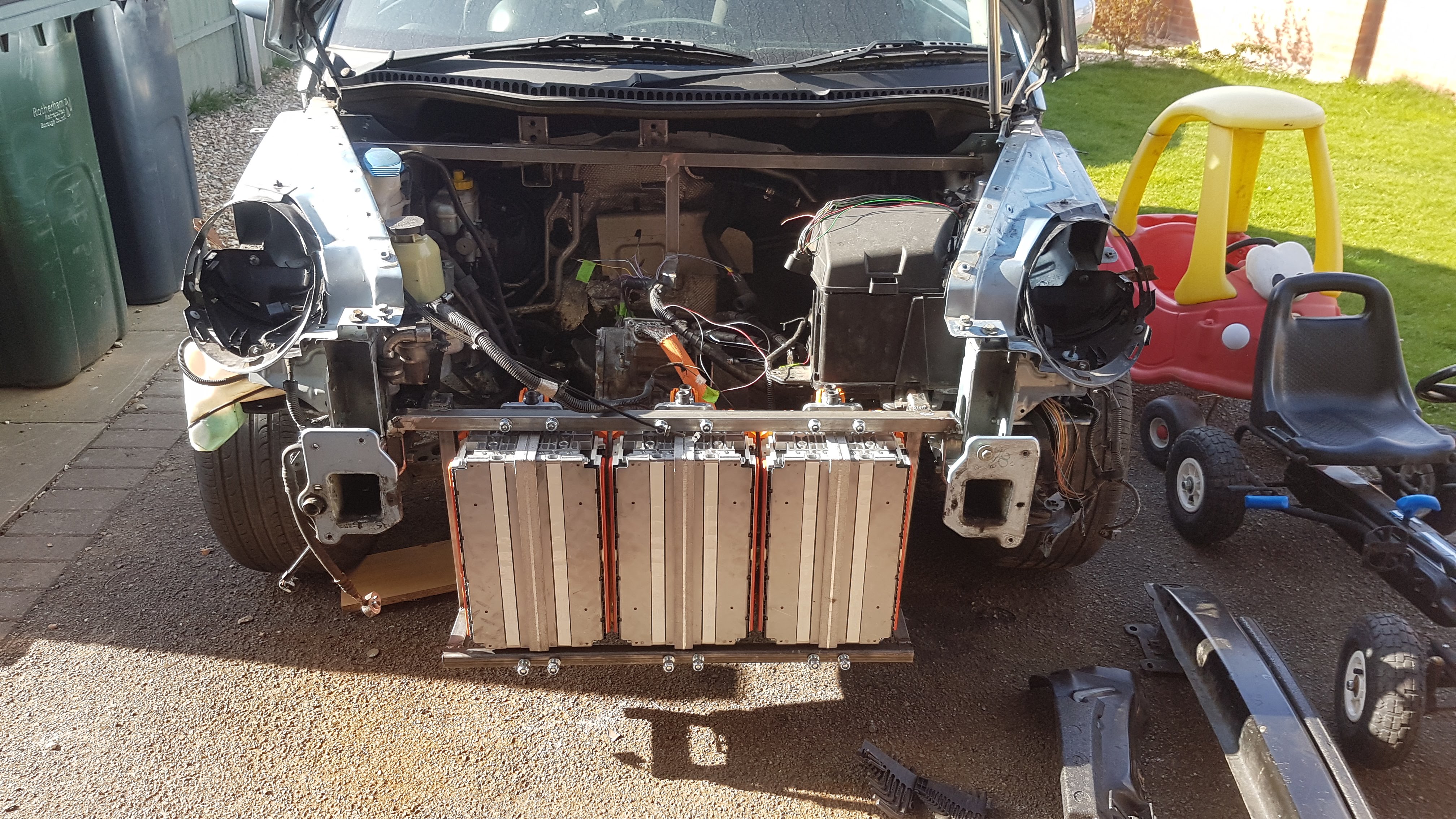

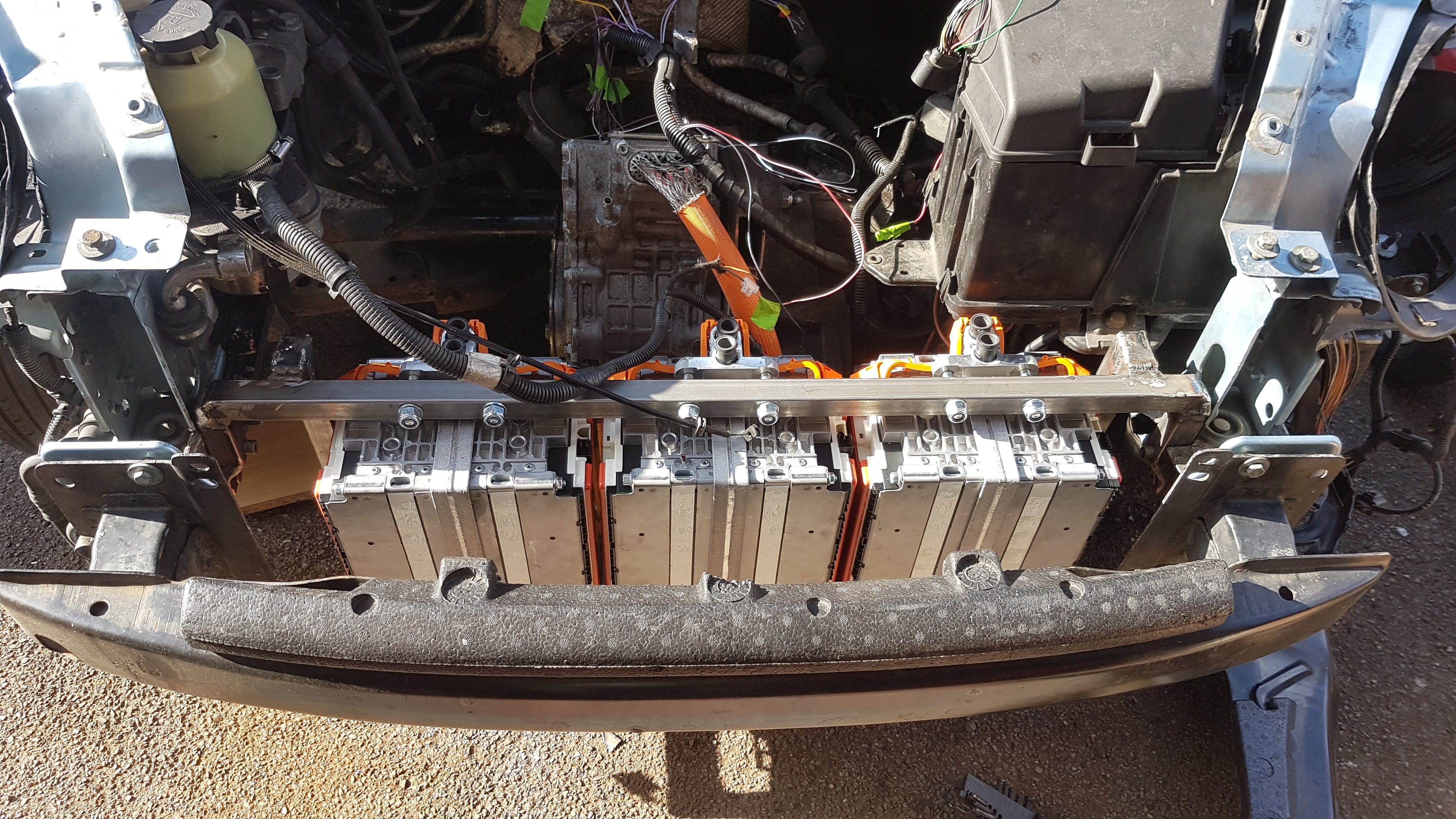

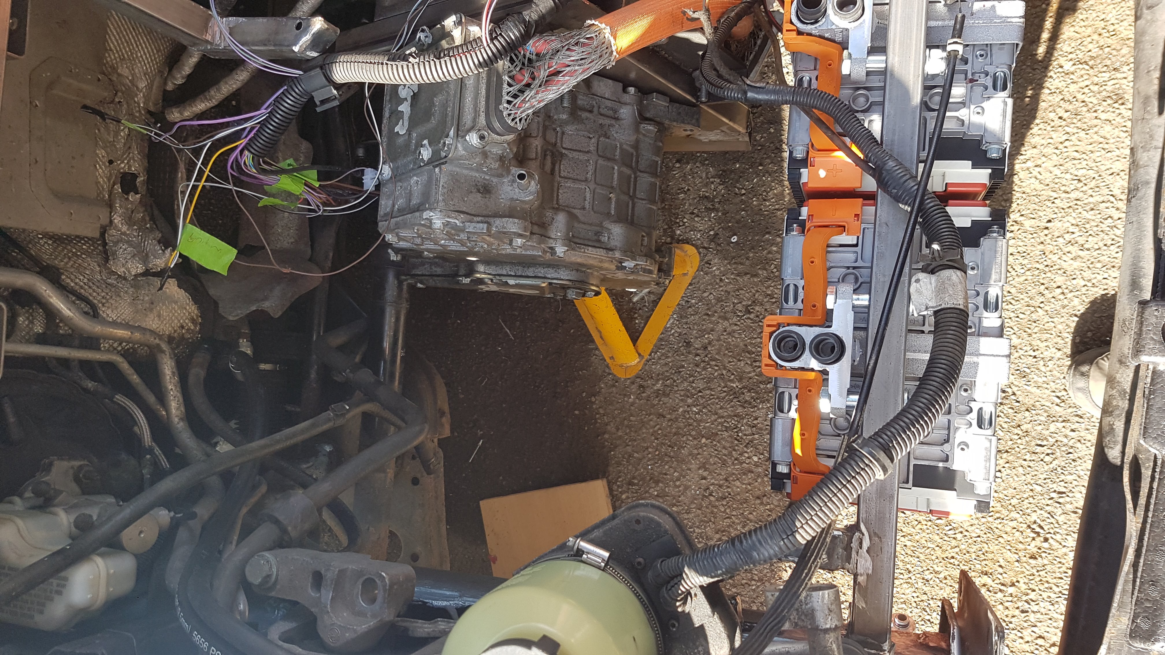

I little more progress on the battery mounting.
The are going in a L shape, once the mounting frame is done, I'm planning on making a fibreglass tub for them to sit in. Still need to make up a mount for the motor side to the old engine mount.
My adaptor plate has just been delivered.
