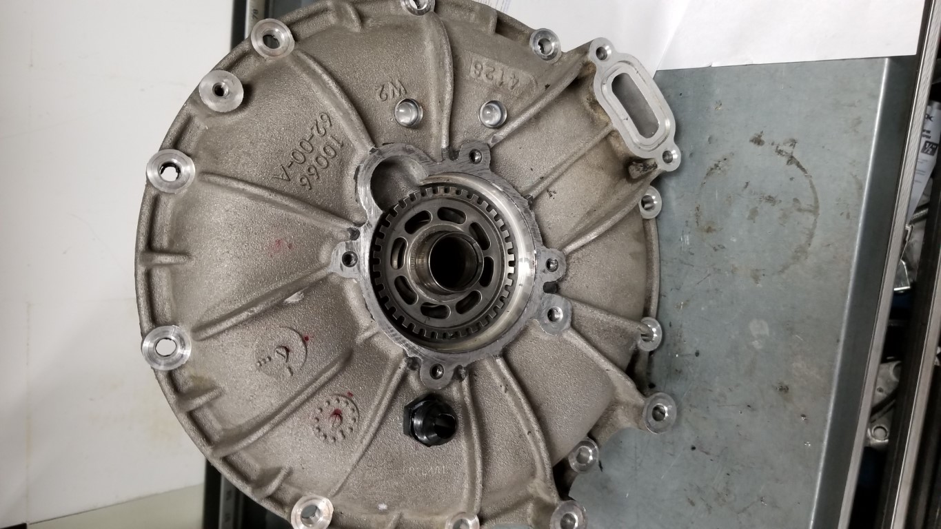

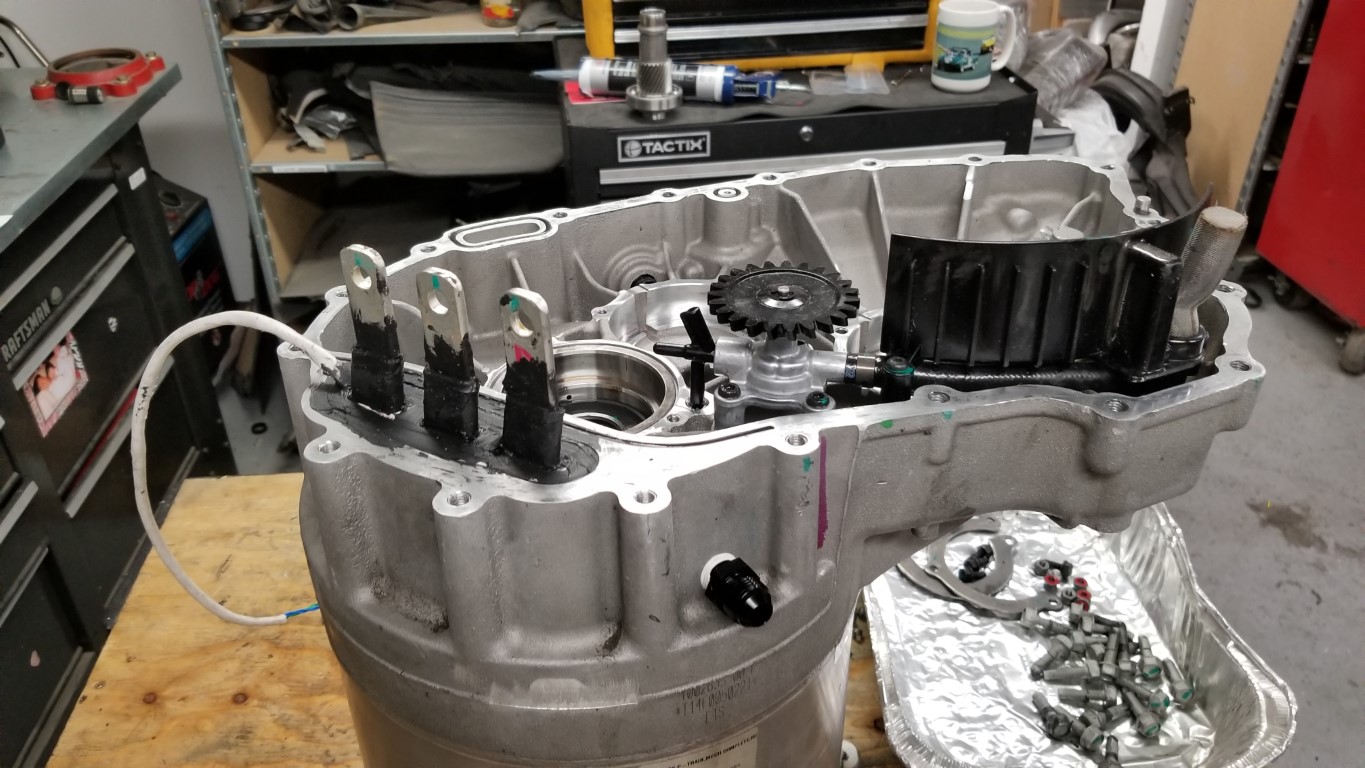

Jon:
AN fitting on front cover was used for injection. It is aligned with air gap. Sight plugs on right were used to see inside during testing
Drain plug at back of rotor cavity. Silicone sealant around bus bars to prevent fluid intrusion into inverter area.

Doug when I read of your idea to use oil injection to cool the drive on the other forum, I suspected friction was going to be a issue. You are nuts to have tried water! I would not have had the stones for it. My bet for success is a mist of a low billing novec fluid. Maybe a 45 or 55 c. Spray in a mist, it boils, and you remove the gas, condense and return it. Co2 or n2 might so work, hell just a tank of compressed air might work, I think you need about 500x the flow of water for air cooling to provide equle heat removal.
How did you remove condensate from the drive? Did you ever think of pulling a vacuum on the drive? A lot of that heat generation might be from friction heating of the air. Centrifuges pull vaccume on the rotor to keep Temps down.
So you have any numbers on what the water injection was able to do?
Bob
Bob

Re: Came acrossed this mad man
The spray water injection testing was only moderately successful. We were able to slow down the rate of overheating, but not stop it. We tested on the dyno and were somewhat limited by the dyno overheating. If I remember right, in our test run the stator might have reached 85 degC with the spray water off, and 65 degC with the water on.
We were spraying a finely atomized mist into the rotor gap. The water would flash to steam and exit the vent at atmospheric pressure. We did not need any vacuum assist.

Doug. Those are really interesting results. I may bench test my novec fluid idea. It basically is the same but if the fluid accumulates in the drive nothing goes smoke. The vaccume is to remove the air, not the water vapor. The air causes friction with the spinning rotor, and can heat the rotor significantly. Think skin of Lockheed blackbird a Mach 3. Evacuating the chamber might just do the trick.
