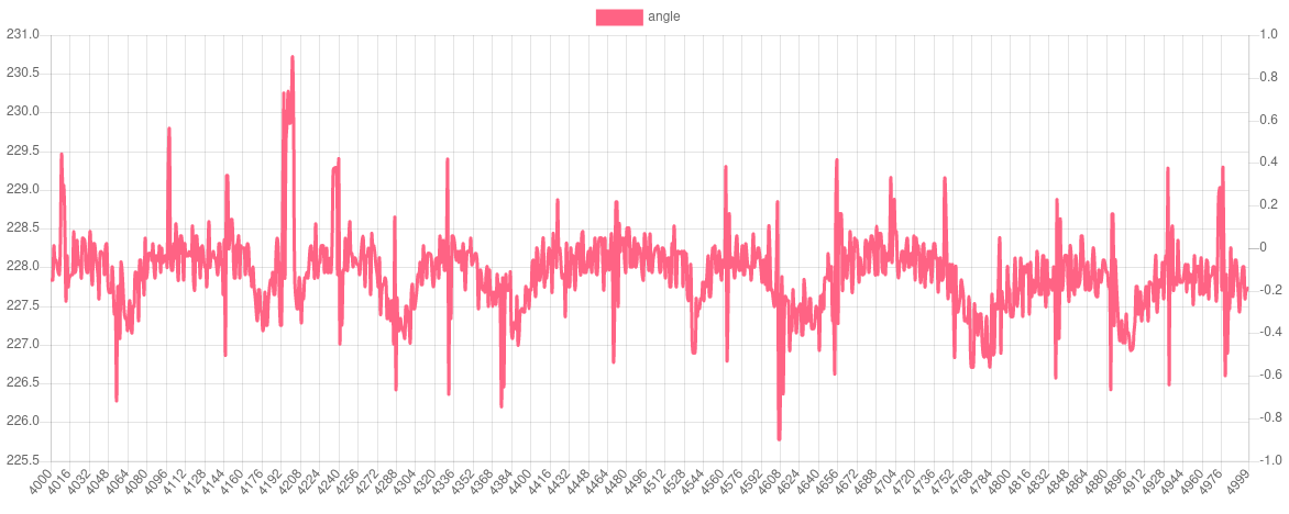

I have now replaced the stm32, reprogrammed it and tested. The spikes in angle plot is still there... I don't know whats wrong or what I'm doing wrong but this is beyond me??

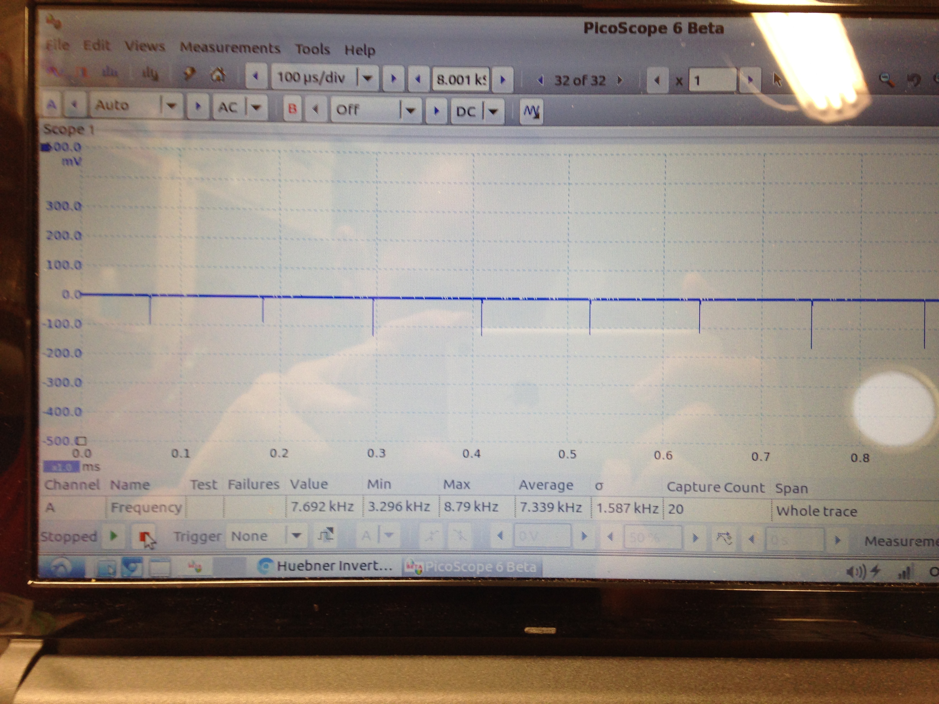

When doing an AC-measurement on C27 and C28 I see a disturbance at 8,8kHz and up to 20mV peak. Amplitude and sign varies with the adjustment of the input voltage at the resolver input. I'm feeding in dc-voltages and using SinCos as encoder setting. The disturbance is for a set input the same sign.
What is running at 8,8kHz on the board? I'm running inverter at 4,4kHz and resolver exciter is not active in SinCos encoder mode.
How can I calculate the time a certain number of data points corresponds to in the angle plot?
EDIT:
When I inhibit PWM by removing my 5V supply to R38 the disturbance is gone on the scope. However the angle output is also stopped. Any way I can inhibit PWM but still get angle output?

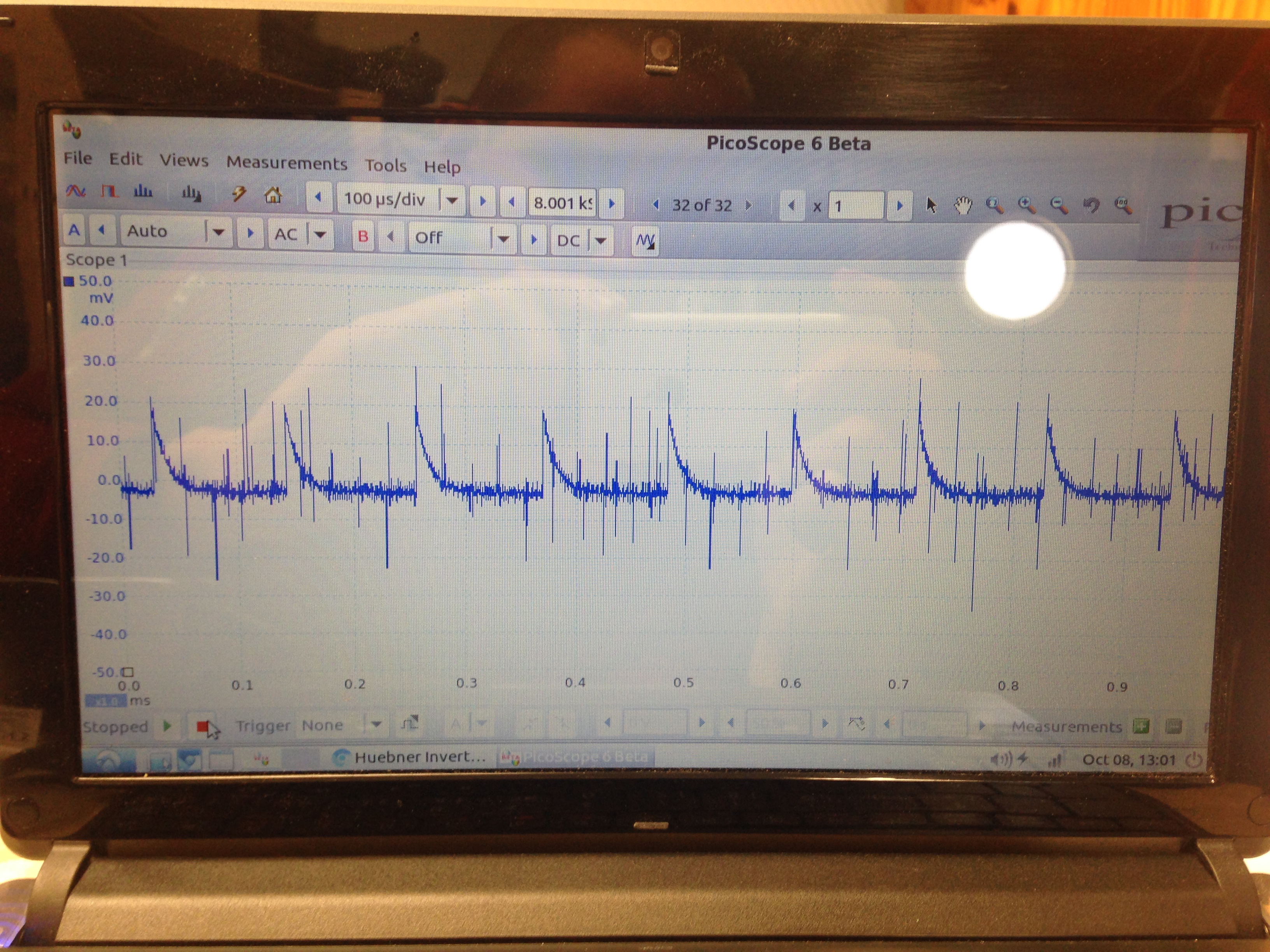

A picture from scope, probe at C27.

As I'm running on bench in manual mode I don't have any PWM output. And also no change in disturbance frequency when changing PWM frequency.

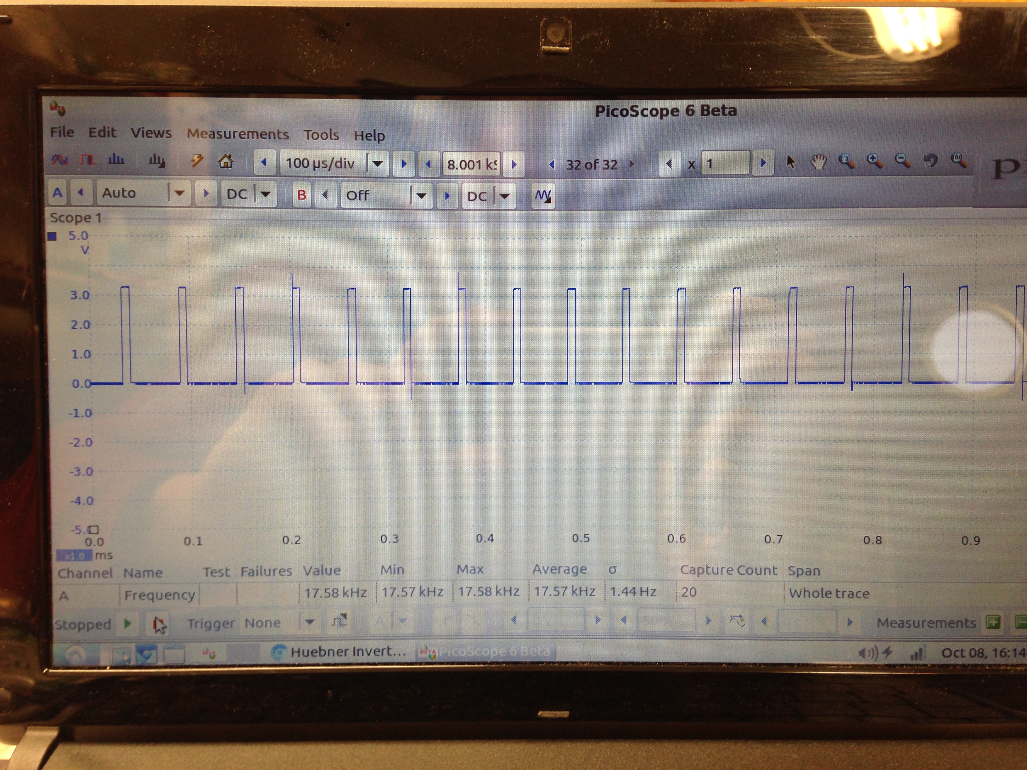

I've been trying to probe around on the board but still can't find anything creating this signal.
Also, as mentioned before, no exciter output either, as expected, but what else is running at 8,8kHz on the board?
EDIT:
I probed all pin on the stm32.
On pin 61 which is NC but still outputs a signal at 17,7kHz, twice what I'm looking for. Also at pin 14 I found this. Why is there so much disturbance on a signal going to GND via a resistor with the exact frequency I'm searching for?

I get the same behavior at the ADC inputs when running the SW on my blue pill. I have tried different sources of 3,3V for this setup and the result are the same. I think there is a problem in the SW and how the clocks and ADC are setup? I know to little about this micro controller to have any usefull input but the disturbance I can see is at 8,8kHz and goes away if the MG2_PWM_INHIBIT is high.
Any comments on this? Is this possibly a SW issue?

So keep in mind the software runs on numerous devices with resolver and doesn't play up. Please check on github in param_prj.h which version still shows the raw "sin" and "cos" inputs. It was one of the early FOC versions.
Regarding your findings: you discovered the pin that normally generates the PWM for the comparator reference (over current protection). That comparator is not present on the Prius board but the PWM runs anyway.
Also the control loop frequency is always 8.8 kHz regardless the PWM frequency. So you're seeing the ADC sampling but little blips of 20mV will not cause a large angle swing.
When you shut down PWM, the sampling also stops, thats why it looks clean then. Currently I have no idea, I think a software with sin and cos display hopefully reveals the problem.

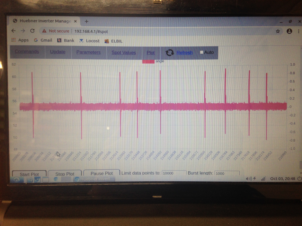

I'm just trying to find out why I have spikes in the angle plot signal. I'm under the impression that the angle signal should move max 1 degree or so and I see spikes in ranges of 10 degrees. Should I just ignore the spikes and move on? Have I created a problem that is not there due to me misunderstanding what should and should not be ok? Would you say that the spikes in angle is not a problem? The reason I started to dig into this is because I'm having trouble finding the syncofs value and it then came to my attention that the spikes in angle plot should not be there.johu wrote: ↑Fri Oct 09, 2020 10:32 pm So keep in mind the software runs on numerous devices with resolver and doesn't play up. Please check on github in param_prj.h which version still shows the raw "sin" and "cos" inputs. It was one of the early FOC versions.
Side note: It does not mean that everyone is experience a problem even though the problem might be there? I find it very odd that I see the same behavior on two very different HW. Almost the only thing the Yaris board and the Bluepill has in common is the SW.
I'm not able to find any SW with the sin and cos param lines not commented out in the param_prj.h? Or have I been looking for the wrong thing?
/* VALUE_ENTRY(sin, "°" ) \
VALUE_ENTRY(cos, "°" ) \*/
I'm agreeing that the 20mV dips on the ADC signal can not be the cause of a 10 degree fluctuation in the angle, when doing the math of how angle is calculated. But question remains, what then can be the cause of the spikes?

But why do I have the same issue with spikes in the angle plot when I run the SW on another board, my blue pill? In my opinion, that suggests it is not the board itself?
Do we all agree that the spikes in the angle plot should not be there and you have not seen them in any of your working boards?

Yes. Could it be your power supply? Are you running a sufficient amplitude into the sin/cos pins? The calculation at some point calculates the quotient sin/cos so if both are small amplitude the SNR decreases.
Absolutely, +/-1° is pretty much the most you should see. Like that little noise floor between the blips.

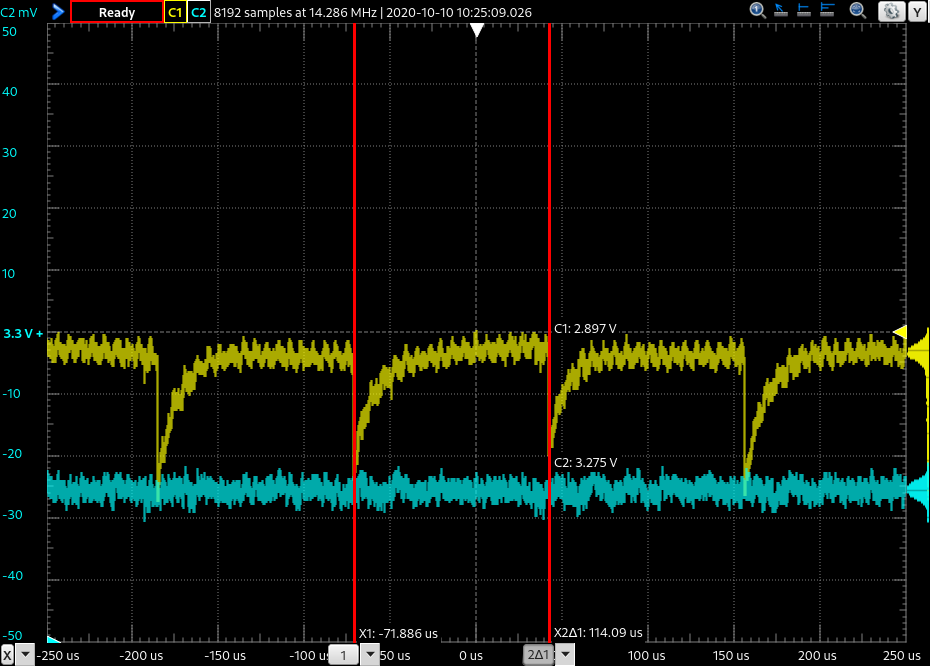

Did some plotting myself.
So with my test setup I'm also getting about 5° jitter. The supply voltage (blue) looks pretty clean (10mV/div) and I'm getting the same blips at 8.8 kHz. I'd say you can roll with that.

If I understand the math done in SW correctly it would require a pulse of 150mV to get a fault of 5 degree in angle.
Only the spikes I measured at Pin 14 are in this magnitude. This pin is pulled high to 3,3V on the PCB.

I'm afraid I can't let this problem go, it bothers me to much, so please bare with me.
When searching in the datasheet for the STM I can conclude that there might be a current draw of up to +-1uA when the ADC is used and has an internal resistance of 1kohm. This means, with an external resistance of 10kohm, a total of 11kohm and 1uA. That's 11mV in worst case. The pulses observed are in range of 25mV, which I find odd.
Is the ADC read only once every "control loop turn" i.e. at 8,8kHz?
Also to get the spikes magnitudes seen in angle plot it would require a magnitude of 100-150mV. This can be observed at pin 14, also possible to connect to ADC...? Pin 14 is pulled high to 3,3V via an external 1kohm resistor. To get a voltage drop of 100mV requires 100uA.
In the schematics this pin in annotated "MG2_UVLO_IN_14". If this pin truely is an input, why is there a 100uA current draw every "control loop turn" on this pin?? It makes no sens to me. I'm thinking that something is set as an low output for a short period of time.
I'm stuck on the idea that there is something going on internaly in the uC that causes the spikes seen in angle plot. Since I have tested it on three uC and Johannes also can see similar results it is not just a coincidence. Even if this may or may not have a large effect on the performance of the inverter it is still worth looking into unexplained behaviors. I'm not a programmer so I really struggle understanding where to look in the SW for clues so any pointers on where to start looking is much appreciated.

Yes sin/cos is sampled once every 125µs in a one shot fashion. All other values are continuously sampled

To be clear, the control loop runs at 8,8kHz or approx 114us and the ADC samples sin/cos input at 8,0kHz or 125us. Is this correct?
If so, it would further strengthen that something in control loop is drawing current and not the ADC sampling as the disturbance seen on ADC inputs are at 114us appart.

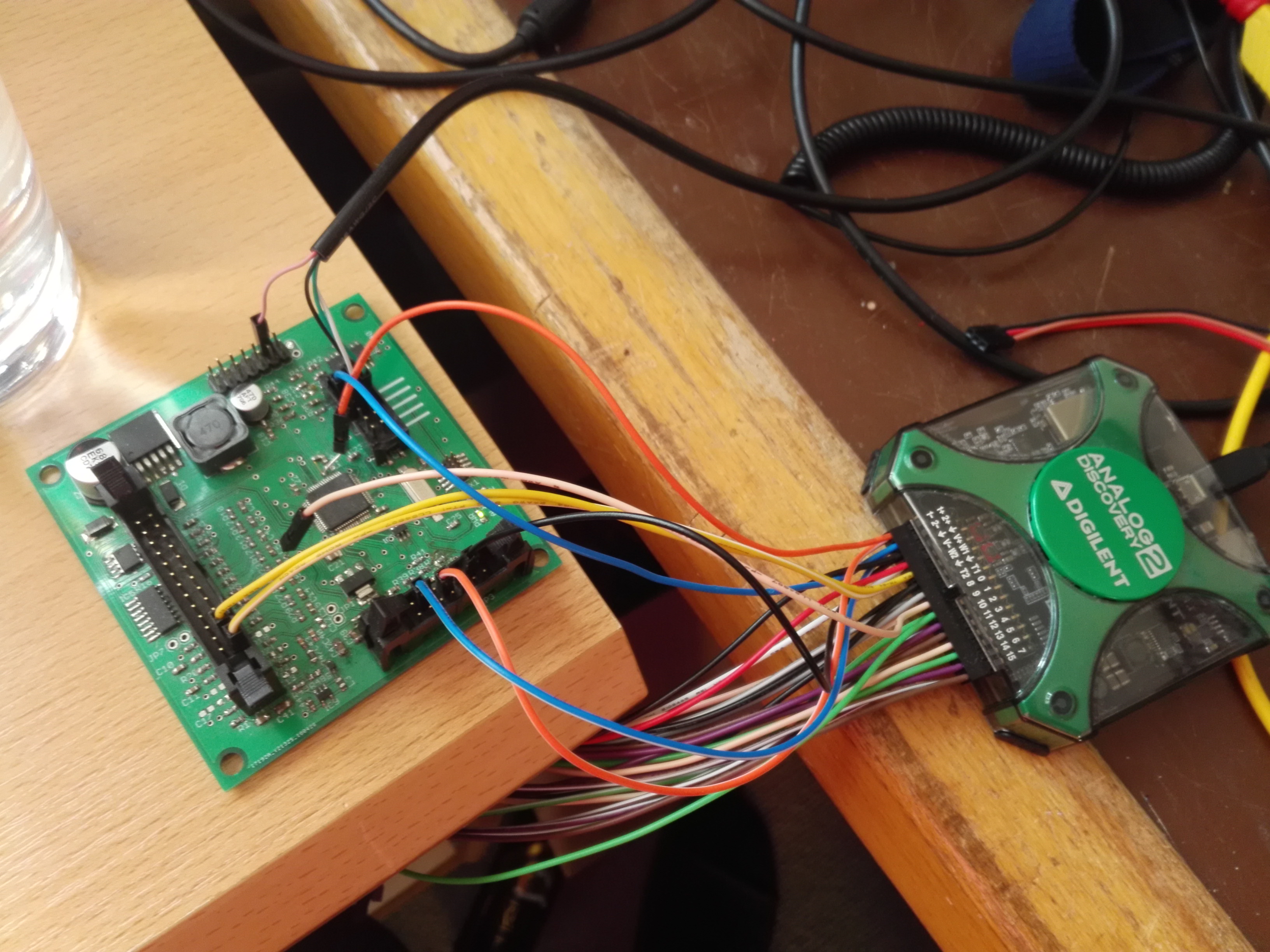

After looking around in the SW. In hwinit.cpp there is a funtion detect_hw which does a is_floating(GPIOA, GPIO0), thats pin 14 on the Yaris board.
Is this function run once at startup or every control loop?
I can't figure out which is the "main" program file? so don't know when this is called.
When looking at the voltage measurement from johu it is according to my math possible to get a voltage change of 25mV/250us from a 1nF capacitor using a 30k resistor. That is the fast voltage change (dip) and then recharge (rise) via 10k and 1nF in ~40us.
And also a voltage division between external 1k resistor pullup and 30k to gnd will result in a dip of 106mV.
Just saying it might be possible to cause this behavior using a 30k pullup/pulldown resistor.

Re: Large jitter on angle in resolver and sincos mode
Or maybe it is not a SW issue after all... I have found some interesting info on the ADC and that the input filter 10kohm/1nF might have to high impedance. I will make measurements on this and report back. Probably have time on thursday for this.
ADC clock frequency effects what impedance can be used.
