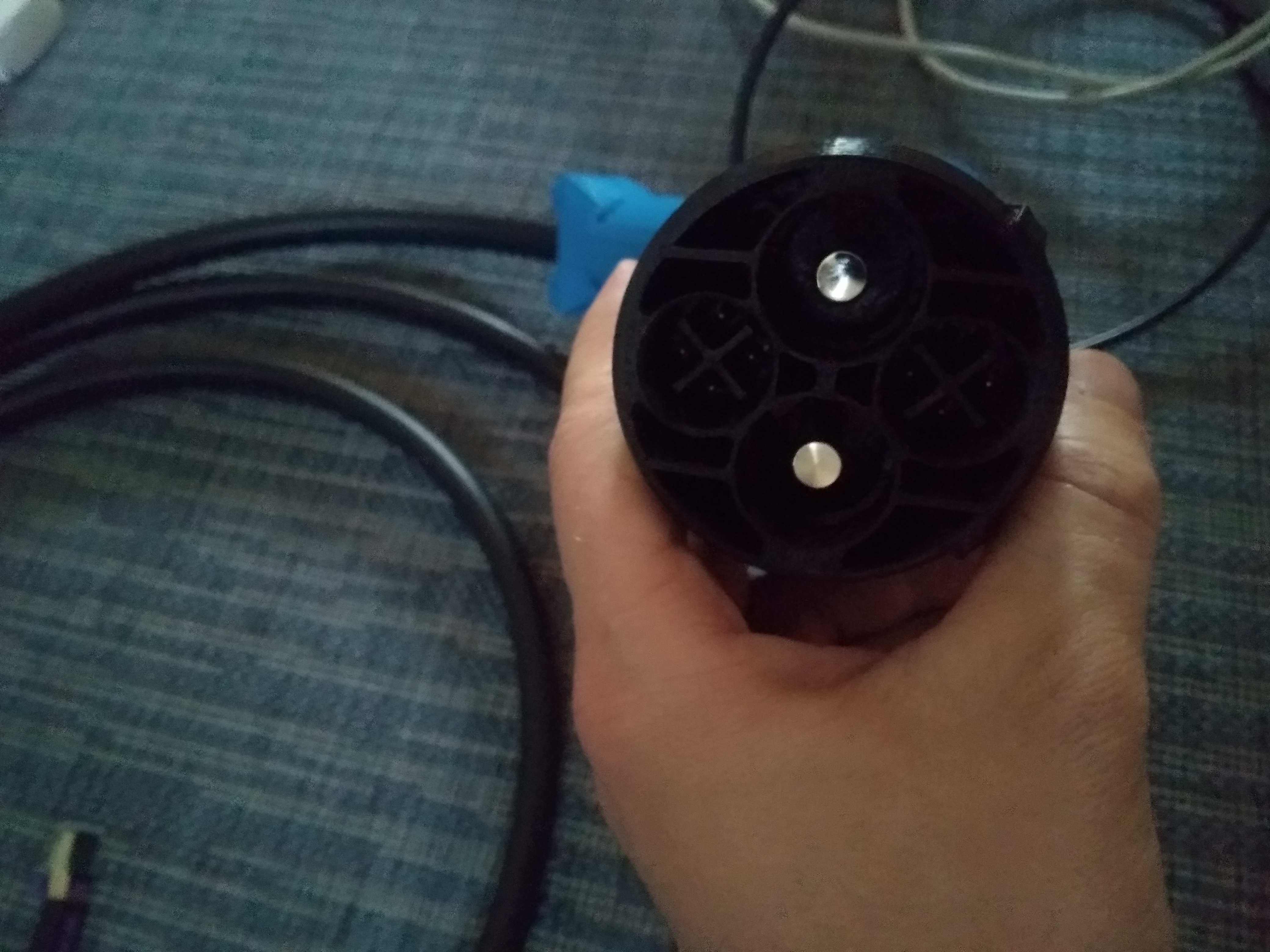

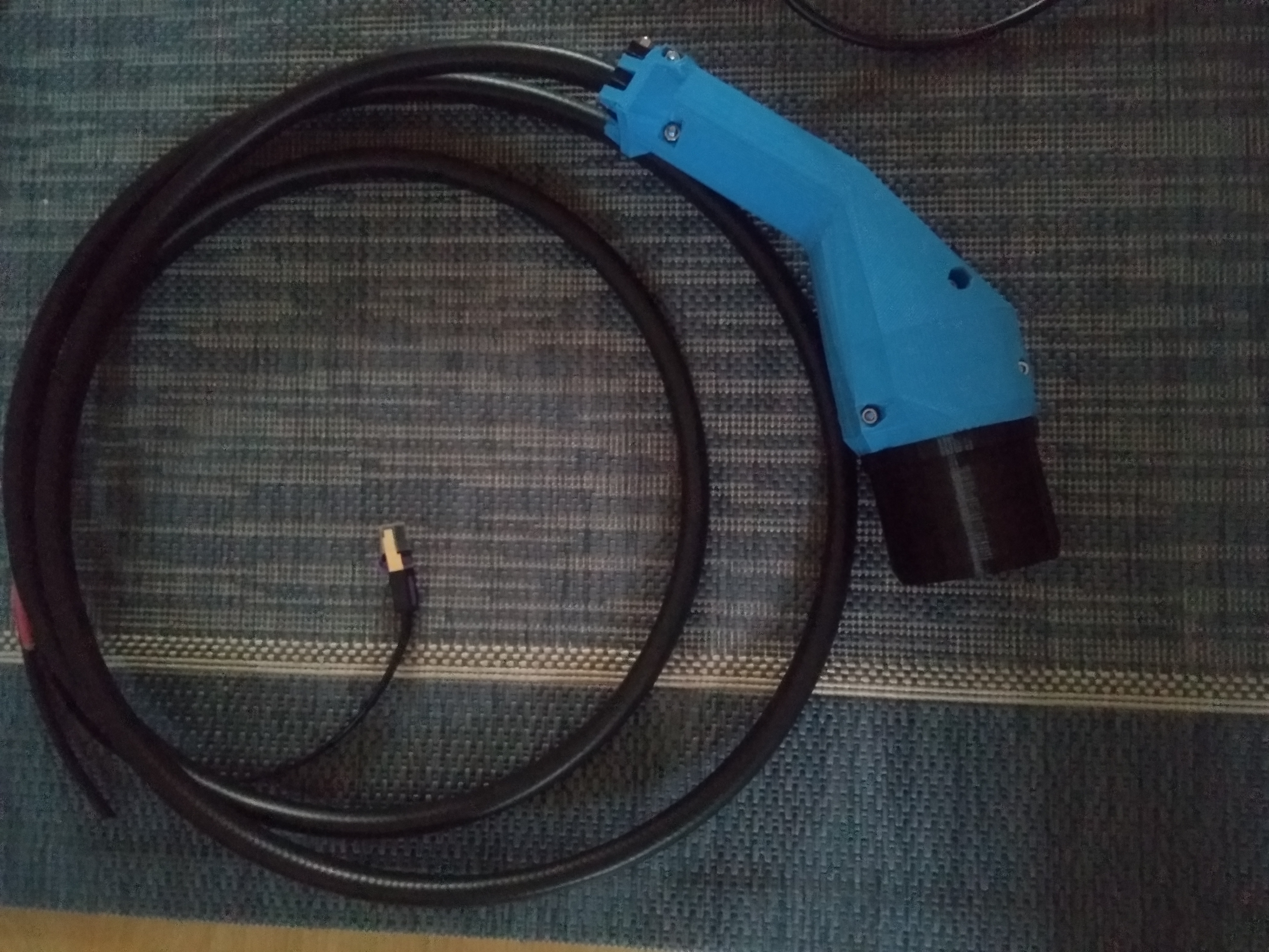

here is my chademo plug twin :)
I am working on ccs (car) to chademo (charger) adapter. I am planning use foccci board for ccs side and my developed hardware for chademo (charger) side.

Did not understand which variant you are planning. Charging a CCS car on a ChaDeMo charger? Or the other way around, like Johus Touran adaptor?
explorer232
Posts: 15
Joined: Mon Oct 09, 2023 11:25 am
Location: Slovakia
Re: Is it possible to make a CCS to CHAdeMO adapter?
Post by explorer232 »
uhi22 wrote: Tue Oct 24, 2023 5:31 pm Did not understand which variant you are planning. Charging a CCS car on a ChaDeMo charger? Or the other way around, like Johus Touran adaptor?
Sorry, on the picture is diy chademo male connector so its for charging Nissan Leaf from ccs charger - CCS(car side) to chademo (charger side) adaptor

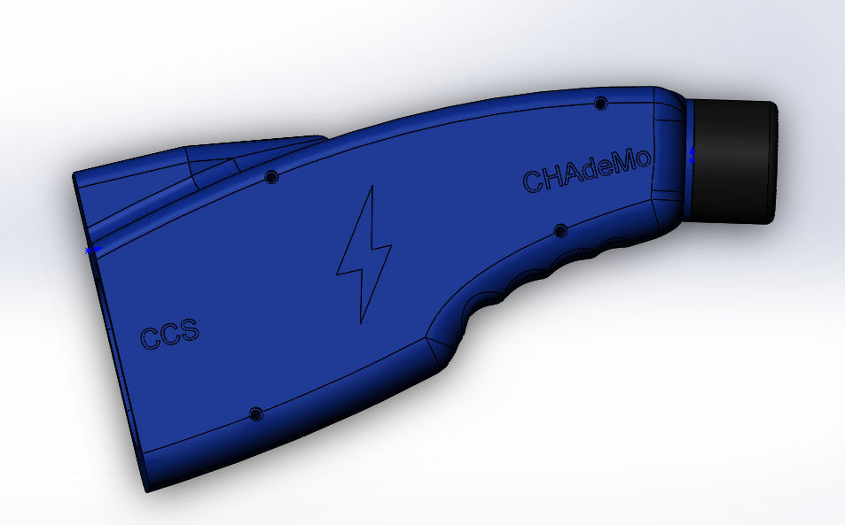

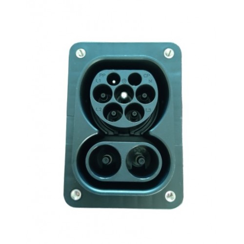

First attemp to design adaptor case for standard ccs socket from ali.

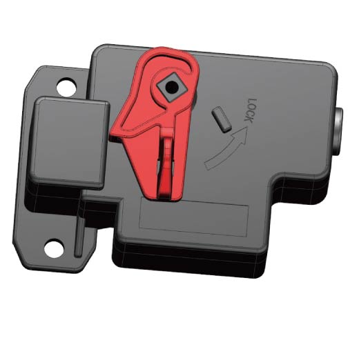

*Added ccs lock (Socket Actuator Uchen DSIEC-ELM ) to design
uhi22
Posts: 1245
Location: Ingolstadt/Germany
Has thanked: 245 times
Been thanked: 684 times
Post by uhi22 »
To reduce the bending moment on the ChaDeMo connector, I would suggest an angled connector 20 to 30 degrees instead of the straight line, so that the electronics, the CCS socket and the CCS connector is located below the center line of the ChaDeMo.

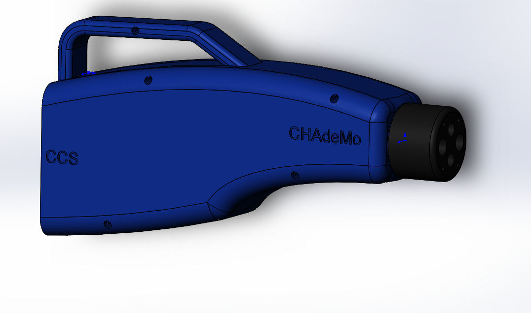

explorer232
Posts: 15
Location: Slovakia
uhi22 wrote: Thu Nov 02, 2023 7:18 pm To reduce the bending moment on the ChaDeMo connector, I would suggest an angled connector 20 to 30 degrees instead of the straight line, so that the electronics, the CCS socket and the CCS connector is located below the center line of the ChaDeMo.
Thanks for your tip. Fixed
