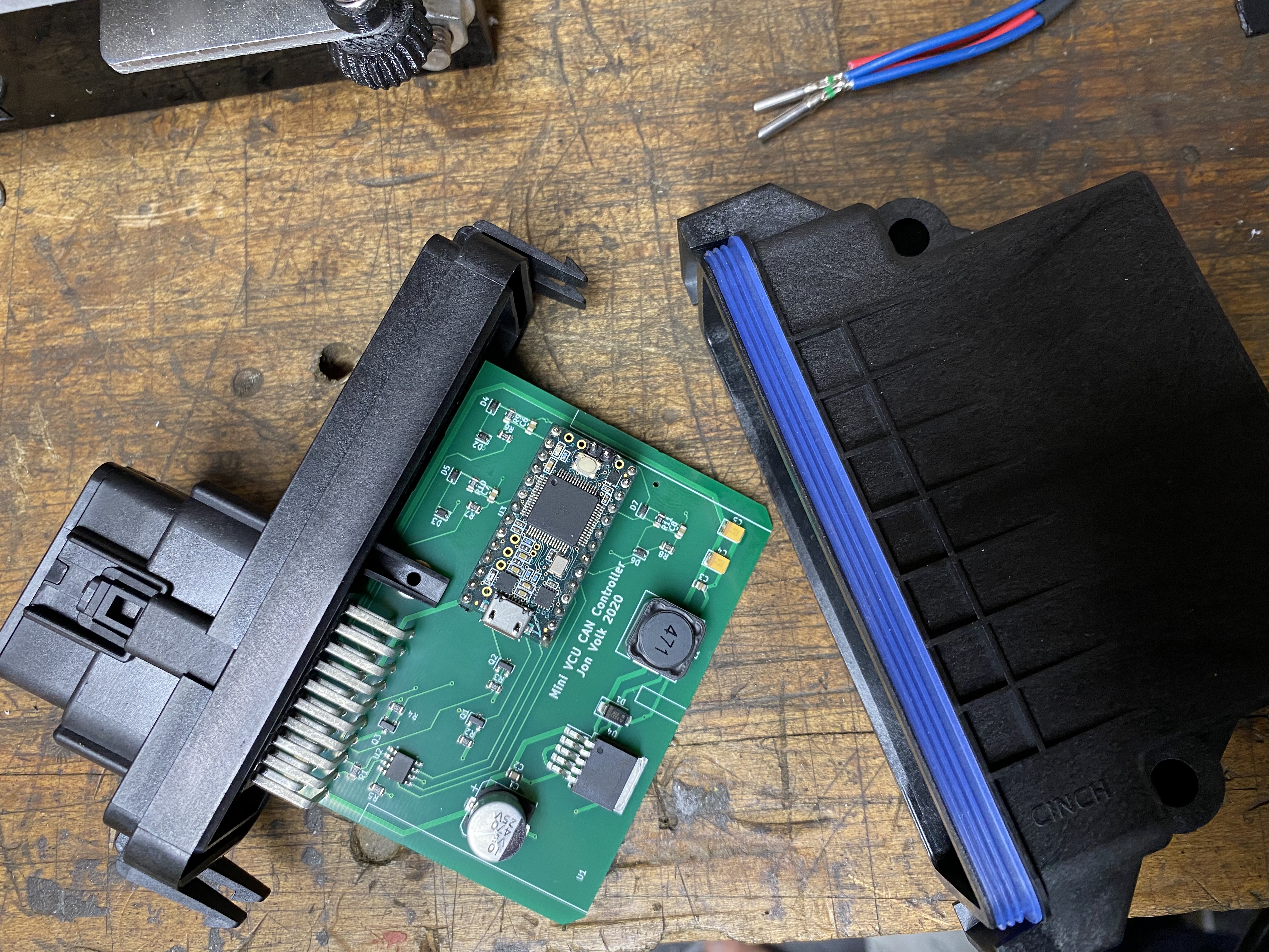

If anyone wants to play with this stuff on your own without breadboards, I’ve got a couple of these available.
viewtopic.php?f=12&t=1129

So I thought I'd revisit this. As what initiated this thread, Ive still been running some CAN based parameter mapping on my LDU board. This has resulted in very smooth operation without any real issues to speak of in function. Im still running a Teensy based VCU in the car and as the list of connected CAN devices has grown, along with adding more functions to the overall code, the Arduino abstraction (along with my poor optimization) is adding noticeable lag in moving messages where they need to go. Since fweak is one of the parameters that is changed with throttle input, a lag here can in rare occasions result in an overcurrent trip with a fast whack of the throttle since creates a higher change "step" than desired.
My first fix was to start porting the code over to one of Damiens F105 boards as I'm trying to focus on ST based hardware now. In doing so, I decided it would be more efficient and faster (possibly safer) to hard code the changes per Johannes interest above.
Below is an incorrectly branched version of 4.97 firmware. I probably should have done it the "correct" way, but this was a clone that was simply re-initialized locally. Before attempting to run this on an actual motor, Id like to request Johannes give it a quick once over and let me know if there's any glaring issues that may cause undesired behavior.
The changes themselves are pretty simple and limited to 3 files. mymath.h, stm32_sine.cpp and pwmgeneration_sine.cpp. In mymath, I added the macro for a MAP function which is taken from the Arduino. Understanding that should hopefully add some logic to the rest. I have affectionately flagged any changes with comment "TRASH" to easily locate. Also note that anything pulling a "pot" value is obviously based off my throttle calibration currently.
https://github.com/jonvolk/stm32-sine_LDU
Take a peak and let me now if theres a high probability in switching in a backup inverter :D
