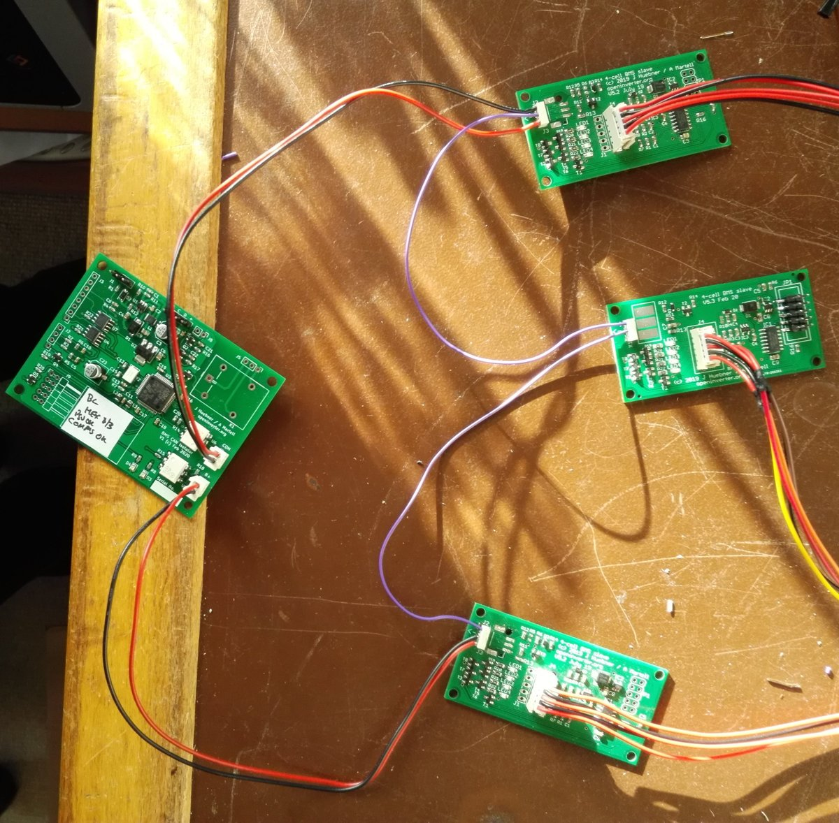

victor_norberg
Posts: 13
Joined: Wed Mar 11, 2020 7:07 am
Location: Stockholm, Sweden
Re: 4-channel BMS with daisychain bus
Post by victor_norberg »
I have gotten a hold of a lot of slaves and two master units.
I have hooked them up like this:
I get no response from the master, it seems to be completely off.
Did I miss wiring up a power supply for the master?
Any help is greatly apprecciated.

LRBen
Posts: 608
Location: Somerset, UK
Has thanked: 121 times
Been thanked: 290 times
Post by LRBen »
victor_norberg wrote: Wed Apr 19, 2023 9:44 am I have gotten a hold of a lot of slaves and two master units.
best regards,
The master board will need power as well. Couldn't tell you which pins though since it's a earlier variant to the one I had.
I think you will also need a wifi module for the master board if you want to connect to it.
