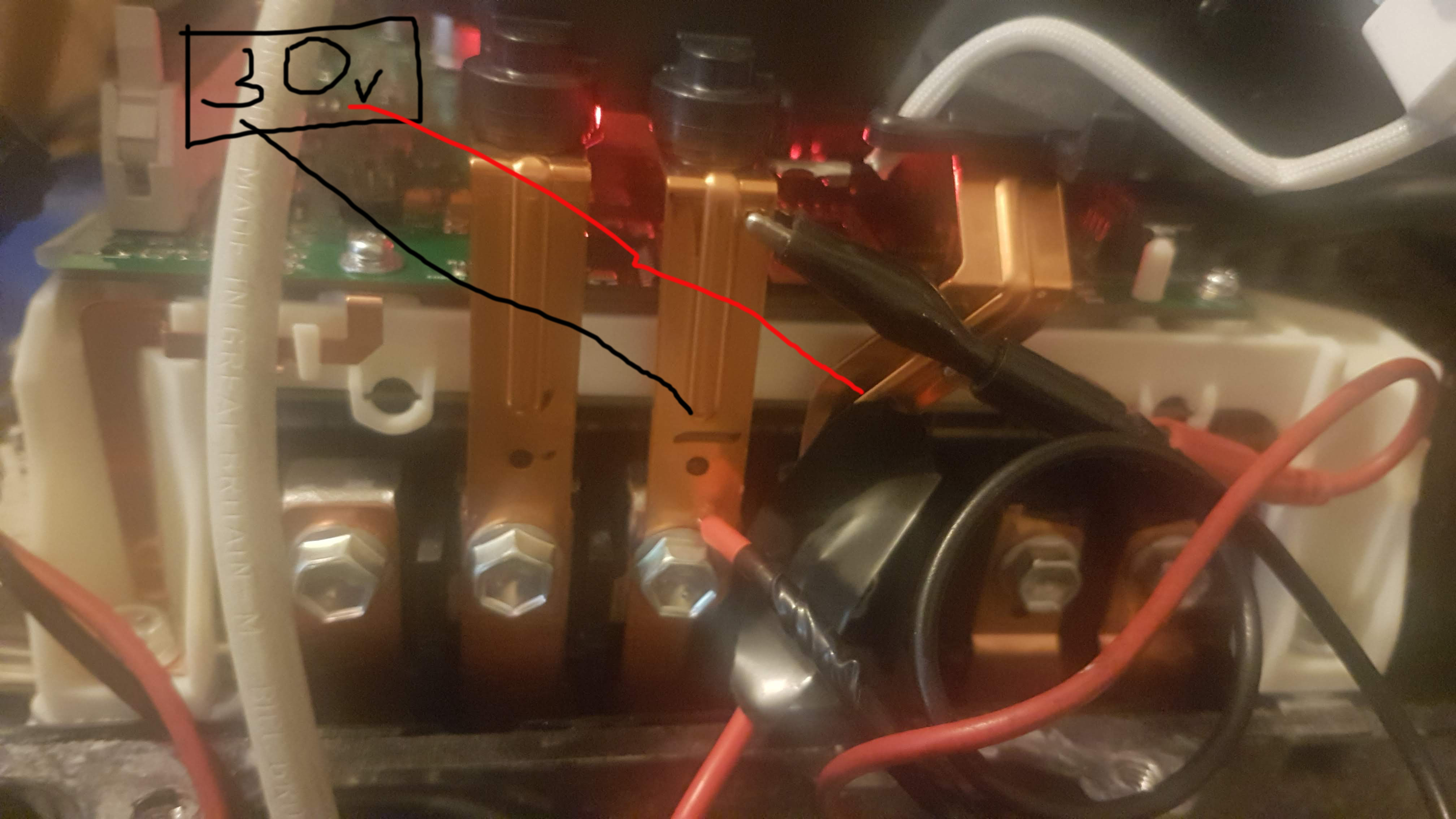

I can't get any output, 12v in pin 1, gnd in 11, 12v in 3 for forward direction.
30v PSU attached like so.
Scope probe on one of the MG2 outputs, the negative on the DC bus negative.

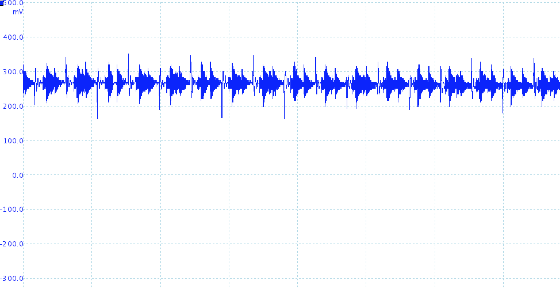

In the web UI I've done
start 2
set fslipspnt 1
set ampnom 1
Signal remains the same regardless of the run mode is manual or stop

I'll try probing the 50 way connector MG2 a/b/c hi/lo tomorrow. I'm I missing something to startup in manual mode?

Is 5v off and -5v on for the IGBT drivers?
I've getting sold 5v on R64 - R69 as soon as the inverter is powered on. Hitting start in manual mode and setting fslipspnt and ampnom doesn't get me a PWM on the gate drivers.

Cheers for the Skype call. Now getting pwm. I'd assumed man up run ignored feedback loop all together. Changed encoder type did it. I'll update the wiki so no one else gets stuck on it.
EDIT
I have almost achieved rotation, open loop :D

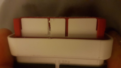

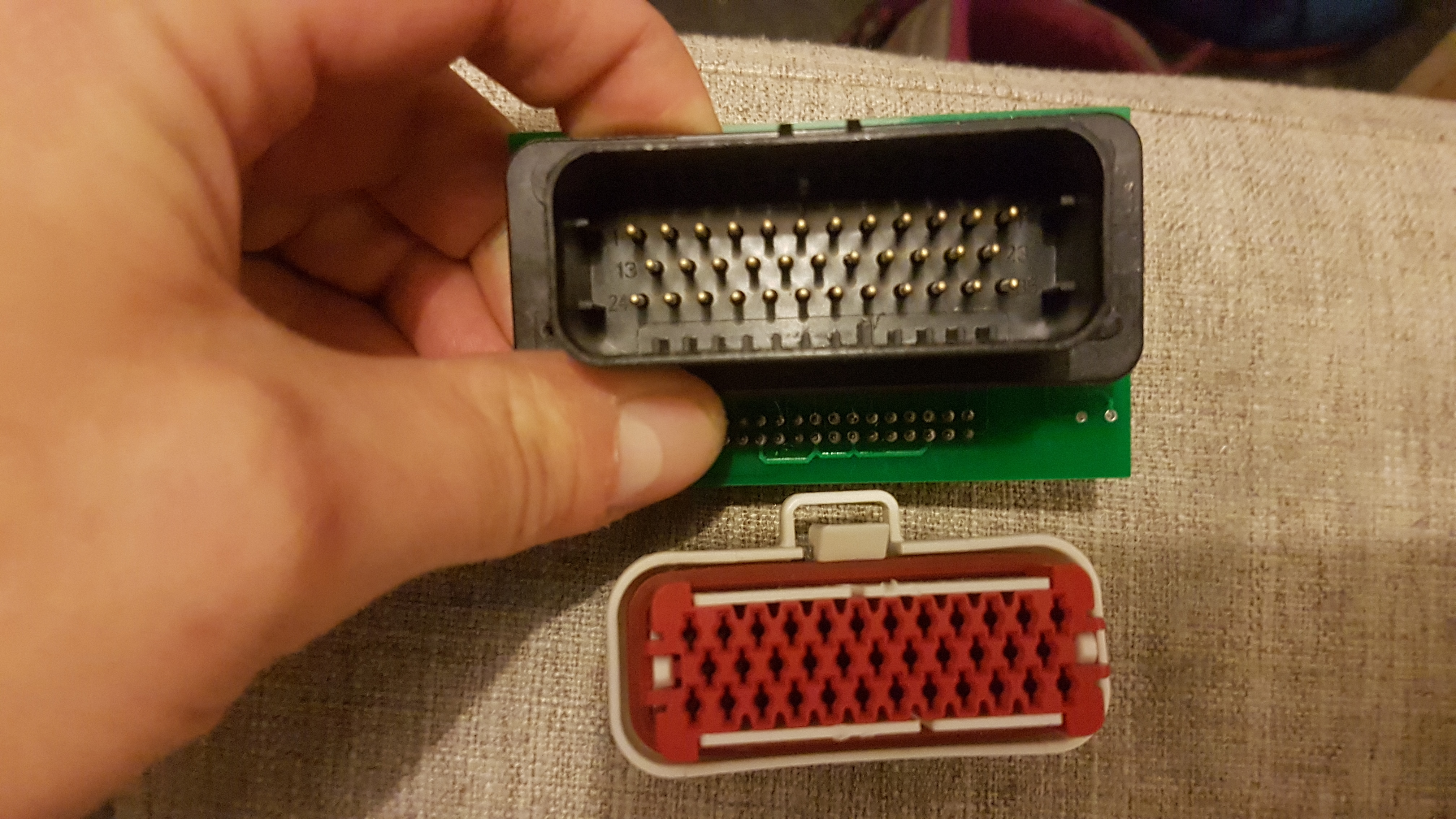

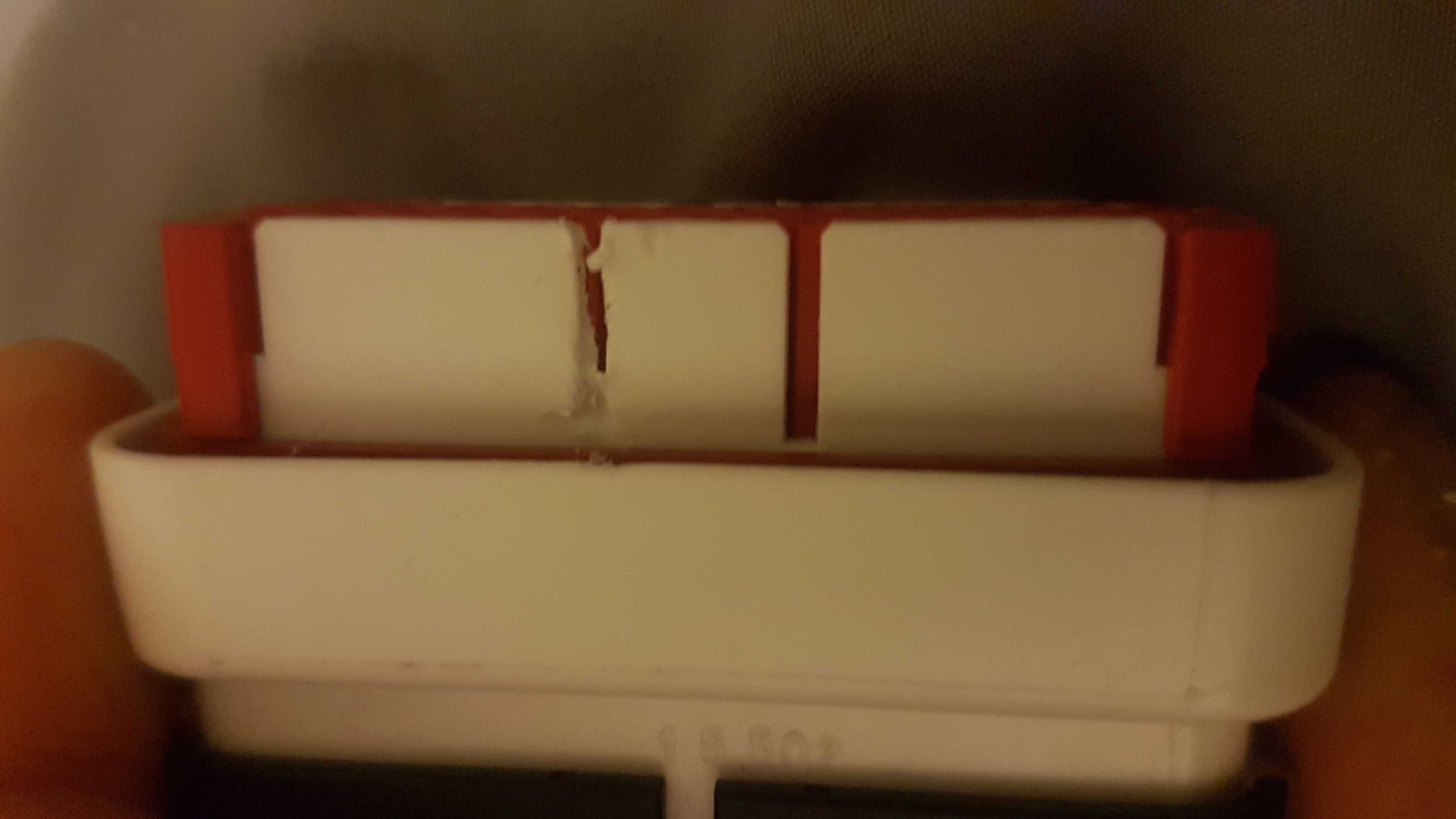

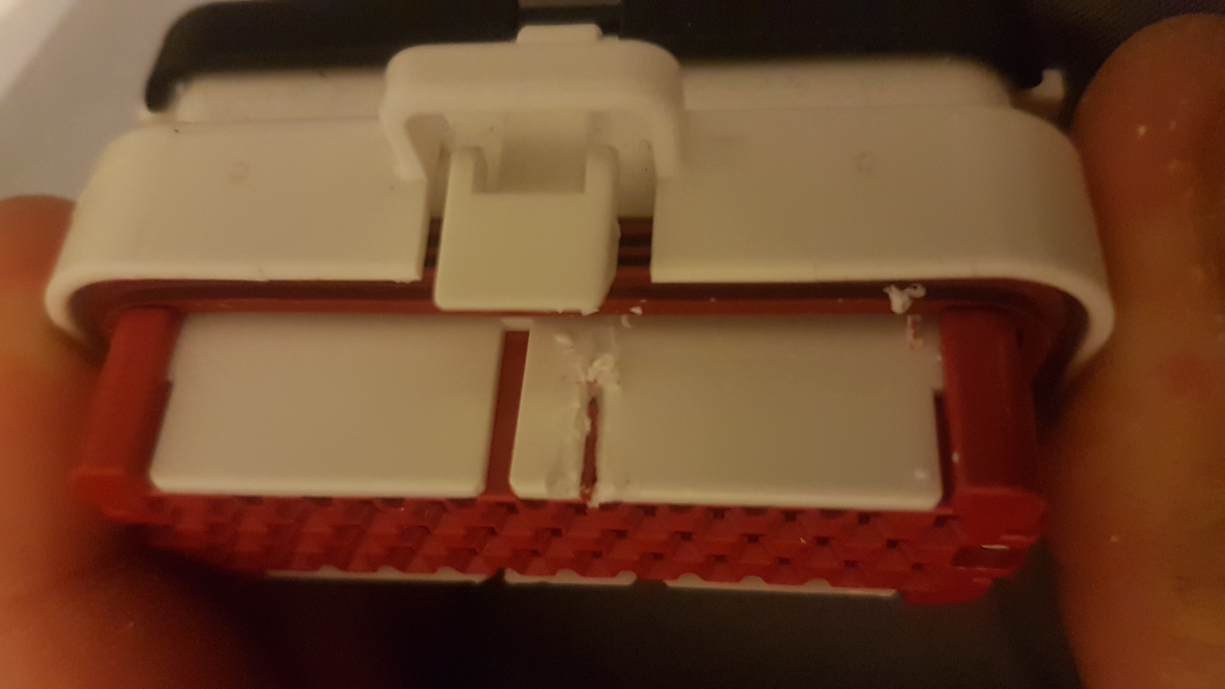

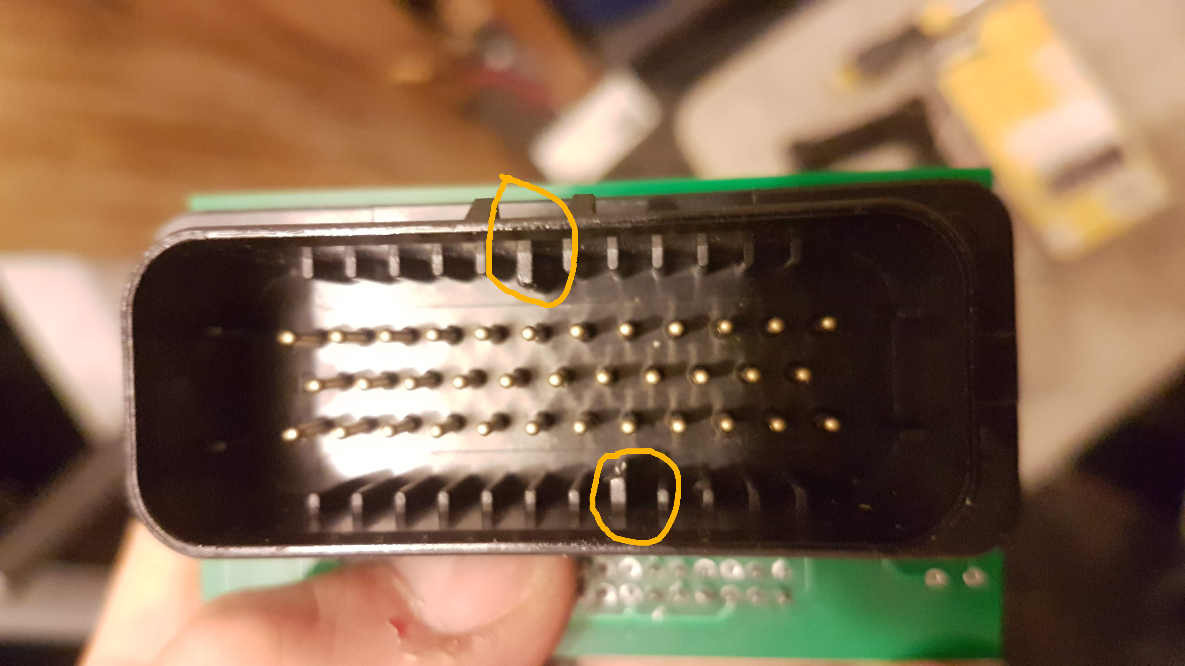

I'm not sure the 34 way connector included in the kit is the correct one for the socket, unless I'm doing it wrong which is more likely, it doesn't seem to want to 'mate'
The little tabs are fouling on the connector, anyone got this same issue?

Bigpie wrote: Sun Jul 05, 2020 5:49 pm I'm not sure the 34 way connector included in the kit is the correct one for the socket, unless I'm doing it wrong which is more likely, it doesn't seem to want to 'mate'
Which socket are you trying to plug it in to? That's the male socket AMPSEAL right? But it's not fitting into the female plug?

It's hard to get a photo that shows it but the grooves don't match the tabs.
is yours the same?
I've been filling more info on the wiki. Could you add details on your contactors and pre charge setup when you've time? I've not got that far

Problem solved. Not a massive issue, but I'll look in to part numbers and update/check BOM, I'm a bit obsessive when it comes to incorrect or out of date documentation.

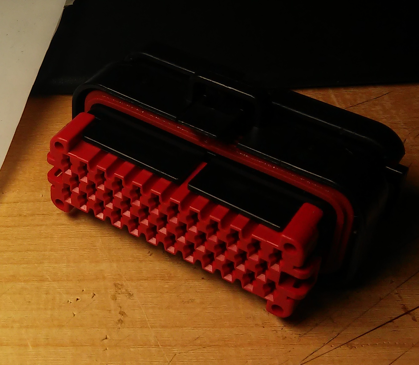

I've bought this TE connectivity 35-pin plug for Curtis five years ago and it's groove is differ from yours, and as I can see "notches" you made while trying to connect it, black connector is standart, but red one is different.
Posts: 1884
Has thanked: 91 times
Been thanked: 517 times
Yours looks like it might be the correct one. I think 776164-1 looks like the part you have, Konstantin, 776164-2 looks like what I have.

Just been looking at the ones I've bought and they don't list the part numbers on the remaining documentation I have but it's definitely this one - 776164-1: https://uk.rs-online.com/web/p/automoti ... s/6809437/
