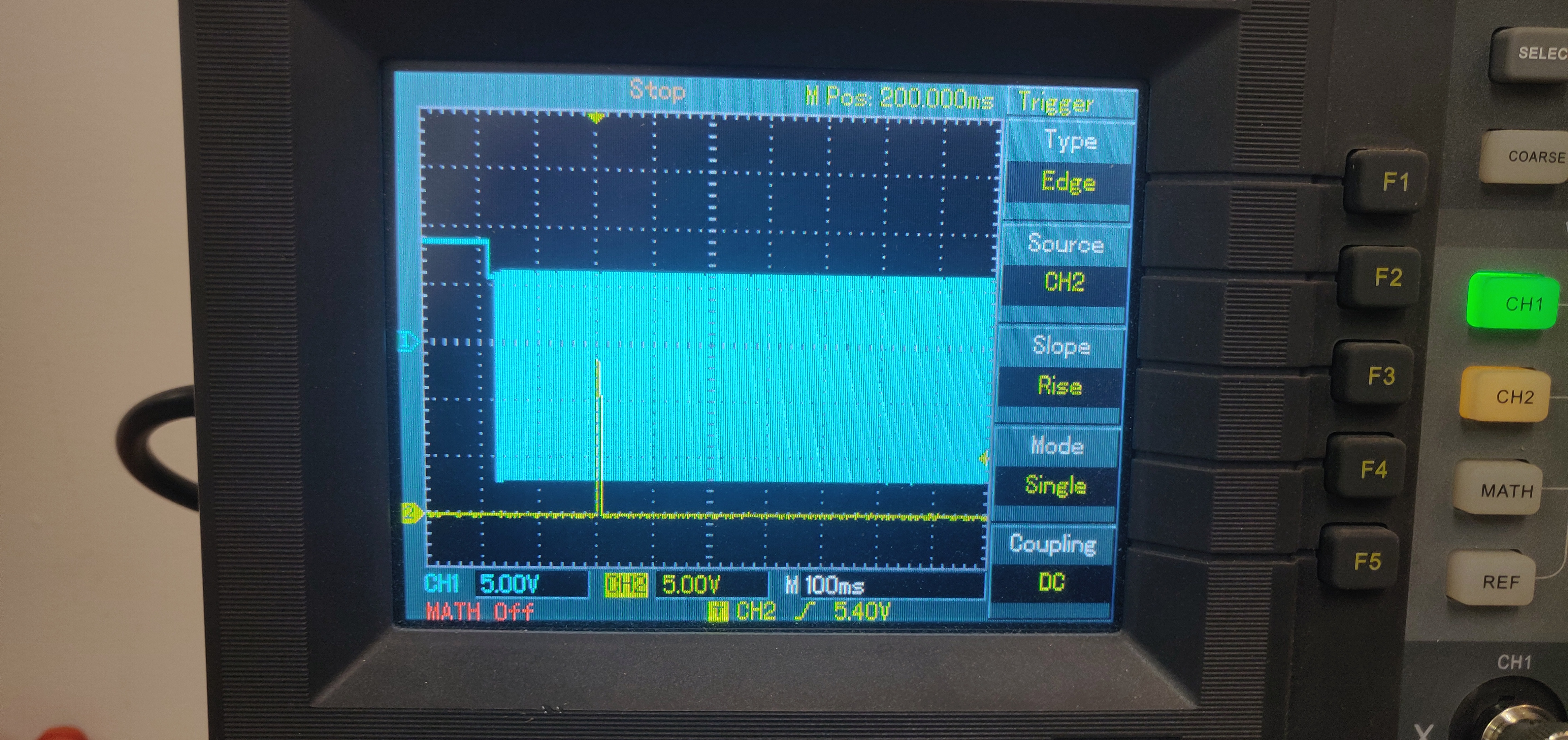

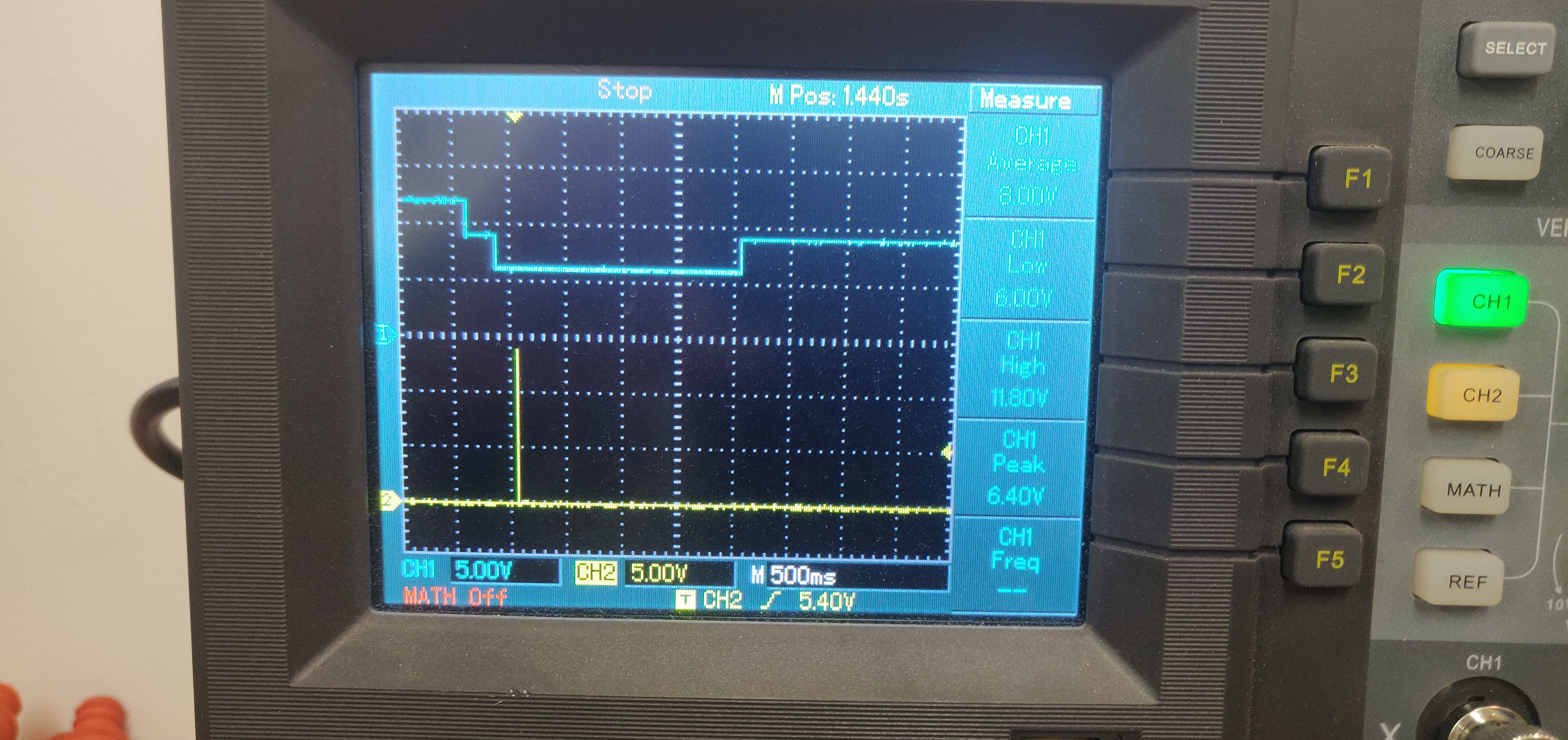

I made some measurements.
First picture shows how applying steady 12V to CP line results in 9V as supposed. Then the PDU apparently wakes the Zombie up as the Zombie momentarily drives the PDU T15 supply up as can be seen from channel 2 on the oscilloscope (yellow). Only for the aforementioned 6ms, though. Then the PDU is also ready to charge and indicates this by 6V on the CP. This situation is continued for a short period and then the PDU apparently notices that T15 is not present anymore, as indicates by the channel 1 on the oscilloscope (blue).
In this situation I tried if EVSE ready would help, but the behavior stayed the same - no bonus. :(

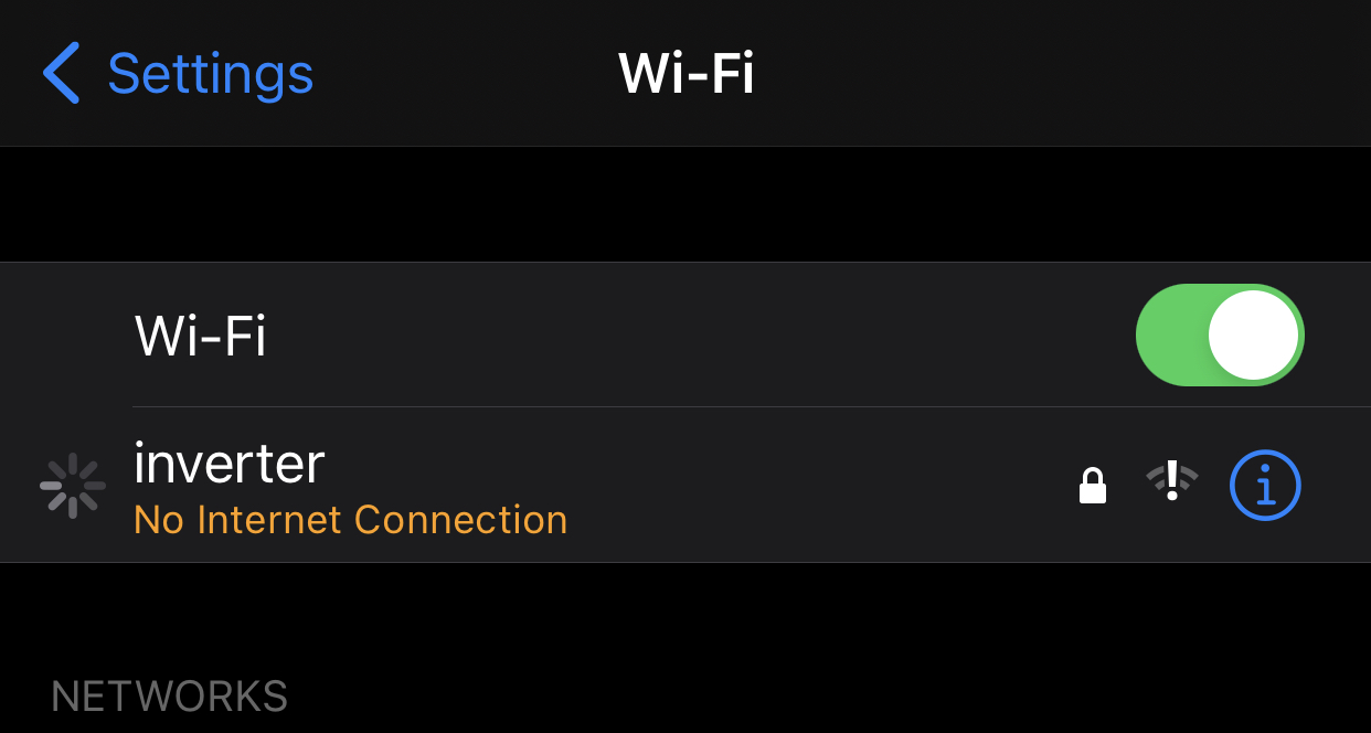

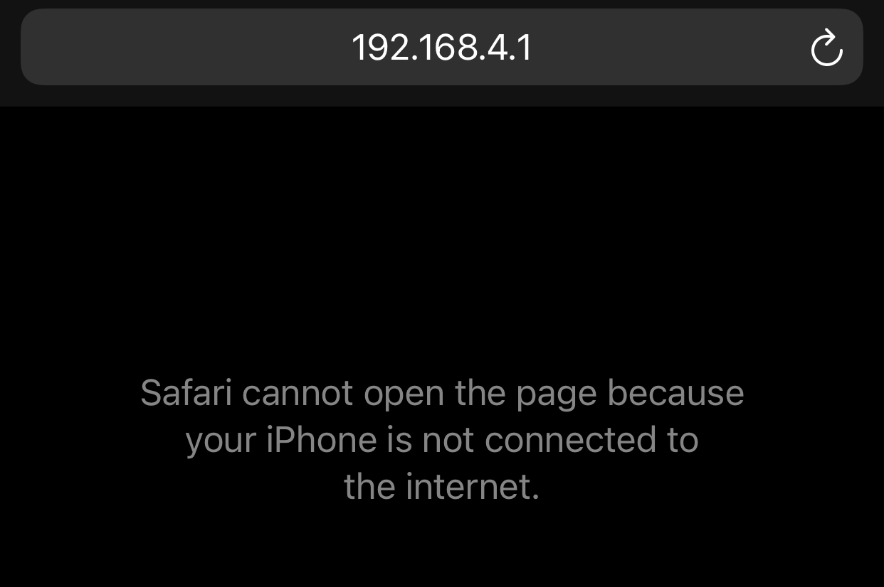

I have a problem also, trying the new zombie board today.
The wifi module has a different SSID and password than before, I know that, but the connection always has a warning, and it’s not possible to open 192.168.4.1. Tried this on phone and a new laptop with identical results.
I tried swapping in the wifi module from the old unit, it’s possible to connect to that but then the gui is “empty”.
What can cause this?
Posts: 4007
Been thanked: 1138 times
Re: ZombieVerter VCU Support
I've spent more time bashing my head off a wall with these stupid wifi modules over the past few weeks than I care to mention. They worked perfectly up to my latest purchase when OBVIOUSLY something was changed either by Olimex or by Espressif and naturally no one wants to find the issue as all the silly little arduino sketches work fine. Can someone PLEASE PLEASE help the community and me to solve this.
@et0 obviously there is no internet connection but that should not stop the device from connecting to the webpage. If you are still stuck all I can offer is to try and find a spare old module somewhere here and I'll send it over.

Jack Bauer wrote: Tue Nov 30, 2021 3:50 pm @et0 obviously there is no internet connection but that should not stop the device from connecting to the webpage. If you are still stuck all I can offer is to try and find a spare old module somewhere here and I'll send it over.
Yes, I just included that because the other module doesn't show that warning, thought it might be something to do with it. Is this already being discussed somewhere else? I'll lend a hand if I can but remember swearing off ESP32/arduino adventures once before.
If you have one that works we'd really appreciate it to get the new unit up and running. But shouldn't it work with the module from the old board, there's no firmware difference on the STM side is there?
We'll carry on with the old unit in the meantime but I am pretty sure it needs a new STM32 chip, both problems trace back to what look like dead pins on that device (no inv_out signal and the ADC channel for motor temperature is jammed at full count). I know, that's very unlikely too, but I can't find stock anywhere to replace it.

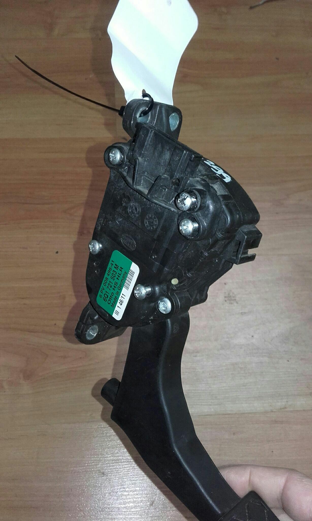

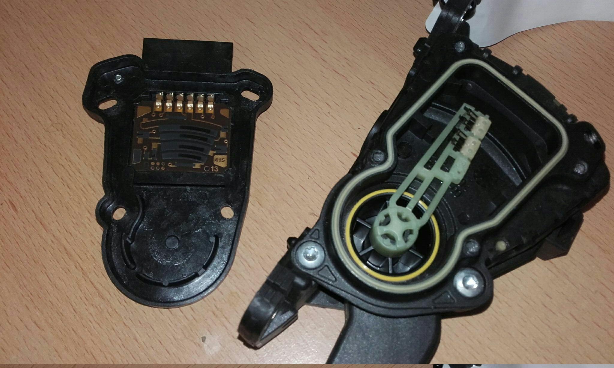

Throtle pedal question: I bought a VW Polo diesel throtle pedal, I opended it and found that it looks like it is just two potentiometers.
Can I still use this?
What signals does the Zombieveter want to see, just 0 to 5 volts?
Will this work?
Kelju
Posts: 171
Joined: Sat Aug 22, 2020 6:54 pm
Has thanked: 13 times
Been thanked: 19 times
Post by Kelju »
PaulHeystee wrote: Thu Dec 02, 2021 8:48 am Throtle pedal question: I bought a VW Polo diesel throtle pedal, I opended it and found that it looks like it is just two potentiometers.
Will this work?
That should work just fine.
You need to figure out which ones of the pins are the center taps of the potentiometer.
Then just wire 5V and GND to the other two pins of each potentiometer.
If you get 5V and GND mixed together, there should be no damage, but you need to get the direction right (that being an increasing voltage in function of percentage of throttle travel).
Keep in mind, that if you mix the center tap with either the 5V or GND, you risk damaging the 5V reference supply of the Zombie or damaging the throttle pedal (Assuming there is no short circuit protection).
