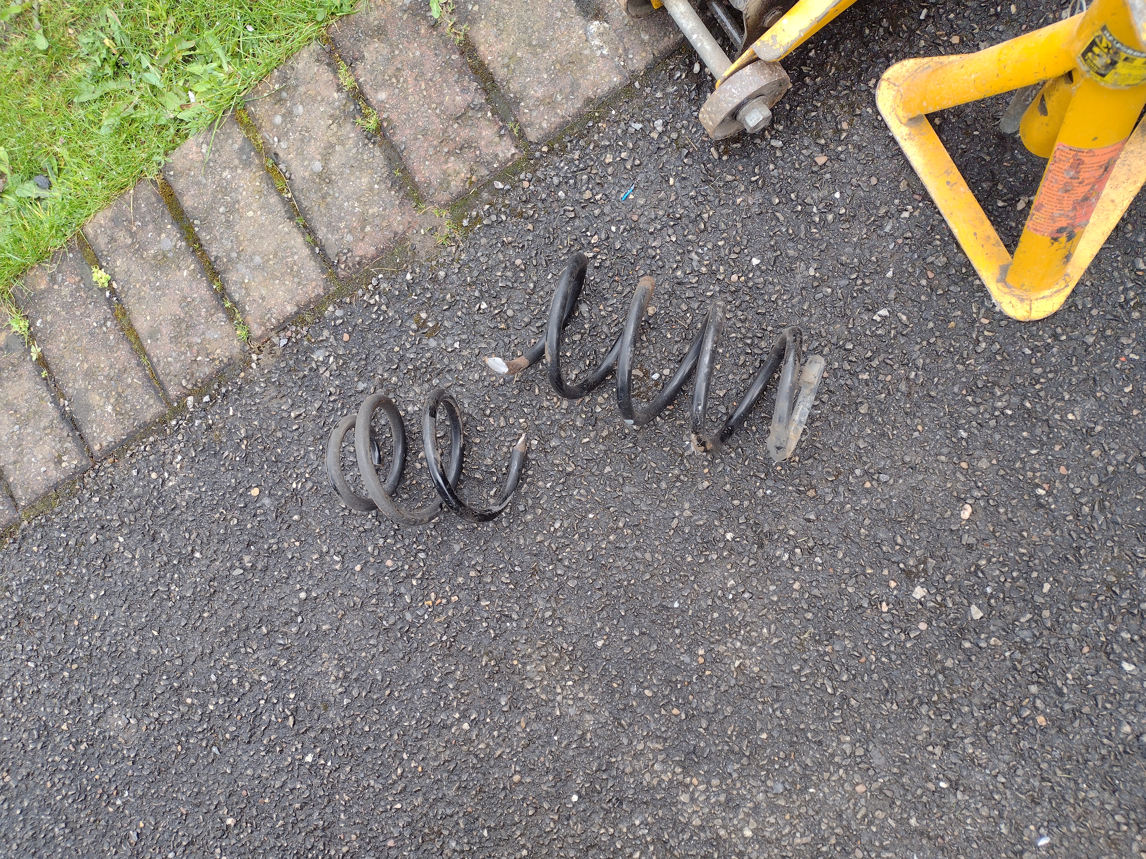

Bigpie wrote: Thu Apr 20, 2023 7:57 am Cars been lowered
Unfortunately it wasn't desired.
I heard a clunk when I set off then the ride was pretty terrible.
Oops!
On a positive note, they're pretty cheap and easy to replace. ;)

Springs replaced.

Love how easy they are to change on the back of those cars 2 jacks 2 bolts done in under 10 mins I bet! Probably even easier with no exhaust!

Not quite, one nut was well buggered. Done in an hour though.

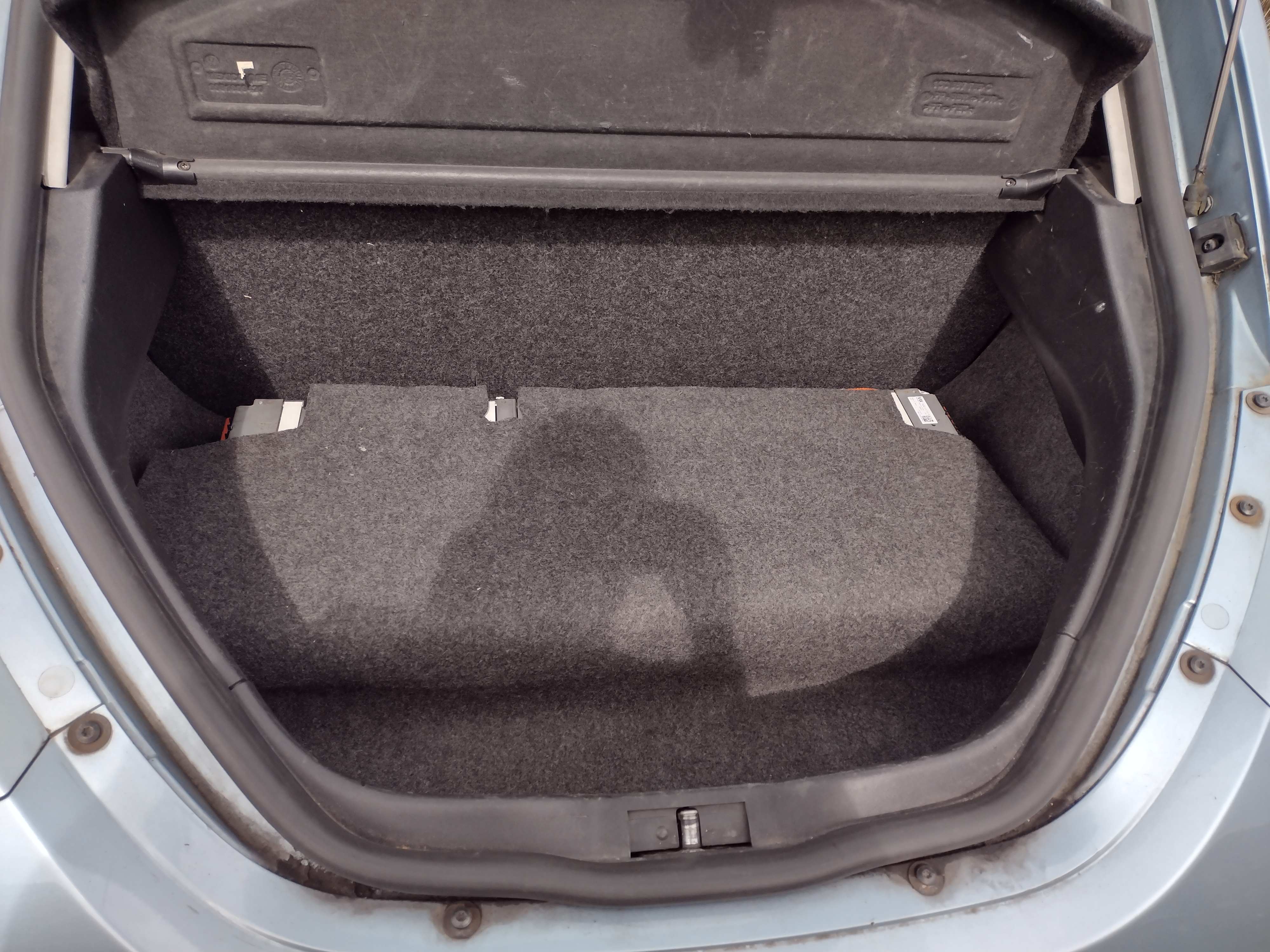

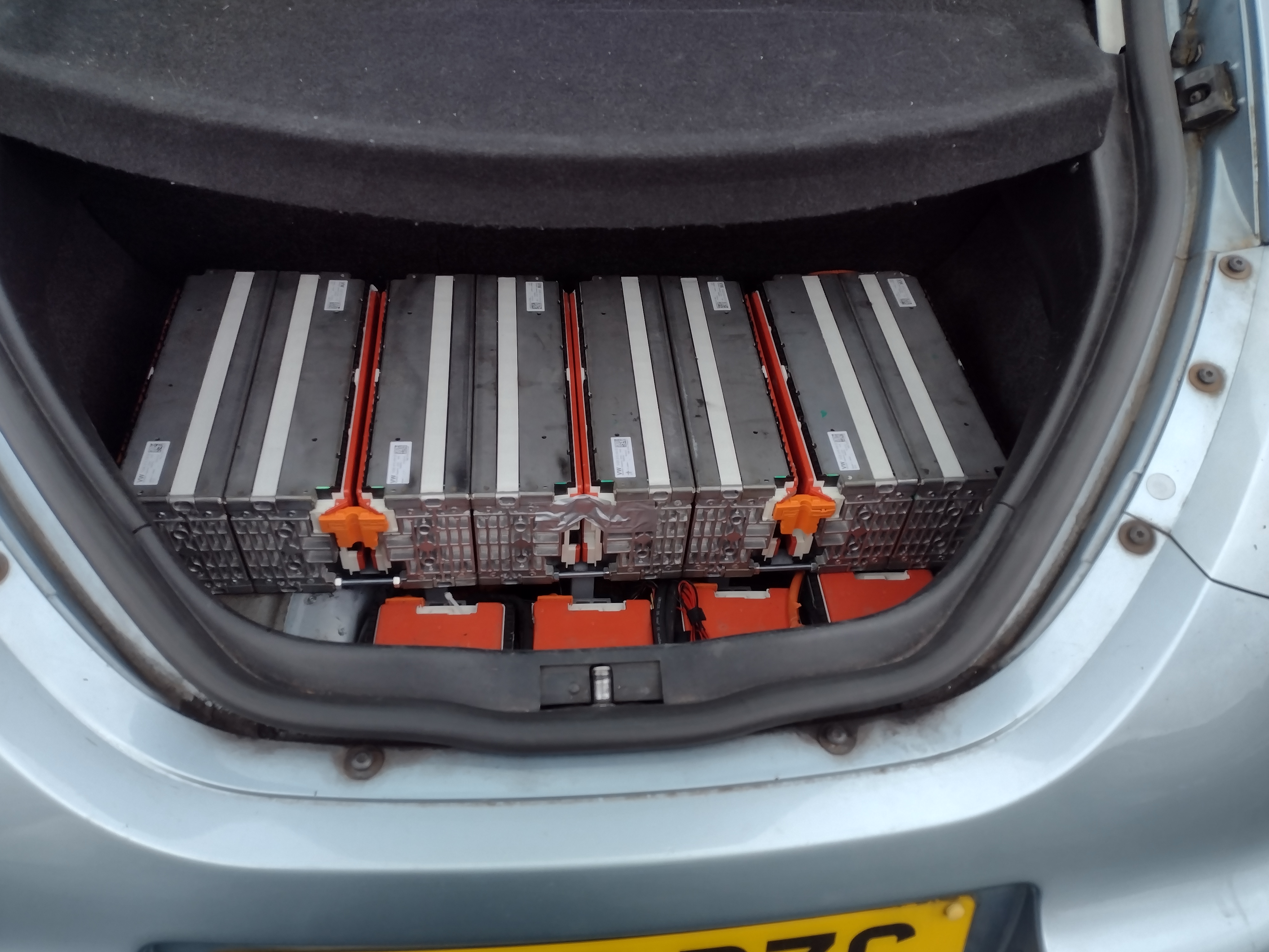

Finally feeling a bit better after Covid again, so I got the 3rd and final pack in the car, mounted in the boot for now while I decide if I can be bothered to make a box to mount it in the old fuel tank space.
The HV and LV wiring isn't done yet, and then I'll make a new floor for the boot to finish off.
It leaves me with quite a small boot and they're not massive to begin with.

Nice job! I know all about loosing boot space to batteries! Does this mean spaceballs bms is imminent?

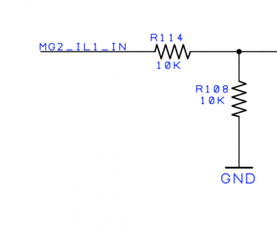

Pete9008 wrote: Tue May 09, 2023 1:02 pm Did you ever try changing the resistor values or is that the next thing to try?
Continued here as to not barge in on nathaniel's project thread.

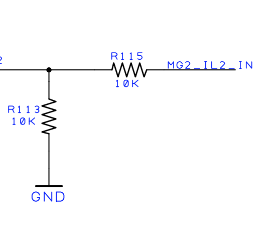

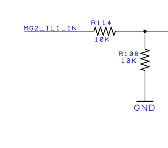

I've not, I've dug out this https://github.com/damienmaguire/Prius- ... _curve.jpg suggesting the current sensors can read +-600V
I guess these are the values that need changing.

Sorry, just noticed back here viewtopic.php?p=52911#p52911 that I offered to work out what needed changing but then forgot all about it :(
What current gain parameter values are you using at the moment?

OK so just to check I'm not losing it a 12-bit adc gives 4096 codes or plus and minus 2048. 2048/4.5 = 455A which is roughly where you start to trip so the explanation of the ADC clipping at around 450A does make sense.
What current would you like to be able to read up to, 500, 550, 600A? The higher you go the poorer the measurement resolution, and the higher the noise, you actually get.

OK, think I now understand how that circuit works. Three resistors need to change to get the new gain and keep 0A in the right place. Give me a few minutes to work out the equations.
Pete9008
Posts: 1801
Has thanked: 102 times
Been thanked: 351 times
Re: VW - Beetle 2003
Post by Pete9008 »
I think you need to change R44 and R49 from 62k to 47k and R48 from 3.16k to 2.7k. That should keep 0A in the same place but give around an extra 33% range (450A to 600A). The current gains will then need to change to around 3.42 and 3.38 to compensate in software.
Spreadsheet used to calculate attached.
Note - first order only, it doesn't take account of the load of the R45 and R44 on the input potential divider (which should be pretty small and since I've aimed to keep zero and the end points in roughly the same place as the standard values it should cancel out).
Note2 - This does assume that the Prius CTs can cope, it will need the output to go to -1.67V and +11.66V which should be possible but only if the neg supply to the CT is really -5V (iffy if it's an early charge pump version of the logic board)!
Note3 - It's a slightly unusual circuit in the way the offset is removed. Wondering if it leads to a slightly non-linear transfer function?
Edit - The other possibility is that you are already getting 500A and it's the il gains that are wrong!! Might be worth checking how it was originally calibrated if you have any way of contacting Damien?

I'm suffering with the brain fog and exhaustion too since my recent covid so not sure when I'll get to the motivation of removing the board for modding but will put modifying the firmware for a raw il1 and il2 parameter for logging on my todo list.
I'll ask Damien on Discord. And it is the early board, first batch.

Damien's response: Dc first then ac rms x1.414 to peak values

Bigpie wrote: Tue May 09, 2023 4:20 pm Damien's response: Dc first then ac rms x1.414 to peak values
Sounds like the current gains should be right then.

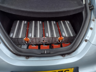

Finally got the 3rd pack wired in and setup with SimpBMS, though I have a bug somewhere in the balancing code/offsets, I now have 26.4 kWhs :D
Modules: 24 Cells: 288 Strings: 3  Voltage: 365.602V   Avg Cell Voltage: 3.808V  Low Cell Voltage: 3.706V   High Cell Voltage: 3.862V Delta Voltage: 156mV   Avg Temp: 13.438C
Delta is larger than I'd like so will get the balancing code sorted next week.
The get this to work, I've got 1 can bridge changing a single module as I had duplicate IDs in the 3rd pack, then another can bridge for the entire pack, so quite a few places to check for the can messages to get messed up.
Last job is to get some wood cut and some boot carpet then I can move on to something else.

Also realised that the current input circuit block that you posted, and that I used for calculating the resistor values, was for MG1 so the component references I quoted will be wrong. It's the equivalent ones in MG2 that will need changing instead (assuming it is the MG2 CTs you are using?)

Ahh right, good job you mentioned before I go removing resistors :D
