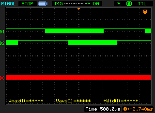

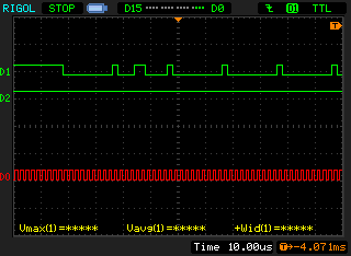

I ended up running a nice long CAT5 cable into the house so i could look at the data coming off the car in comfort. I also got my logic analiser out of storage. Both proved to be quite useful.
HTM data = 100 bytes (not 80)
MTH data = 120 bytes (not 100) (atleast 30 bytes near the end are all zero's)
HTM always starts with 001E
MTH always starts with 000C
The frames are overlapped, see attached capture from the scope.
I've saved the raw capture from the analyser as a wfm file, does anyone know good software to read this format? i believe it is an old tek format?

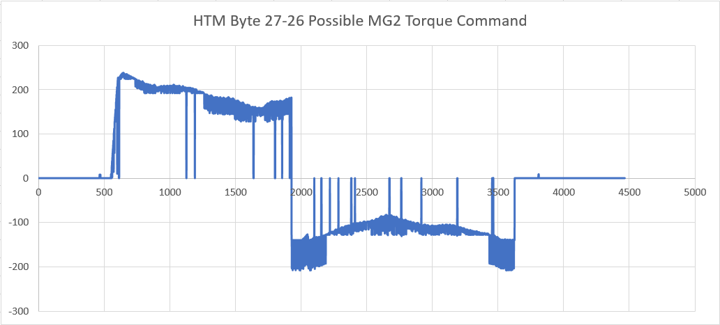

I wrote some excel macros to help extract and plot the data. I think that the MG2 torque is in the same position as the lexus GS450, which is good news. The graph below shows the car going forward and back in the driveway very slowly.
Does the toque value of 300 seem in the right ball park?
I think there's a couple of rows of bad data in my log file, hence there are a few glitches.

Re: Toyota / Lexus useful bits
Yeah 300 for slow moving would be about right. I'll see if I can migrate these posts over to the hacking thread.

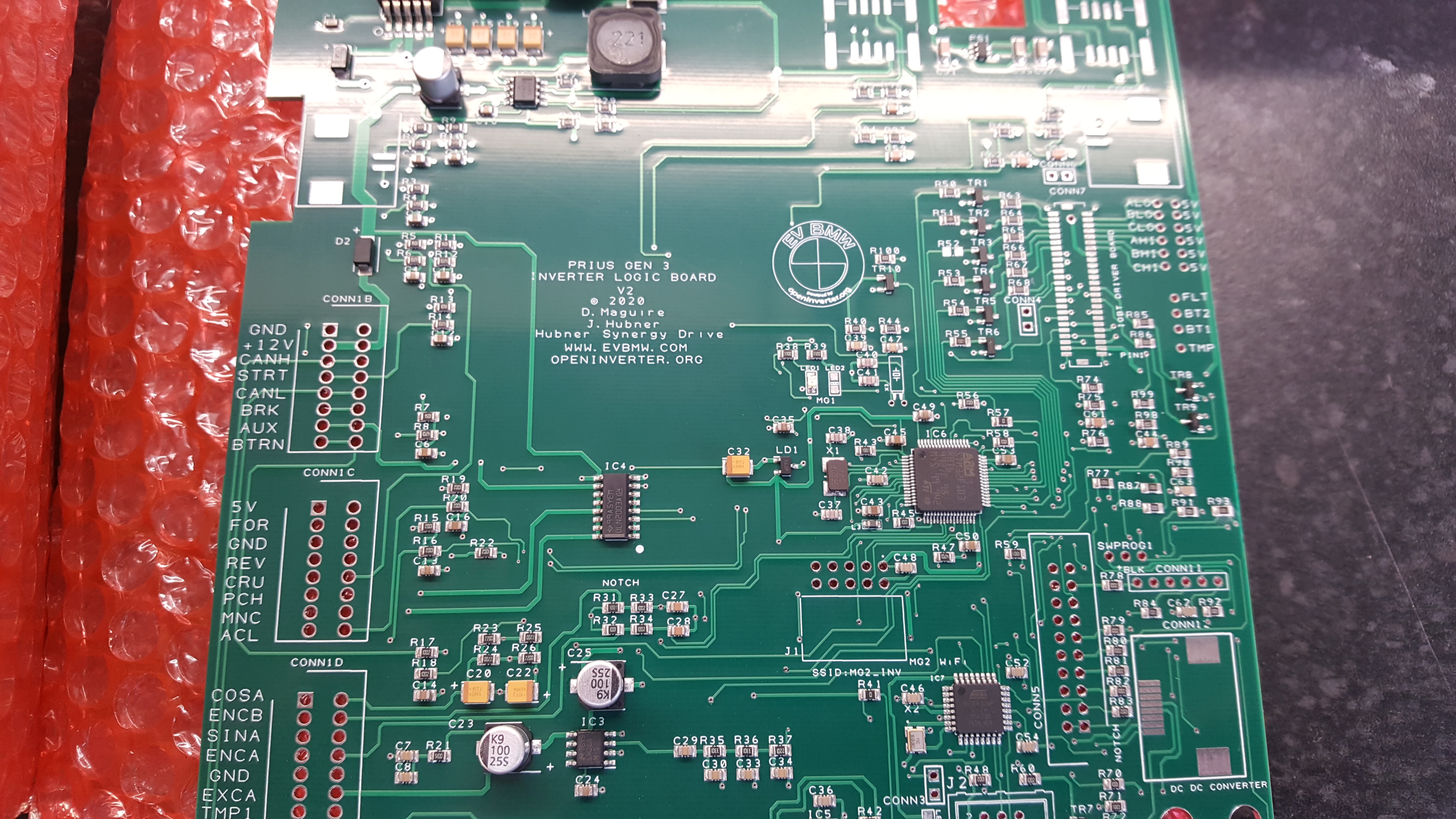

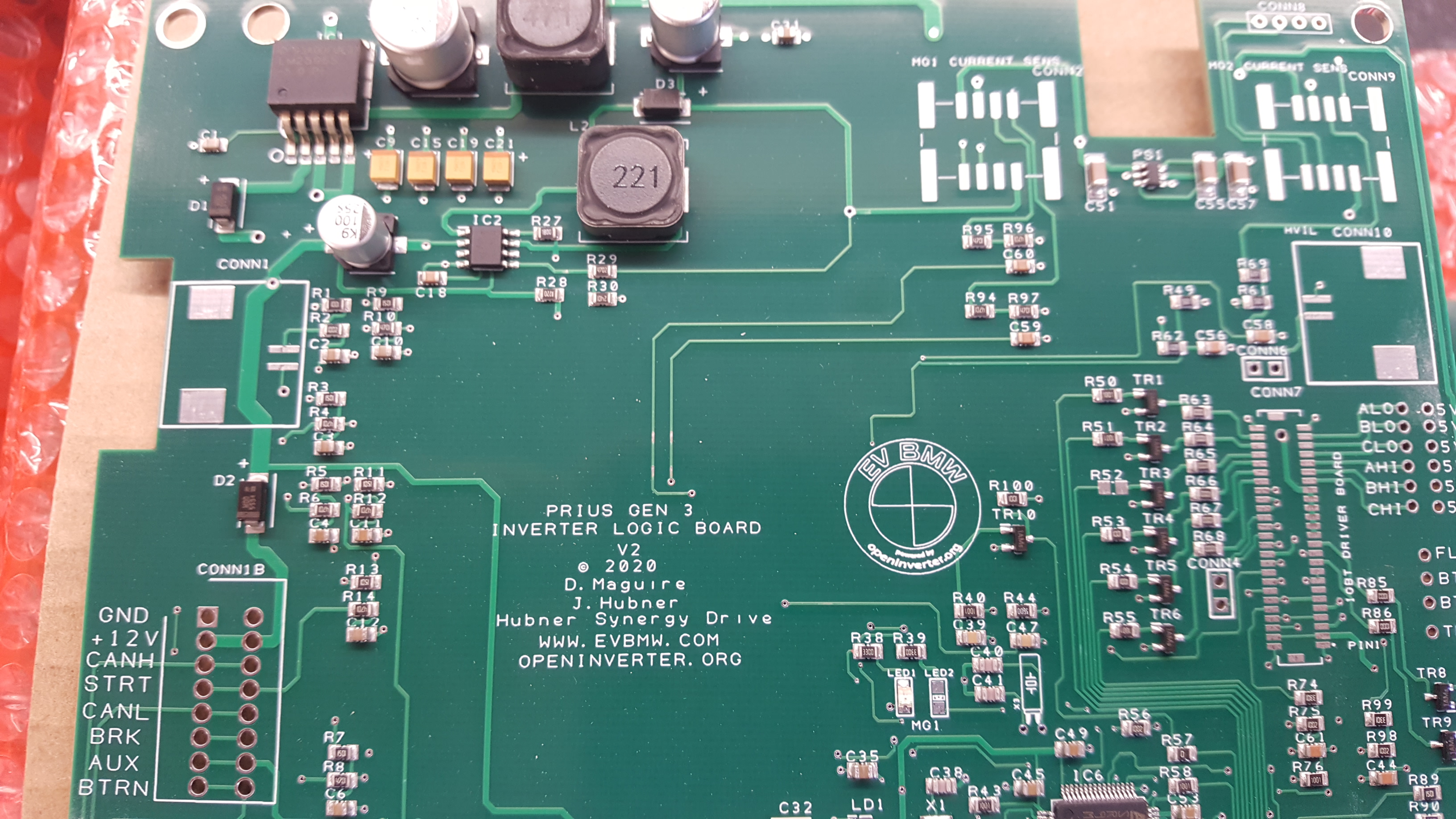

First batch of prototypes have arrived from JLCPCB. Initial observation is that this is top tier board building. As good as anything I have ever seen in my career and better than anything local who have charged a hell of a lot more.
I'd like to appeal for some calm in relation to the whole JLC build. I won't be responding to anymore "DAMIEN! WHEN ARE YOU RELEASING THE JLC BOM AND PLACEMENT FILES!" type of emails or messages on here or otherwise. The boards will be tested. Errors if found corrected. Webshop and github will then be updated and videos made. The vast majority of people are great and appreciate the effort involved but some seem to think I'm their personal design engineer. Newsflash! I'm not.
Now in relation to the webshop we'll be making a few changes. There will be three tiers of board available to buy :
1) Board direct from JLC as I receive them with listed smt placed, unprogrammed and untested. This will replace the bare boards currently on sale.
2) Board direct from JLC as I receive them with listed smt placed, programmed but untested. This gets around the need for programming the micros.
3) Board with all components both listed smt and non listed smt and through hole placed, programmed and tested.
