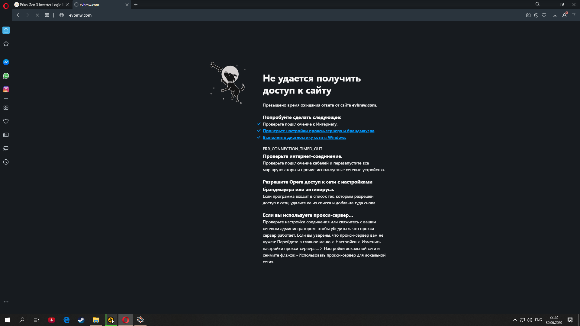

As soon as I've decided to buy the board, shop become unavailable :| and now I'm itchy :cry:
Posts: 4000
Been thanked: 1116 times
What are you trying to buy? Shop seems fine.
konstantin8818
Posts: 290
Location: Minsk, Belarus
Been thanked: 10 times
Post by konstantin8818 »
Jack Bauer wrote: Tue Jun 30, 2020 7:04 pm What are you trying to buy? Shop seems fine.
Cheap version of V1c board.
It works thrue VPN, but I don't trust VPN when it comes to payments and shops
Even Microsoft Edge can't open it. Today in the morning it was available... I just can't get it.

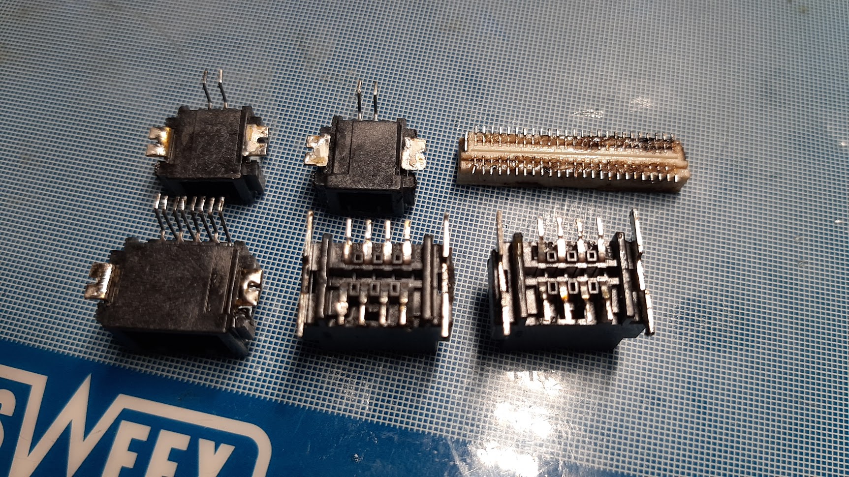

If you really don't need that smoked board, I'll happily trade it for donation or patreon support ;)
Bacause I'm not shure if those salvaged connectors will do the trick...
Product of three hours of soldering iron misery:
White connector turn out to be really heat resistive, otherwise it wouldn't make it :mrgreen:

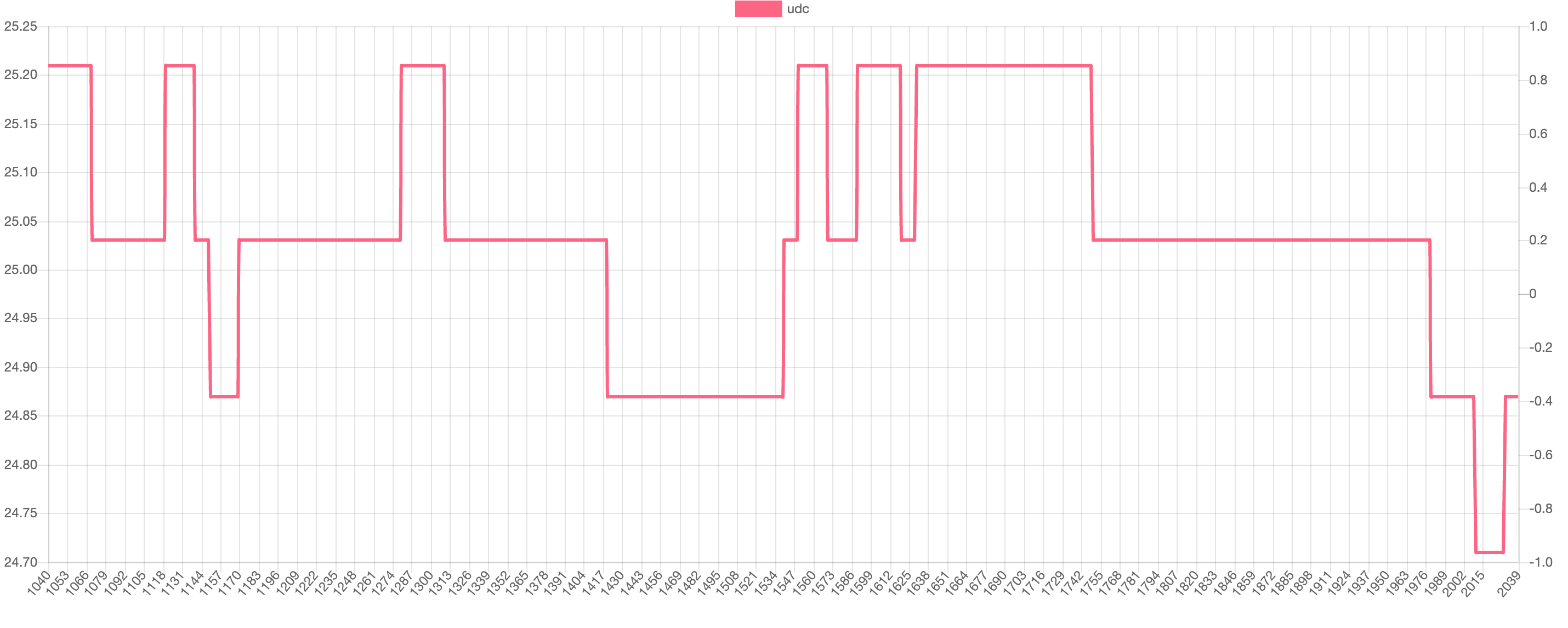

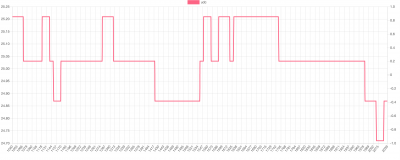

Progress on my side - of a sort. Finally got that 10k swapped for the 8K2 and now have a much healthier -4.81 on the -5V supply...but udc is still waving around all over the place!
Time to start stripping down inverter number 2...
Posts: 1884
Has thanked: 91 times
Been thanked: 517 times
I've swapped the resistor over.
My UDC plot is below. ~0.5v difference
