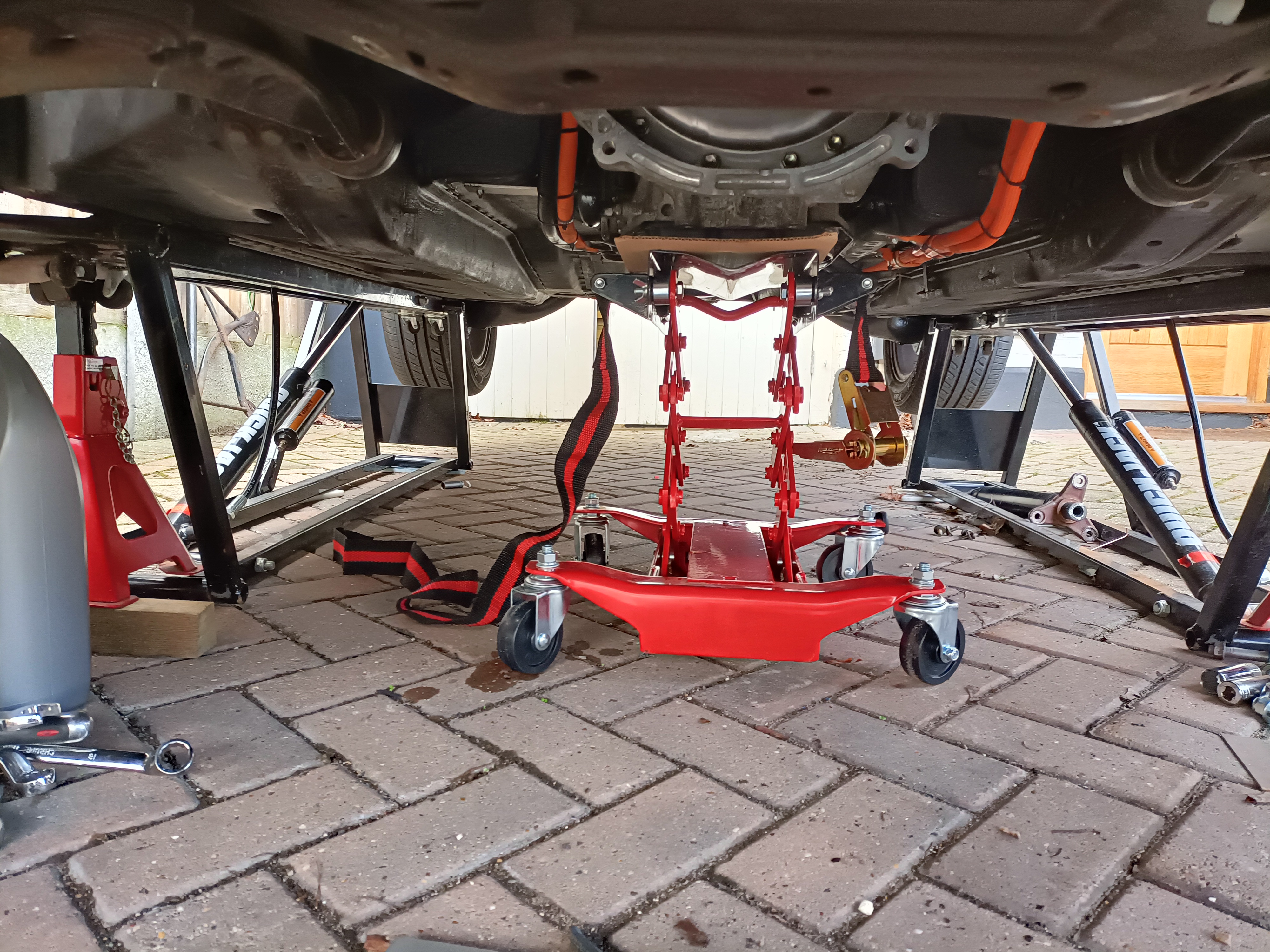

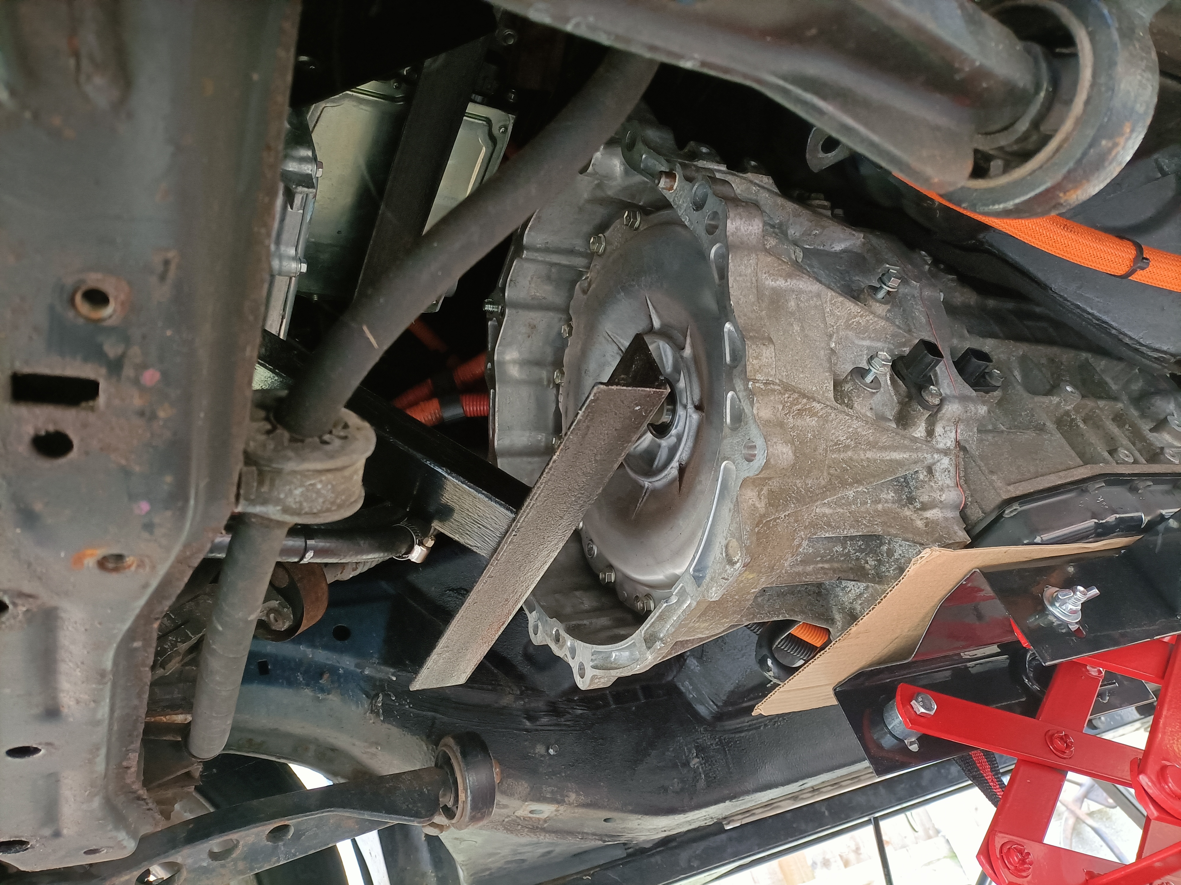

Re: [WIP] BMW Z3

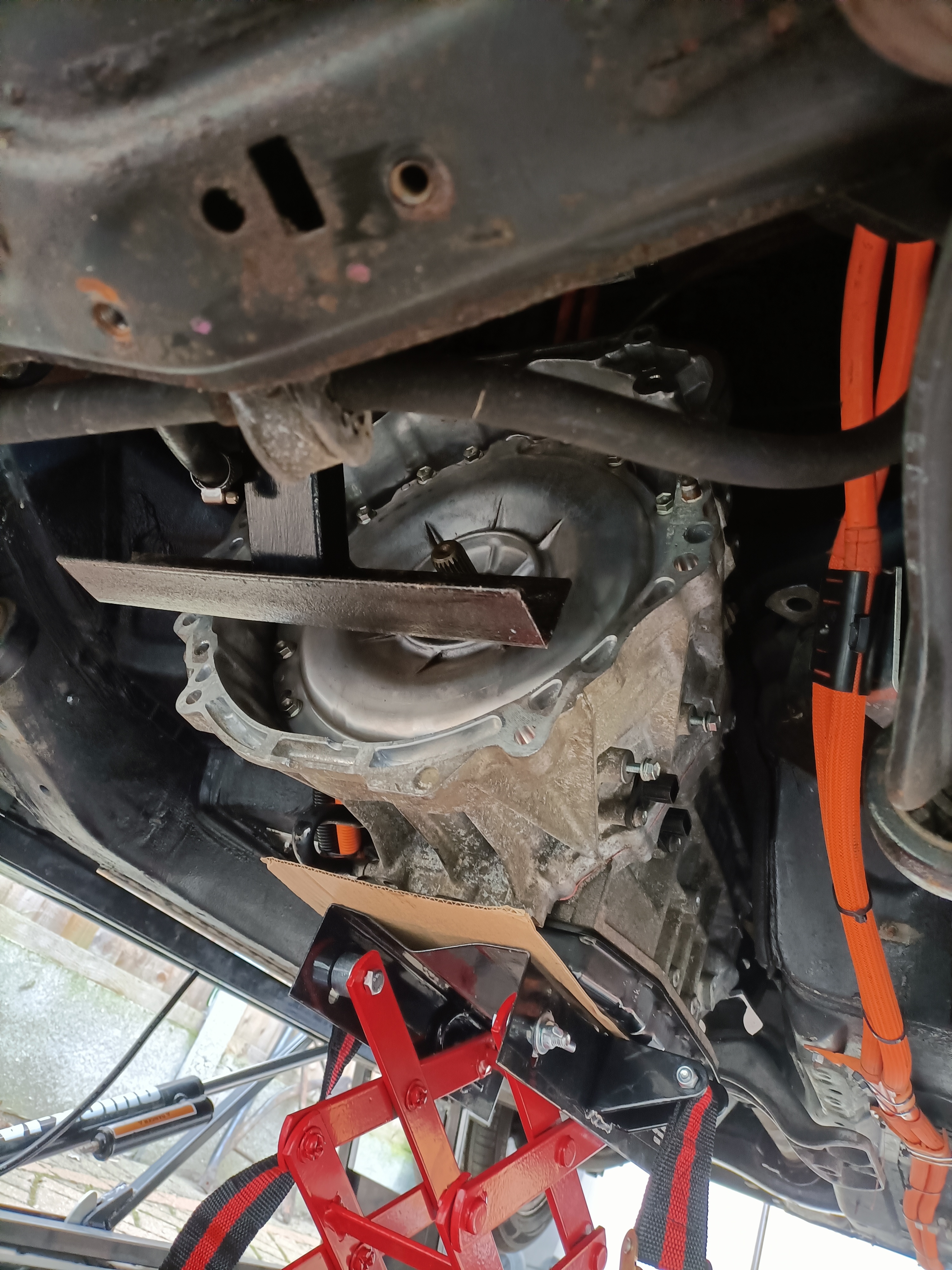

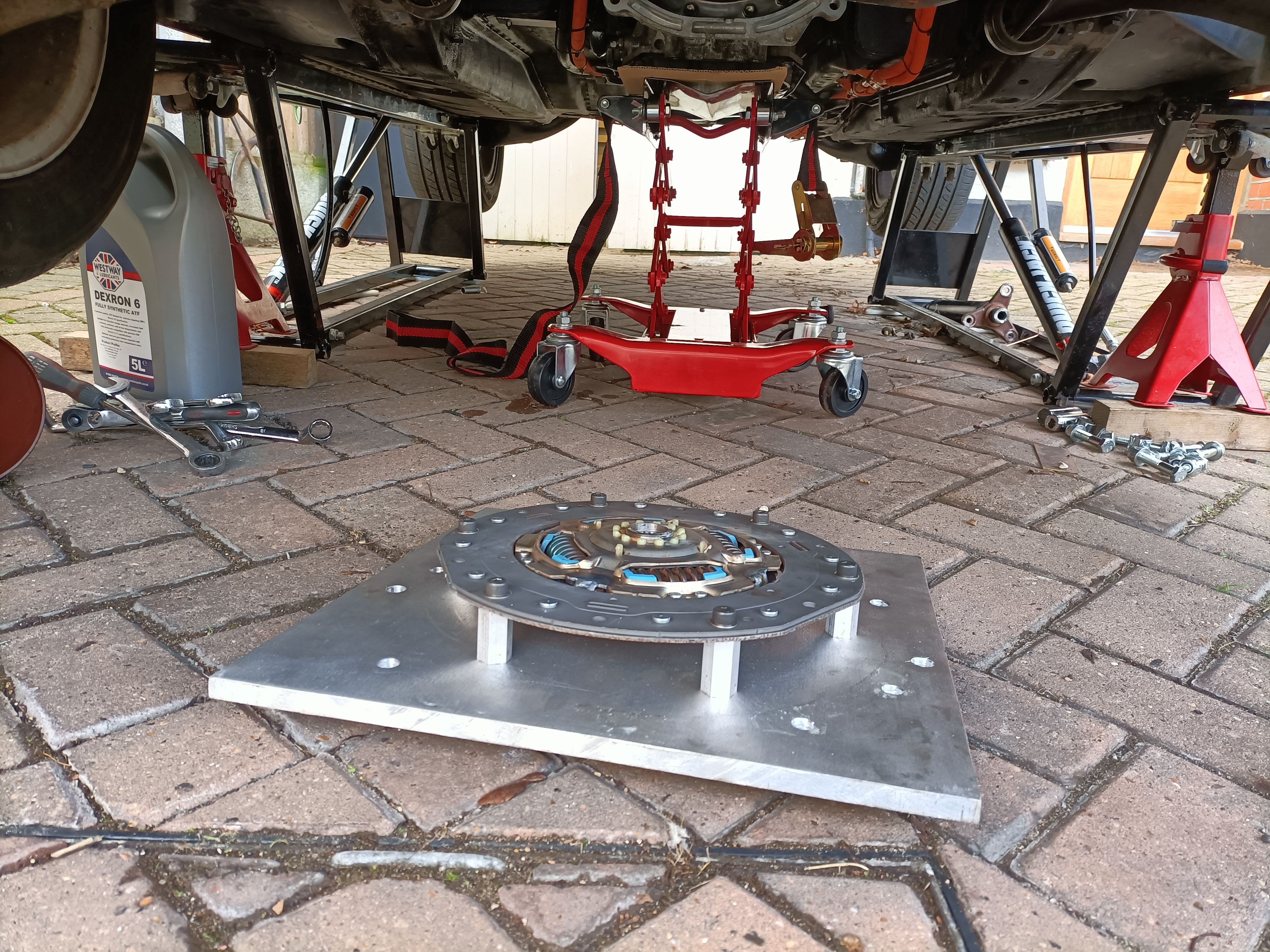

since I have to remove the l210 transmission again I decided to treat myself as I'm getting too old to to drop heavy things on me
much better than having a transmission balanced on a jack on bits of wood waiting to fall off

Re: [WIP] BMW Z3
My new transmission jack is earning it's pay already and I'm really impressed moved really easy with one hand on block paving with the l210 on it.
I managed to get the front mounting plate and coupling disc out without even dropping the Transmission just unbolted it, dropped the propshaft and rolled it back far enough to get it out it felt completely stable.
I tried drilling through the coupling to put some bolts through it to lock it but I couldn't drill through the steel with carbide drill bits so I gave up and welded it up instead.
It's all back in now I just have to refill the transmission oil and I can get back to work

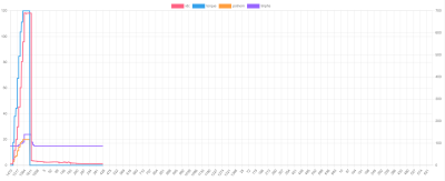

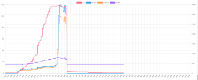

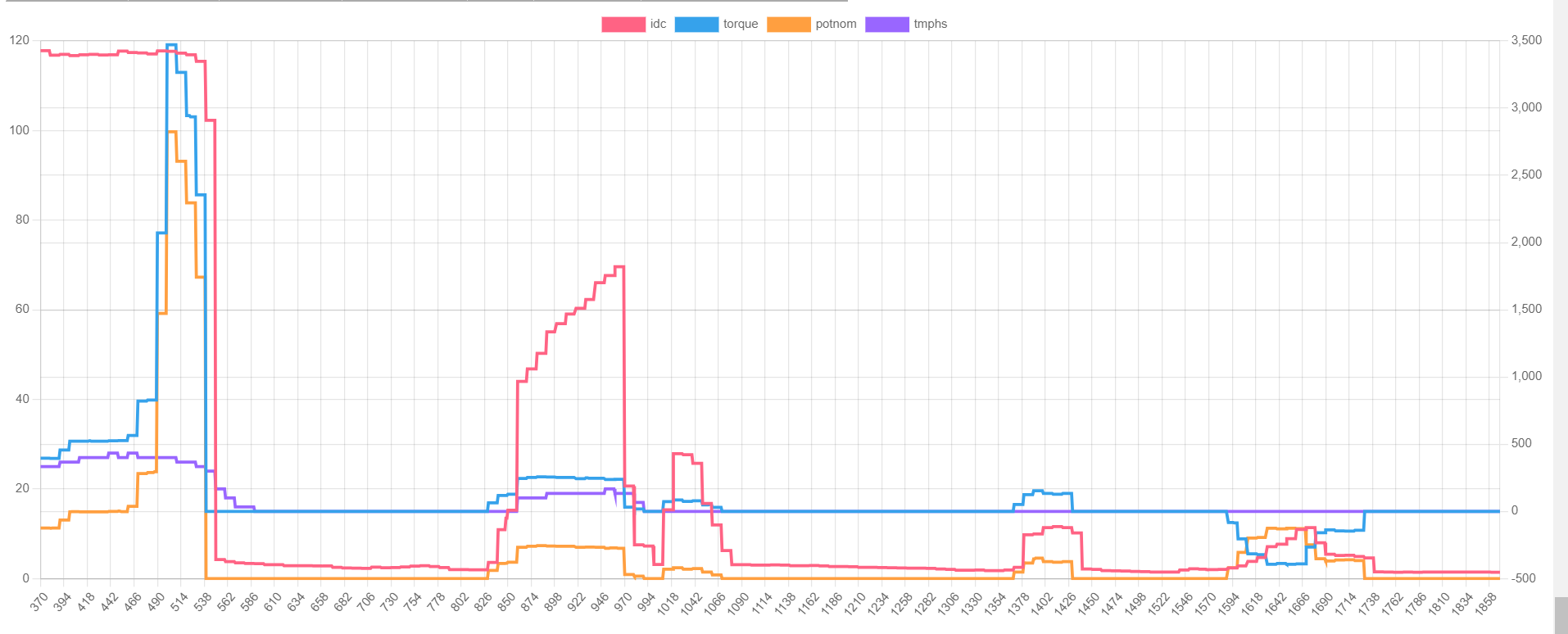

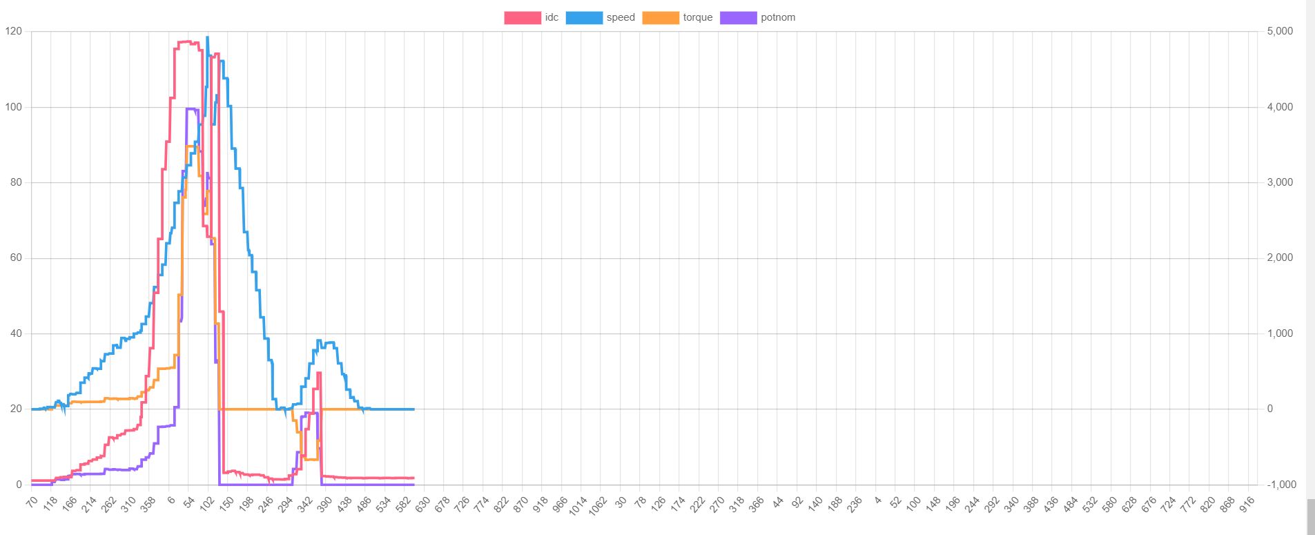

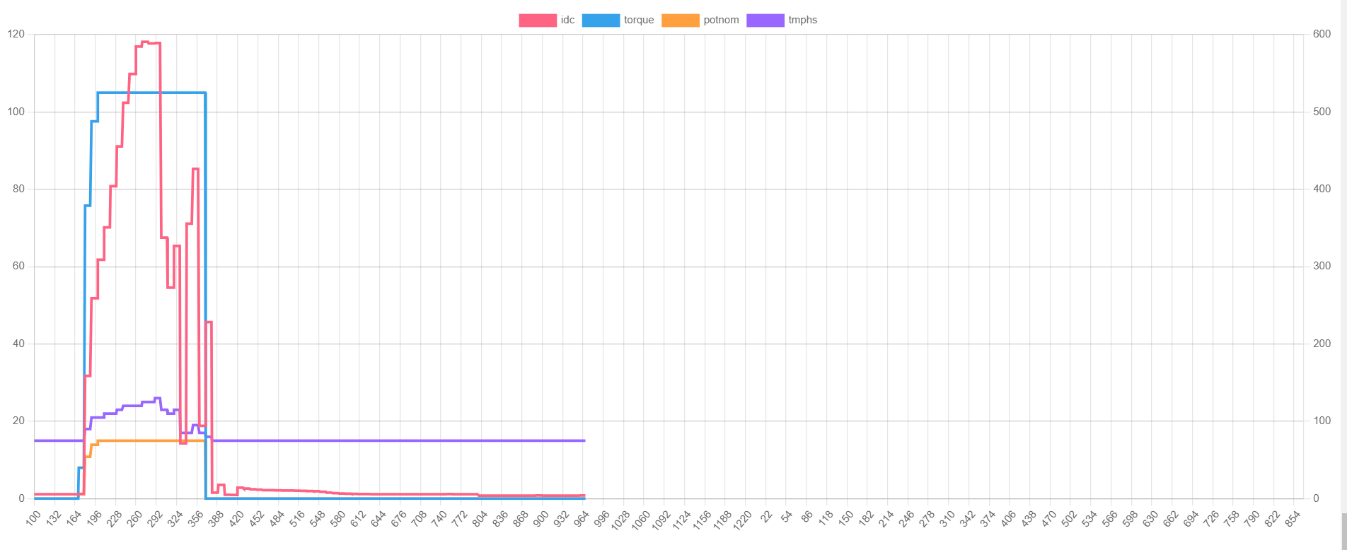

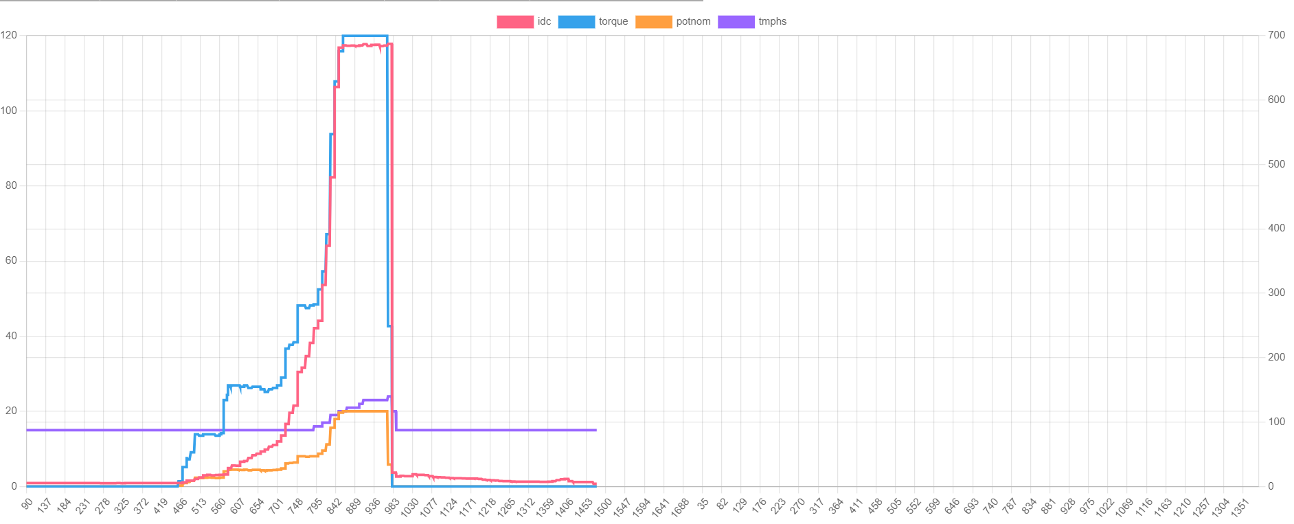

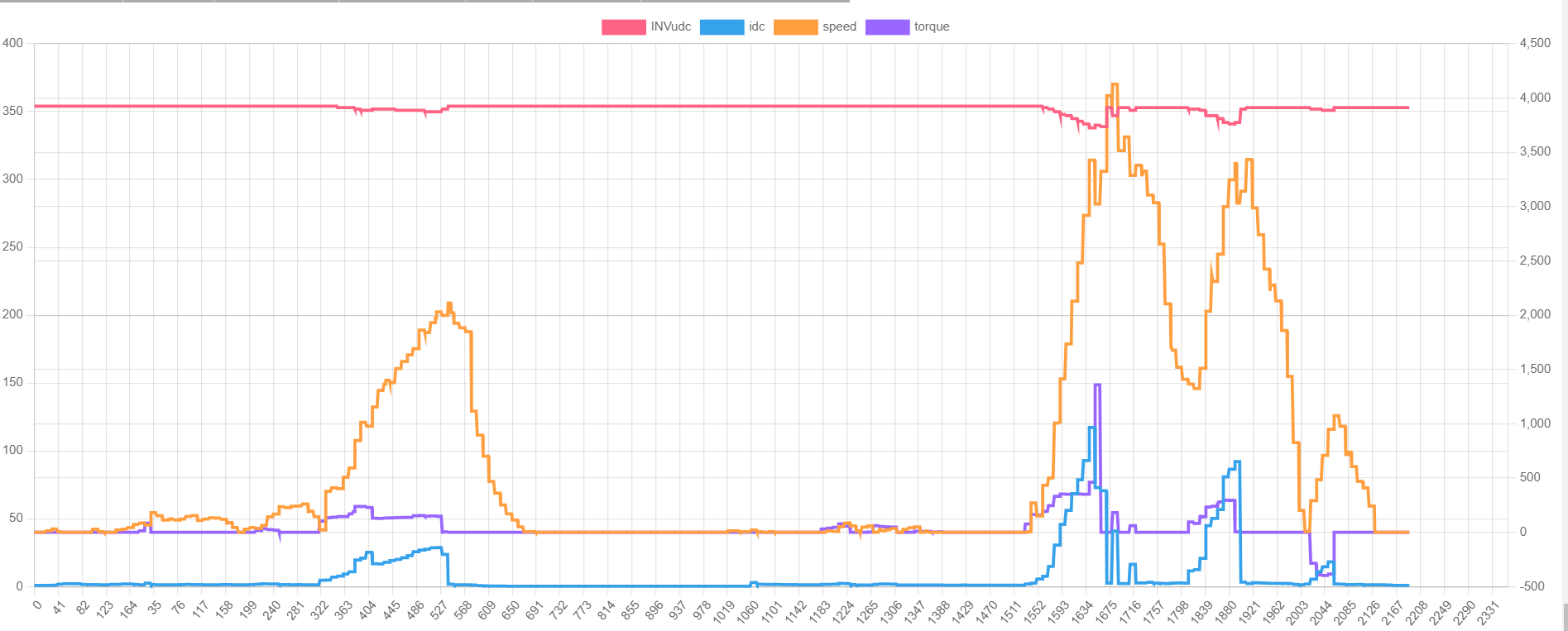

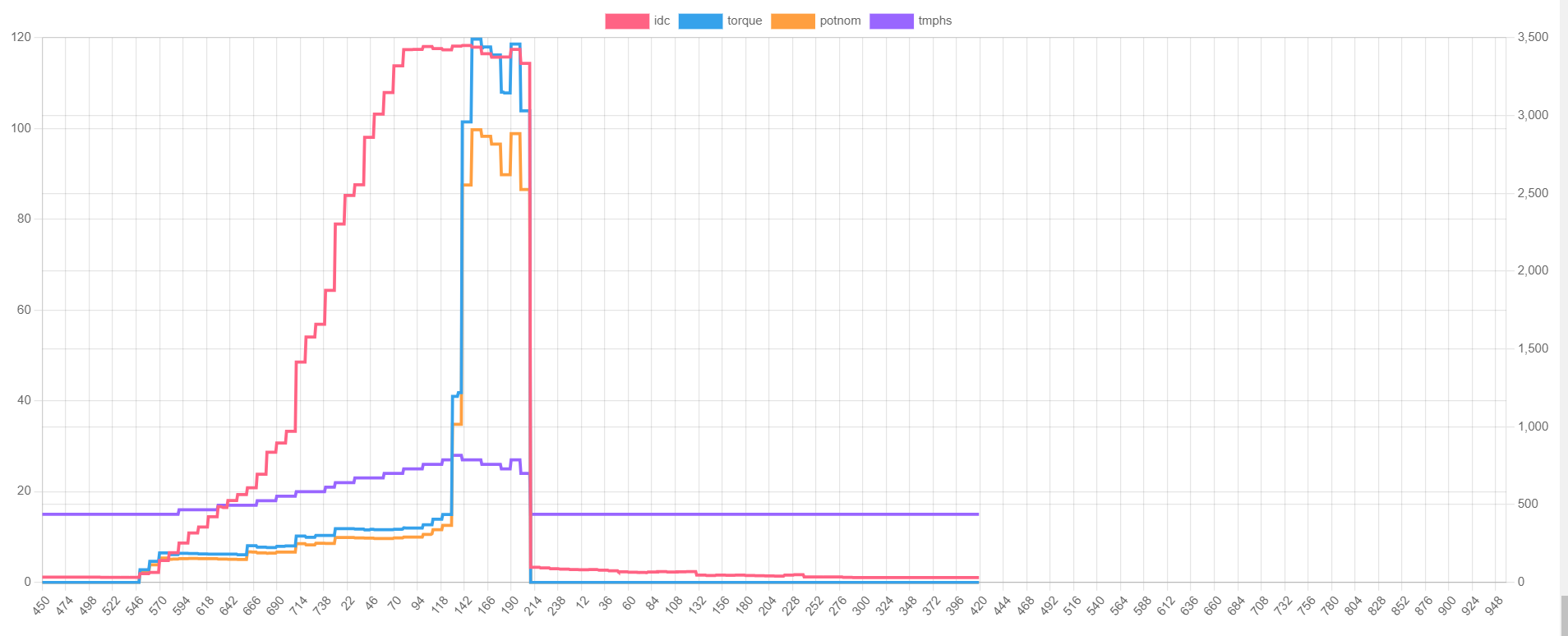

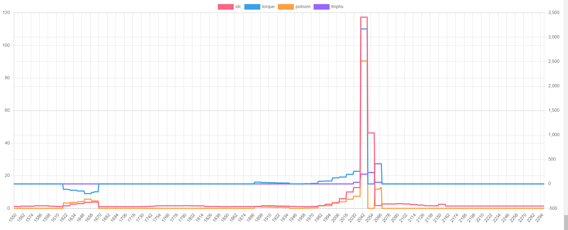

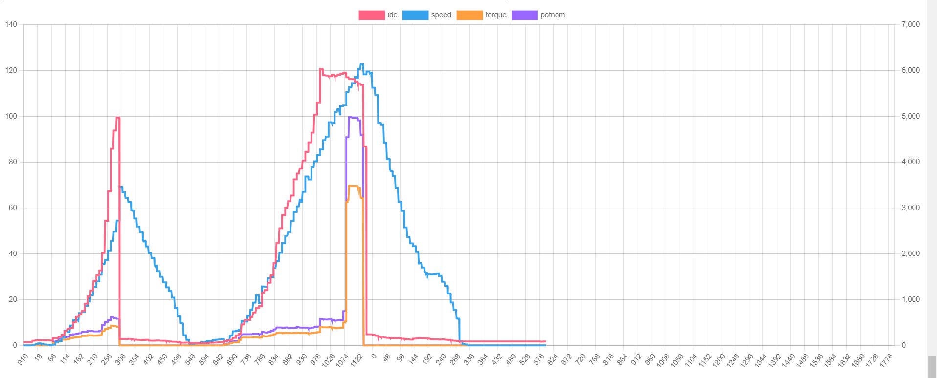

Well now I don't have the rattling coupling to confuse matters I did some more test runs today before the rain came in again
the results are interesting but confusing
there's a cut towards the second part of this run
this run I used minimal throttle no cut this run again minimum throttle no issues
here you can see a cut poss 2 (I didn't feel the first one) with a more aggressive run
definite cut in the 2nd half was also juddering in the middle
make what you will of this one
gradual build up the foot to the floor no cut
and my favorite, floored it from standstill no cut lots of wheel spin so anyway I have no idea what to make of most of this but the cut is still there. I've taken the inv volts and speed out of the later plots as they dont seem to be connected to the cuts also no matter how hard you push it current does not exceed about 120A

- Posts: 2962
- Has thanked: 328 times
- Been thanked: 847 times
Re: [WIP] BMW Z3
Note how in the 2nd to last plot, your "torque" request jumps but IDC does not increase this possibly highlights the fact that the command being sent is not fully correct.
Looking at this you can see there is no change from your roll on PotNom to it jumping from 15% to nearly 100%. I would hazard a guess scaling or byte positioning is not 100% correct. Possibly offset by one byte as the torque is transmitted as 16bit across two bytes.
Best way this could be fixed is logging an IS300h
or just trying all sorts of random hunches until you get lucky.

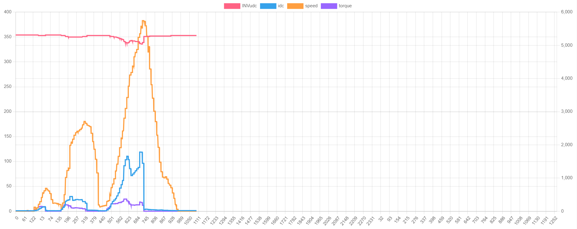

Re: [WIP] BMW Z3
just for reference all of the above parameters are well within their limitsBigpie wrote: ↑Thu Feb 15, 2024 3:09 pm So that's Zombie cutting, now to workout why.
*EDIT*
ok so the only things that can command a torque cut are : motor rpm, hs temp, motor temp, battery undervoltage, idcmax
Plot these to see if they're sane, and post your params?
Gaffa says he's happy to have a phonecall with you to debug if it'll help.

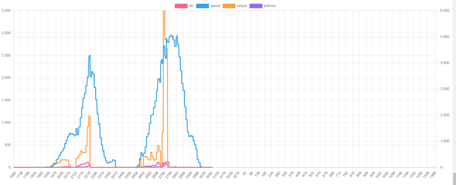

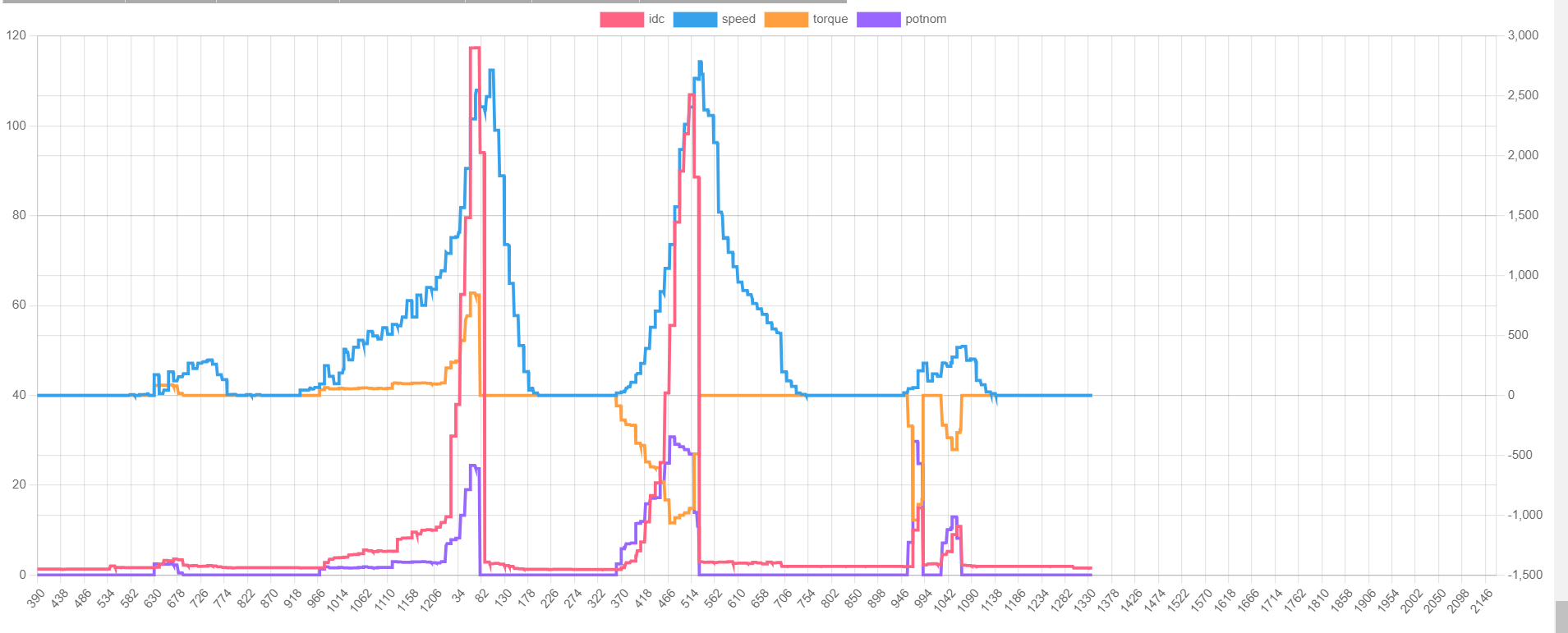

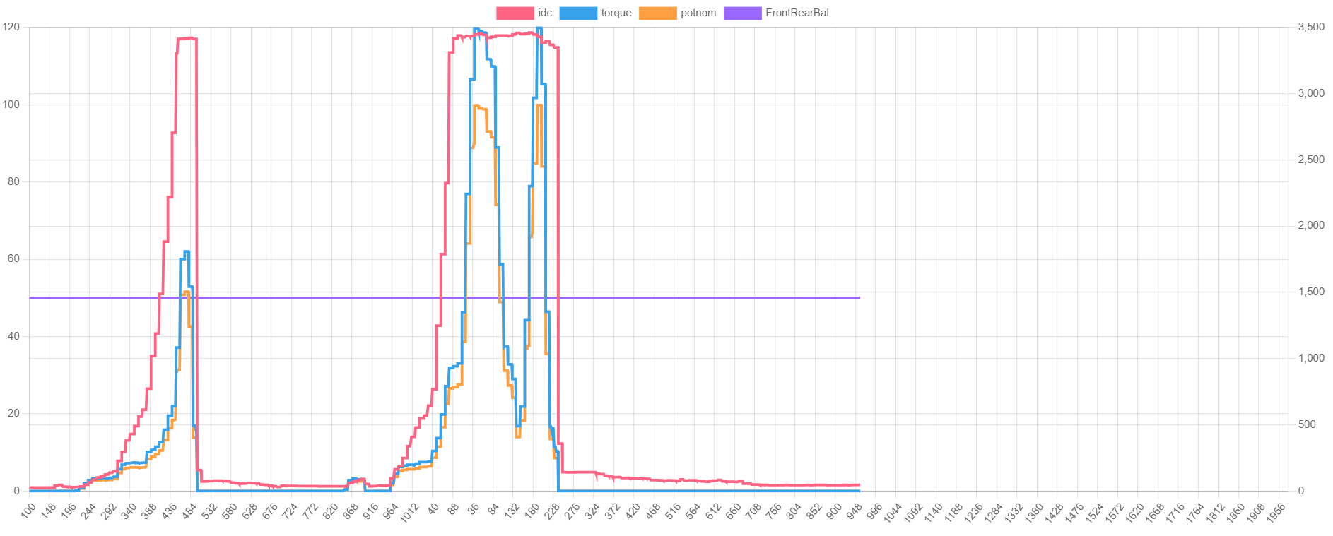

Re: [WIP] BMW Z3

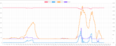

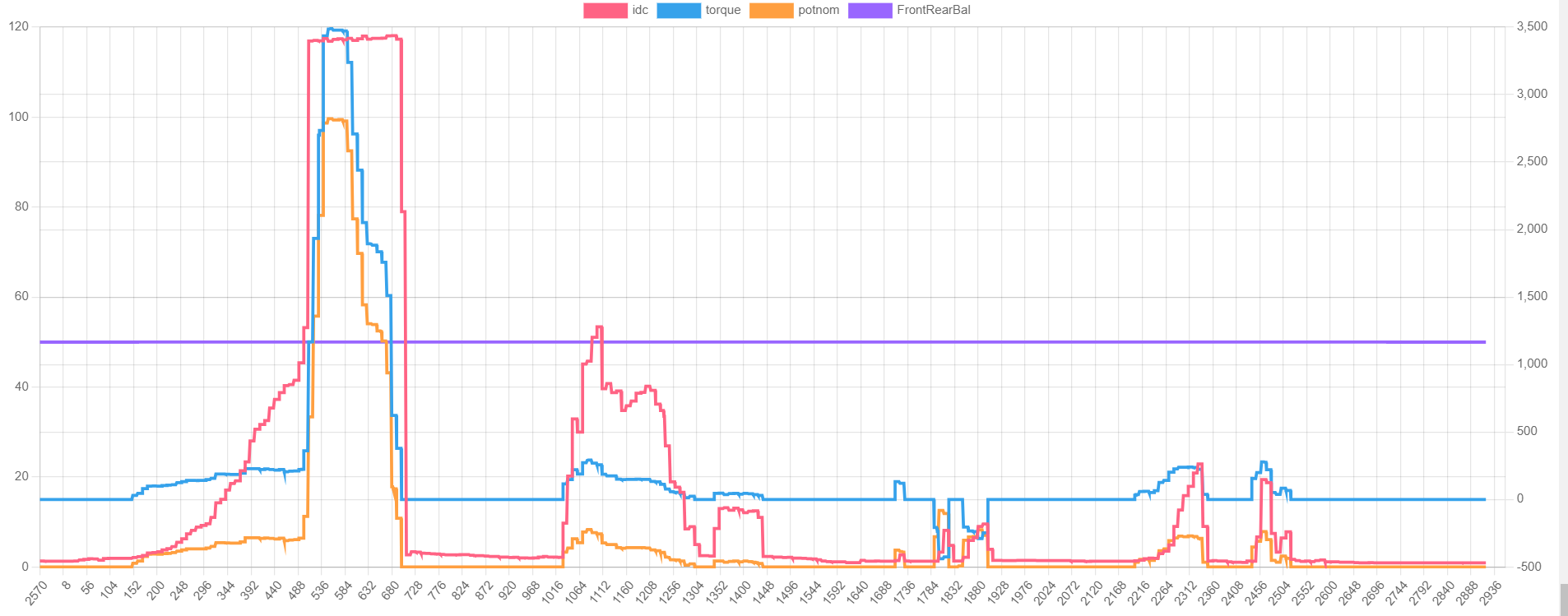

trying to get as much data as possible while the weather holds
(I plotted the front rear balance in the first couple just because I didn't know what it was and wanted to see)
there is a cut just after the 2nd half of the first plot
all the rest of the plots were pretty good as long as I'm really careful with the throttle once it's moving I can floor it with no issues
- Posts: 1884
- Has thanked: 91 times
- Been thanked: 517 times
Re: [WIP] BMW Z3
FrontRearBalance doesn't seem to do anything. It's hardcoded to 50 for all vehicles except Subaru but doesn't seem to be used for anything.

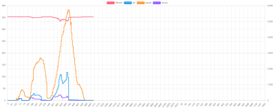

Re: [WIP] BMW Z3

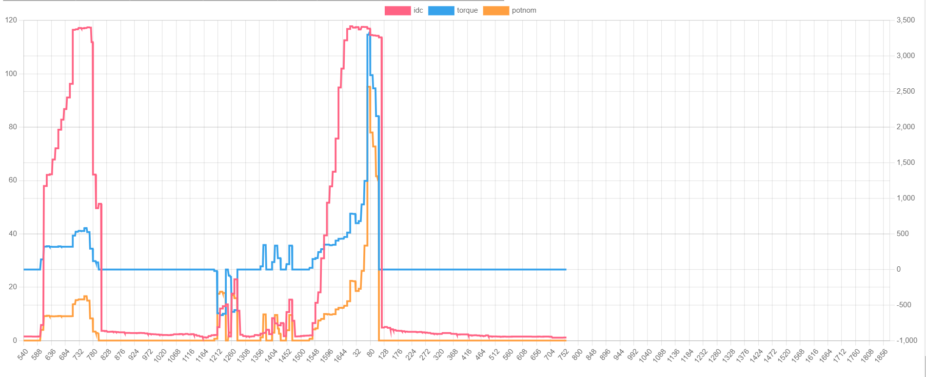

sorry this is not exciting the squeaking is the plastic surround on the steering column rubbing
first run was smooth, light throttle
2nd run juddering and cutting when pulling away at junction even with light throttle the wheels were spinning

Re: [WIP] BMW Z3
it is still very clear there is a bit of lag from potnom/torque request to when it pulls current.
The vast discrepancy of torque actually being generated/power draw vs the "commanded" torque is crazy. 'Potnom of 25% yields roughly a 800 torque request which can yield the max draw of 110A.
Would it be possible for you to do a run with the following:
1. Throtmax : 20%
2. Throtmax : 25%
3. Throtmax : 30%
This should allow you to floor it and just pull consistent requests, I would want to see the current build over time and the differences between the three.

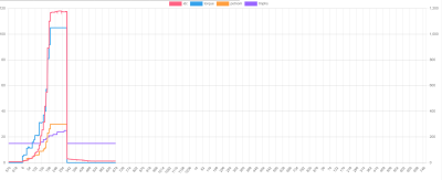

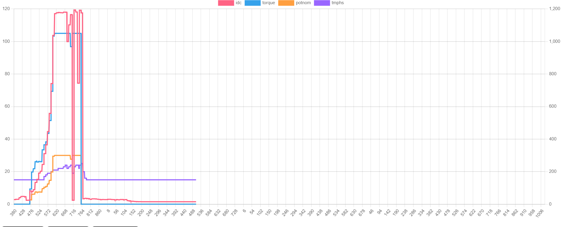

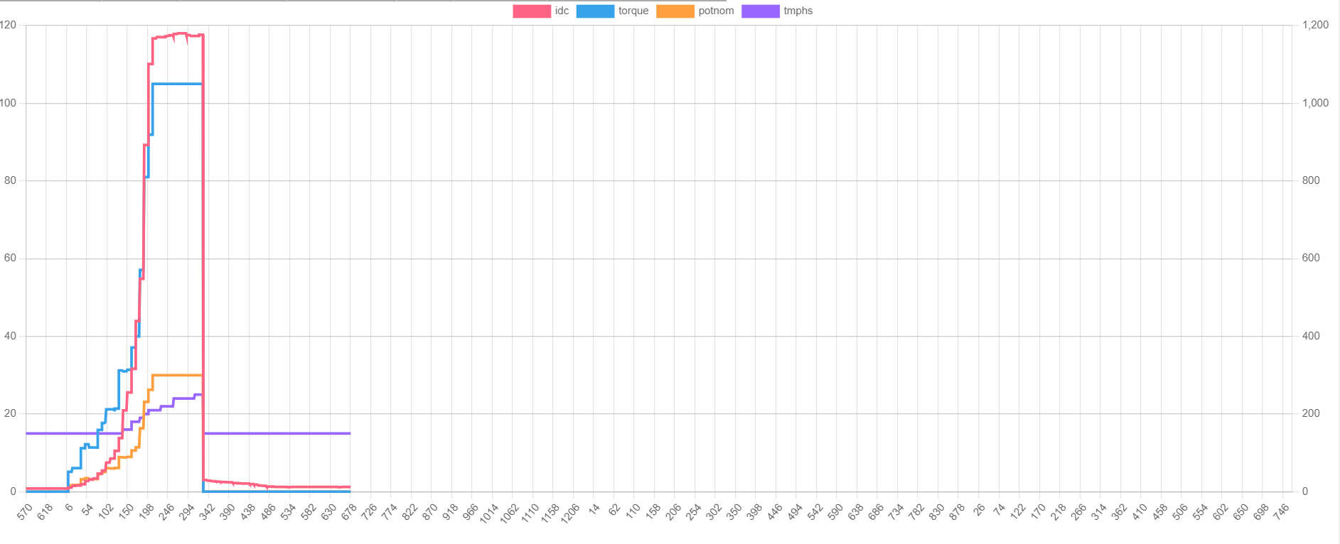

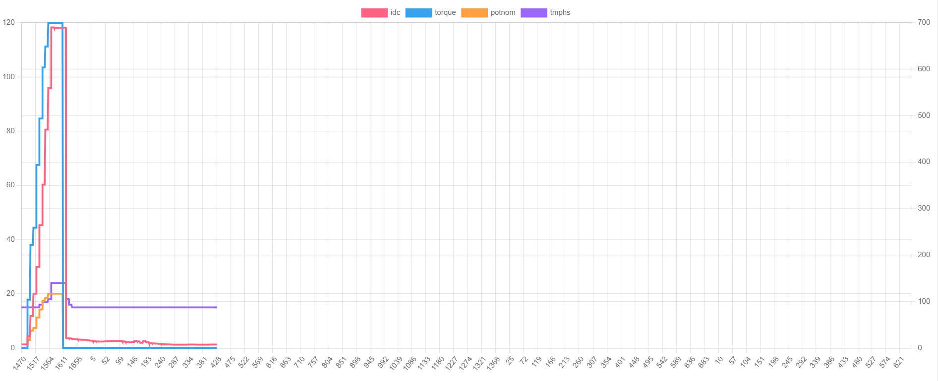

Re: [WIP] BMW Z3

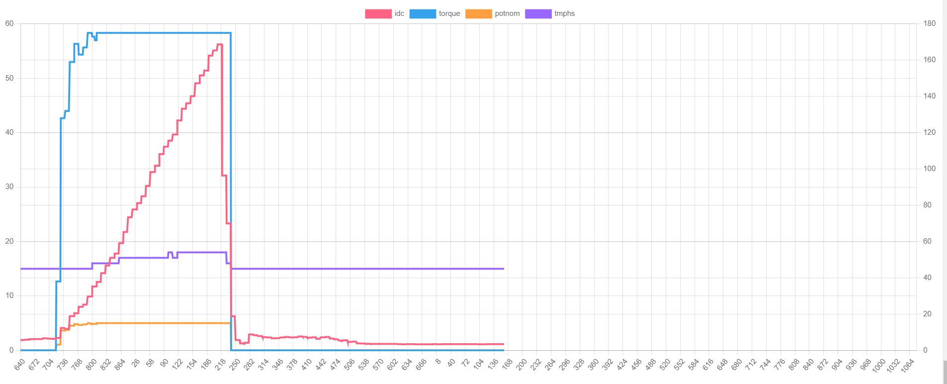

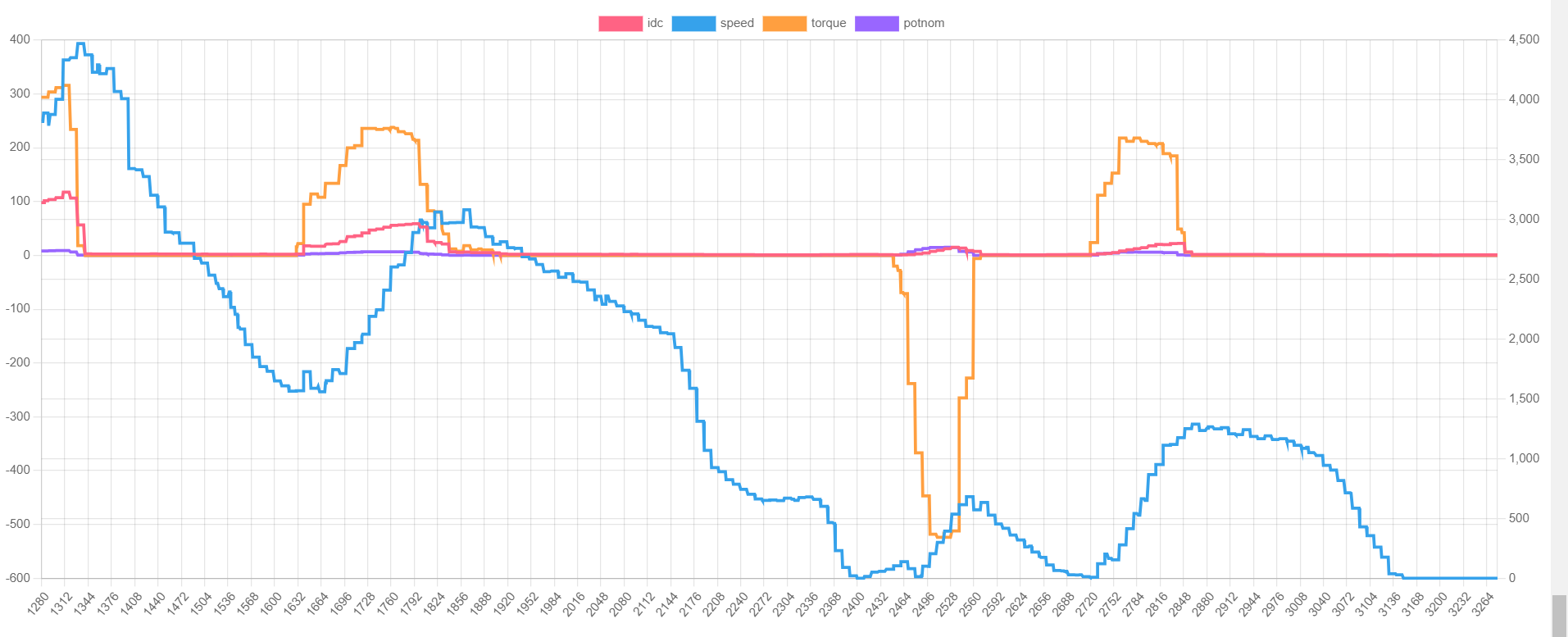

not 100% what you asked for but my neighbours are getting fed up with me driving up and down the road
20% 30% 15% This last was at 5% throtmax and was very rattly I think that my badly worn diff is contributing
- Posts: 2962
Re: [WIP] BMW Z3
These are perfect, what variable is on the right axis only the torque?andybpowell wrote: ↑Wed Feb 28, 2024 10:53 am not 100% what you asked for but my neighbours are getting fed up with me driving up and down the road

- Posts: 2962
Re: [WIP] BMW Z3
So currently you are hitting +/- 110-120A consistently, has your voltage been dropping and you not charged when doing tests over the past week?
It is very likely that you are hitting a discharge power limit.
