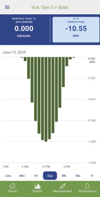

so just picked up one of these Emporia Gen 3 Monitors for myself and my baby brother to monitor our solar, these have way stronger WiFi signals than just suing the plugs, and it works great for him since his inverter is in a shed on the side of the house, I am thinking of picking up yet another one for our mums house
these also unlike just the Smart Plugs actually recognize if your energy is coming or going, so they don't show solar as consumption in blue but as production in green, good times
FYI they finally discontinued support for their Gen 1 product line so I advice you don't buy those used on eBay any more, at least jump in at Gen 2 if buying used

added two more 200 watt panels for a total of ten, now we have 2,000 watts of solar panels feeing into a 2,000 watt inverter, they are connected in pairs, so there are five pairs in parallel, and I can't wait to see how much energy that generates, hoping for at least 10 kWh per day
Total System Cost so far: $2,500(ish)
(yes I tried to wash them with Windex last night when I added the two additional panels on the right)
hell yeah 10 kWh of Sunergy
