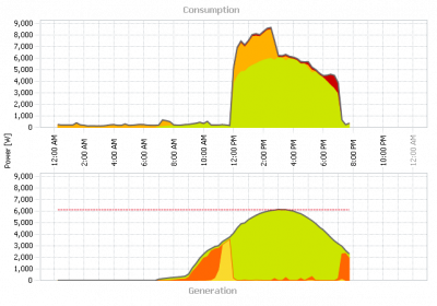

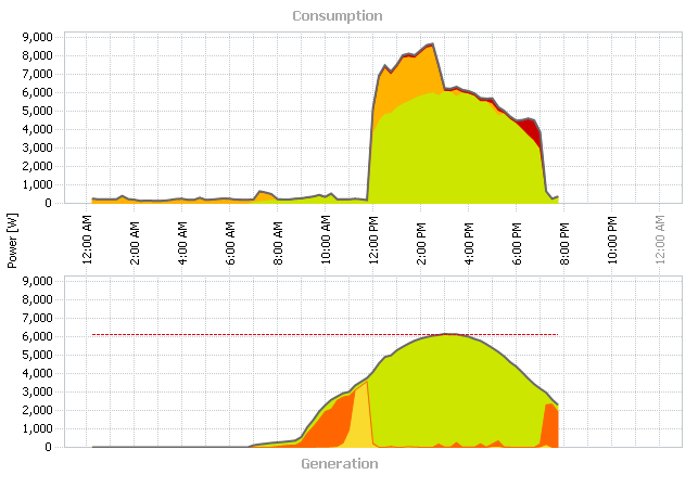

Now some chart from todays charging session. It doesn't get any better. I've set the controller to pull 100W from the grid. That way it maxes out the stationary battery inverter instead of allowing it to charge the stationary battery with priority. So car is always filled first.
Here's the result
39 kWh go directly from PV into the car, another 8.5 kWh come from the battery and just 1.6 kWh come from the grid including the end of charge when there wasn't enough solar power. Max charge power was 8.7 kW. Right now the battery is back to 34% which should be enough for the night
