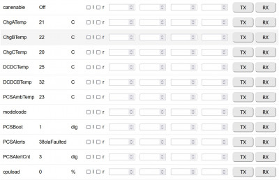

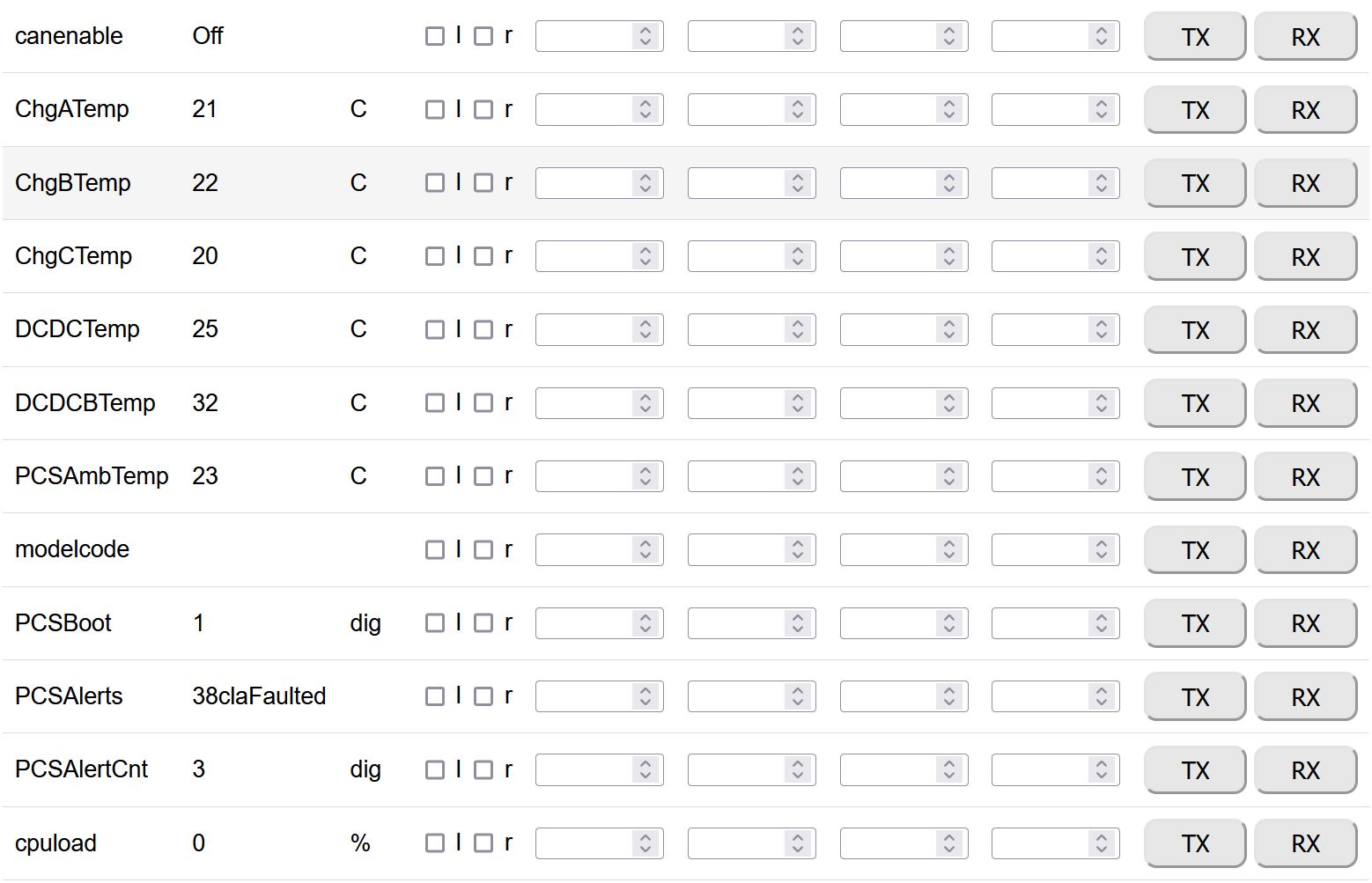

Have another question about one of the error codes also. Looks like I keep getting error: 38claFaulted but I can't seem to find an explanation of what this error is?

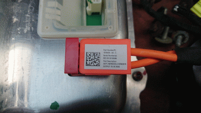

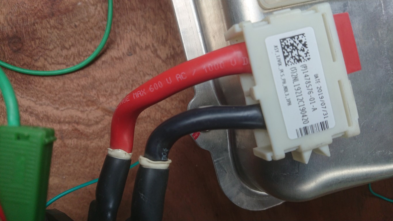

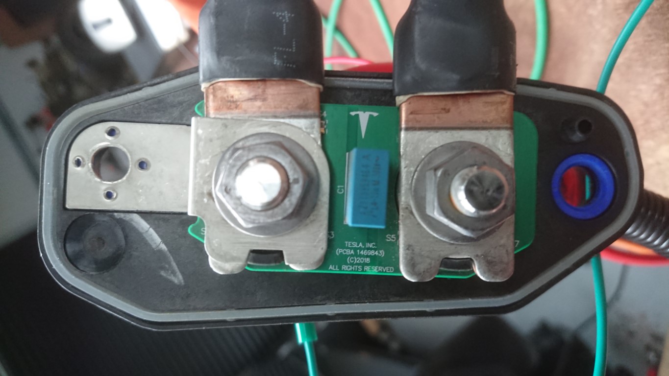

I suspect this is to do with the 12V side and possibly to do with a poor quality 12V battery. When I connect the charge cable, DC-DC starts up and the web interface reports system is putting out the required 14V. After a short period, a high pitched whine starts at low volume and gradually increases over a period of 5 to 10 seconds, before stopping...a few low volume clicks, quiet, and then the cycle starts over again. Refreshing the web interface during this shows the DC-DC shuts off, and restarts. This seems to be coming from the small PCB behind the 12V terminal block from the PCS (as in the pics below)
- Posts: 4007
- Been thanked: 1139 times
These Olimex wifi modules seem to be getting worse. I am working on that in parallel. Regards activating the DCDC in drive....ooops! Genius here forgot about that one:) Leave it with me a few days. I'm not up on every fault in the pcs but claFaulted is indeed generated by the DCDC so a different 12v battery would be my first port of call. What do your DCDC temperatures look like?

Is it ever necessary to have different DC-DC voltages for either driving or charging? Eg: 14V while driving when more load on 12V battery, but for hours of charging with lower draw on the battery, <14V is enough?
- Posts: 4007
Those temps are fine. Never needed different voltages myself but it would be easy to add a "DCDC DriveV" param if folks want?

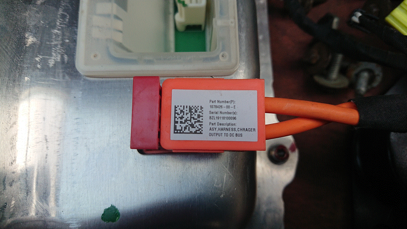

I'm still looking for a 3D printable version of this Plug.
Does this exist? Buying the cable is around 200€ - thats a lot just for a Plug!

This should be the one, same as used on some of the other controllers such as the GS450H VCU. I have the dual plug version of the PCS controller
https://eu.mouser.com/ProductDetail/Cin ... cycode=GBP

One quick search of this thread with the term "3d print" reveals :
https://github.com/muehlpower/EV-FFB
Can someone please add to the wiki page? I have done so on the first post.

Correct, BUT the HV Plug that i posted above is NOT included in this List, so there is no 3D Model of this Plug so far...Jack Bauer wrote: ↑Thu Sep 29, 2022 8:45 am One quick search of this thread with the term "3d print" reveals :

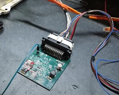

I'm going crazy on the task to find the correct housing and plug and pins.
On the EVBMW it says "Enclosure and connectors NOT supplied.Please see attached connector BOM". But where is it attached?
I went through the Wiki and the Thread and the EVBMW website and also GitHub. I ordered the housing from farnell but i just can not find the header. I went through the data sheets but none fits the holes on the board.
I have 35 Pin Holes, must be that one here on the picture
Help appreciated
Help appreciated
- Posts: 4007
On Github : https://github.com/damienmaguire/Tesla- ... Pinout.pdf
