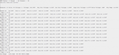

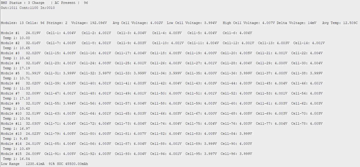

So far so good on my side. Balanced to 15mV now back to charging.
I do see some modules that report a constant temperature (17C)... Maybe the sensors are broken?

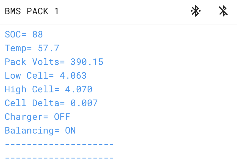

My pack was horribly out of balance to the tune of like 300mV at full charge.
After some testing with Bogdan over Christmas the new code is balancing at >20mV per day. Delta is now tiny. He’s also introduced some refined logic so that charging will not be allowed until balancing criteria has been met.
I’ll report back as further testing progresses.

Pretty happy with the results. This pack was 165mV out last week.
