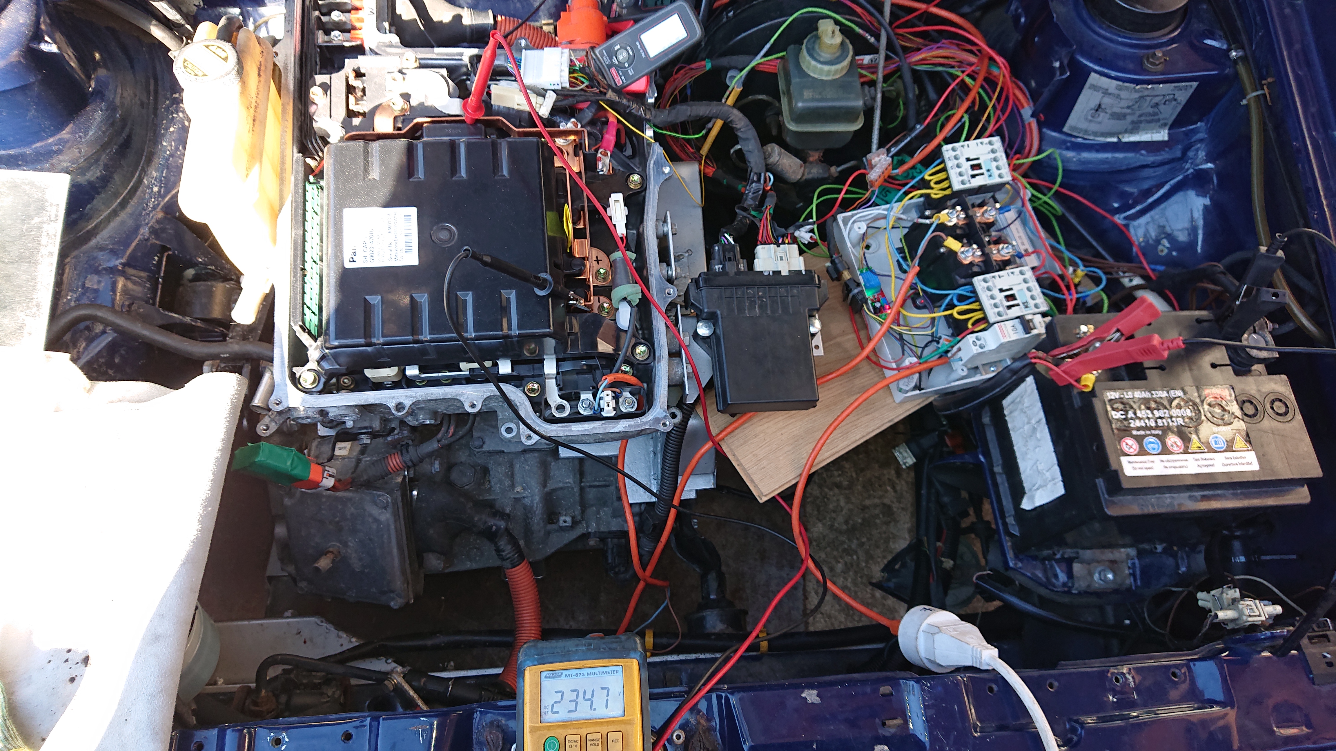

Got my setup into Charge Mode finally. Time to do some charging attempts tomorrow.
Been going over this thread from start again.
It might be a good idea to split it for BUCK charging from MG1 and BOOST charging from Air Con Output
It could be confusing for people who join later. I do plan to do a Wiki thread for MG1 Charging once all is working nicely.

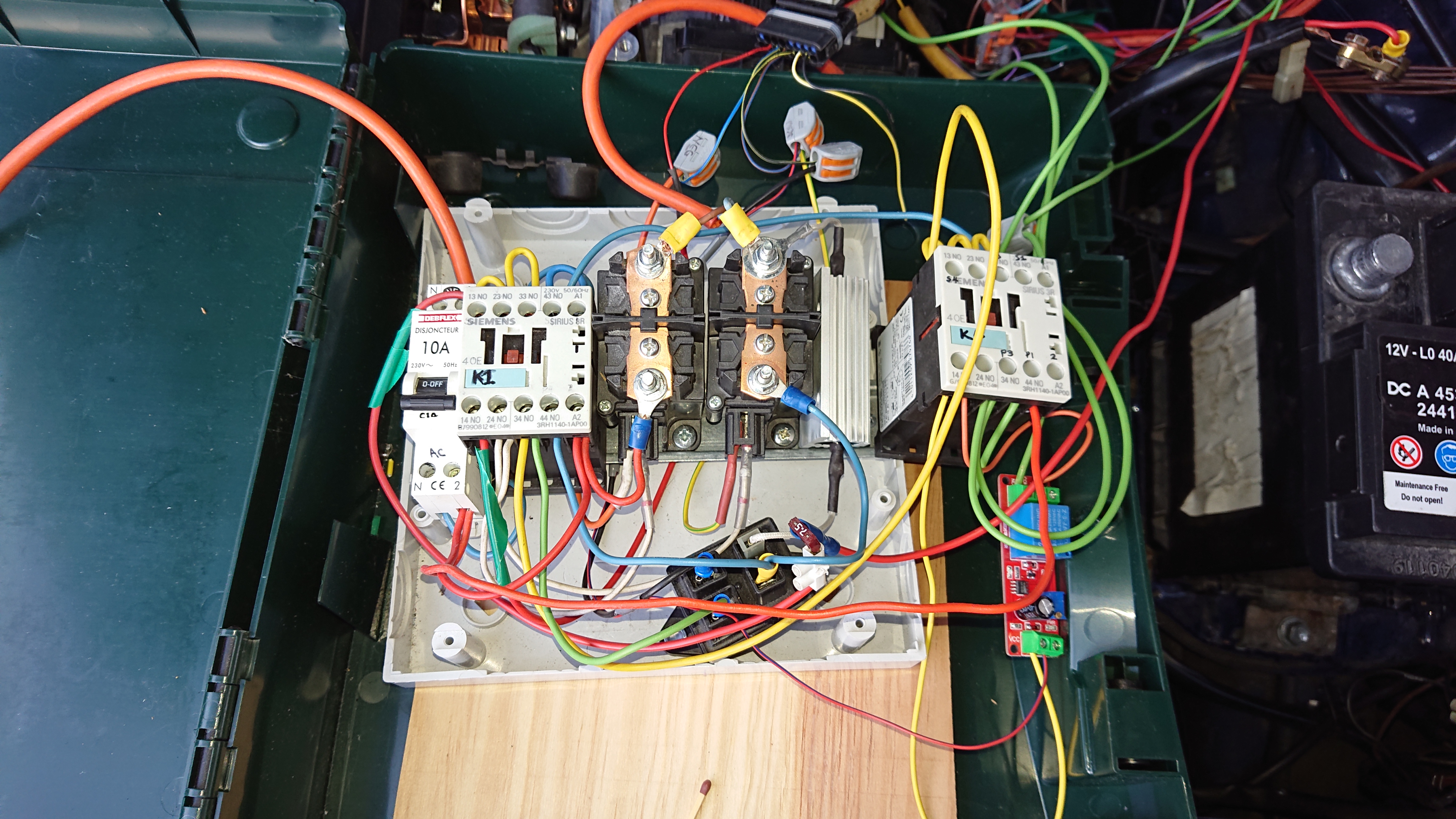

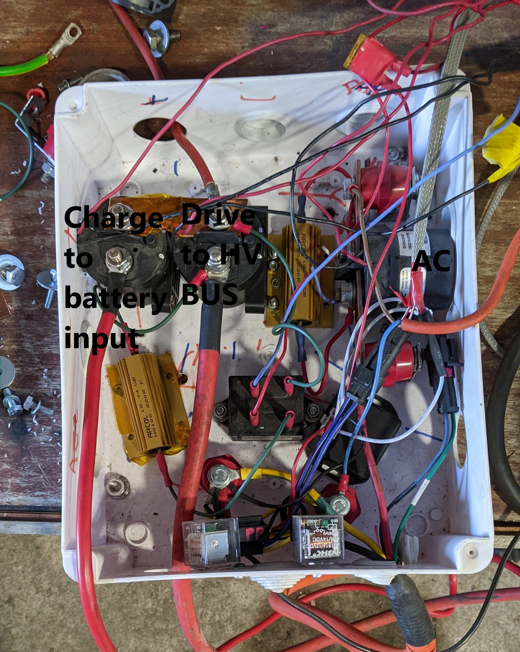

Probably a good idea for the wiki thread. I'll have to update the notes I made on this with the recent findings then I can throw those up as well.
This is how i have the junction box setup now. The main positive contactor connects to the HV bus, with a precharge resistor and contactor.
For charging I have a second contactor that connects to the default battery inputs, I linked this contactor to the signal for the AC contactor so they both close together and I don't have to change my setup at all.
In there is also the AC precharge resistor which is always connected, as well as the SIMP charge module with a couple small relays that ground the Teensy VCU signal wires for CP and PP on the EVSE.

Re: Prius Gen2 Adapter Board for CHARGING
looking good, why is the AC precharge resistor always connected?
- Posts: 571
- Location: Somerset, UK
- Has thanked: 76 times
- Been thanked: 218 times
Johannes said it wouldn't hurt and I am a cheapskate trying to save buying another contactor.

So I managed to test with 24v dc on Mg1 U and W to DC Bus (no load) . Changing PWMIN seems under control, 50% of 24v =12v.
I set PSDN to be pulled high on startup and go floating after 0.5sec.
Buck mode is detected too.
Now to recheck wiring, as my dcsw on HV battery is not closing.
I have the 2 sets of contactors in parallel so precharge and dcsw happens at the same time on AC and DC of inverter.
I was feeling lucky and took the risk of connecting 220vAC with PWMIN @10%, tripped house mains directly.
Time to investigate.
When I tripped the mains it was because when I added in the second battery contactor for charging or driving I forgot to change the code. So I was closing both contactors, shorting battery input positive and the HV bus positive.
Which could have gone worse.

Sorry I wasn't very clear on my setup. My contactors are controlled a separate Teensy based VCU I designed and coded. It takes the inputs signals from the inverter control board and then activates the contactors based on that. The idea was that I could add in additional safeguard checks before closing the contactors.
How I have it setup there are separate outputs to control AC, battery + and precharge contactors. So when I added in the extra contactor I had to parallel the AC and the new battery + for charging contactor. So when charging I really don't want to close the normal battery + contactor which connects to the HV bus.
If you only have one connection from battery to the normal battery inputs none of this will matter. It's just the only time I have managed to trip a breaker.
I don't use the precharge contactor on the battery side though. Have you got a photo of your contactor setup?

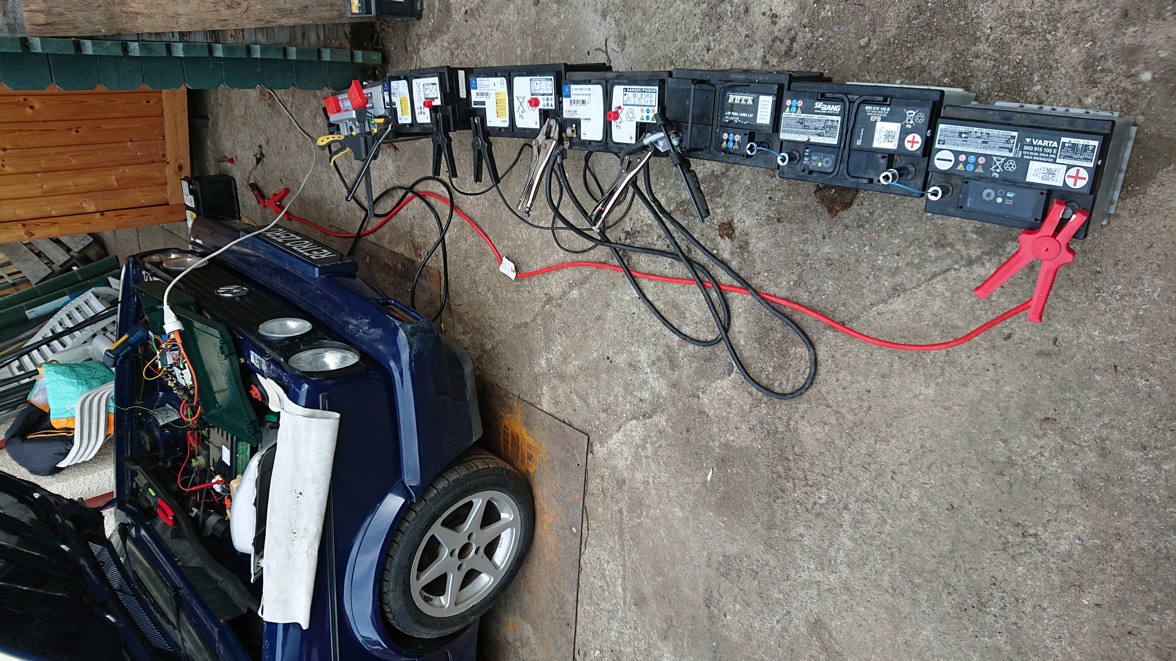

Champagne !!
Firstly, I set udcgain to 27. I had 12v battery hooked up to battery inputs, voltmeter on dcbus showing similar value, but udc in parameters showing around 50v...
Idc was around 115amps ,and il1 and il2 were around 56amps each.
Once udc was close to measured value on dcbus, il1 and il2 became more plausible values automatically (around 1amp).??
After adding battery by battery, I got to charge a 12v battery (hv battery inputs) from 84v DC input on Mg1 (7 batteries in series)
I played around with pwmin and pwmax to see their effects on bus voltage and amps.
I took the plunge and hooked up 230v ac house mains, configured for 27% charge and succeeded in charging at 80 or so volts!
No mains tripping
Will attempt charging original prius battery pack tomorrow.
Will go through wiring and schema and put it in the wiki once happy with setup.
Thanks to everyone chipping in to get this to 2 viable charging options from inverter.
More tuning and parameters to follow.
Did notice quite a spike when I turned off charge mode (removed ac plug). On second attempt, I changed pwmin to below pack voltage and then switched off. No spike.
Would pulling CSDN high and then removing the plug be a better option?
