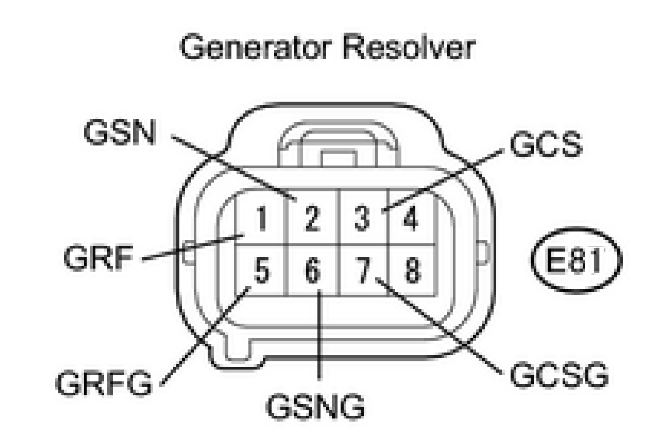

Attached is pinout for Generator Resolver connector (E81)

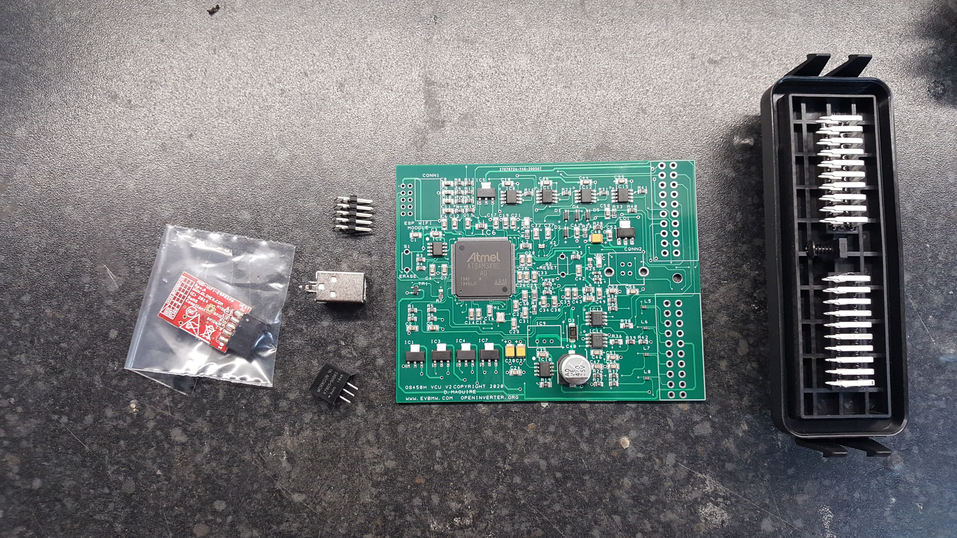

GS450H kit build video coming soon.

Good to know that the JLCPCB rolls of electrical tape come in different colours!
