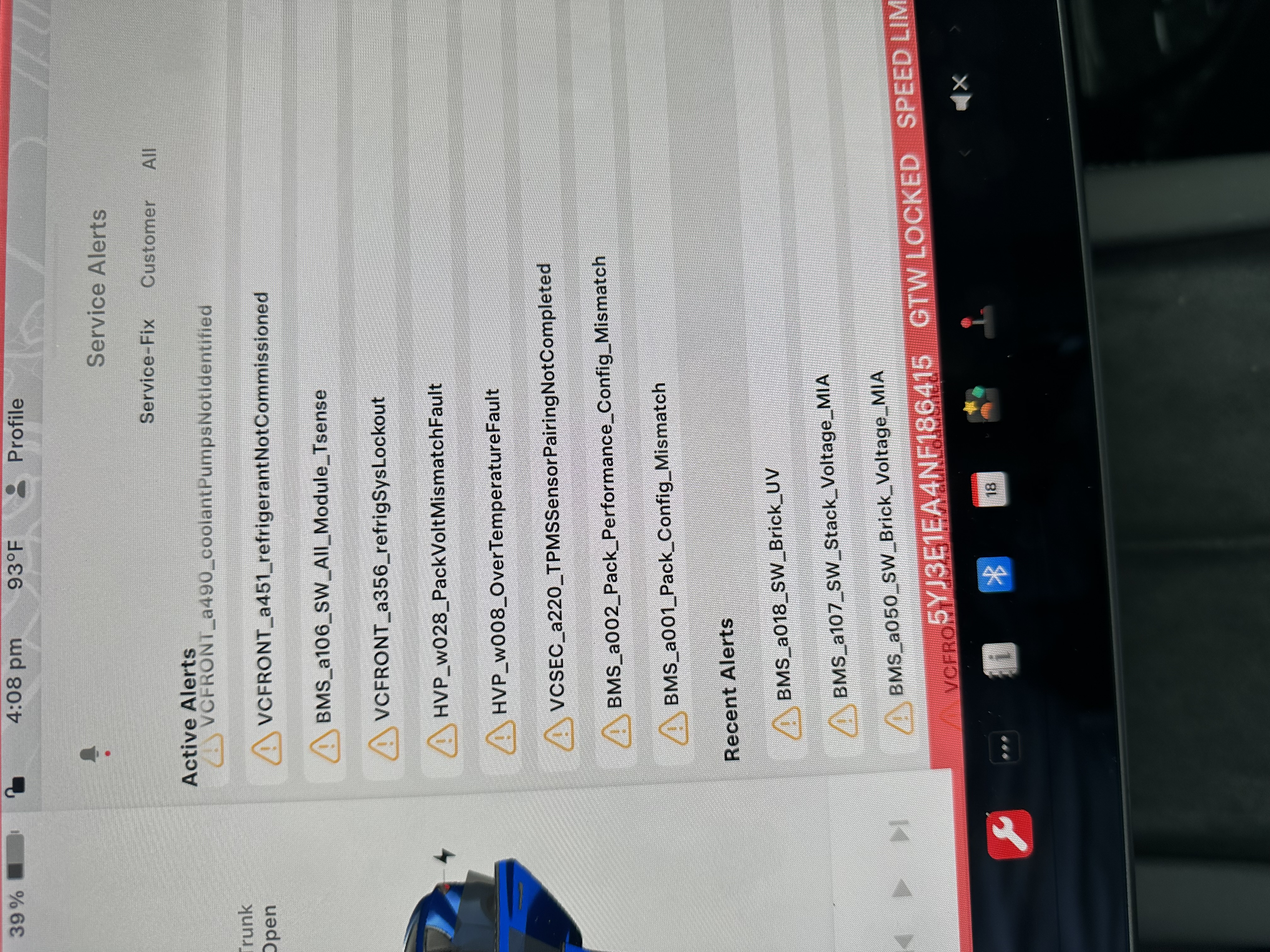

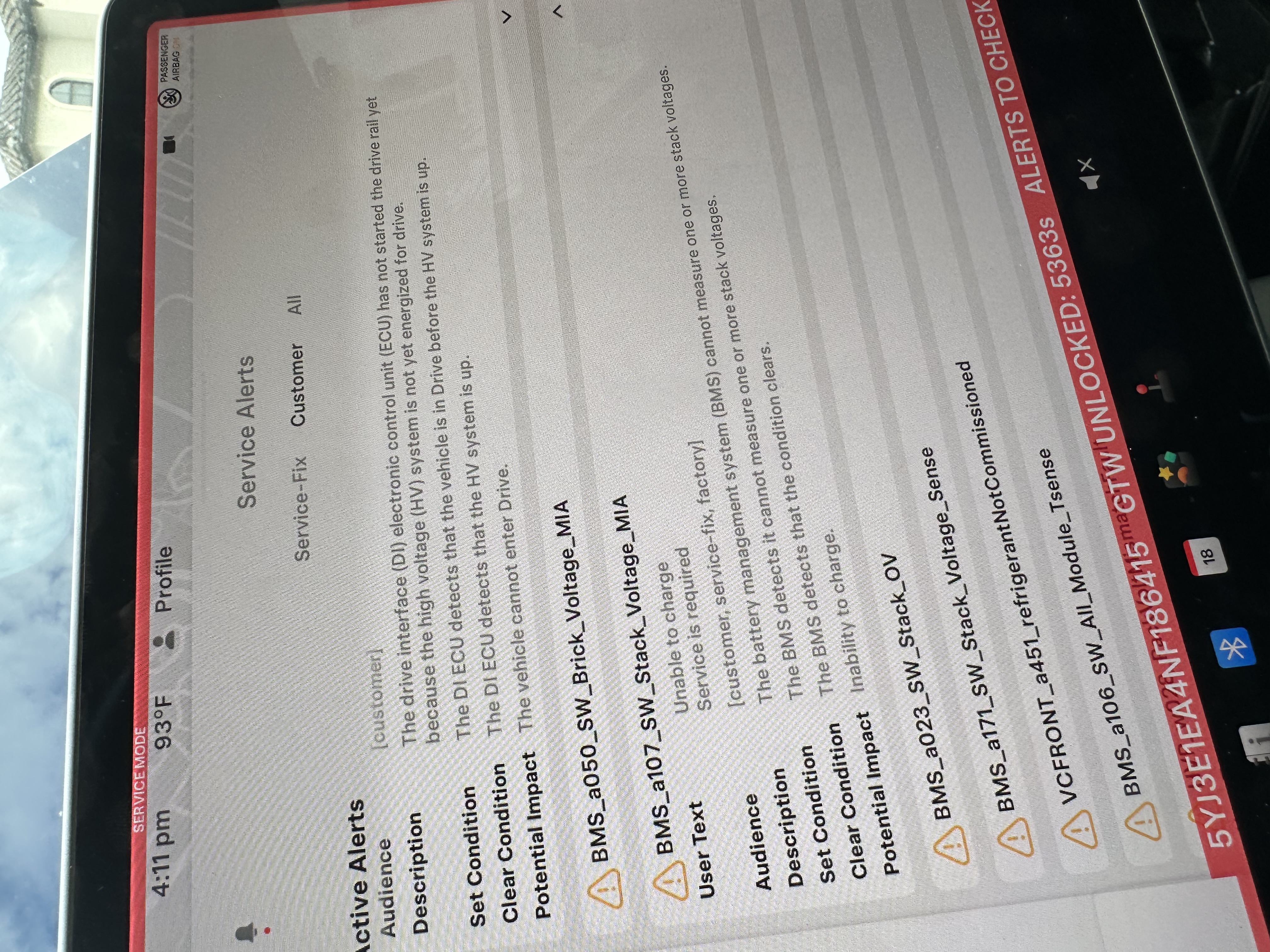

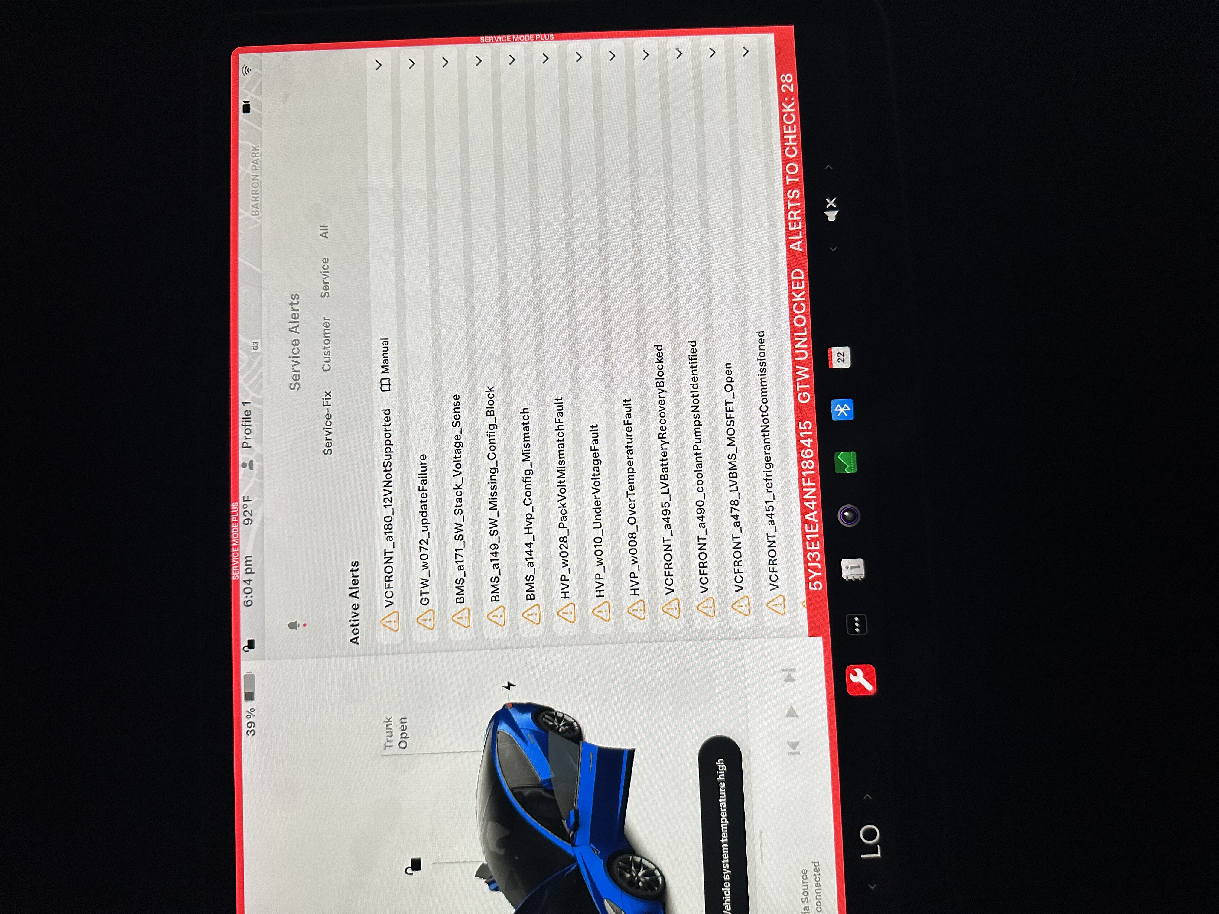

I really could use help I have a 2022 model 3Nam wrote: ↑Sat Feb 11, 2023 7:41 pm Yes, I connect the battery to the display. Actually almost complete car except doors and some front sensor. However, all peaces are removed from a car and de-assembled in my garage so maybe I may miss out some connection. I manage to get the firmware updated to all ECU including BMS.
Health test will require the battery to be fully discharge but the contactors are open so I don´t think health test can be done.
HV CONTACTORS won’t close tu support system I’m getting Bms pack configuration mismatch

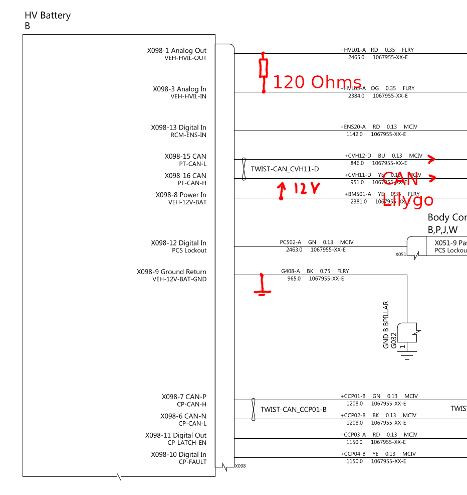

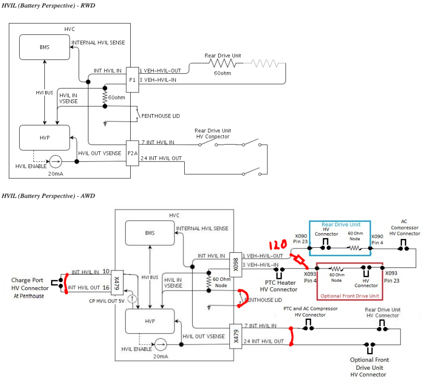

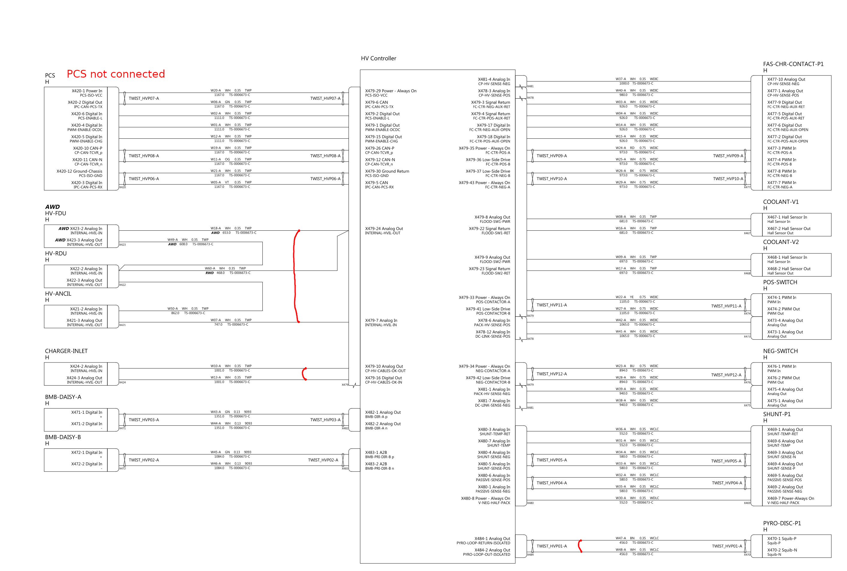

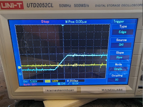

Hello everybody! I am trying to turn a a M3 battery from the scrapyard into a solar home battery and having trouble getting the HVIL satisfied... Here's what I tried:
Any help would be highly appreciated.
It's a 2021 AWD battery.

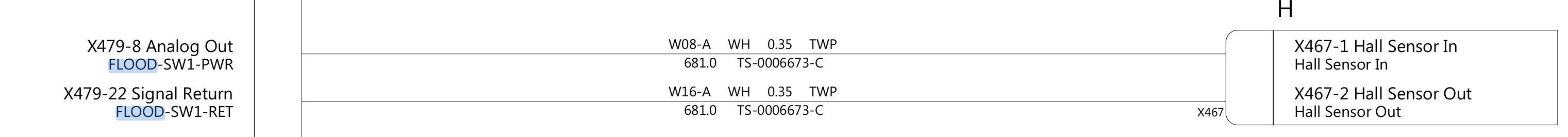

I have the feeling that the 20mA current source never gets activated, I checked the voltage on the 120 Ohm resistor and it's always zero - not even for a tiny amount of time when turning on (blue is the 12V supply and yellow is Voltage on Pin 1 of X098. When I measure resistance between X479-24 INT HVIL out and ground I get around 180 Ohms, as expected. Also when I measure voltage between X479 pin 10 and 16 I get 4.8V...
I honestly don't know what to try anymore... both flood sensors have around 11.6V on the Analog Out and 0.6V on the return... I assume that's the dry output? I also tried 60 Ohms instead of 120...
Edit2: Works now. You need to send the right CAN commands to activate the 20mA current source:

I’m really struggling to get my contacts to close too using evcontrols controller, did your schematic you put up with your jumpers and resistors end up working out for you? I believe I have the same problem you had with the 20mA current not being activated because I’m getting some faults that I can’t figure out how to clear and I am not getting any voltage out of my HVC to the shunt and contactors. Any help would be greatactuallyali wrote: ↑Tue Sep 12, 2023 7:15 pm Hello everybody! I am trying to turn a a M3 battery from the scrapyard into a solar home battery and having trouble getting the HVIL satisfied... Here's what I tried:
CAN_frame_t TESLA_221_1 = {.FIR = {.B = {.DLC = 8,.FF = CAN_frame_std,}},.MsgID = 0x221,.data = {0x41, 0x11, 0x01, 0x00, 0x00, 0x00, 0x20, 0x96}};
CAN_frame_t TESLA_221_2 = {.FIR = {.B = {.DLC = 8,.FF = CAN_frame_std,}},.MsgID = 0x221,.data = {0x61, 0x15, 0x01, 0x00, 0x00, 0x00, 0x20, 0xBA}};
