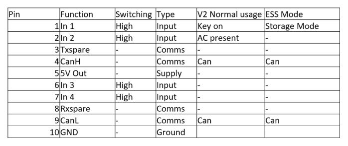

Has anyone had an issue with charge input not working, I have 12v in J5 pin 6 but nothing comes up on input in debug. Not sure if I've set something up wrong, no errors and input for drive mode works fine.
joromy
Posts: 371
Re: Simp BMS
Post by joromy »

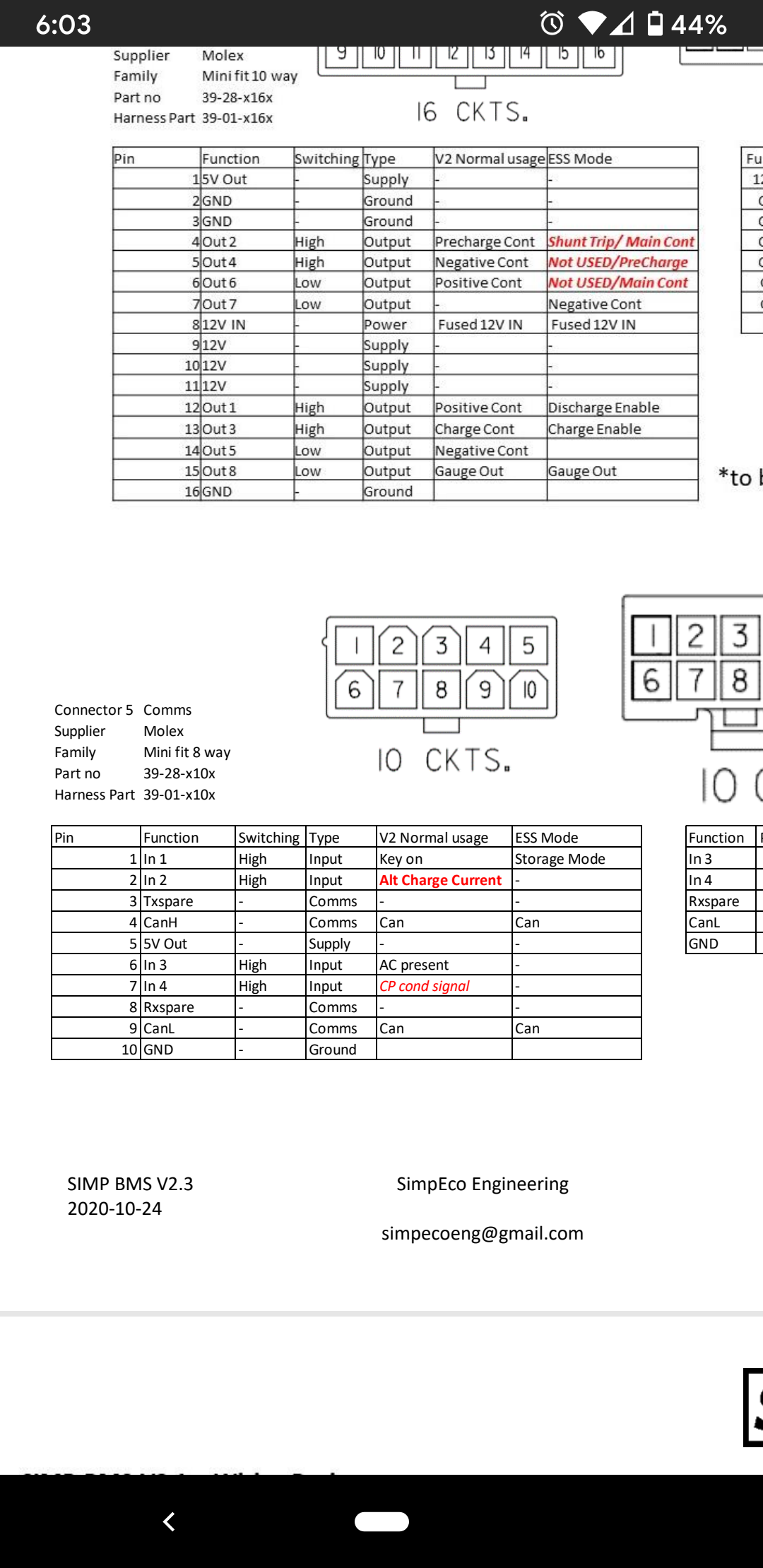

I think you have an old manual, d/l ver. 0.9 (or newer)
It should be pin 2 IN2.
Edit:
Sorry wrong again, you have the right pin!!!
There was swapped pins in old manual it's fixed i new manuals.
Posts: 3796
Been thanked: 413 times
Re: Simp BMS
Maybe input has pull up. Test if you need to show it GND? Some of the pins are active high and some active low.

Hmmmm. where do you get that manual from? I'm using manual v0.23 off the simpbms GitHub. Pin2 is alt charge current in that table.
Posts: 2963
Has thanked: 330 times
Been thanked: 848 times
Re: Simp BMS
Pin 6 is charge enable / AC present.
Have a measure on the opto coupler to see if it changes.

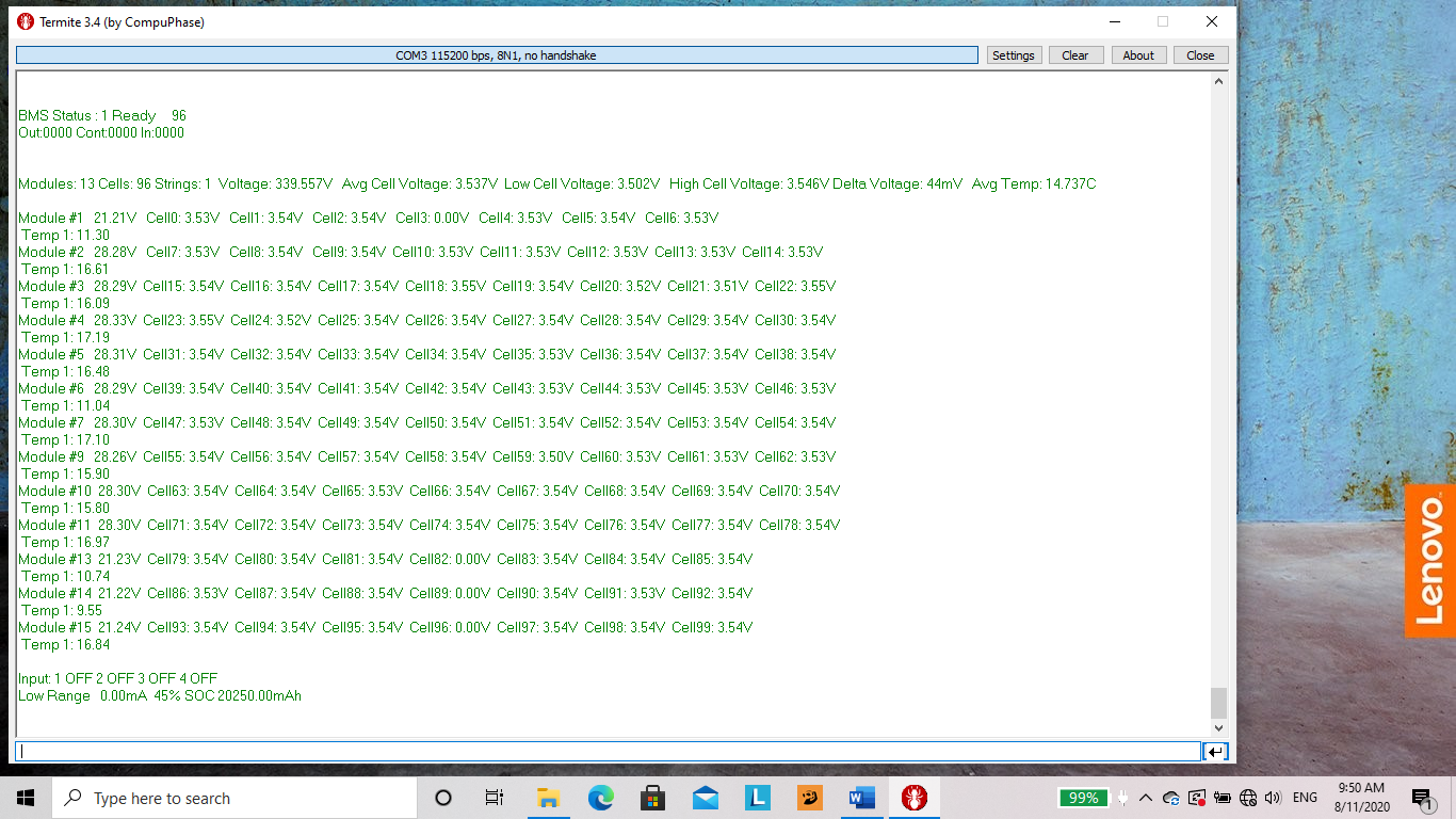

I noticed in Dusty4's output the same thing I see - 0V for middle cells...Is this a known issue? And is it simply ignored by the ignore cell with voltage less than threshold setting?
Posts: 2963
Re: Simp BMS
mdrobnak wrote: Mon Nov 09, 2020 10:15 pm I noticed in Dusty4's output the same thing I see - 0V for middle cells...Is this a known issue? And is it simply ignored by the ignore cell with voltage less than threshold setting?
The reason for this is purely down to can decoding. I do not map it exactly but do it as "simple" as possible. Some slaves might skip one or two fields and leave those at "0.0 V", but not to worry the code does not care as long as your cell count says the amount of cells connected you are fine.

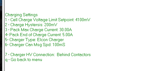

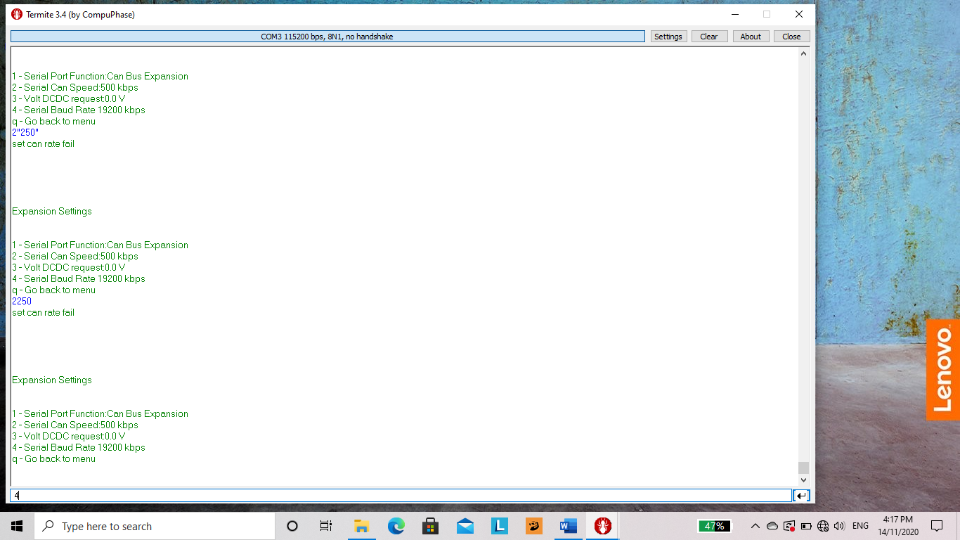

Hey Tom, I've got it hooked up again and inputs work correctly now :) . I've got a problem with the tc charger I'm using, the bms is in charge mode, plug in the charger and I get red,green,red led (bad communication). I see in the serial terminal the expansion module is set to 500kbps (I'm unable to change it) and the charger has the option of 250kbps or 500kbps. I'm not sure what the charger would be set at, and I got very little documentation with it. What is your thought?
Posts: 2963
Re: Simp BMS
Dusty4 wrote: Sat Nov 14, 2020 11:06 am Hey Tom, I've got it hooked up again and inputs work correctly now :) . I've got a problem with the tc charger I'm using, the bms is in charge mode, plug in the charger and I get red,green,red led (bad communication). I see in the serial terminal the expansion module is set to 500kbps (I'm unable to change it) and the charger has the option of 250kbps or 500kbps. I'm not sure what the charger would be set at, and I got very little documentation with it. What is your thought?
What are your charger settings? Do you have any can sniffer tool to check the data coming out of the charger without the bms attached, you just need to give it AC voltage for it to start spitting out canbus.
I do not recall still having an issue with a canbus expansion module, are you on the latest firmware?

Charger setting in pic, firmware 311020. I should be able to check CAN data tomorrow morning.
Screenshot (21).png (9.17 KiB) Viewed 7522 times
Dusty4
Posts: 85
Joined: Tue Dec 25, 2018 12:41 pm
Location: Western Australia
Has thanked: 11 times
Been thanked: 9 times
Re: Simp BMS
Post by Dusty4 »
Good news Tom, This morning I've plugged the CAN module into a serial adaptor and I was able to change the baud rate to 250kbps, I was then able to change the expansion setting in the serial terminal to 250kbps. Connected it all up and it's happily charging👍 Thanks for your help

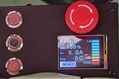

sorry to be a pain Tom, my display isn't displaying any data from the BMS. how can I check if the BMS is sending anything? Or would it be worth reflashing the display?
Posts: 2963
Re: Simp BMS
If absolutely nothing is shown, usually reversing RX and TX wires might be the fix
Dusty4
Posts: 85
Re: Simp BMS
Post by Dusty4 »
Yeah, that was my first thought.. no difference :?
Posts: 2963
Re: Simp BMS
Try flashing the display.
