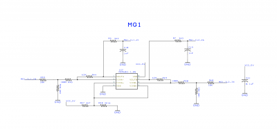

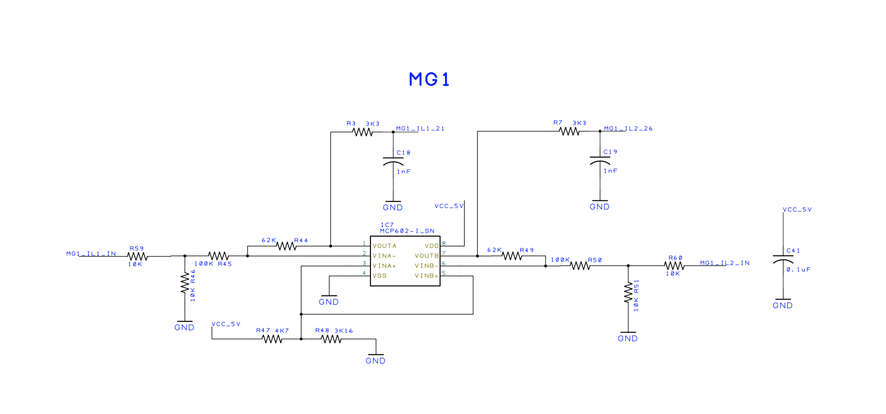

Ahh, I understand on a high level. I guess adjusting some resistors on the logic board will scale it down?
TBH, you've already made it 100% better so if this is as good as I can get out of the current hardware pretty happy with it
Edit, just another note, I have the gen3 Prius board but the inverter I've got in there at the minute is a from a Yaris but with the Prius main capacitor. Not sure if the physical current sensors differ. Think I've got the Prius sensors somewhere.

Would changing R59 to 20k and halving the scaling be the fix or am I wayyyy of in my understanding?
- Posts: 1801
- Has thanked: 102 times
- Been thanked: 350 times
Re: VW - Beetle 2003
Now that's interesting, that's similar to the circuit block that I'm currently modding onto my logic board! Gives me confidence that I'm going in the right direction with it. I'm wondering whether I've been looking at the wrong set of reference schematics. Where is that circuit from?
Not sure R59 is the resistor I'd change, probably reduce R44 instead but need to work out the gain equations first (the standard circuit gives a bipolar output, that one has been tweaked to cope with the stm32 adc's 1.65v midpoint offset) to make sure the 0A point stayed in the right place.

https://github.com/damienmaguire/Prius- ... ematic.pdf Damien's git hub.
- Posts: 1801
Thanks, that explains it, I was looking at the dual motor version and I can't see them on that.

What kind of full scale current are you after? Bear in mind the bigger you go the worse the resolution at low current becomes.
Assume you have both MG1 and MG2 current going through the MG2 CT?
Ill try to have a look at what resistor value change would do the job this evening.
Just looking at your MG2 param file I would guess at around 644A, would need to know the circuit to be sure though. If you have a link I can have a look?

In that case I might be more tempted to detect the adc maxing out in software and derate. Keeps the full resolution and probably safer overall - @johu, what do you think, possible or not?

I don't think that the ADC is limiting, the maximium output for the circuit above is 3.24V with 0V input. If the current sensor response is as on github, 1-9V then the ADC will not see above 3V.

The trouble is the CT output can actually exceed those values. The op amps in the CT are powered from -5v and 26v and can probably get to an output of -2V to possibly up to somewhere near 20V! We tend to push them a little bit past Toyotas 1-9v range (which is based on guaranteed output under worst case conditions).
If you work back from the possible 12bit adc range, through Bigpie's current gains and compare this with the currents measured it is right on the limit (and that's assuming a perfect mid rail reference which is unlikely).

Is this the graph you are referring to?
https://github.com/damienmaguire/Prius- ... _curve.jpg
If so I see your point, that would suggest that we should comfortably have a 600A range. Something isn't right there though, my fairly rough measurements suggest 10mV/A for MG2 (and I'm fairly sure I've seen that figure elsewhere too) which doesn't tie up with that plot. Could the plot be for the Gen2 (the numbers seem to match Ev8 gain parameters much better and he is using the Gen2)?
Has anyone characterised the CTs using a decent current source or measured one against an accurate meter?
Either way I still think the adc is clipping on Bigpie's setup based just based on the adc range, Ilxgains and measured currents. If the current sensor gains are wrong it's still clipping but the current is being under (or over?) reported.

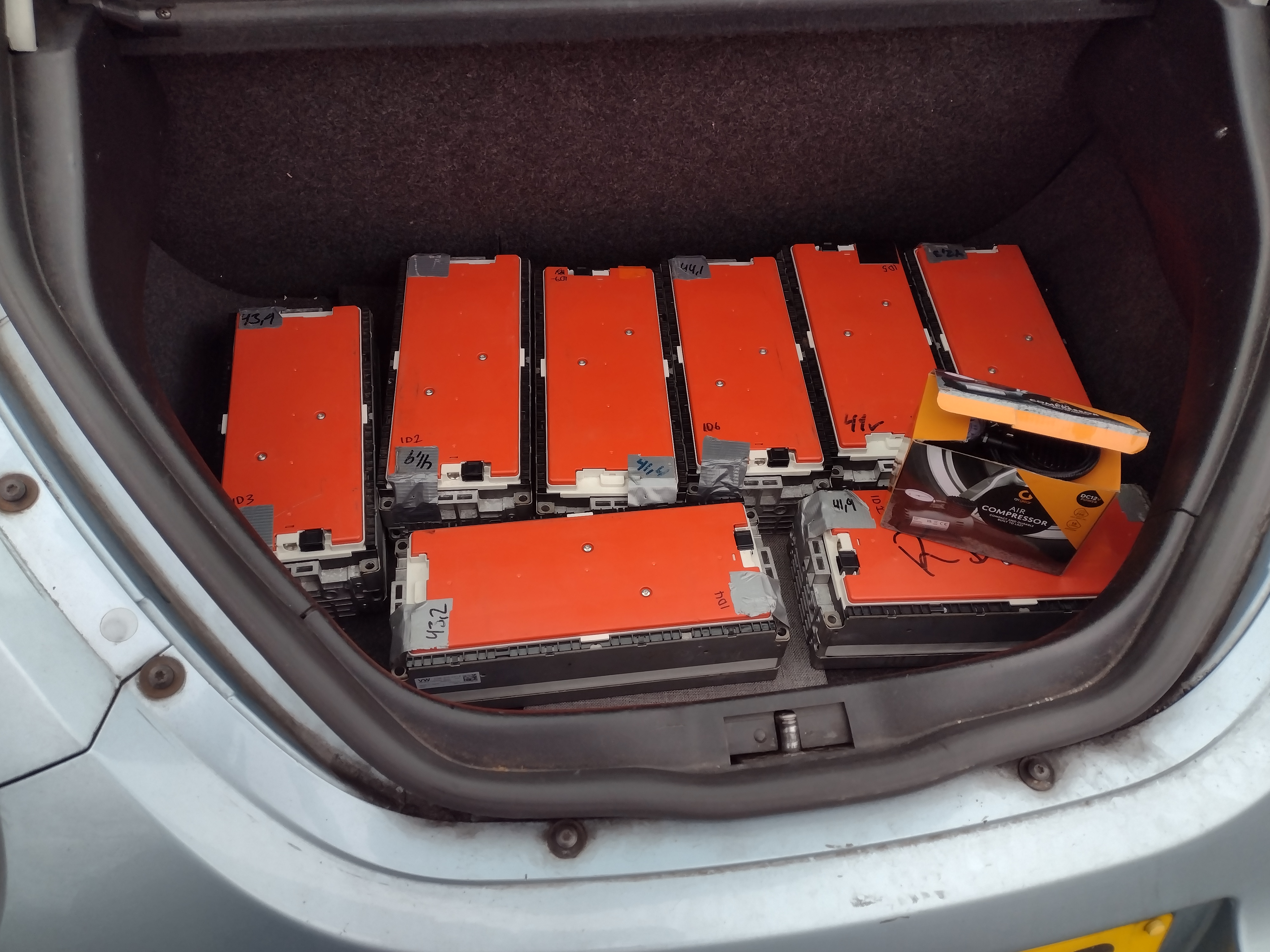

What a long day, set off at 7ish to go meet Dom for another battery back.
First rapid charge took some getting going, thankfully I was overcautious and stopped early, charged 40% to 90% and carried on my way. Next stop another 35 miles or so someone in an Etron had pulled up and there was only 1 unit. Decided to carry on to next a couple of junctions away, 2 instavolt units. 1 had a leaf not charging Infront and another free. As I was jumping on, an AA man appeared to say he was here for the leaf that was flat and wouldn't charge. I tried both units and sure enough no cigar. I was on 19% and Dom was still waiting 20 minutes away.
Thankfully he was kind enough to meet me there to do the deal, I now had another ~9kwh but I couldn't use it.
My aunt lives about 10 miles from this charger and there's no other rapids in range, Leicester is pretty poor for a major city.
I managed to get to her house, just, 2.8v min cell, proper empty.
4 hours on a granny, enough to get me to a BP outside of Loughborough when I got there it was occupied, so I pushed on to McDonald's instavolt. There was only one unit there, also occupied but I didn't have much left so waited and got a charge.
Not enough to get home, so headed back to the first instavolt of the day. Theres 2 at this site, the one I used earlier occupied and the second was free, awesome. I tried it a couple of times, was just about to get laptop out for some debugging and the fella next door moved, so I just swapped to that one and filled up. I got home just before 8pm.
Each time you use an instavolt they put a £30 preauth on the card, so by now I much have £300 of preauth transactions on my card that take a few days to go.
I did 178 miles, battery was under 30 degrees, just. It was a stressful day. The charging infrastructure is too patchy and unreliable especially with a tiny pack.
Forgot to mention, the leaf was a rental and the renter had just buggered off and left the AA man. While debugging, the station wasn't able to measure any voltage. It was just reporting 0 volts on both units. Someone did get the CCS going though.
