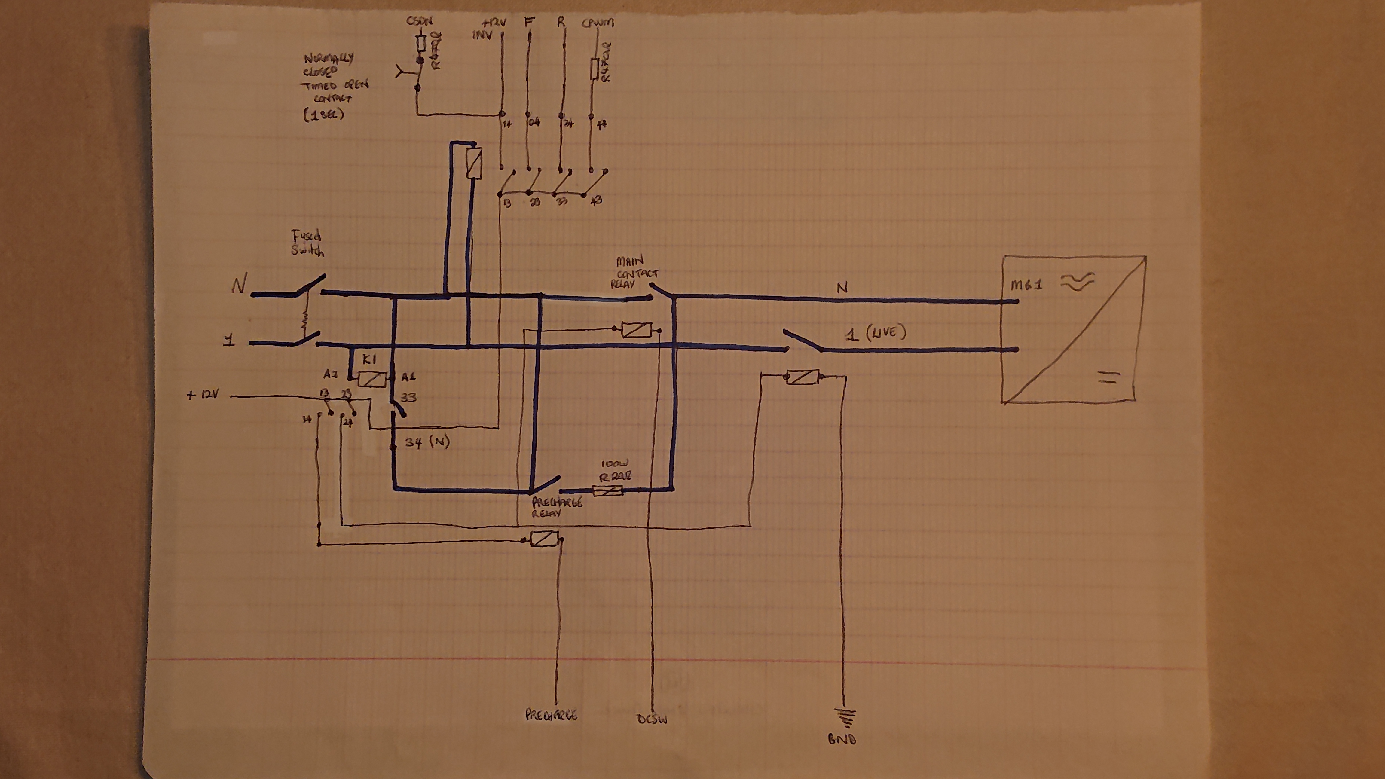

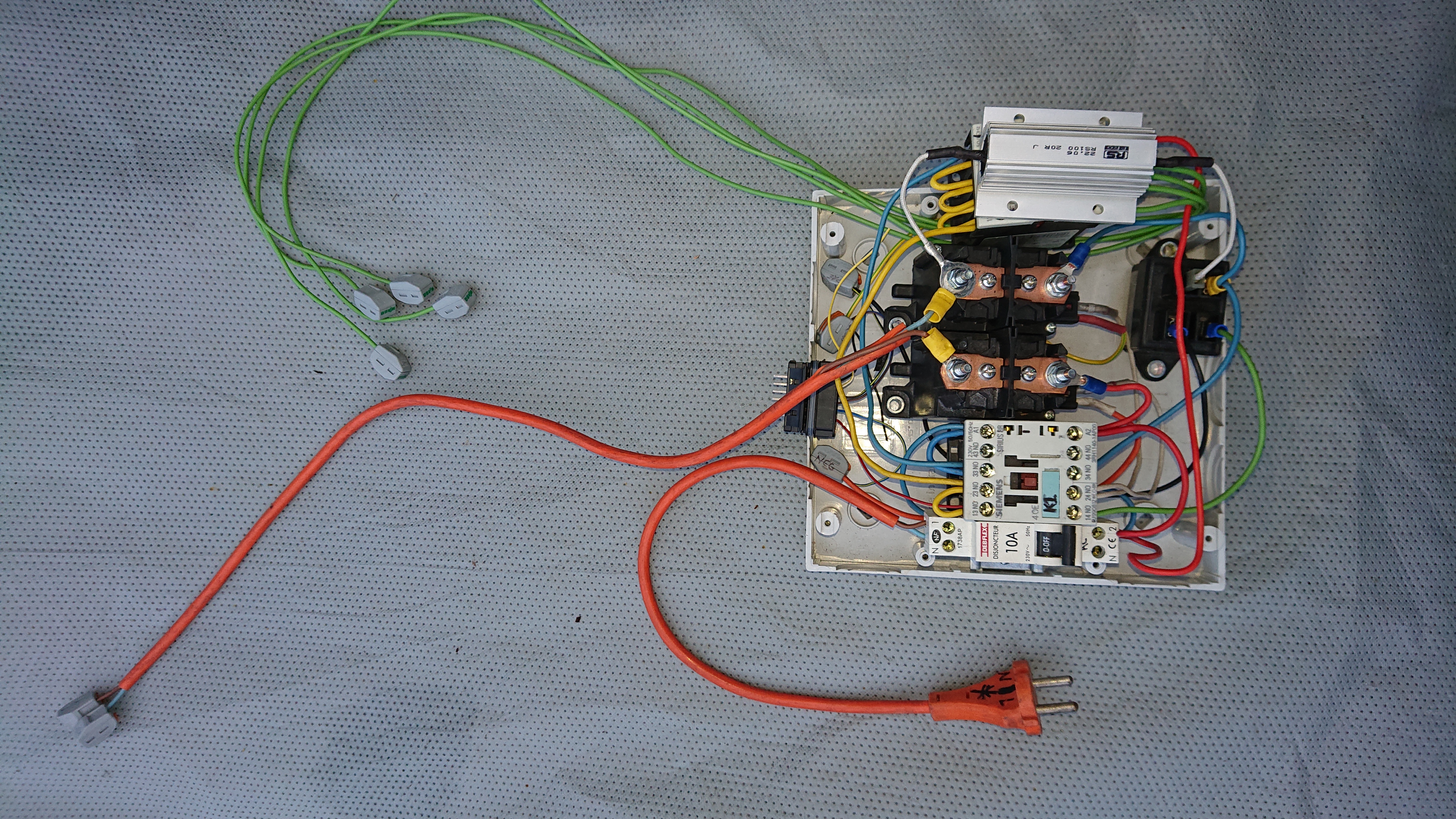

Well, progress slow my side. Trying to understand all parts of the process.
I managed to wire up the AC side in a relay box today. I used Prius HV Relays to switch Live and Neutral seperately.
I will connect the low side tomorrow to the Openinverter Board, with CSDN openning Two seconds after plugging in the AC Plug .
The Inverter will be set to Buck Mode (and be SAVED in settings) prior to connecting.
The HV DC connections will be connected as per the standard setup - NO Jumper wire bypassing the Buck Convertor.
I undertsatnd that as long as CSDN is HIGH (12v), the IGBT's are all OFF, therefore Precharge and Main Contact on AC and DC can be activated at the same time.
Been thanked: 1918 times
Re: Prius Gen2 Adapter Board for CHARGING
It may not be the best idea to "blindfold" the charger PI controller. It will try to create a current during those 2 s which it can't because the IGBT is disabled. By the time the IGBT is enabled the controller might have wound up too much. That said, with low chargeki you can make the controller pretty slow.

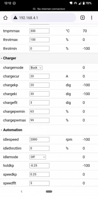

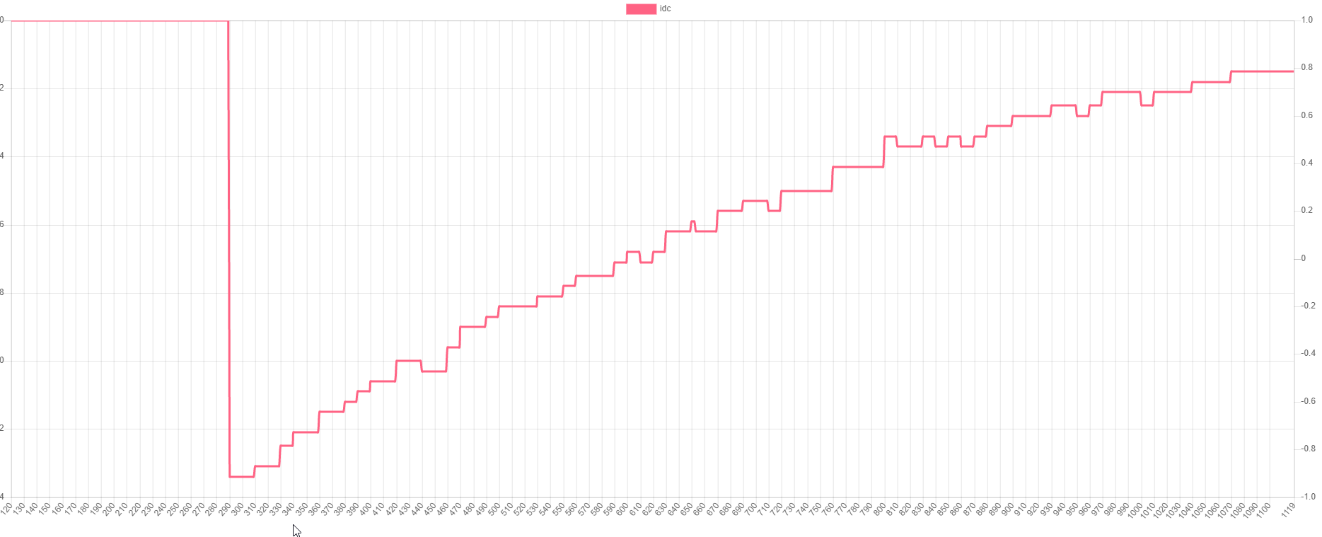

Finally setup the entire battery to attempt to charge. Had one scary moment on the first attempt when a busbar wasn't securely bolted on. A little but of sparking and I think I might have killed a BMS slave board. But all ok now.
When I hook it up to the heater element simulation battery it pulls a steady 3.5 amps and the voltage on the battery inputs sits at whatever pwmmin is.
However with the battery hooked up I am getting charge current into battery go up to around 3 amps to start, then slowly decrease and then invert and start pushing amps into the inverter. The HV Bus was increasing voltage and was at 400v when switched it off.
Not sure what is happening here. I have charge current set to 1.5 amps, kp at 40, ki at 10 and flt at 2 as per my settings before.
Edit: Tried one last time before I went home. This time it started at 3 amps then reduced charge current to 0.5amps and was stable.
If you mix up buck/boost chargemode it will regulate in the wrong direction, maybe that's what happens?

Can someone explain why the precharge resistor should stay in series during charging please?
RetroZero
Posts: 947
Location: France
Has thanked: 645 times
Been thanked: 64 times
Post by RetroZero »
johu wrote: Thu Mar 31, 2022 3:41 pm It may not be the best idea to "blindfold" the charger PI controller. It will try to create a current during those 2 s which it can't because the IGBT is disabled. By the time the IGBT is enabled the controller might have wound up too much. That said, with low chargeki you can make the controller pretty slow.
I decided to pull CSDN to GND with DCSW signal. Will update my schema.
Do we still require Precharge resistor in AC Circuit to remain ON during CHARGING?
RetroZero wrote: Fri Apr 01, 2022 2:36 pm Do we still require Precharge resistor in AC Circuit to remain ON during CHARGING?
No, who said that? It can be on if that makes it easier but it's certainly not required.

It works! I think the current sensor on the inverter needs to be calibrated a little.
I started to just up the charge current and it had some effect on current going into the battery. Started to adjust the other parameters which also helped.
Settled on this, which was pushing in 4.5 amps.

The odd thing now is that I can't get anymore than about 4.5 amps. The charge current setting on the inverter VCU has no effect beyond 15 amps.
Increasing chargekp beyond 20 lowers the amps I get into the battery which seems odd.
Whats the max amps you have managed to get into your batteries?
Maybe hitting udcmax? Or, less likely, tmphsmax

So finally wired up Relay Setup as per my scetch.
Updated software as per Johu's update in previous post.
Chargemode is already in BOOST.
No AC or HV-DC connected.
Simulated AC connection, which pulls CPWM and CSDN HIGH (+12v) via 470 OHM resistors on each line, F and R to +12V.
Set time delay switch to Pull CSDN floating after 0.5s.
Inverter (Opmode) remains in OFF Mode

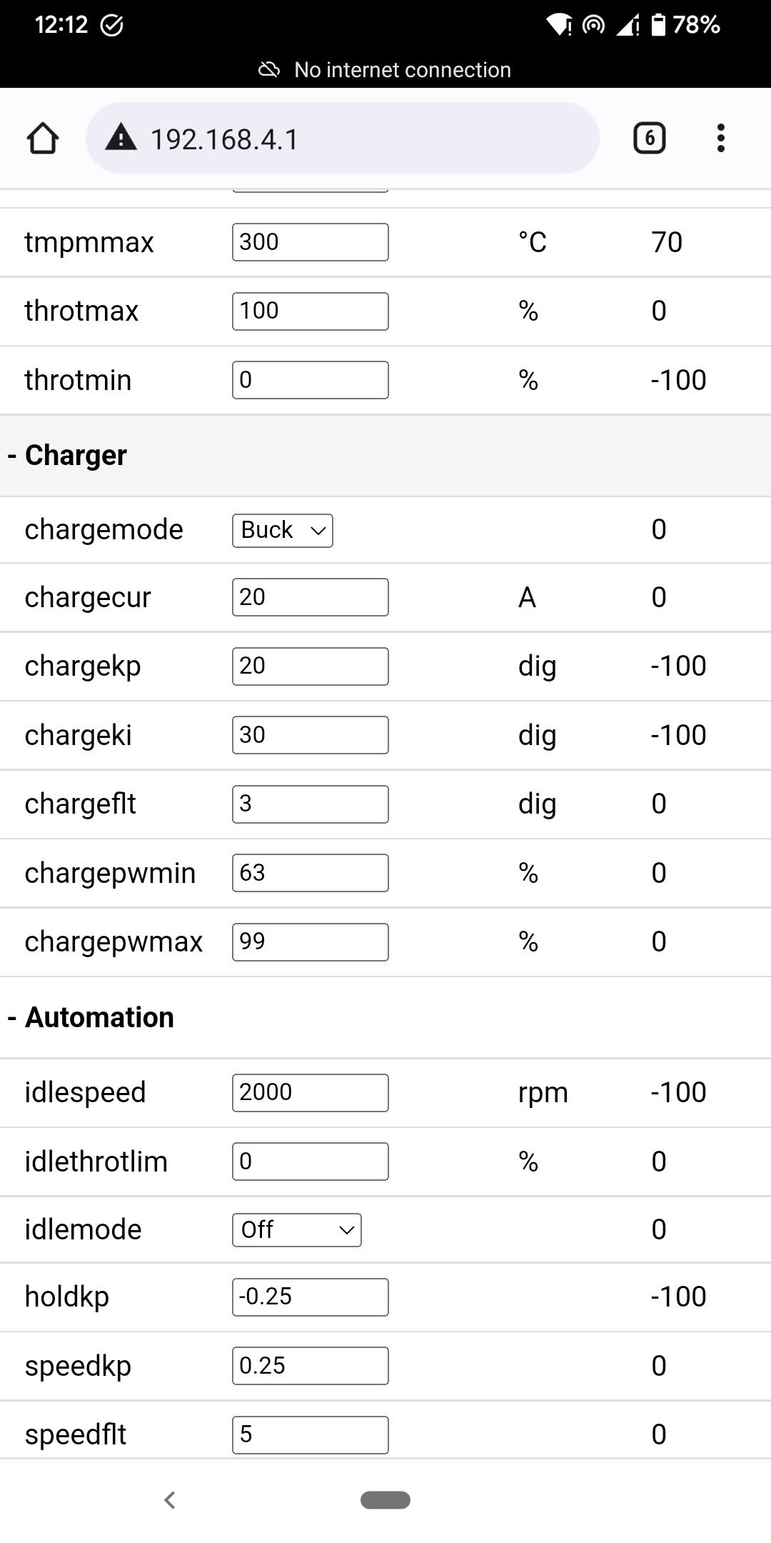

Dropped the pack down to 60s. Had to change the settings a little again. Found that chargeflt had the most affect this time. Managed to charge at around 8 amps this time, if increased chargeflt anymore the EVSE errored out.
chrager 8 mp settings.png (11.37 KiB) Viewed 5557 times
I'm planning to keep the pack at 60s for now since it makes battery install easier.
Next step is to add the additional contactor so I can split the battery positive to the inverter. The charge contactor to battery inputs will be activated by the same signal as the AC contactor, then my main contactor will connect to the HV bus and run as normal.
