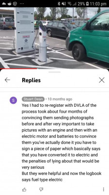

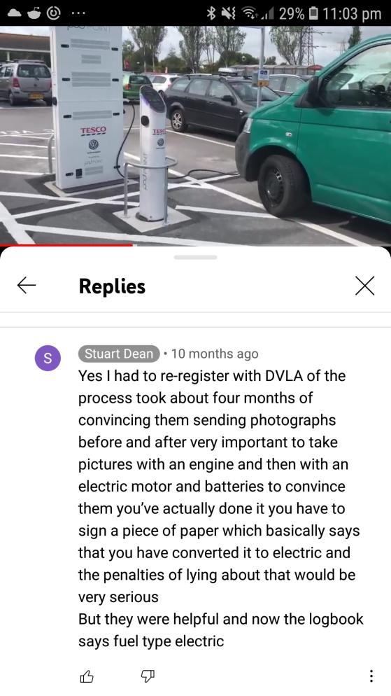

@ev8 Would you mind if I tweeted this picture (with your details blanked out?) I think the best way to make this process easier is to highlight it in public as much as possible. I'd recommend everyone who has even the smallest social media presence to highlight this.
Interestingly, the "fuel type" on your MOT history says 'electric'. Funny how it can be changed in some places but not others..
Sorry if that's overstepping your privacy, but i was interested to see what it would say.
Yes no problem

Yes, @zippy500, so basically what DVLA are saying is "Thank you for letting us know that the car is now fully electric, we have made a note of that but unfortunately, we can't change the taxation class (of post 2001 vehicles I assume). So you will have to continue paying road tax at the same band as it previously was.

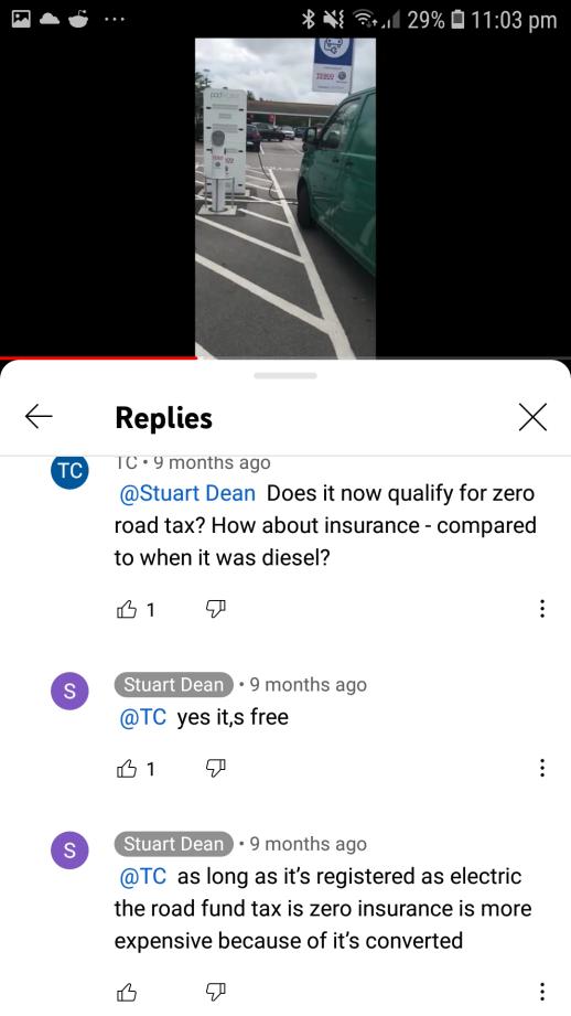

As a double whammy .... You are required to tell the DVLA of changes to your car so you have to get letter from garage to show that the motor has been changed!

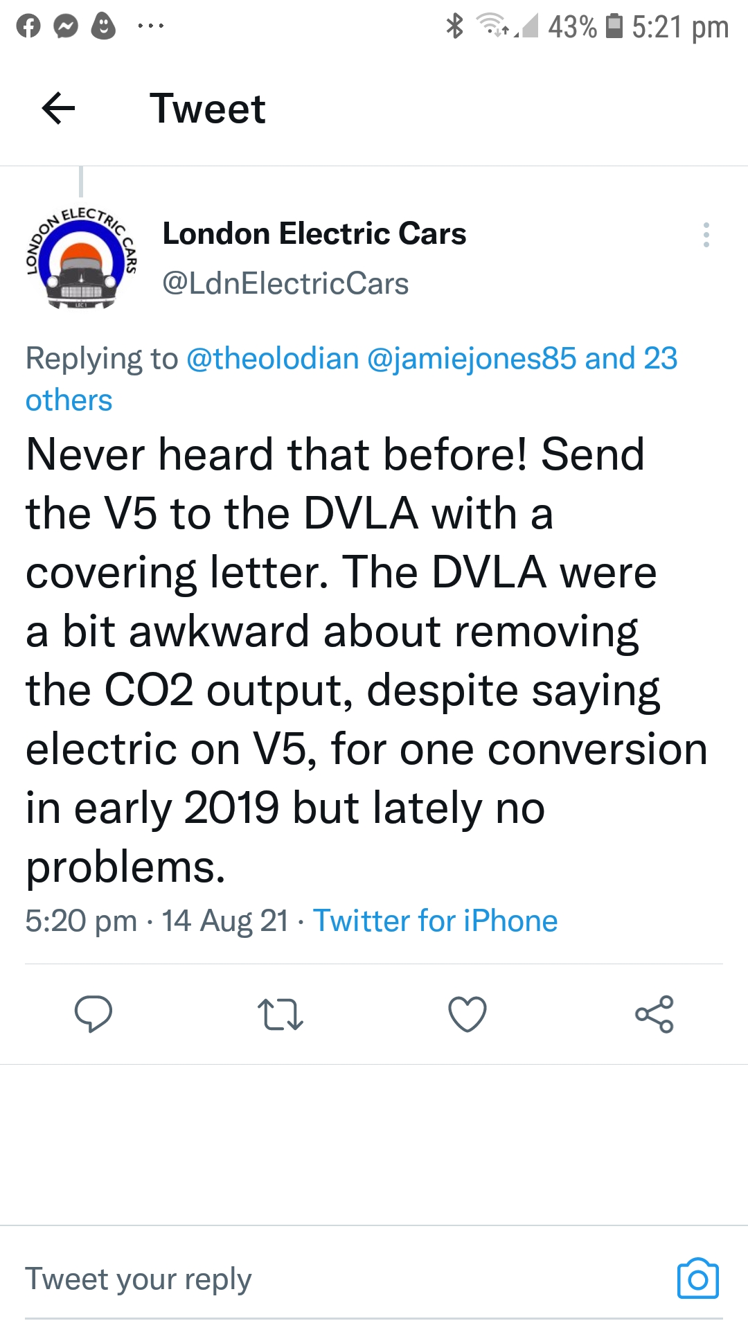

Seen this in Twitter that might be interesting

Domt177 wrote: Sat Aug 14, 2021 9:11 pm I imagine it's a lot easier to convince the DVLA when your a firm doing many conversions a month vs a random 17yr old converting the car in your dads garage.. hope I'm wrong.
This would of course be terribly wrong. The law on this matter does not distinguish between the professions of those applying to have the Taxation Class changed. DVLA should accept a car as converted to Electric, even one aged between 2001 and 2017. Legally, it is NOT dependent on who is applying for the re-classification.
As far as I am concerned and also legal advice I obtained, the main provisions of the relevant regulation need to be adhered to without needing to read into any sub Schedule(s) and the main provisions explicitly state that an Electrically propelled vehicle is exempt. There are NO exceptions to that. Age of vehicle and/or current classification is NOT a consideration at this top level of the regs. DVLA insist on interpreting this incorrectly, at least they did during the extended discussions I had with them specifically on this topic.
So I would be very interested to know if London Electric Cars have had DVLA accept a 2001-2017 car as converted to Electric and had its Taxation Class changed to that (hence exempt from VED) as by the end of our discussion, they were very clear that cars of that age would NOT be allowed to have their Taxation Class changed. So if they are indeed allowing this, that would be of great interest to me.

Same, I've asked them exactly that.

I met Chris from Zero EV the other week and mentioned having to still pay car tax on my conversion due to it being newer. He said that the Boxster they did is 04 and pays £0 car tax. Plate number is PX04 FMZ.
He recommended that you put in the forms for tax change and engine change at the same time, put it down as 0cc capacity and also give them the new engine numbers. Basically just throw as much information at them as possible so they don't have any room to maneuver. I think it might help coming from a business as well. London Electric Cars don't seem to have any issues either.
