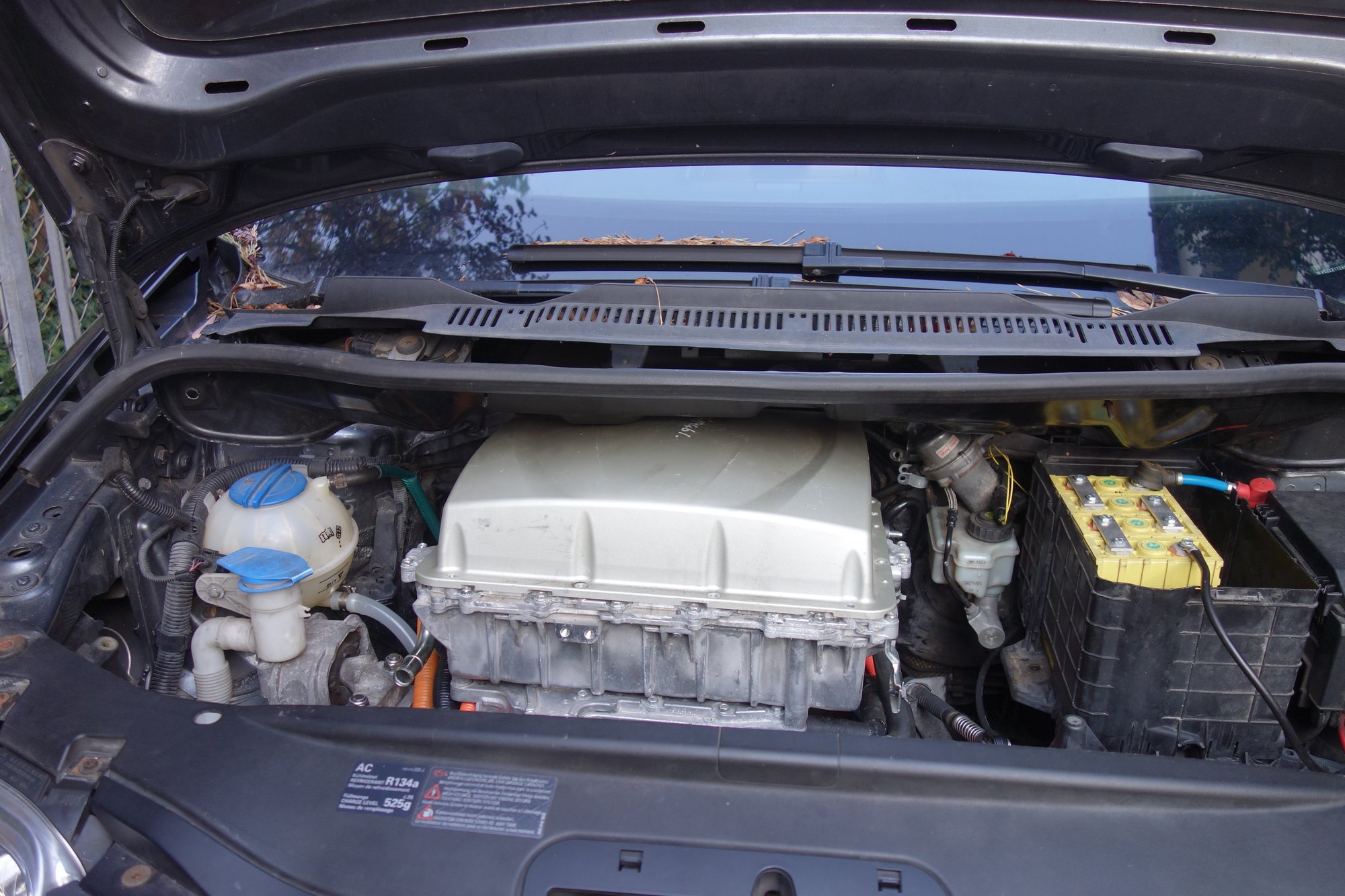

So today I was gonna fit the Nissan charger on top of the inverter. Not that I'm very keen on actually using it but it makes a nice, sealed DC junction box and Nissans main battery and ChaDeMo cable would fit in seamlessly. Certainly a plus for passing the road worthiness test. Also the DC/DC converter would have come in handy.
But: it doesn't fit! How can you make a stupid 3kW charger THAT BIG?
I removed the firewall cover to fit the charger but of course then the firewall cover doesn't go back on.
So I took it off again and wired the battery cable directly to the inverter. Will have to cover that with a box. Also need to think of some switch gear for the ChaDeMo port now.
On the plus side I don't have to go down the rabbit hole of reverse engineering the charger and DC/DC.

You have to be careful with this cover. It is intended to steer drain water out from under the hood. In case you would cut it somehow you can change the flow of drain water and have a flood in the wiring...
- Been thanked: 1918 times
Yes I thought so too. Thus the decision has been made for me (by the cover): I will not use Nissans bigass charger.
- Posts: 3796
- Has thanked: 166 times
- Been thanked: 413 times
Could you make a sheet metal case for the charger that would be smaller? You could still use it then...
I probably could, but the main reason for trying to use it was TÜV. It looks good, the cables are well routed etc. So it was more about the case, less about what is inside.

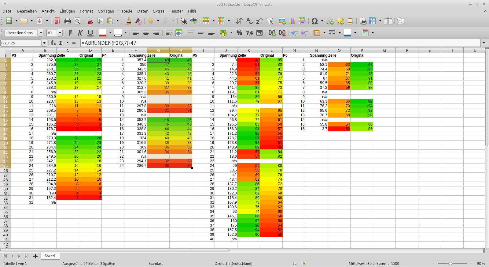

Measured the cell taps today by attaching the multimeter to B- and equip the other test lead with a cut off resistor leg that fits into the plug.
So it looks better than initially thought. The front brick has the cell taps arranged exactly like the leaf, only it is mid-pack to B+ instead of B- to midpack. But if I understand correctly the two halfs are galvanically isolated and can be swapped either way.
The other plug needs rearranging as it used to be connected to the left and right half in a convoluted arrangement. Yes it will be sort of painful to remove 49 crimp leads from the plug while under the car but I think it's worth it. Any hints on how the crimp parts can be pulled from the plug?
- Kevin Sharpe
- Posts: 1339
- Location: Ireland and US
- Been thanked: 10 times
Think we had some posts on DIY electric regarding that... look up Wolf's posts and my Leaf battery work... sorry, can't remember the details now
- Tremelune
- Posts: 74
- Joined: Mon Jun 10, 2019 6:07 pm
- Location: Los Angeles
- Has thanked: 2 times
- Been thanked: 13 times
I believe a safety pin achieved success for Wolf...
https://www.diyelectriccar.com/forums/s ... 81297.html
I don't think they ever figured out the connector type. I don't see great value in keeping them in lieu of a more common/standard connector...
Thanks guys, that was the thread I was looking for. Tried the technique and it works well.

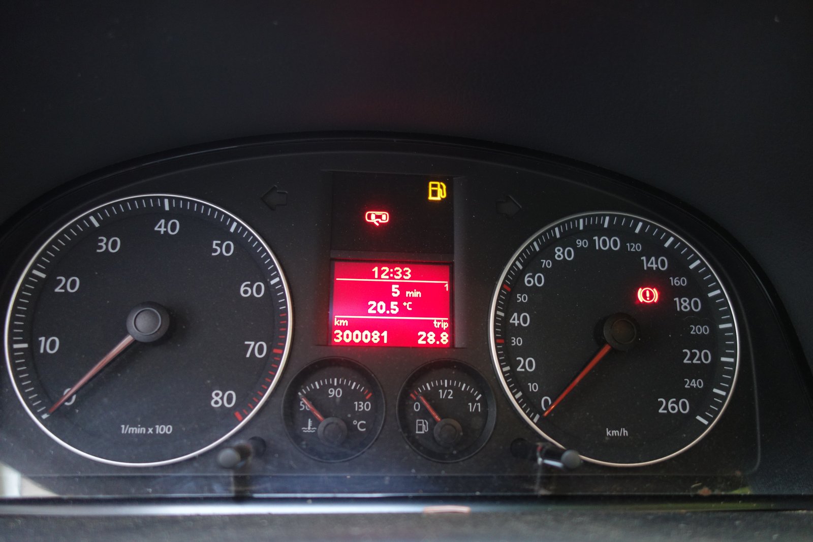

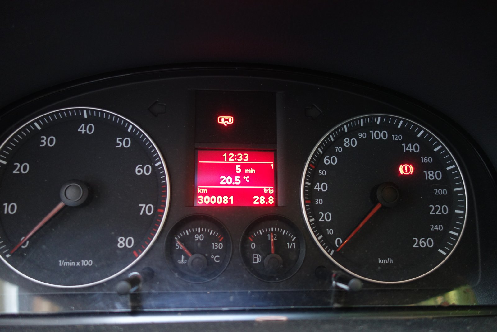

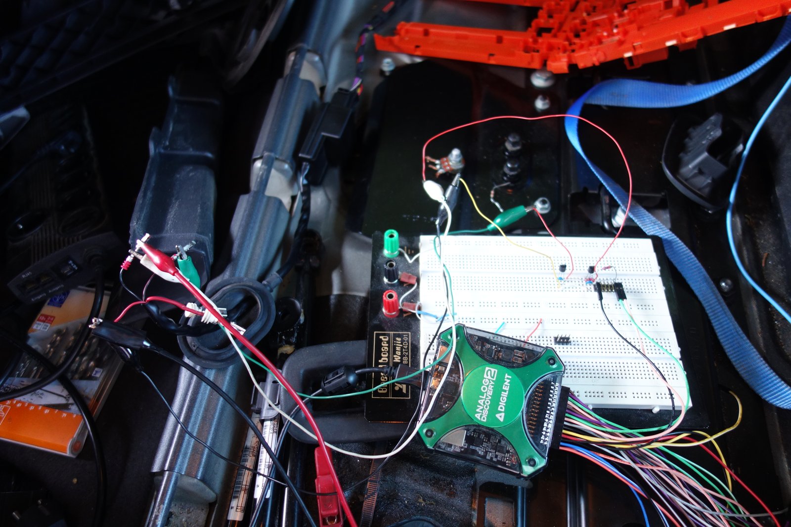

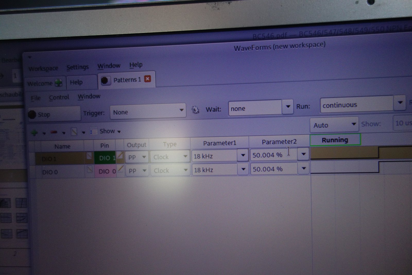

Rigged up my planned "pot simulator" in Touran today and it works nicely. What it is is Two BC547 transistors with emitters grounded and base connected to an 18kHz PWM signal via a 100k/1µ low pass filter.
So at 50/50 duty cycle you can see the fuel gauge is exactly at half-full. At 35/65 you fill get a low fuel warning and at 70/30 a full tank of gas, half a pack of cigarettes and you are wearing sun glasses.
I found that the wiper of the original fuel tank sensor is just grounded and the two pot taps probably get some constant current injected. So that makes it easy to simulate a pot without one of those digital pot simulators.

Do you have an idea how to simulate Tacho reluctance sensor. I need sine signal when each line carries its own part of sine signal. It seems BSM and BSI needs one to see motor is alive, but it needs both sides to show RPM
Can anyone propose schematic on how to simulate this kind of signal?
- VR_signal.png (3.06 KiB) Viewed 15705 times
@Arber: maybe you need +-5V, connect emitter to -5V connect base to DC-decoupled PWM + low pass filter.

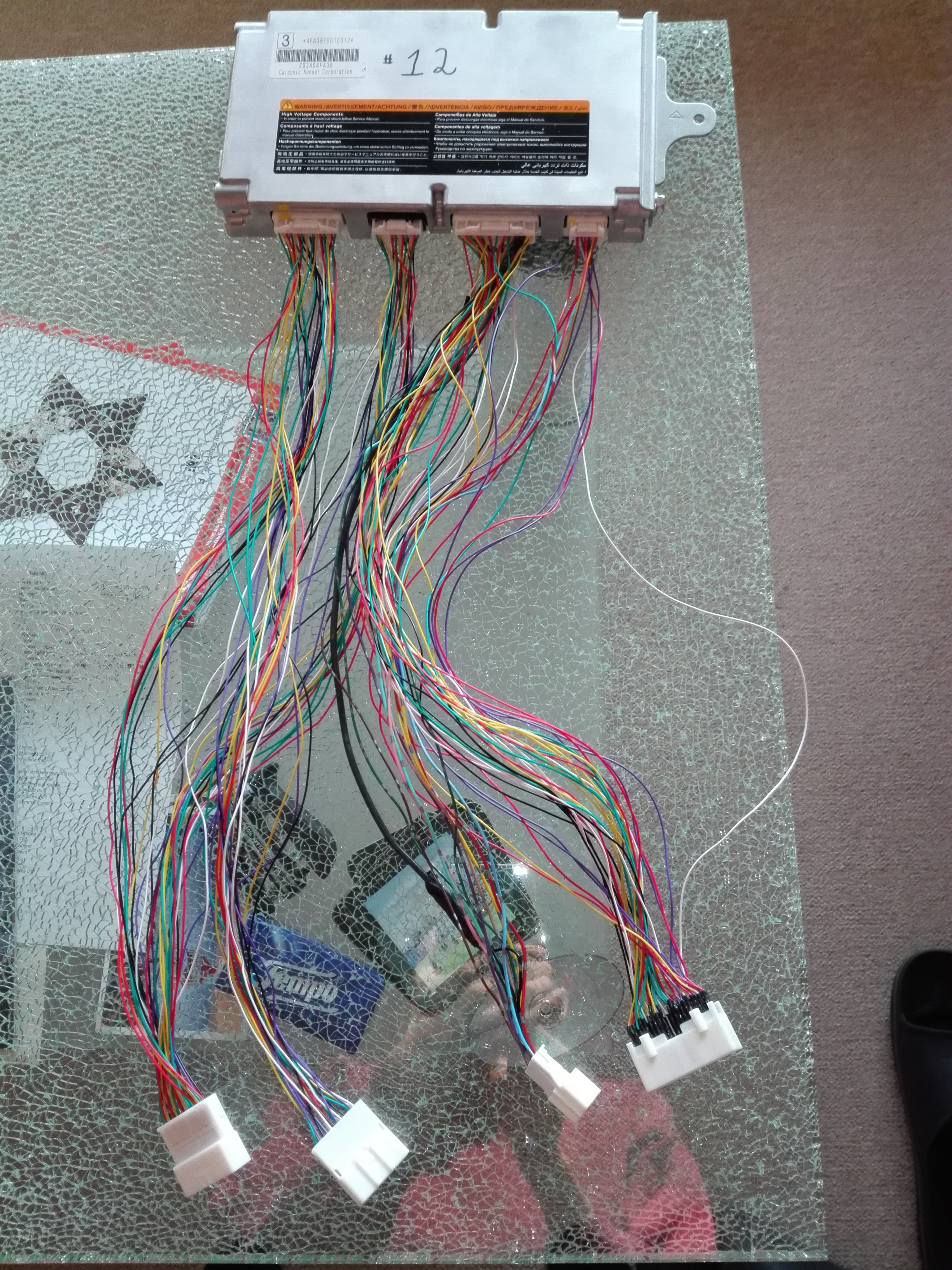

Thanks for that.Meanwhile a gentleman from UK offered to send me his left over BMS for free - In community we trust

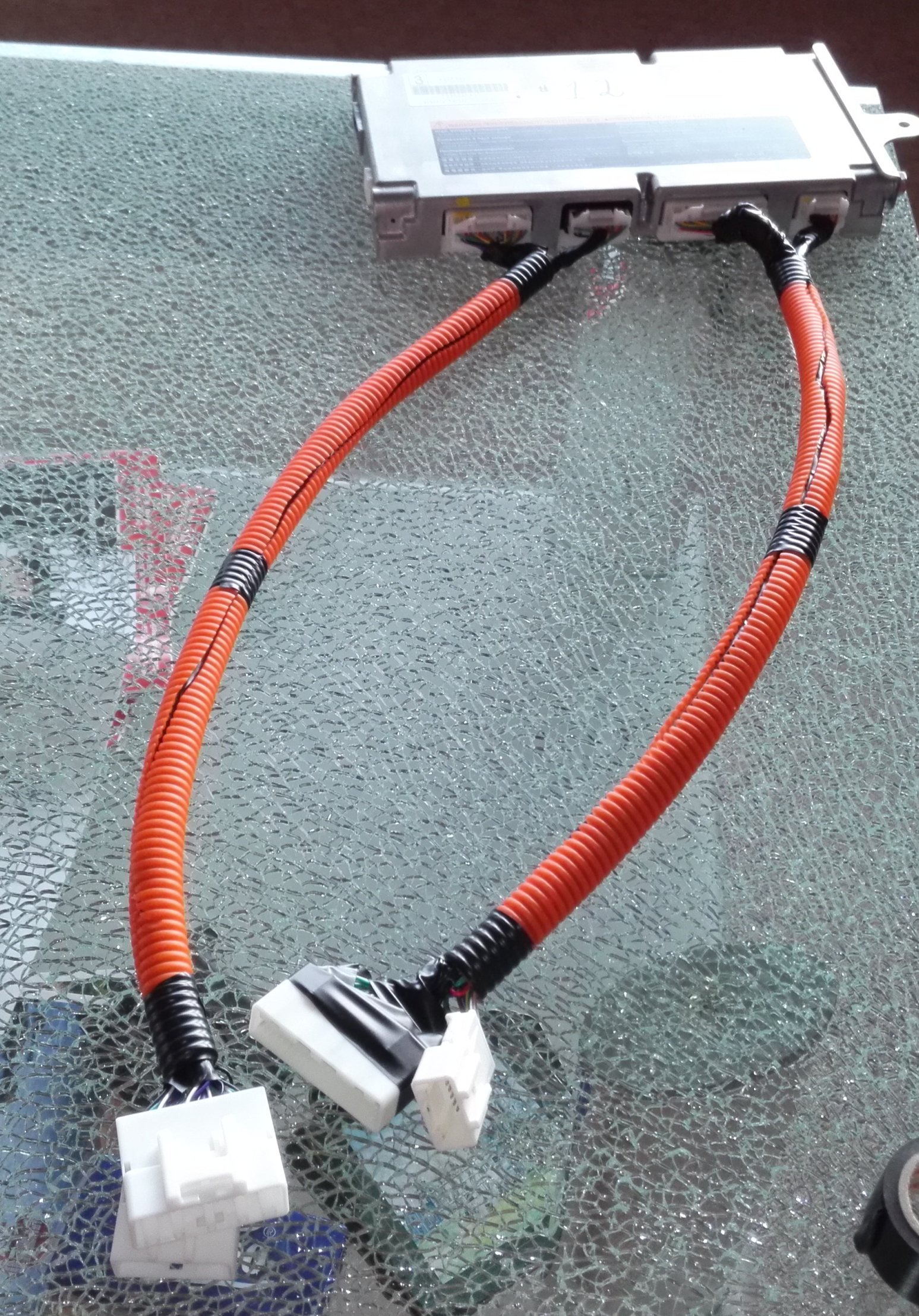

Took reception of the counterparts today. This will allow me to extend the cables a bit and undo the wrong pin mapping. Will test with the partly-fried BMS first then connect the new one.
EDIT: mini BOM:
16-pole male 1473796-1
16-pole female 1318386-1
24-pole male 1473413-1 1473799-1

The 40-pole male isn't actually a crimp part. For some reason thats not available for 40 poles, even if you look directly at TE.

Adapter done. Will connect it to the battery and verify once more that the voltages are now in order before doing any more damage.
It seems the male pins are different for different housings. They all fit except the 24-pin housing. It also fits with some force though
EDIT: I stole the populated 16-pin connector from the LV BMS harness as I don't have anything connecting to it. Anyone knows what it is?
