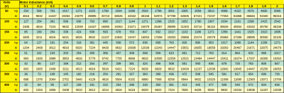

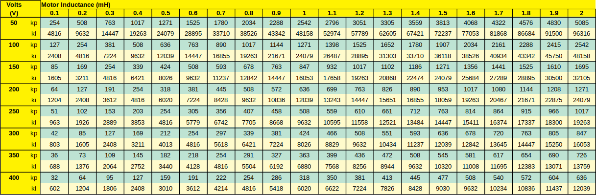

Been thinking about how to setup the controller gains when first setting up a new motor and have come up with this:
The idea is that you use the inductance value that the phase check test gives and the voltage you are running at to look up the values to use for kp and ki. For example in Bigpie's case of 0.2mH and 44V above you would set kp to around 508 and ki to around 9632 for the initial spin tests (and then drop down to 73 and 1376 when running at normal 96s pack voltage).
These are not intended to be final values, just a way of getting something sensible in there for initial tests. Might also be worth starting a bit lower initially, say half the value, until confidence is built up (to reduces the chance of control loop oscillation from setting them too high).
The values in there are just based on parameters published for the Outlander front generator, rx450h and mgr. Including others would probably improve accuracy but the values for these seemed to fit well with theory and I could find them and so will do for now!
The spreadsheet used to generate is attached if anyone wants to have a look at it or add more data.
StartingGains.ods- (21.29 KiB) Downloaded 190 times

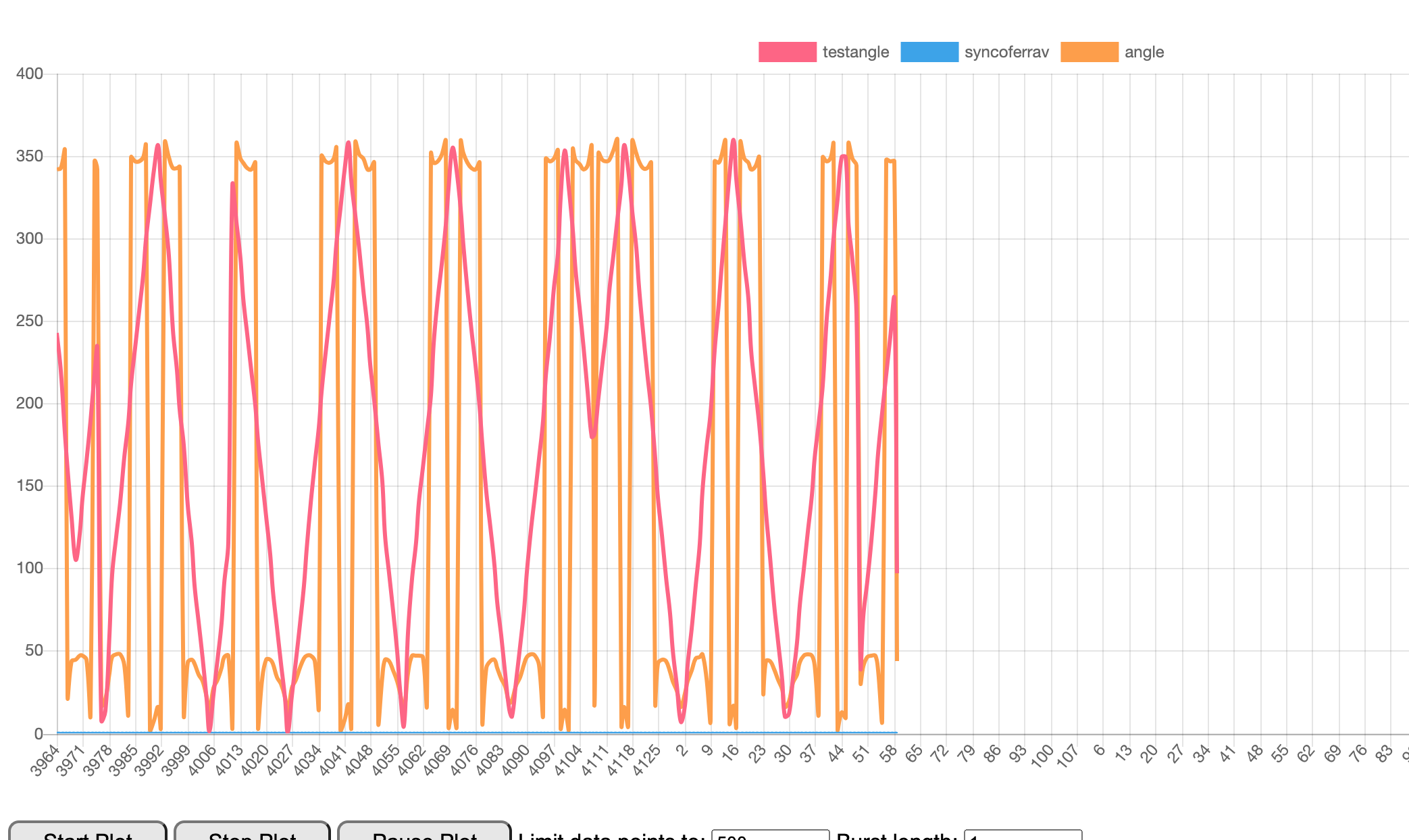

Just posting latest findings. I don't seem to get getting an average error. Maybe I misread last night?
This is Bi Directional the the ki kp increased by a factor of 8
Running in forward mode but with no manual id, looks to give decent resolver feedback.

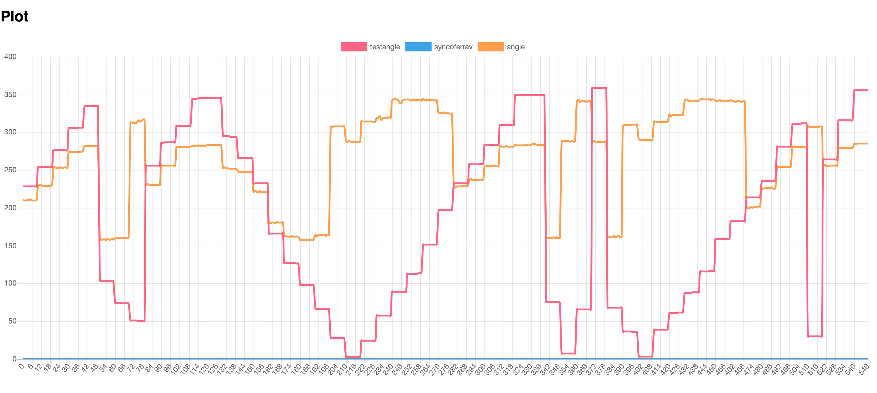

It still doesn't seem to be following the field correctly
What does it do on a forward spin now? (until that spins reliably there's not much point in trying to find syncofs)
Have you checked the phase resistances, is it possible that there is a problem with the motor?
Edit - not sure why the average error would have disappeared
Edit2 - Assume the missing bits in testangle in the first pic are due to wifi dropouts?

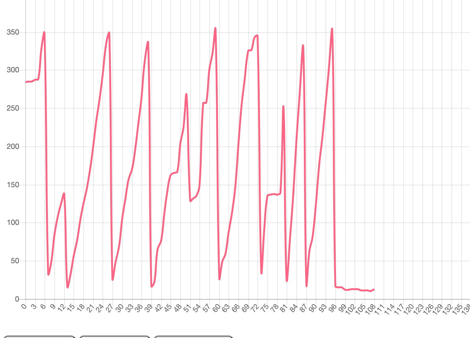

Forward seems to work with more id current
I gave it more id current.

Something just doesn't look right there, it's never going to be perfectly smooth but it should be a lot better than that (it appears to be going in the wrong direction sometimes!). It's almost like it's missing a phase (or half a phase maybe, just 1 IGBT)?
Is it worth checking the winding resistance of each phase on that motor? Do you have any way of checking that the PWM looks right on all three phases?
Other option is to log angle, pwm1, pwm2, pwm3, il1 and il2, stick it though a spreadsheet to calculate il3 and see what the current waveforms look like (I'm happy to do the spreadsheet bit if you post the log)?

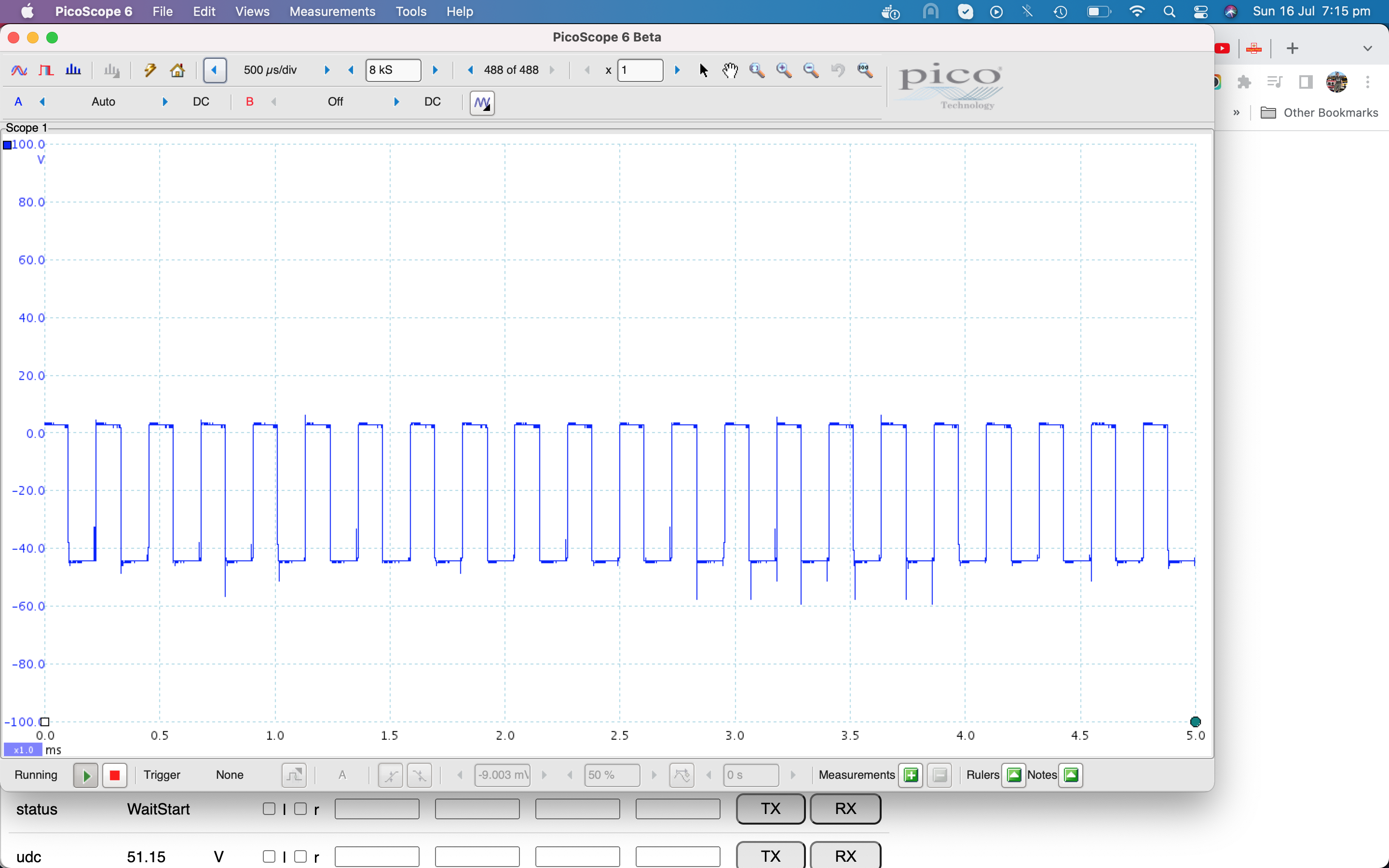

Re: IPM Motor - Auto-setup

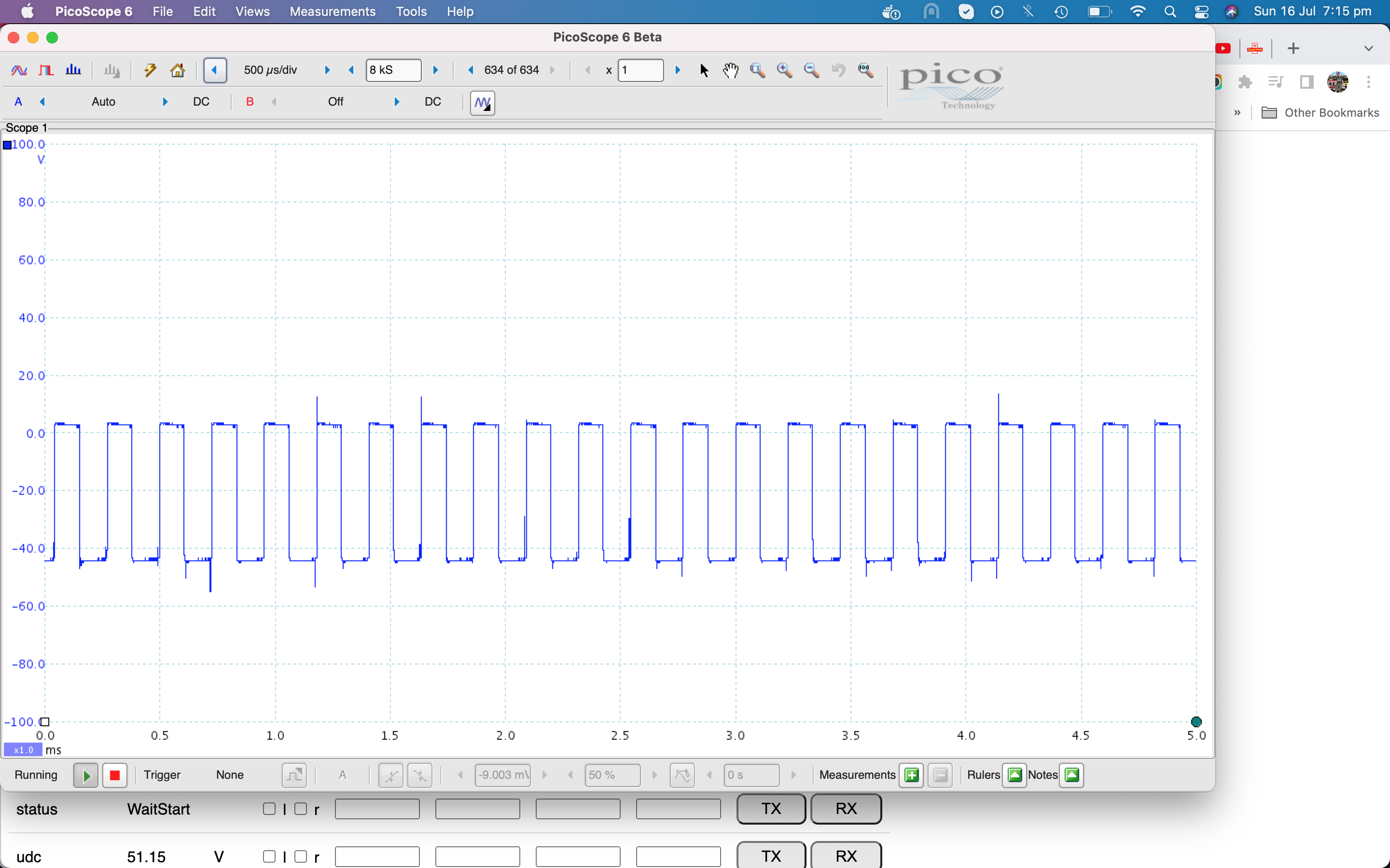

Only had 1 probe to hand tonight. Each output phase with respect to HV gnd. This is fwd dir and 35 amps id
All looks good.
Can't fault those waveforms (why are they negative though if measured relative to HV gnd?), all the IGBT's appear to be working fine.
I clipped the ground to the phases and poke the probe to the negative:D I think it span smoothly with sine and also old manual mode

There is definitely something not right there. On the bidir plot you posted the motor is just oscillating between around -10 and +50degrees rather than doing a full rotation and in the video it's so uneven in places that is shakes the whole motor! I've had another look through the code but can't see anything and what should be equivalent code works fine here.
If you could do the log mentioned above I'll have a look at it but apart from that I'm out of ideas
