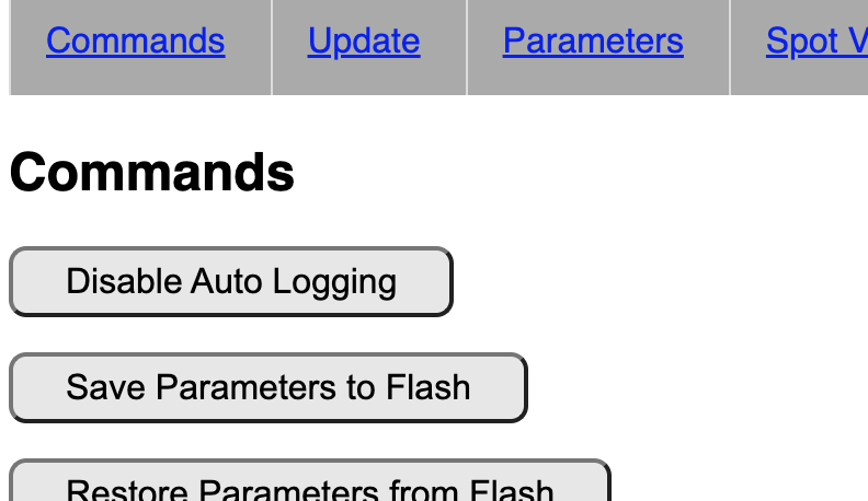

I've added a button to disable/enable auto logging and it's stored to EEPROM.
