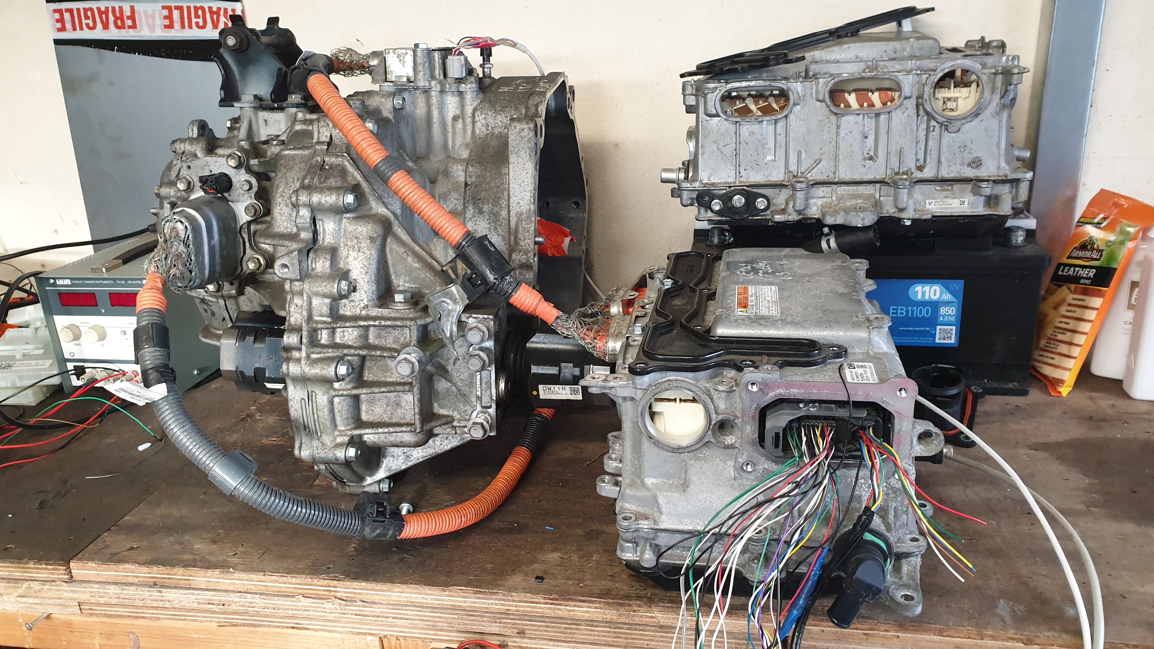

Thanks Matt I think we're back in business:) Got a little time today to start wiring up a test bench for gen3 prius inverter and transaxle. Going to see if we can make the gen3 system work like the gs450h for front wheel drive projects. And by we I mean Dilbert will do the hard work and then I'll take the credit and retire to Lanzarote a year earlier than planned:)

Dilbert
Posts: 410
Location: Dublin, Ireland
Post by Dilbert »
I had a look this afternoon, I captured quite a bit of data last January from the vehicle.
I guess the question is do we make the GS450H module more generic and add the required support for the Gen3 inverter or copy what's been done for the Lexus one and create a new Gen3 module that would be most similar, apart from the remapping of the data.
HTM Data -> 100 bytes
MTH Data <- 120 bytes
MG2 Torque Bytes 26-27
MG1 Torque Bytes 76-77
I need to look at how the battery capacity is signaled to this inverter.

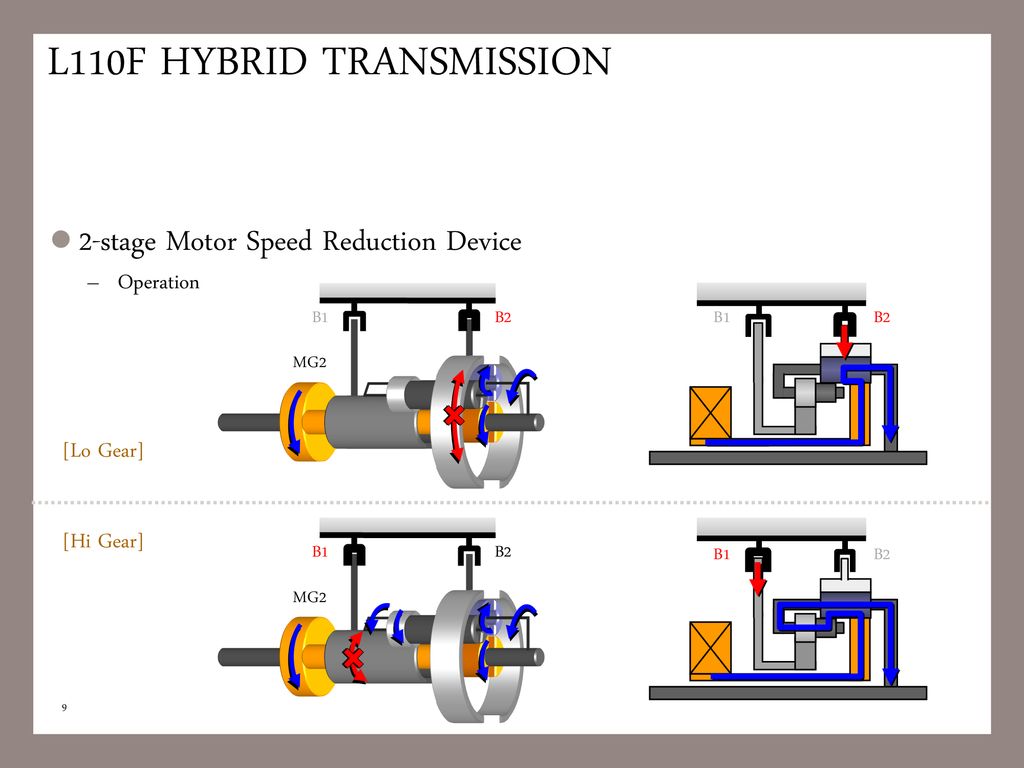

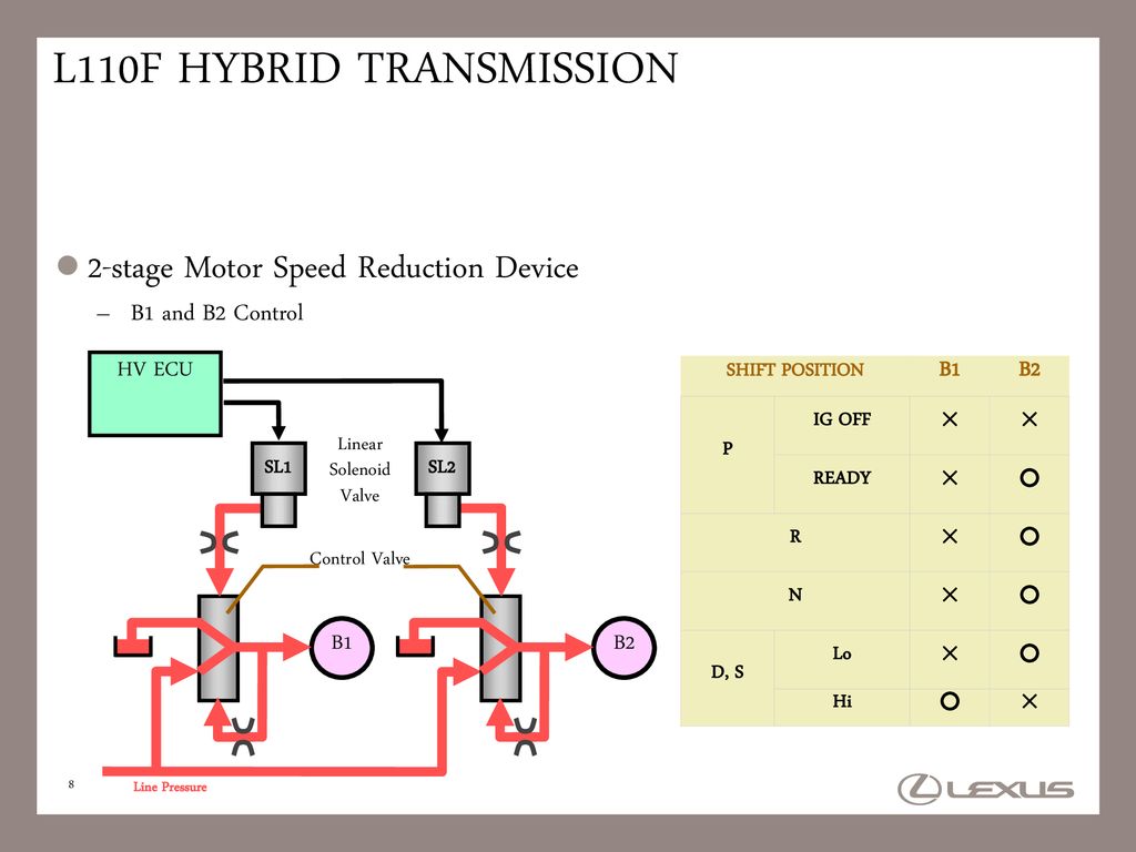

I think I botched things up with the gear selection.
Assuming I read this right:
viewtopic.php?f=14&t=396&start=350#p21589
The resulting code should be closer to this?
        if (Lexus_Gear == 1)
            DigIo::SP_out.Clear();
            DigIo::SL1_out.Clear(); // Diagram implies this should be Set?
            DigIo::SL2_out.Clear();
            Param::SetInt(Param::GearFB,HIGH_Gear);// set high gear
        if (Lexus_Gear == 0)
            DigIo::SL2_out.Set(); // This is currently Clear after the 200ms branch merge
            Param::SetInt(Param::GearFB,LOW_Gear);// set low gear
So do we want it defaulting it to high at the moment (both cases having everything turned off), or did I botch it up?
-Matt

From what I understand Lo Gear requires Brake 2 (B2) to be active ie. applying clamping force, and B1 open
And Hi Gear requires B1 active and B2 open.
Looking at the state diagram it appears O represents "active" and X represents "open".
What's not obvious is whether the solenoids controlling the brakes need to be energised or de-energised to activate the brakes.
The slides were part of a Lexus presentation in Europe which can be viewed here - https://slideplayer.com/slide/14432904/
slow67
Posts: 151
Location: Texas
Post by slow67 »
In the side, “O” is energized and “X” is not energized
mdrobnak
Posts: 692
Post by mdrobnak »
slow67 wrote: Wed Jan 13, 2021 10:02 pm In the side, “O” is energized and “X” is not energized
Oops, then it's all high gear all the time at the moment. But given we're not PWMing control of the line pressure, maybe this is for the best at the moment?
slow67
Posts: 151
Location: Texas
Post by slow67 »
mdrobnak wrote: Wed Jan 13, 2021 10:47 pm
With PWMing the electric oil pump, you should be able to leave the pressure control solenoid maxed out.
