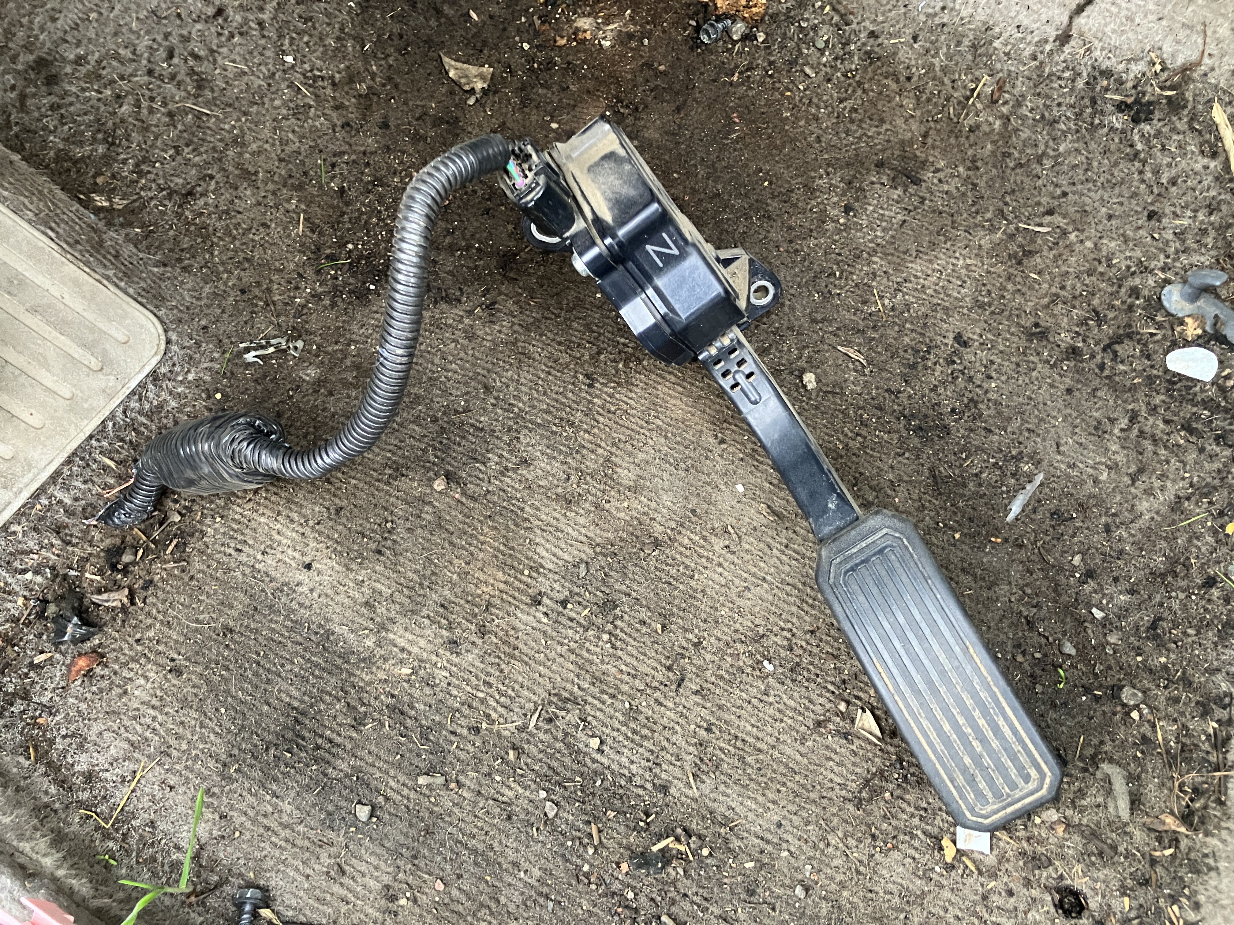

first up was the 3rd Gen Prius 2011 pedal
those of you following the VW Rabbit conversion may recall we had to trim this Prius pedal to keep it from bottoming out

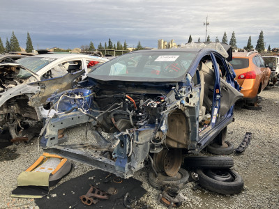

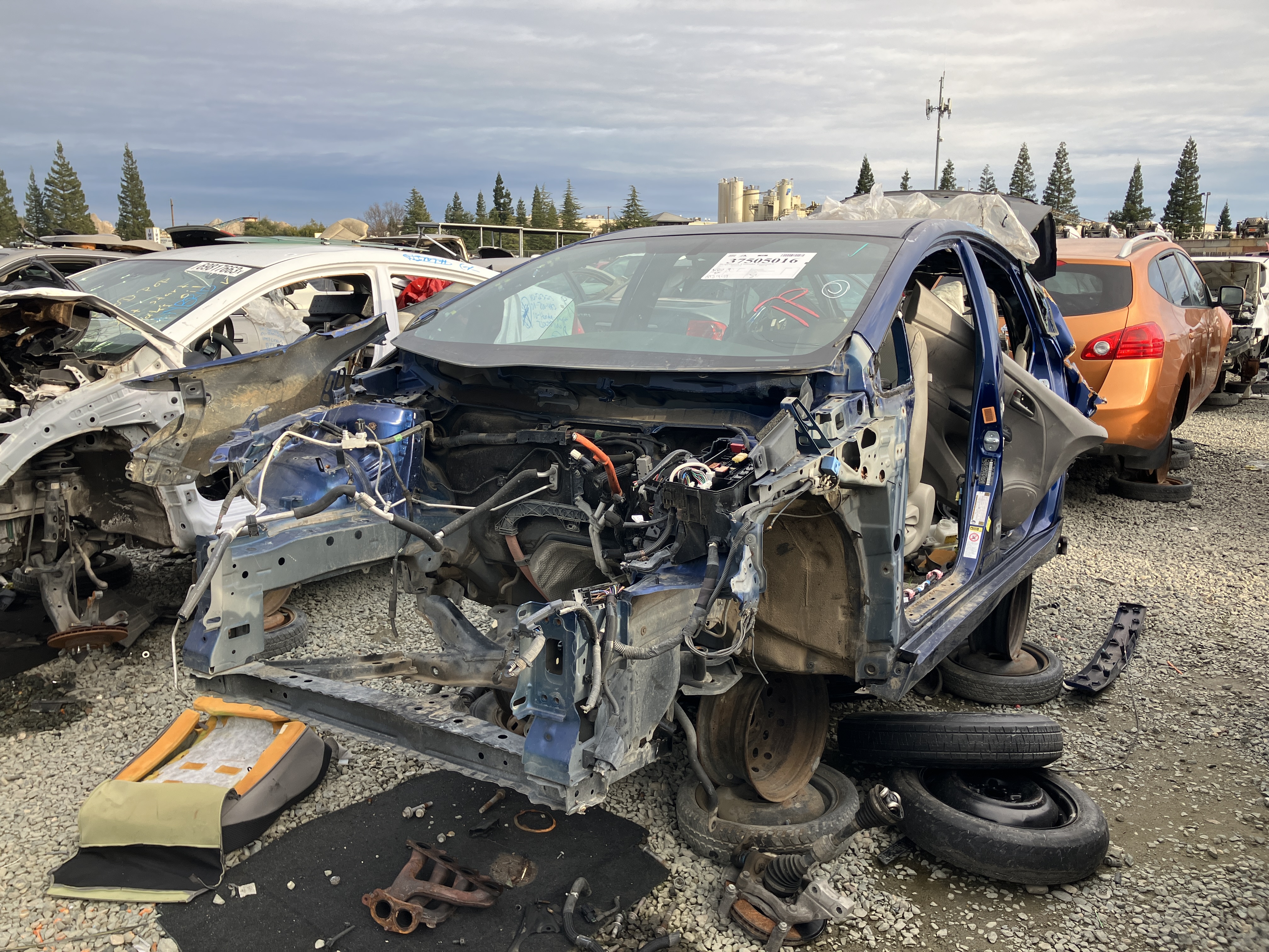

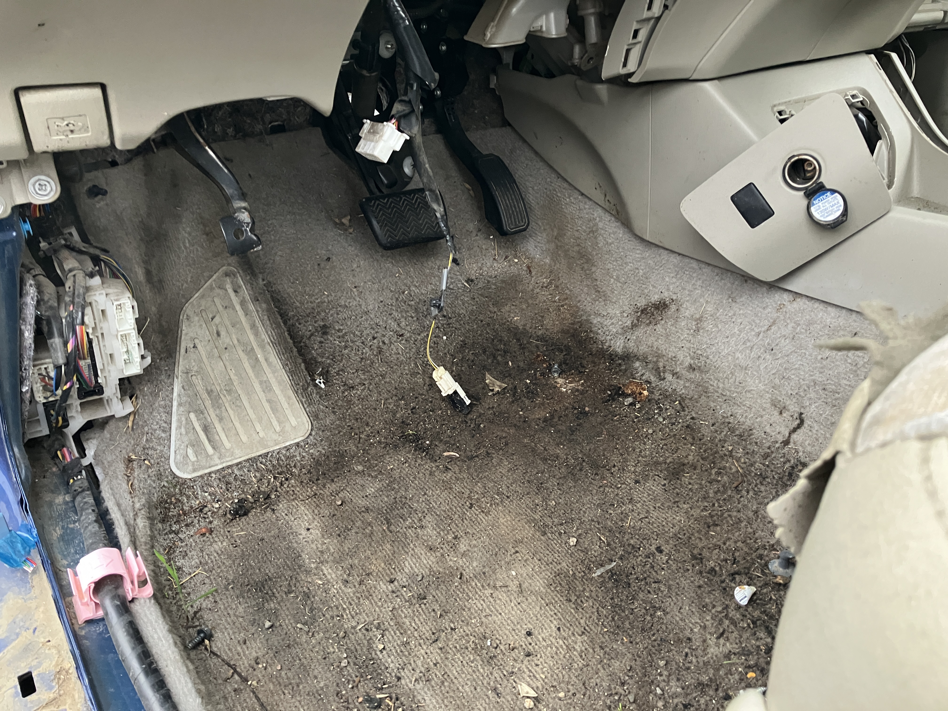

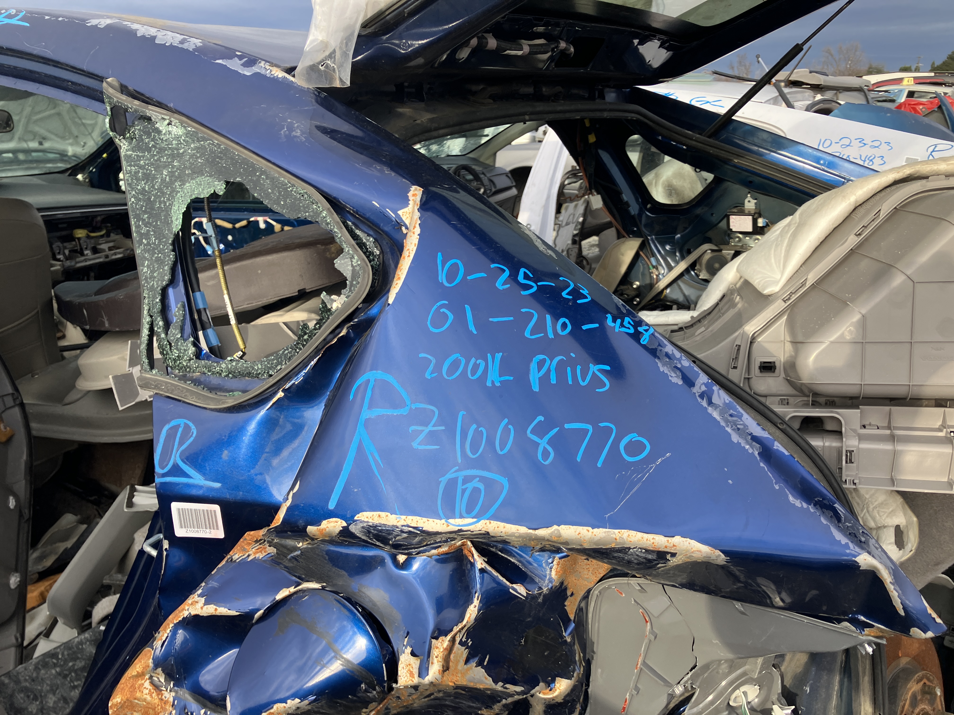

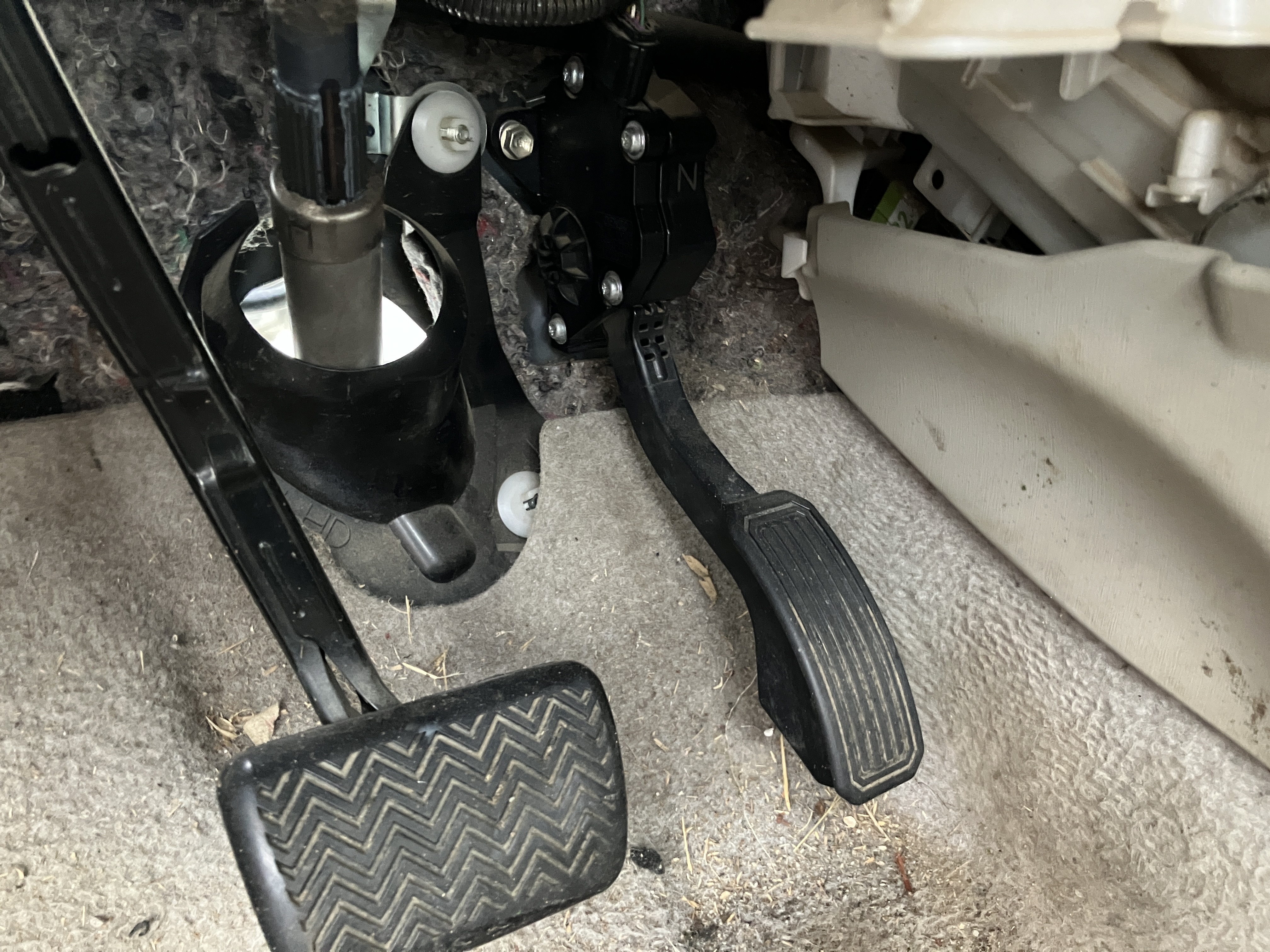

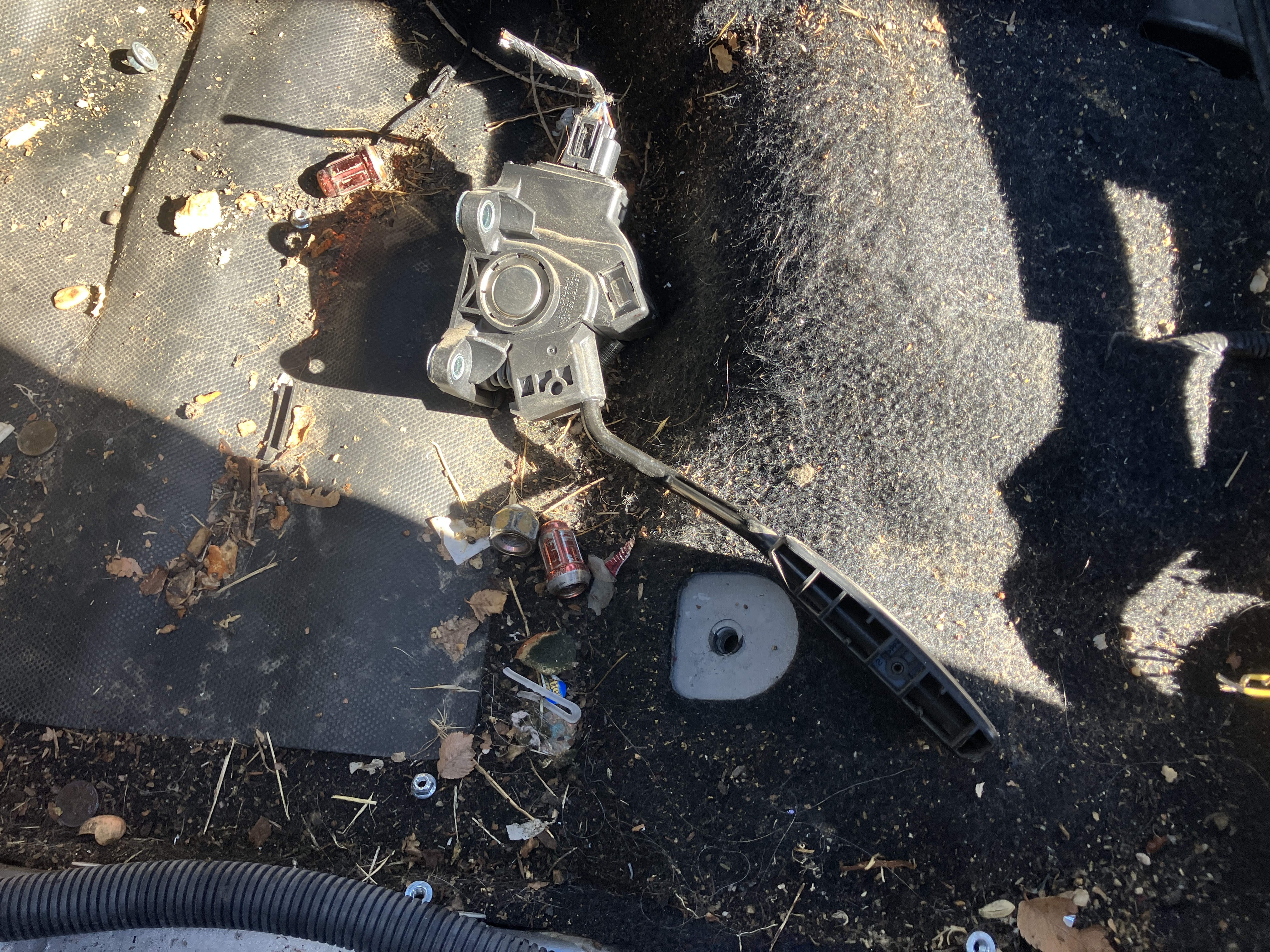

so here's Big Blue, a 2011 Toyota Prius that gave her life so that we could have this pedal, and I have gotten these pedals ranging from for FREE, to $5 dollars on their 50% OFF Sale Days, to whatever they felt like charging me on that day
I think it is worth sharing how it looked and how it was installed in it's OEM formation:
I am tempted to go back to the junk yard and press a few of these down and see if they have a full range of motion when installed or do they bottom out on the carpet, I am 99% certain they bottom out on the carpet and do not have their full range of motion like they do for us on the workbench

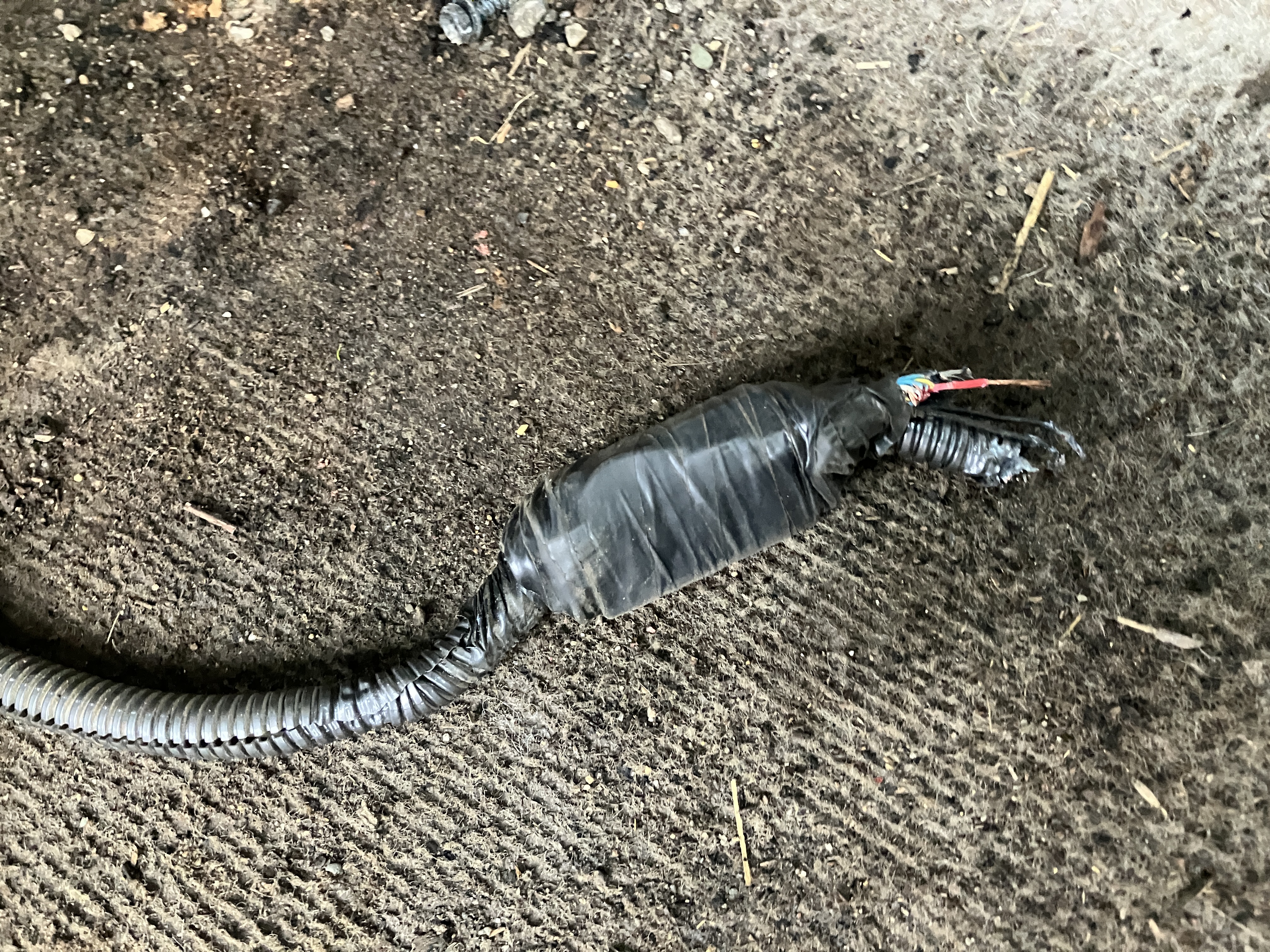

this pig tail was a bit odd, it had two plugs on it, so had I known I would not have had to cut it, maybe
- Posts: 1084
- Has thanked: 479 times
- Been thanked: 314 times

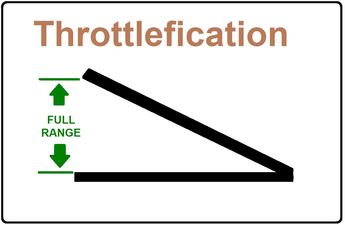

I had an alternative solution. If that's true, it's surely so stupid that many people have complained about it before...Gregski wrote: ↑Sun May 05, 2024 1:47 pmI am tempted to go back to the junk yard and press a few of these down and see if they have a full range of motion when installed or do they bottom out on the carpet, I am 99% certain they bottom out on the carpet and do not have their full range of motion like they do for us on the workbench
https://priuschat.com/threads/accelerator-pedal.77114/
"The pedal itself apparently has no internal stop but relies on the pedal travel bottoming into the floor carpet. The pedal has a littl protrusion that is what hits the floor carpet appearing to be the design. Is this normal? Several now say no. One service manager says yes its normal."
"If it's not allowed to go all the way to the floor, the pedal would have to have an internal stop mechanism capable of resisting the full pressure that a human leg could apply to it. The mount would have to be equally as strong."
"If the accelerator pedal cannot touch the floor, there won't be "flooring the accelerator", right?"
There's even discussion of Dealer-installed vs. OEM floormats and how you have to customize them to even reach highway speed:
https://priuschat.com/threads/accelerat ... et.210839/
"This means I can't actually use a floor liner because a stiff surface prevents the car from accelerating sufficiently to highway speeds."
"Even with OEM floormats (or no floormats) it seems like when the pedal touches the carpet flooring, I'm a step below maximum throttle. I need to depress the pedal into the flooring itself to achieve maximum throttle"
So, yeah, totally normal.

MattsAwesomeStuff wrote: ↑Sun May 05, 2024 2:54 pm I had an alternative solution. If that's true, it's surely so stupid that many people have complained about it before...
Superb information as always Matt, I shall add it to our Nothin's Easy List aka the NEL
- crasbe
- Posts: 330
- Location: Germany
- Has thanked: 58 times
- Been thanked: 180 times
You know that you can just configure where 100% throttle is, right? So even if your pedal would bottom out at 50% travel, you could configure the ZombieVerter to interpret that as 100%
- Gregski
- Posts: 3171
- Has thanked: 635 times
- Been thanked: 1611 times
absolutely

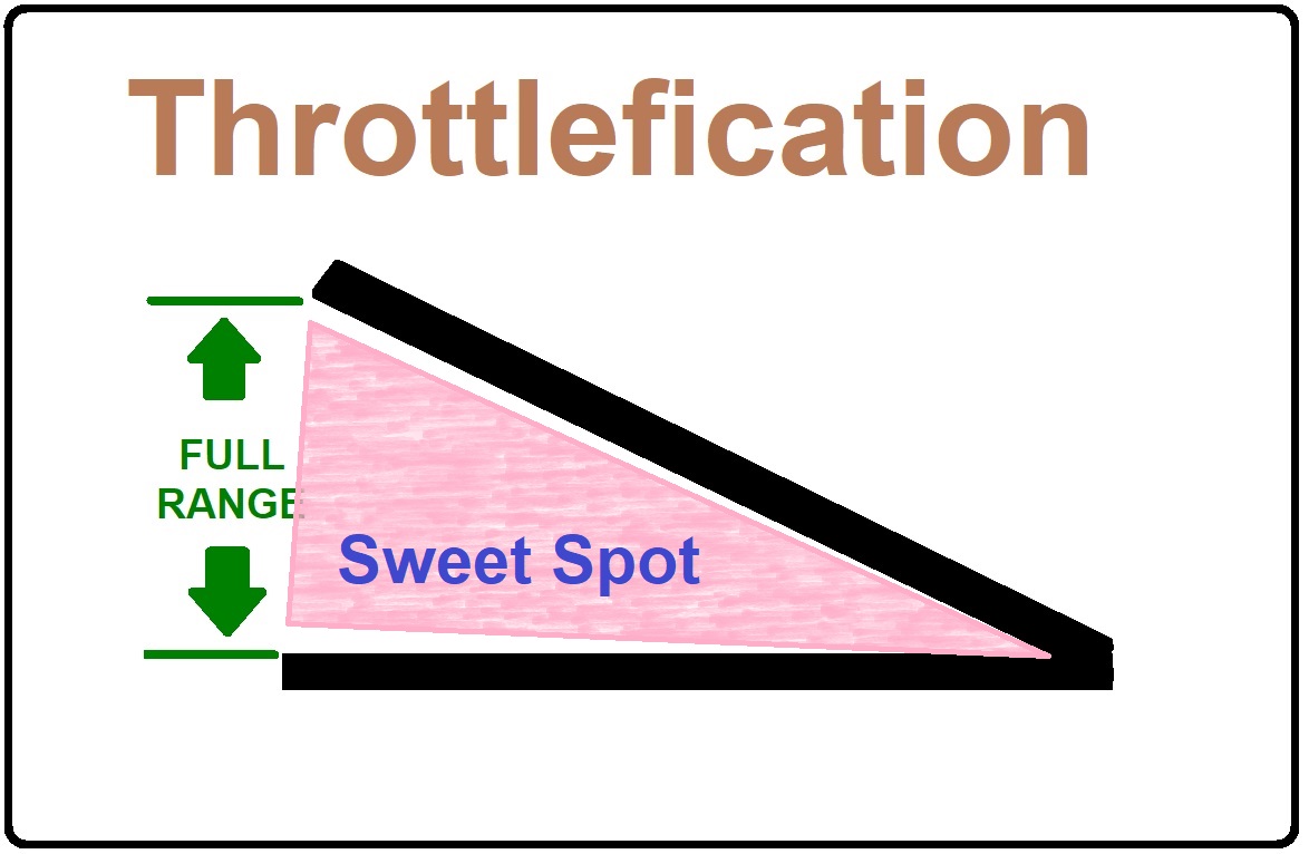

the Prius pedal just didn't blow my skirt up, so with more pedals at my disposal I decided to give the 2010 Honda Fit a go
- Gregski
- Posts: 3171

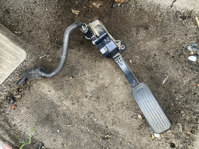

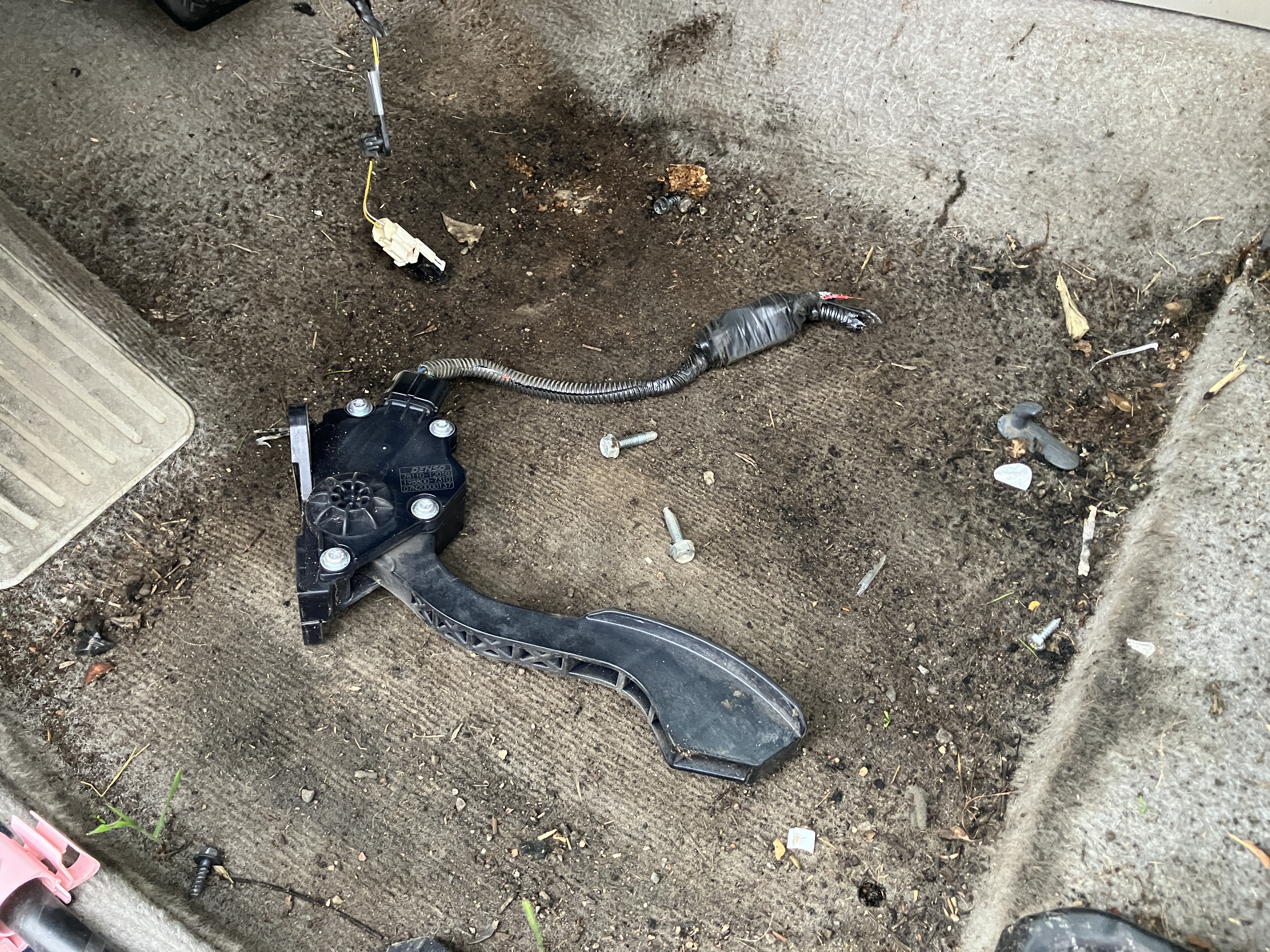

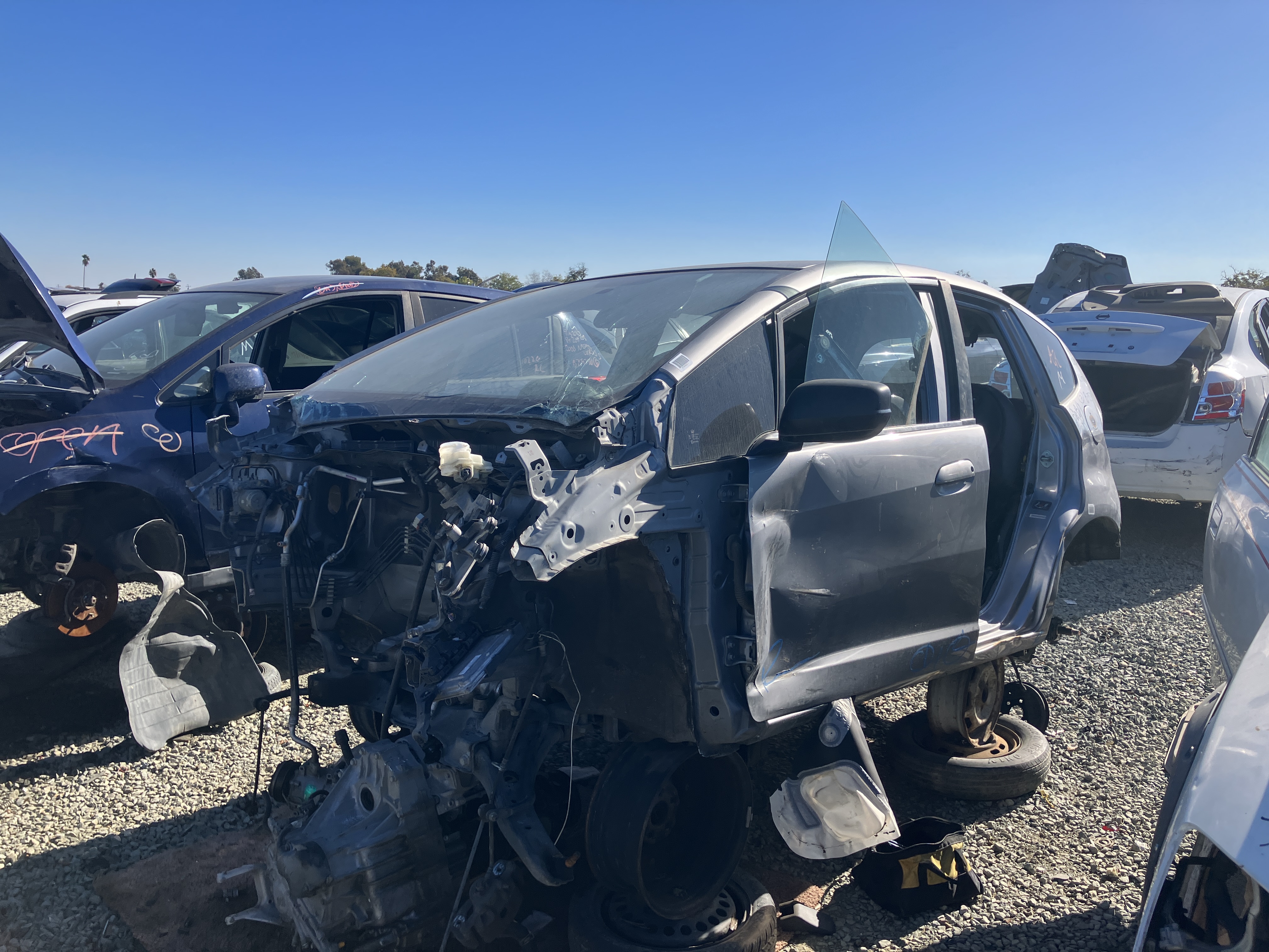

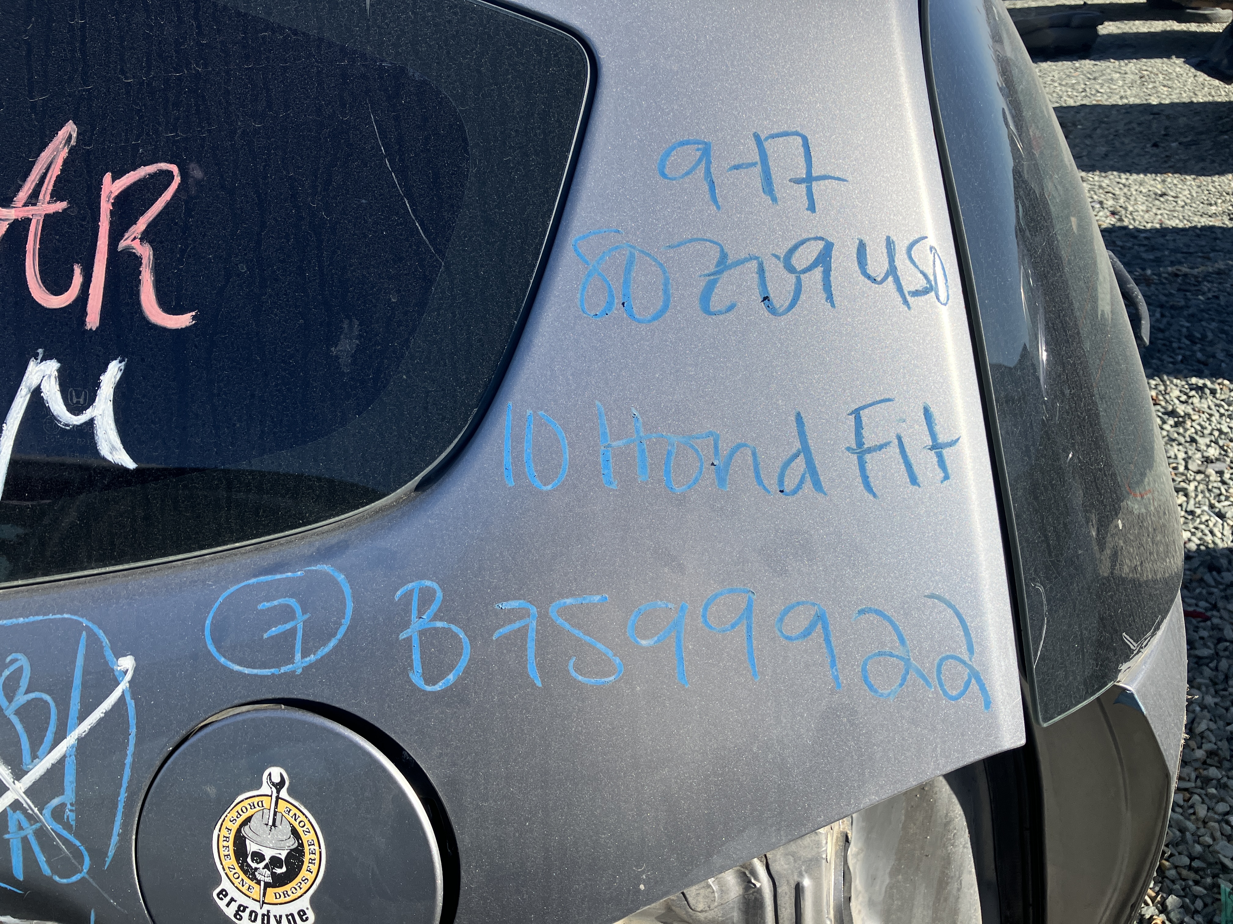

and this is the state I found that pedal in at the junk yard, nothing but a small scratch on that car, I'm certain it never was raced
- Gregski
- Posts: 3171
though I am not running the ZombieVerter VCU in the truck ... yet, (planned upgrade for Phase III) I think you may find this video on throttle calibration interesting
ZombieVerter VCU Throttle Calibration

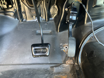

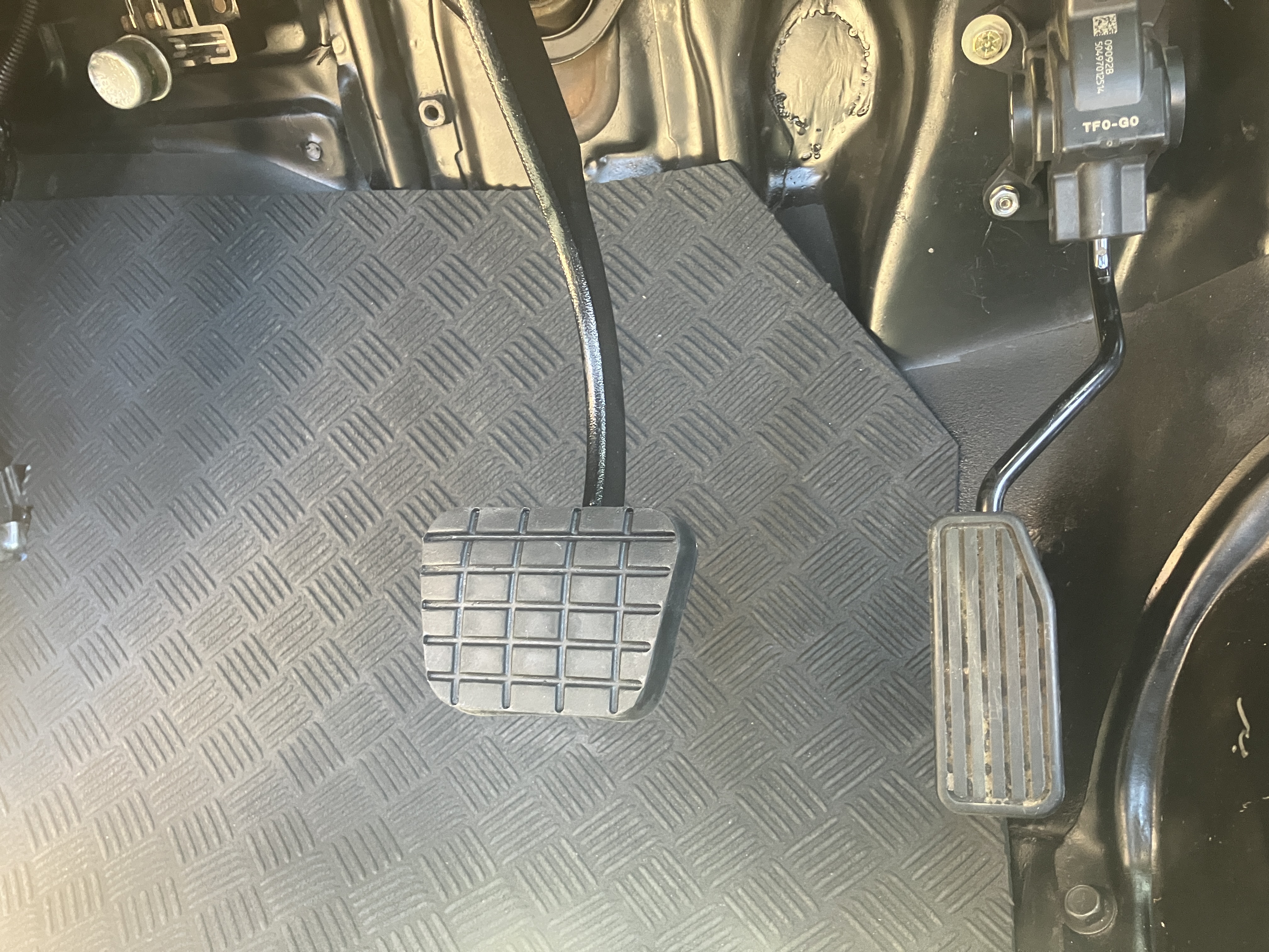

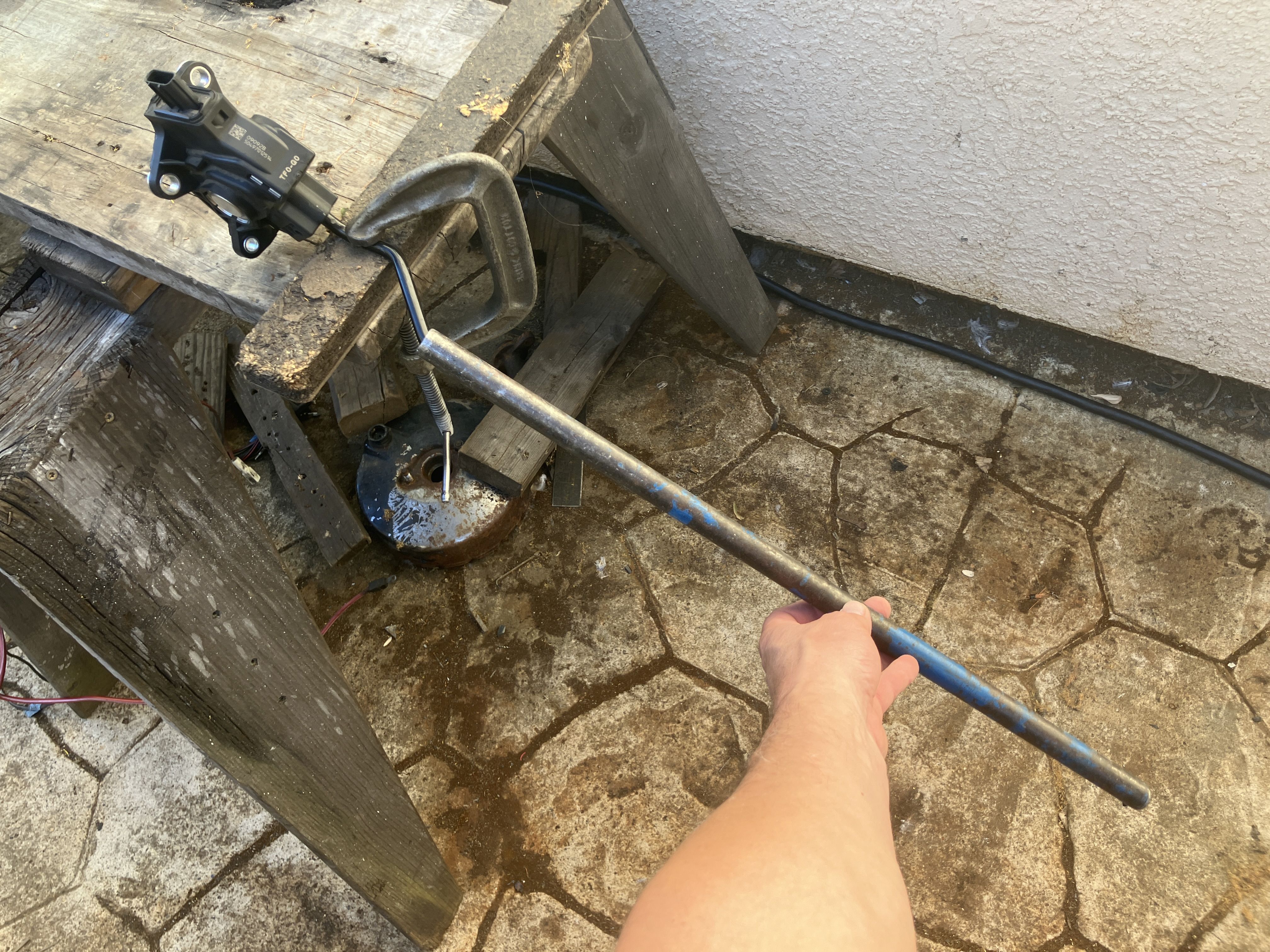

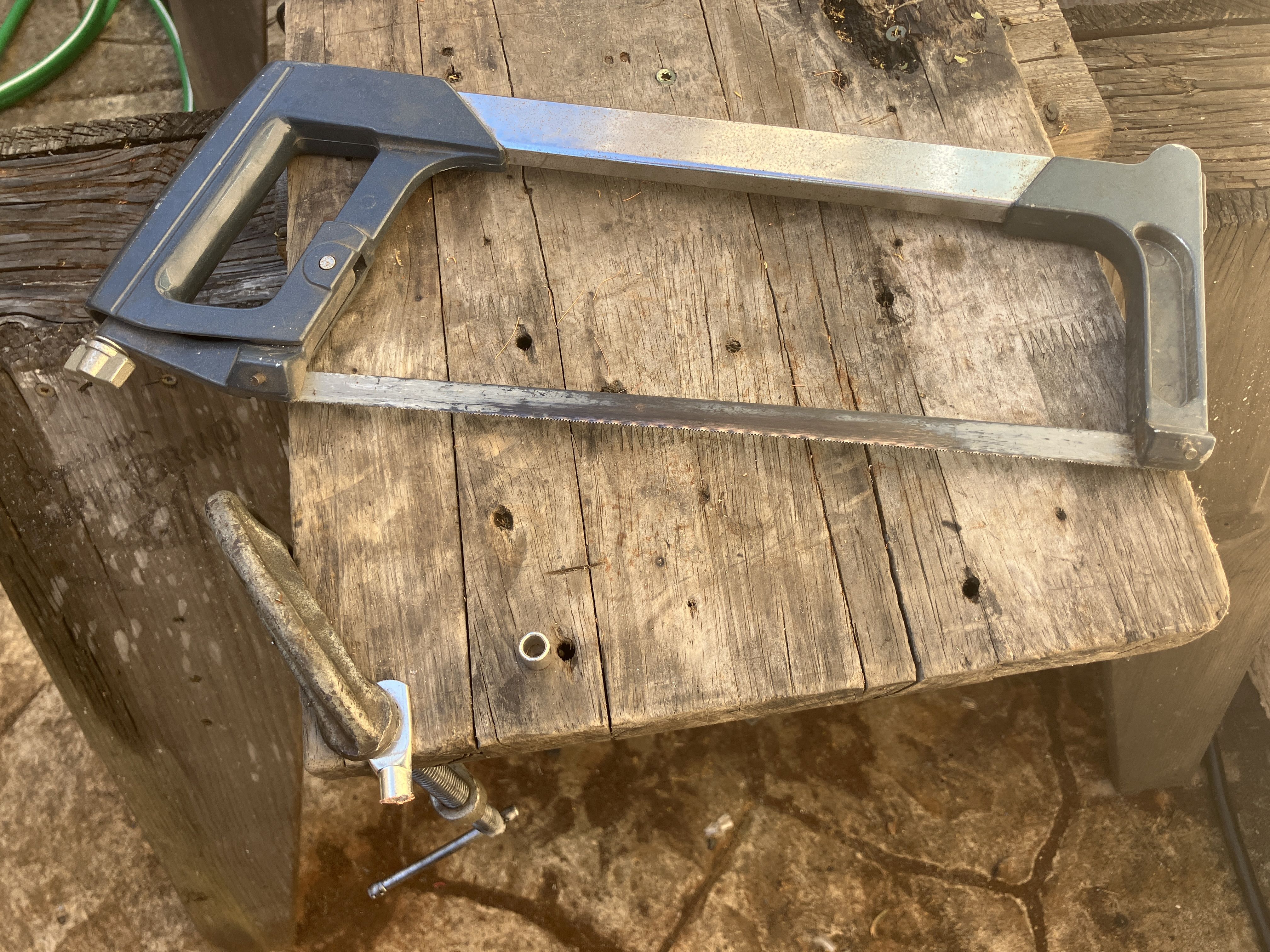

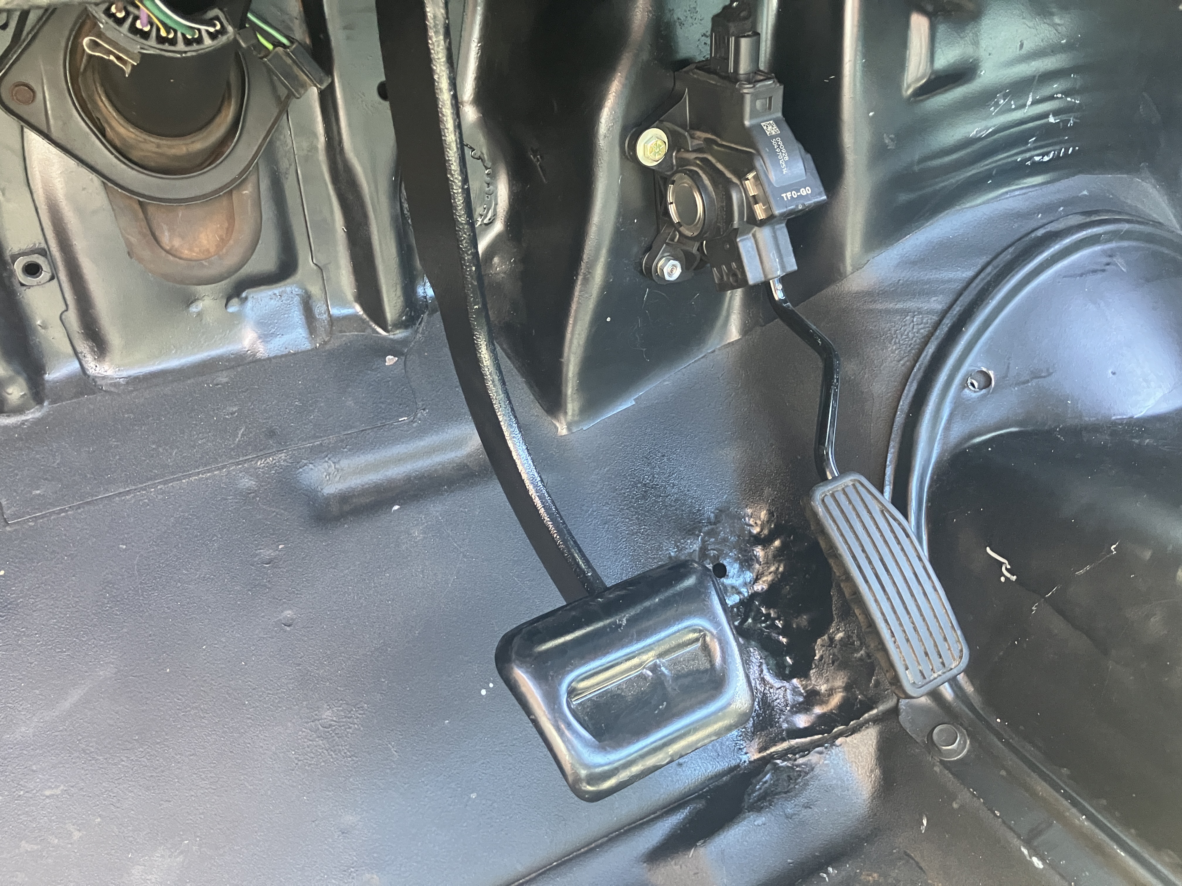

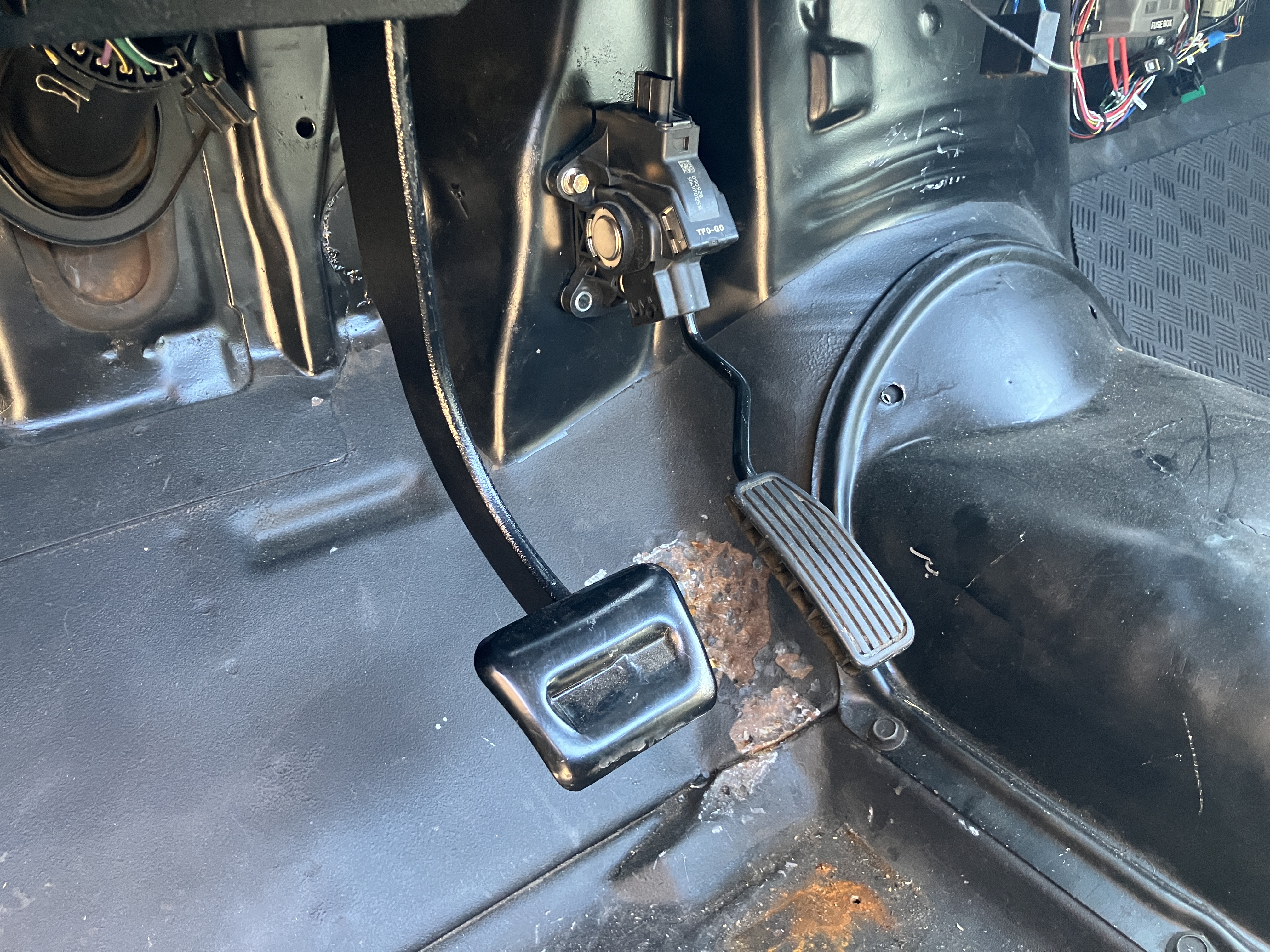

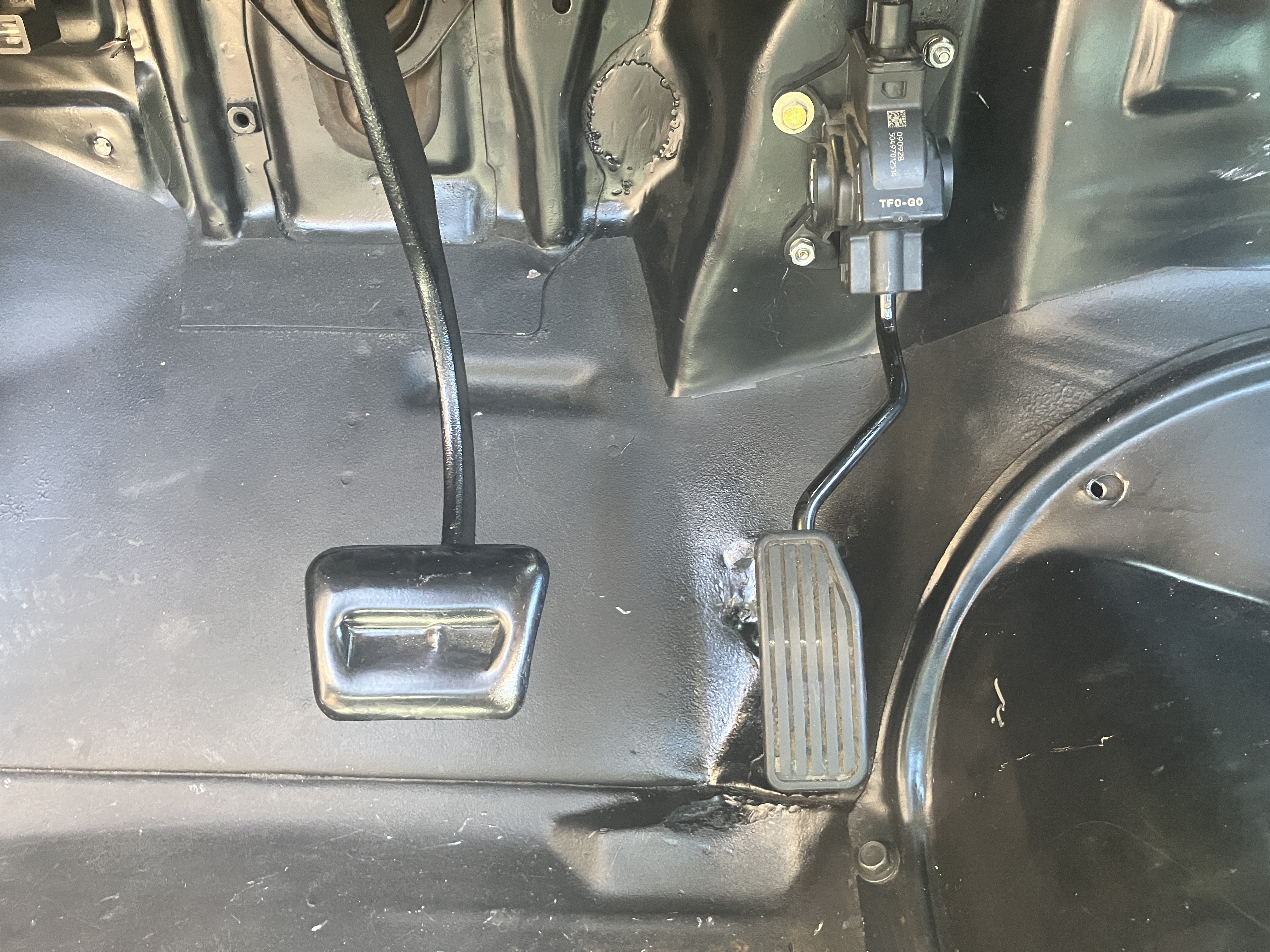

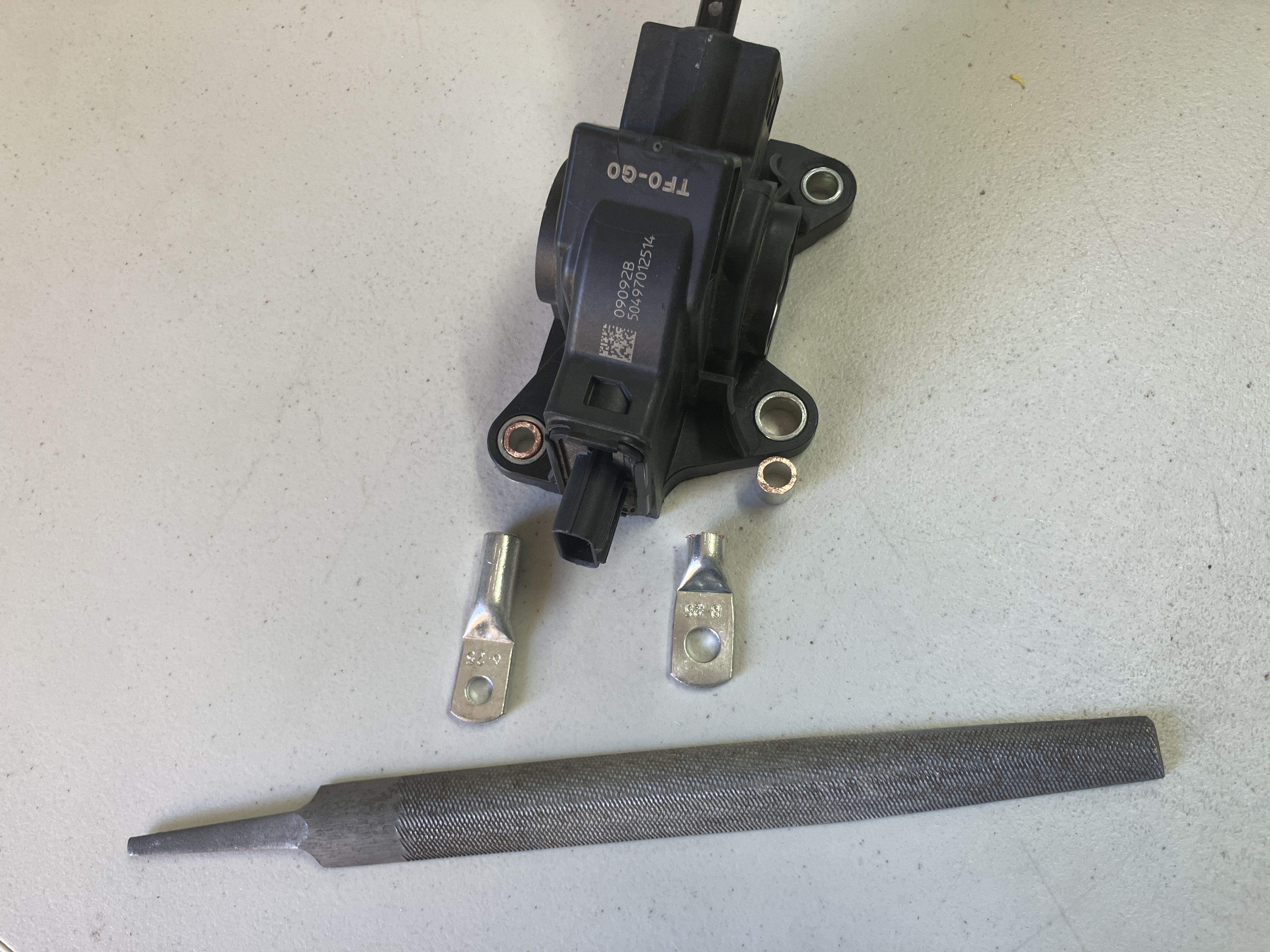

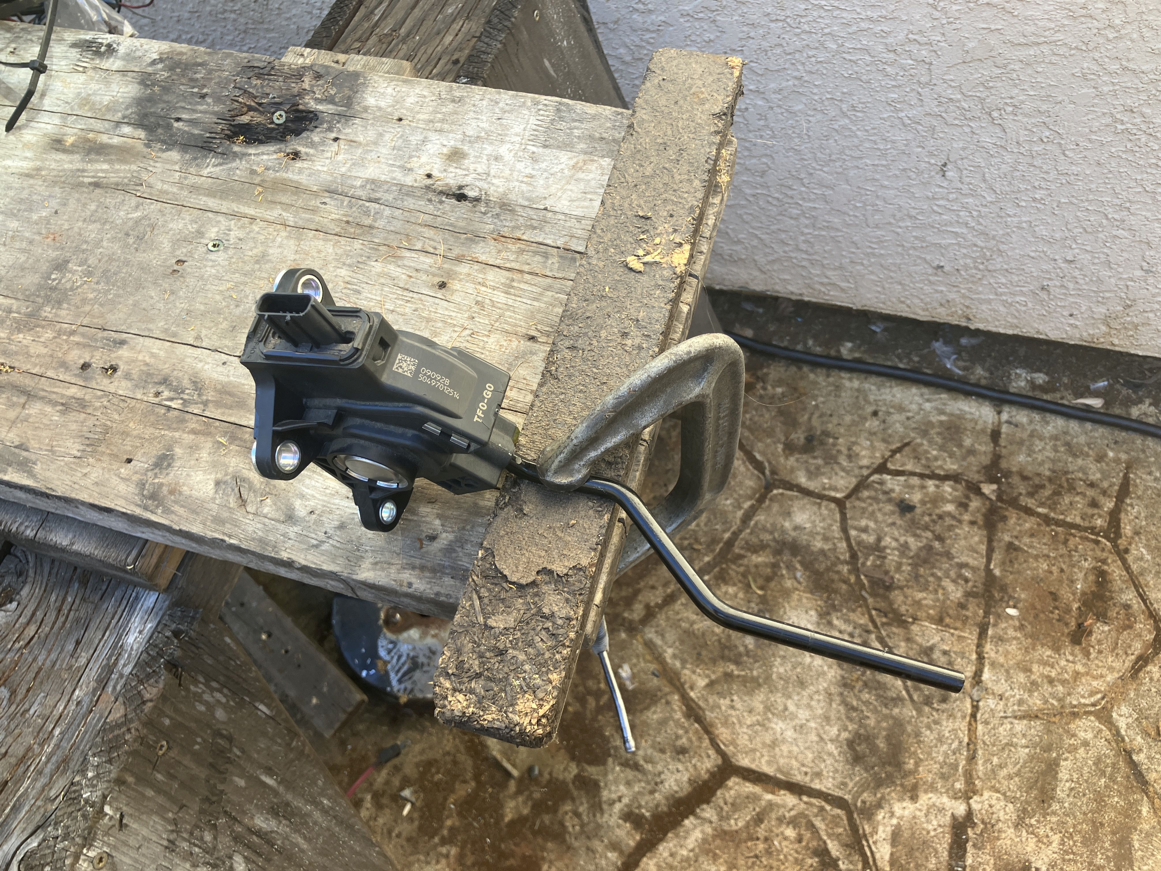

so finally got around to installing the 2010 Honda Fit throttle pedal in the truck
nice thing about this pedal is that it has a metal rod, which we can [ahem] persuade
here I am showing off my handrolic press
who knew these expensive cable lugs make cheap spacers
a lot of filing makes for perfect straight and even cuts each and every time
- Gregski
- Posts: 3171

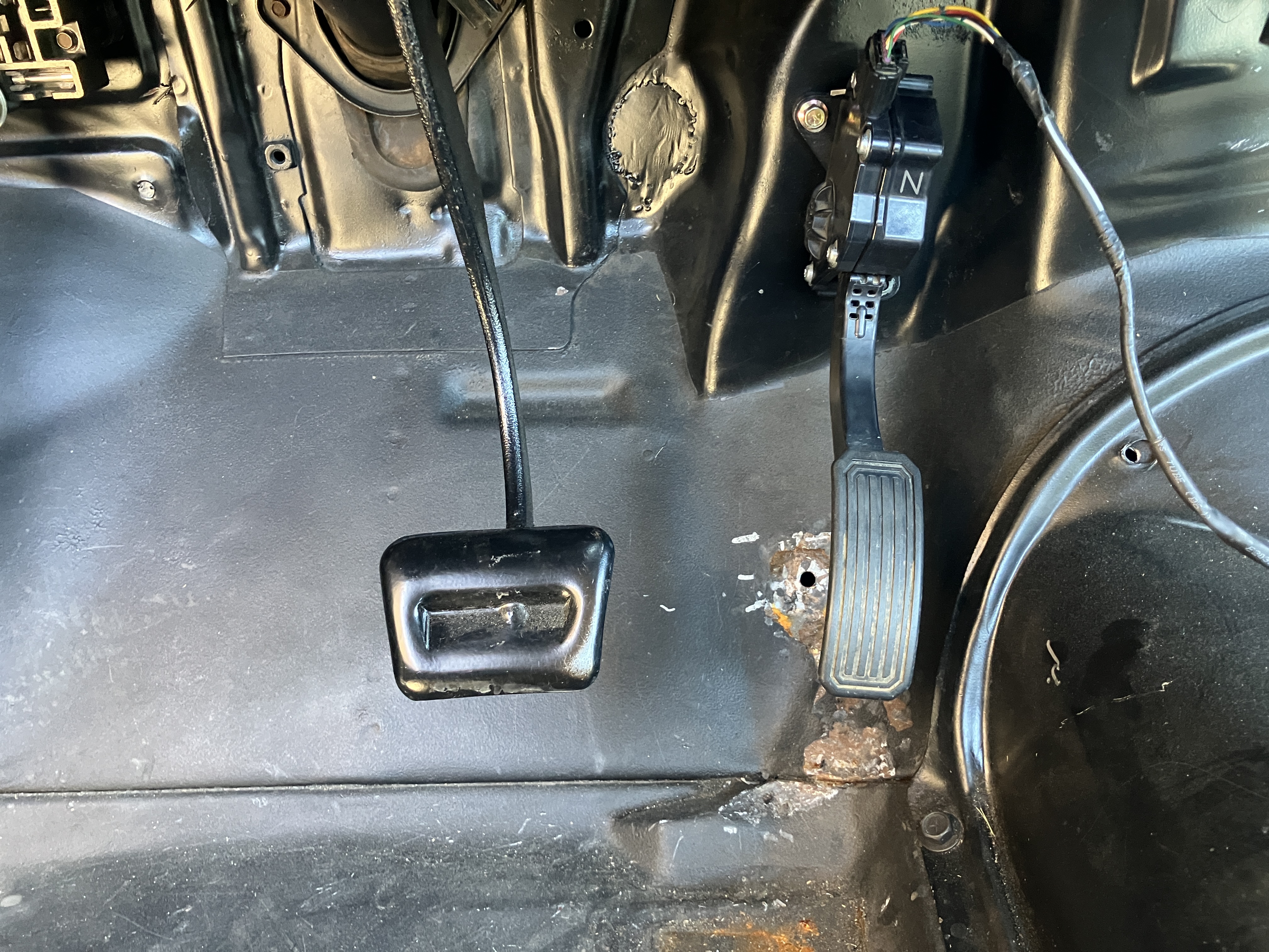

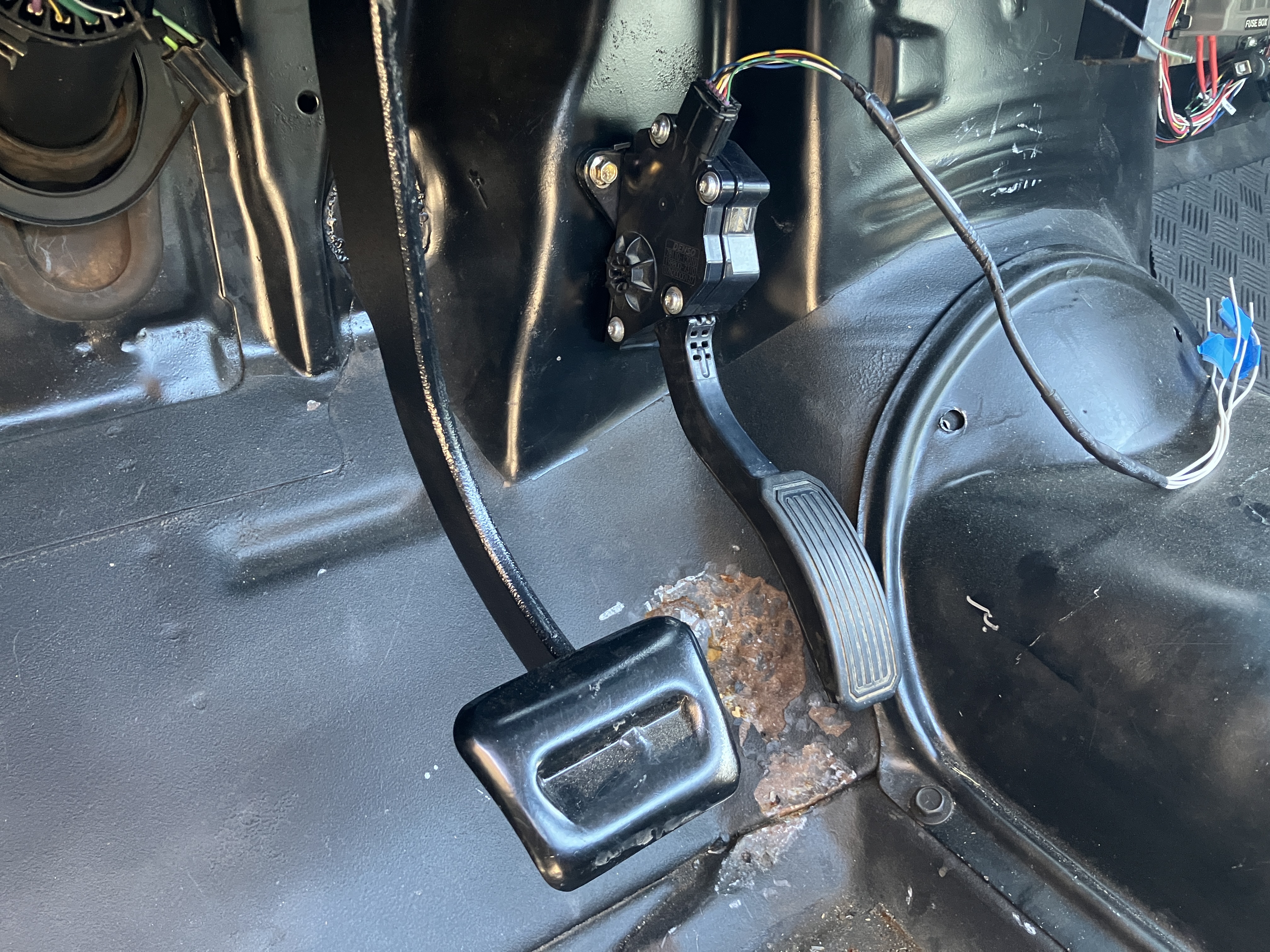

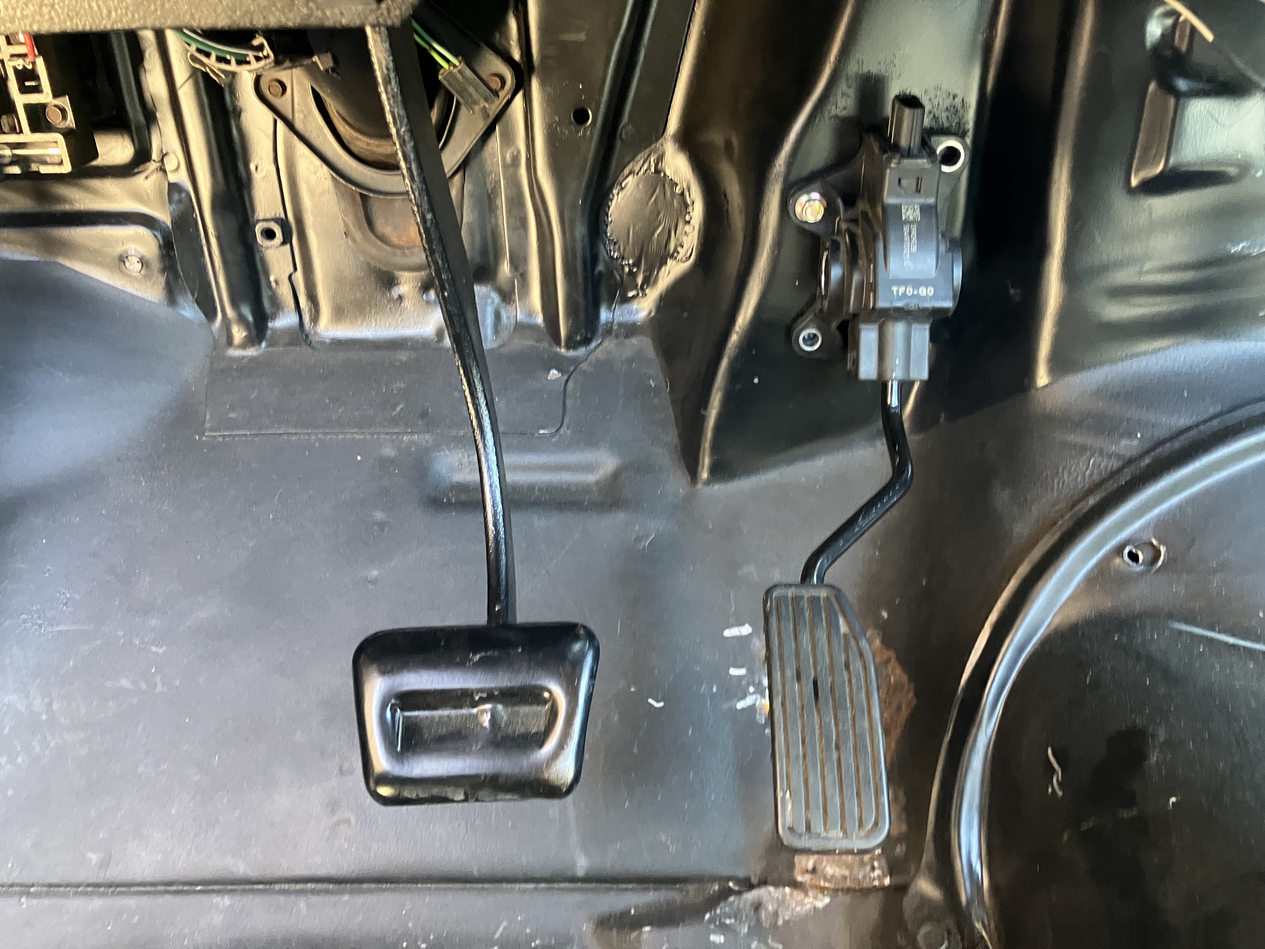

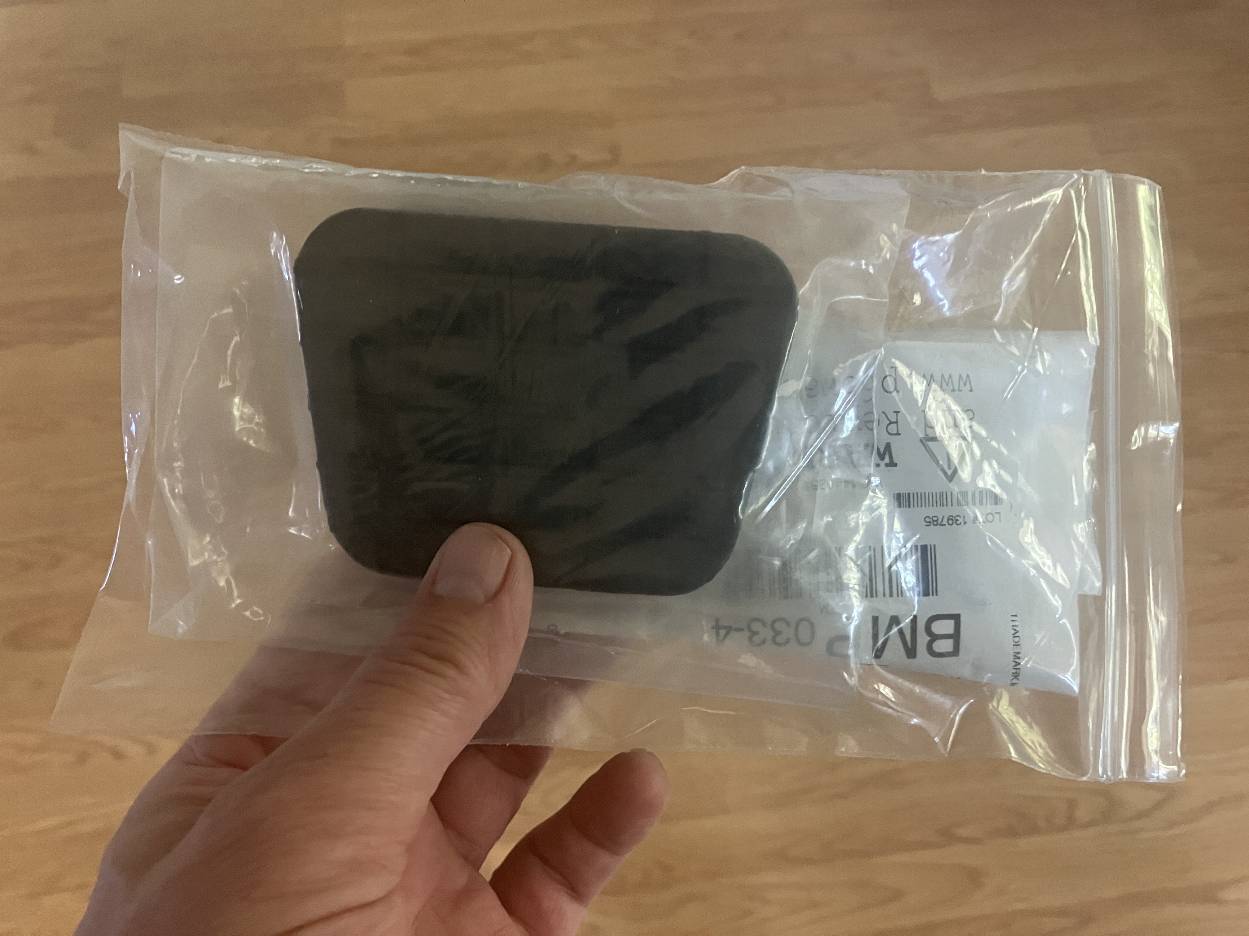

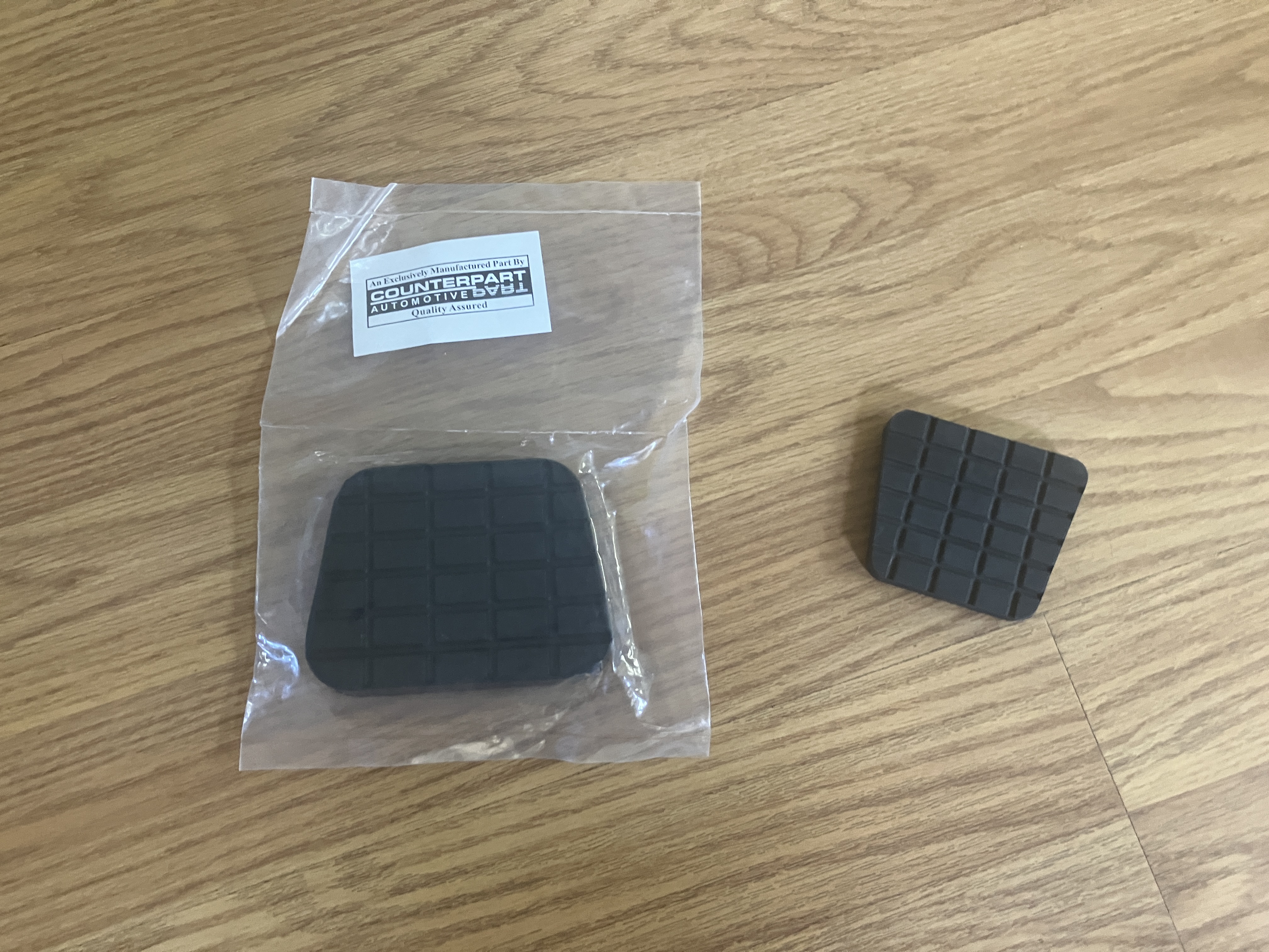

and here it is, installized
the details belong to the devil
just to think, all this to be able to install a floor mat

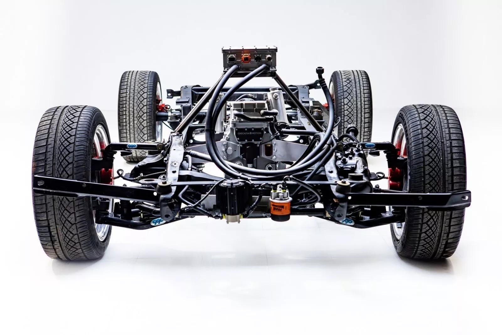

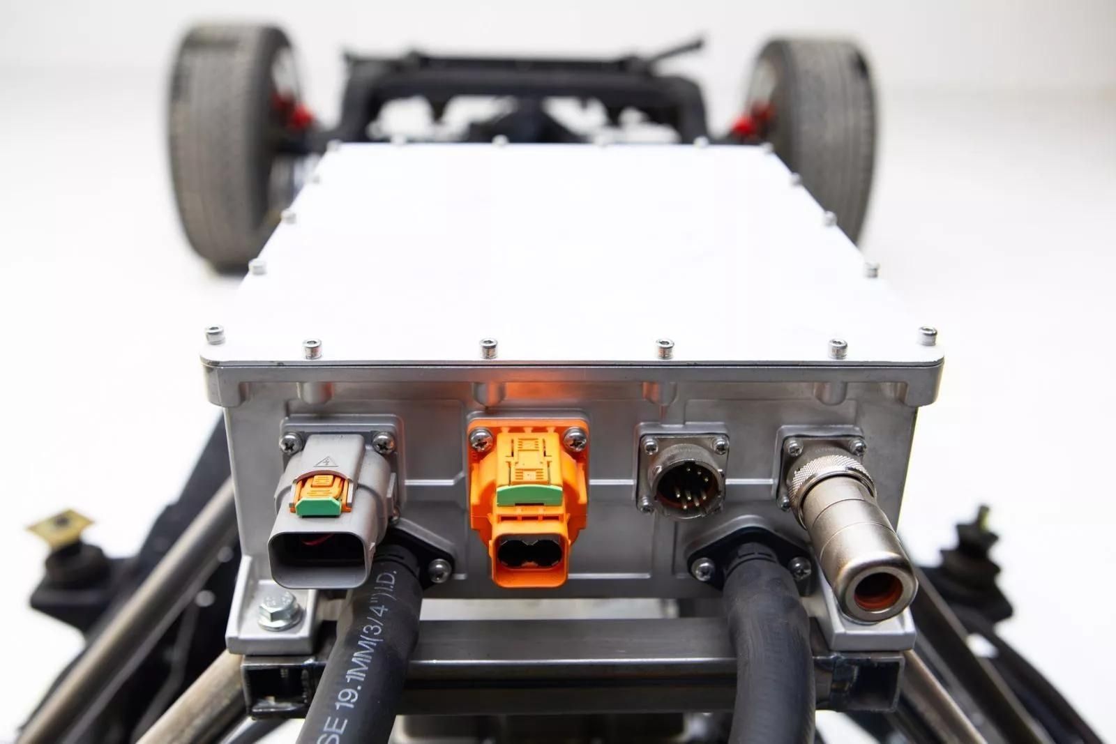

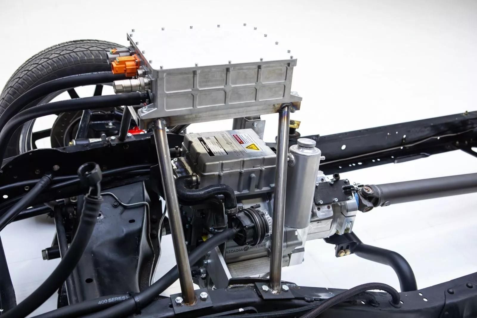

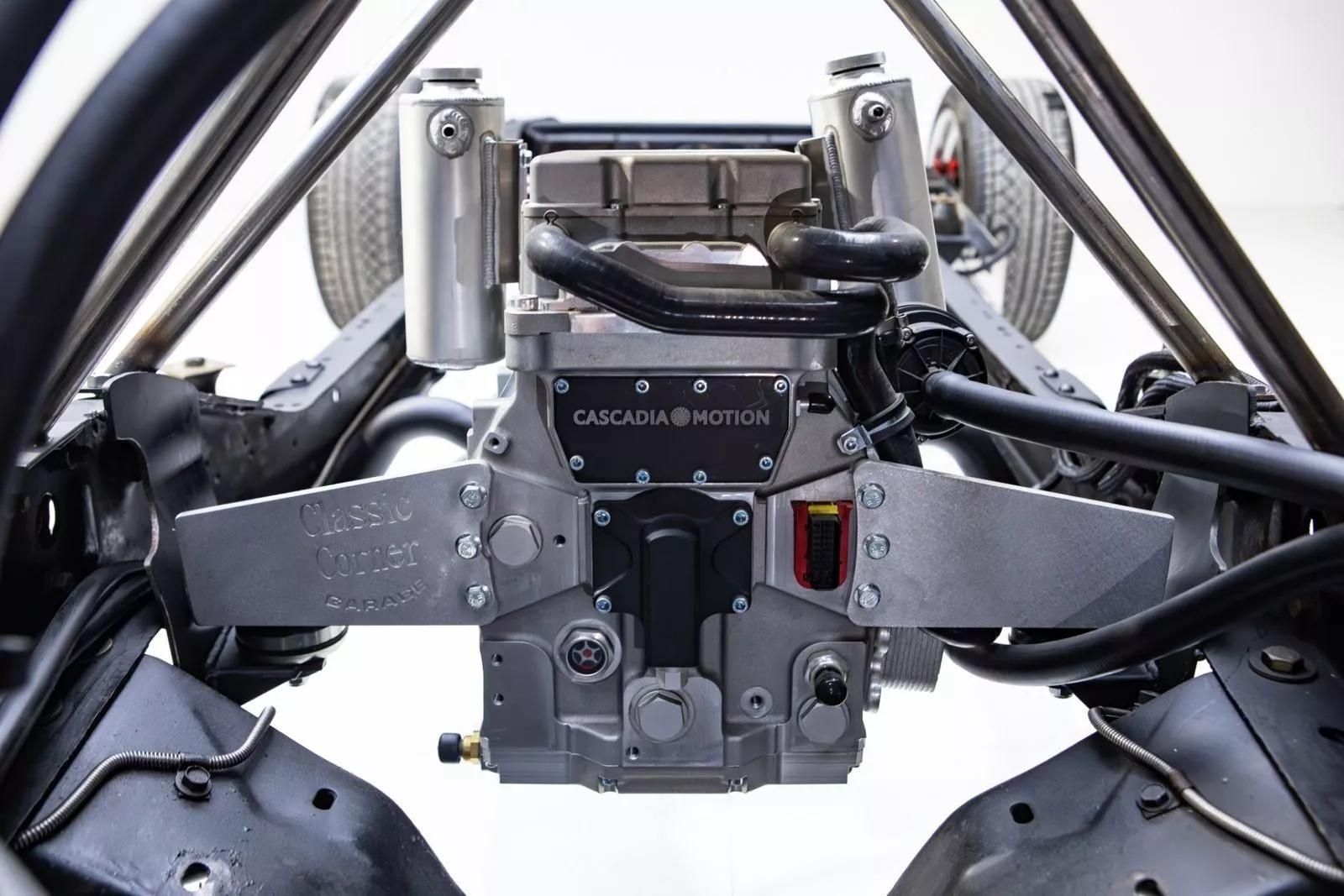

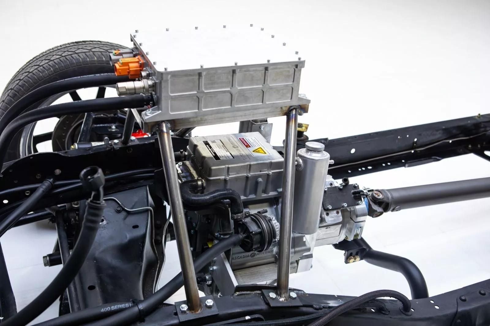

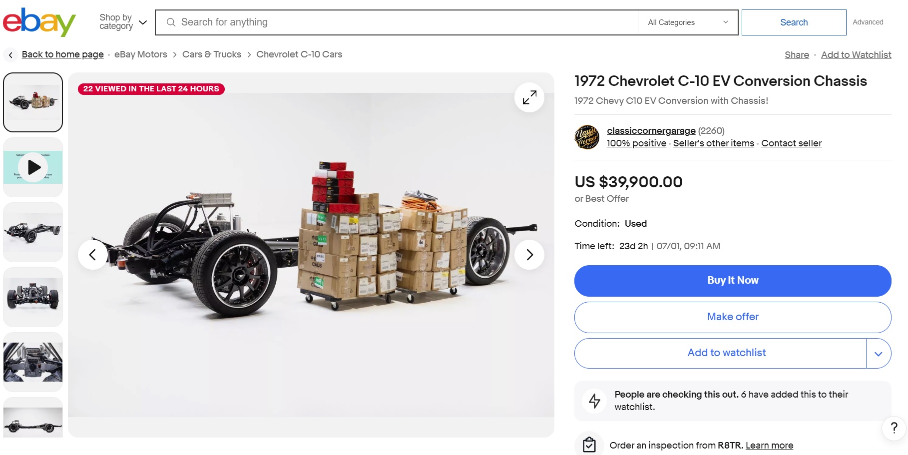

somebody posted this link for a 1972 Chevrolet C-10 EV Conversion Chassis kit I guess on eBay, to my truck build thread on the 67-72chevytrucks.com and I just wanted to share and hear your thoughts please
Upgrade your 1972 Chevy C10 (SWB) Chassis with the cutting-edge Complete Legacy EV Cascadia Motion Drive train package and accompanying batteries (chassis shown in pics is included). If you own a 67-72 C10 Short box, simply transfer your body parts onto this chassis. With a few final touches, you could be cruising in a unique EV-powered Classic Truck! This comprehensive package includes nearly $60,000 worth of drivetrain components and batteries. We've already assembled 90% of the chassis with the driveline, so all that's left is some minor assembly work to put together the truck on your own.
1972 Chevy C10 Chassis with Legacy EV Cascadia Motion Drive train package and accompanying batteries:

And only $40,000. Greg is a fool. Should have just loaded his musket with benjamins.
P.S.Mangelsdorf
- Posts: 1231
- Location: Raleigh, NC, USA
- Has thanked: 323 times
- Been thanked: 353 times
I suppose for someone that wants to just write a check, it's all there, and all top of the line stuff.
This actually gets to one of my peeves with a certain type of EV conversion guy; they guy that has to buy brand new aftermarket everything and is completely sketched out the kind of shenanigans that go on around here. There seems to be the underlying aversion to/fear of stuff that is not professionally developed.
I've described my '40 as a middle finger in both directions, to the "it's not a hot rod unless it's prewar and has a flathead" ICE guys and to the "it's unsafe unless a professional develops it" EV guys.
The only way EVs become the future of hot rodding is if we remember our roots - find production components, make them work, and hot up your car. You don't need permission or a degree, you need a desire and some ingenuity.
That's why I love this community dearly. While the ICE guys run around like the sky is falling, and the cocktail party guys drop a boatload of money to have a professional do it, here we are keeping a small ember of real hot rodding alive for the future.

finally, that only took 6 months from the time I ordered it, gonna mount it as soon as I finish my avocado toast and soy chi latte mocha frappuccino, before heading out to surf

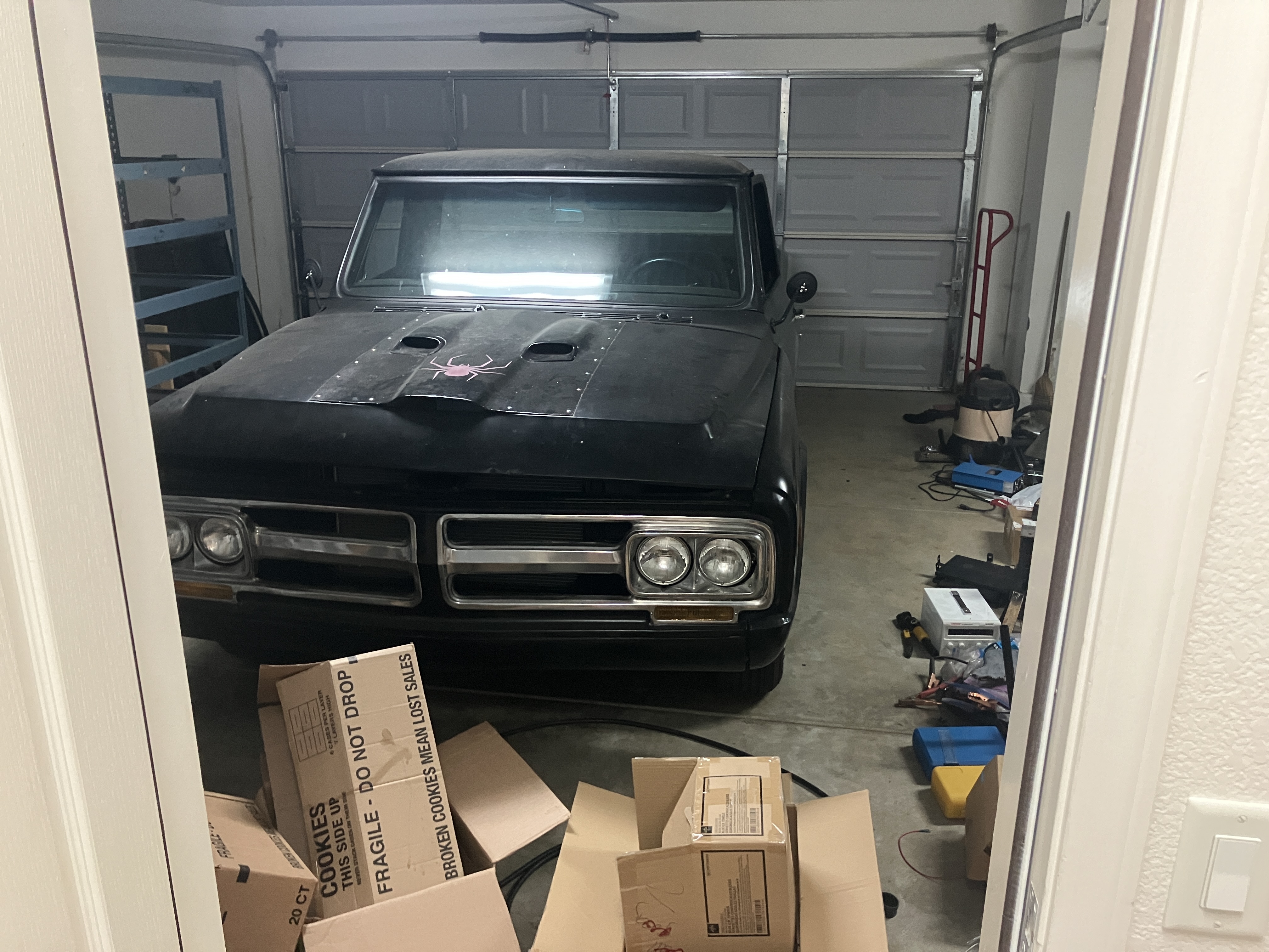

on this episode of I Want To Be Like Damien, I provide you with a little truck update. so as you know EV Conversions are super easy and get boring quickly, that's why I always like to sell my house, and pack up my shop and move into a new place, yes using the electric truck, like you know the Irish Cat Man did. so we pushed the 9 kWh baby battery pack limit making these 25 mile treks
and there she is, think outside the box
- Posts: 1084
You moved? In 120'F weather? Why do you hate yourself?
Congrats/Condolences on the new place. It still has a garage, so, I'll take that as somewhat of a positive sign.
This answers why you've been so quiet.
- Gregski
- Posts: 3171
ha ha, this is a much bigger treeeee car garage, it doesn't look like that in the pic, also in this house EV parts can live inside, if you catch my driftMattsAwesomeStuff wrote: ↑Fri Aug 02, 2024 7:21 pm You moved? In 120'F weather? Why do you hate yourself?
