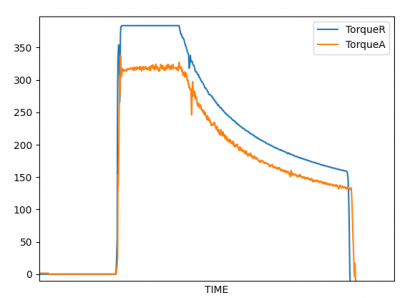

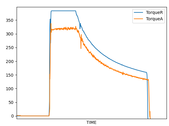

Which bus were these captured from? Doesnt look like the pt can from a quick glance.
Re: Nissan Leaf Gen3 inverter
I thought it was the EV-CAN, it has the BMS, VCM, and inverter messages on it. Is there another bus I am missing?
- Posts: 3999
- Been thanked: 1114 times
Ok thanks will recheck. Was just a quick look.
- Posts: 3999
My apologies on this it is indeed correct. Savvycan had a problem reading the file format. Now fixed.
No worries.
Today I tried to see if I could get more power/torque from this by spoofing the torque request. Turns out it's limited like the old inverter so the 160kW car must have different firmware.

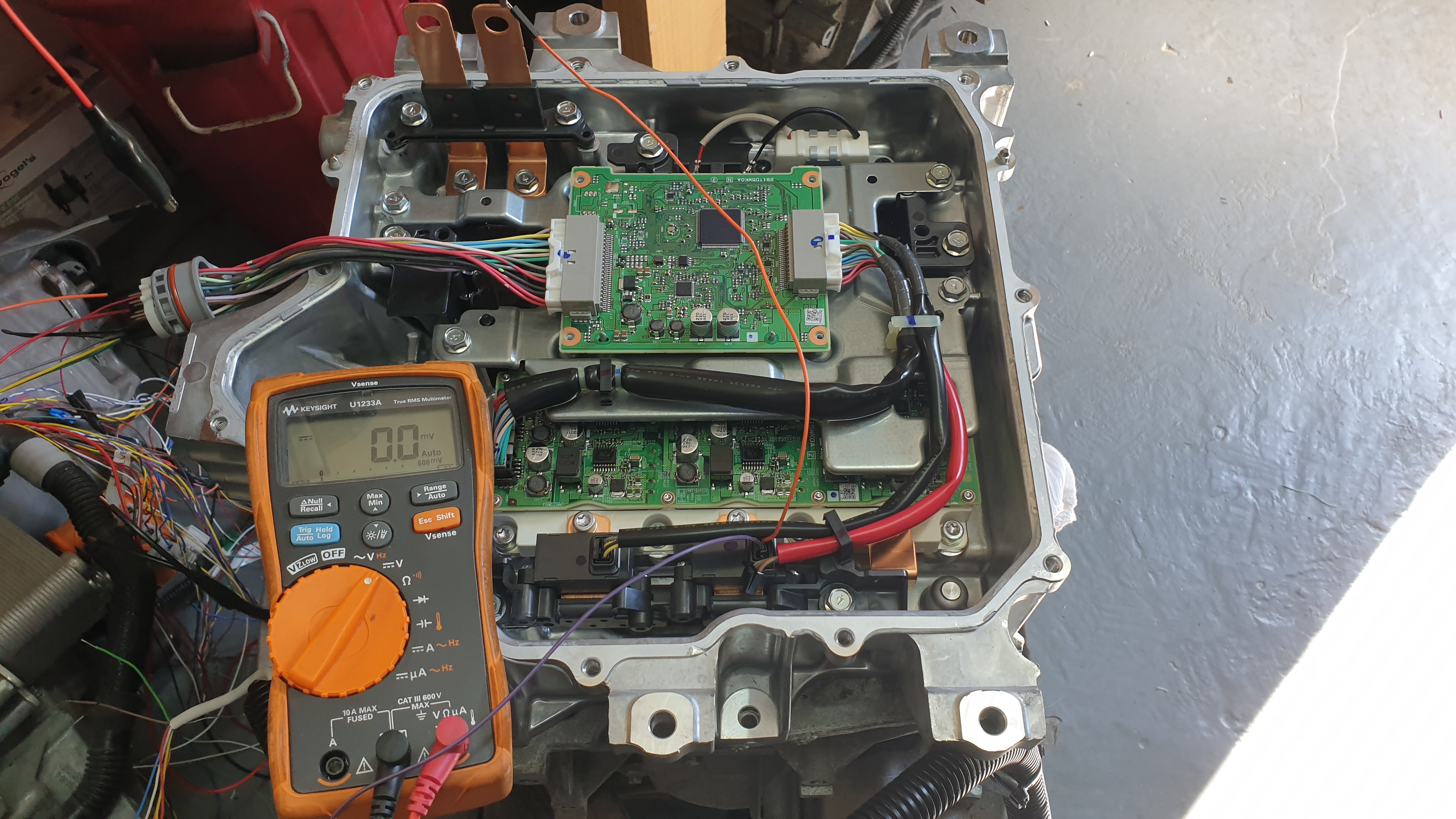

Here are the official names for the F22 inverter pins from Nissan
Currently working on a Gen3->2 upgrade harness, that will work in tandem with a CAN-bridge to supply 110kW instead of 80kW max demand messages!

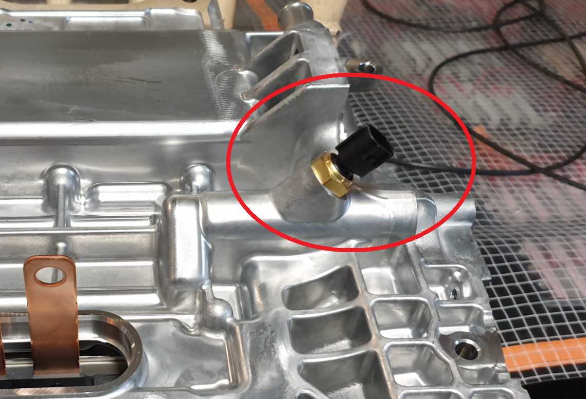

Can you take a resistance measurement from the temperature sensor? So that people that lack this sensor can install a resistor while sourcing the correct sensor.
Also do the resolver offset writing as soon as possible, maybe wait for the leafspy pro version!
The sensor is screwed into the inverter base and comes with it as it is part of a coolant path. The main issue was trying to find a connector to fit, it's some kind of Denso plug I think, I just used bare pins and glue.

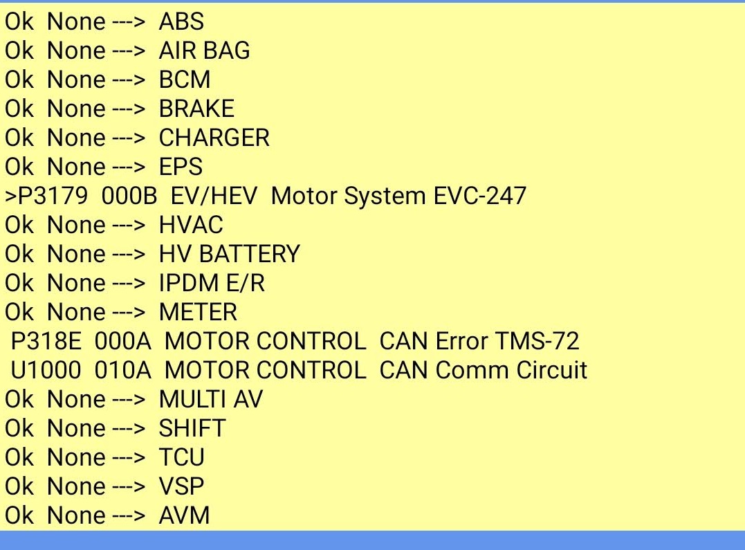

Can you say which fault codes are active? Can be viewed with leafspy!
Sure, see attached. I have access to a 110kW car so planned to send it messages and keep trying to clear, just haven't had the chance yet.

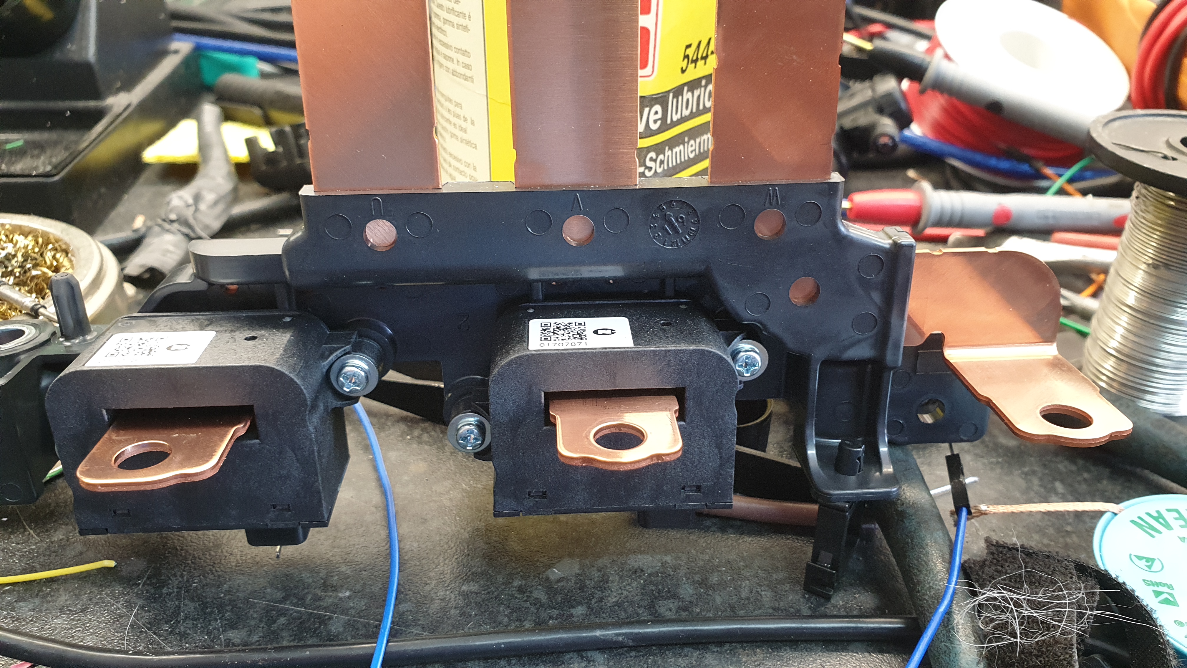

Seems my gen3 inverter has a dead middle current sensor. Don't suppose anyone has a spare?
