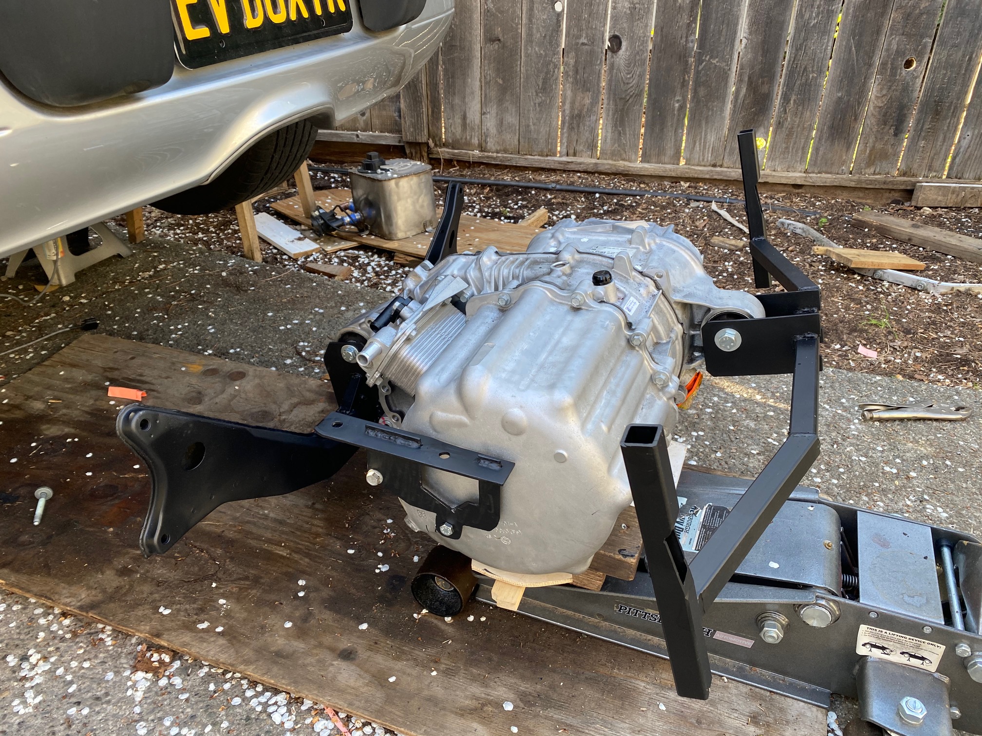

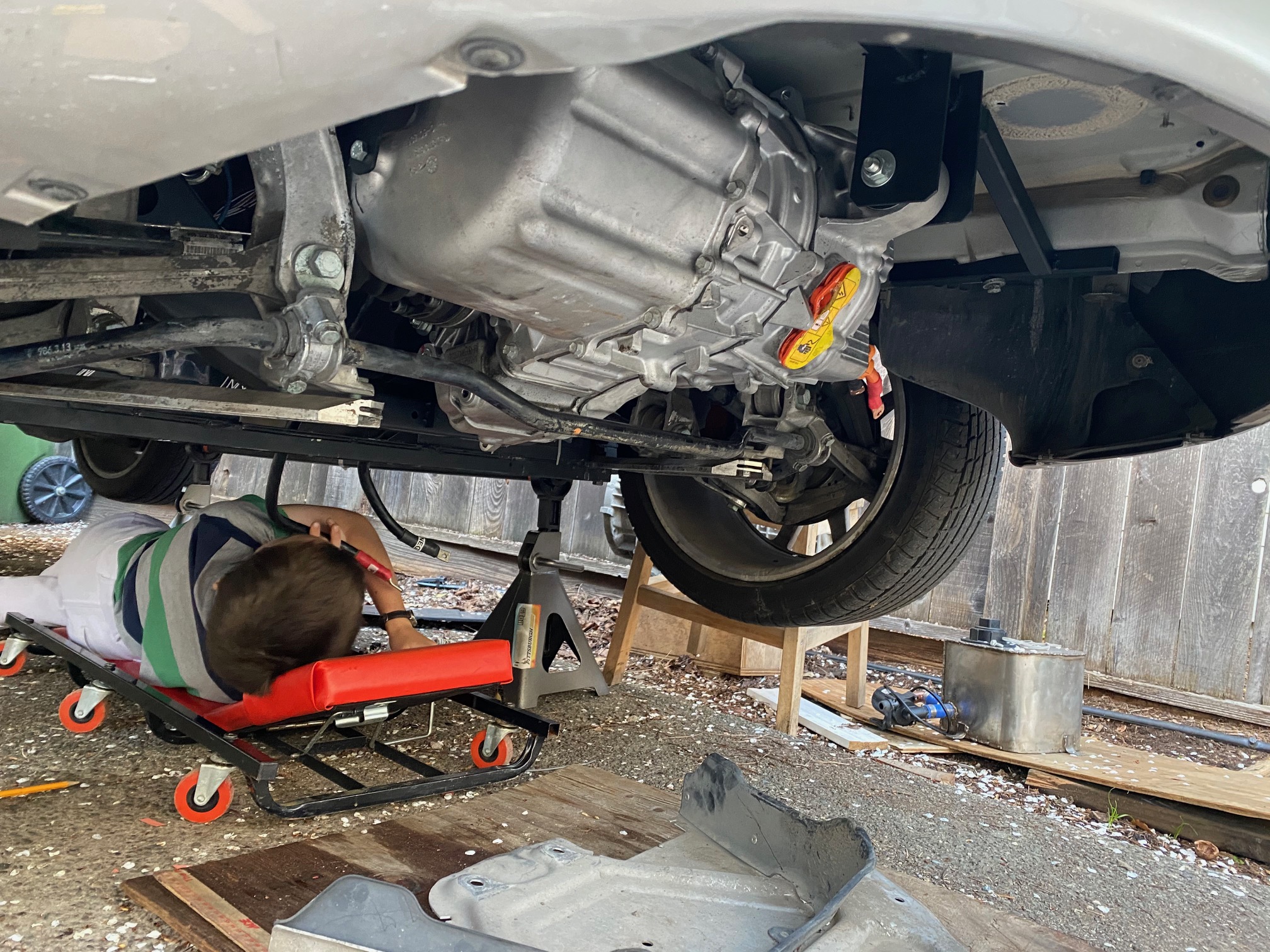

2 week update time. My dad and I spent the last week building mounts; front, rear, and side.
Here they are installed on the motor:

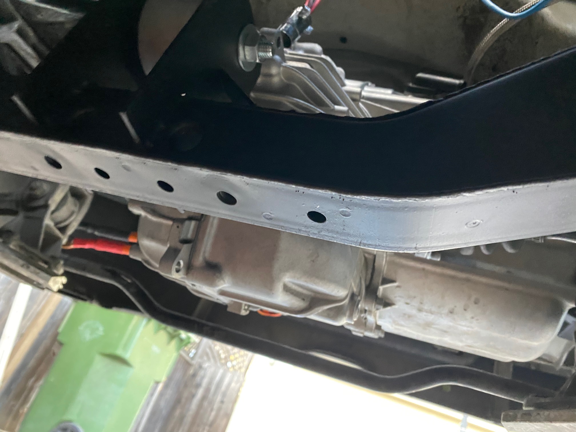

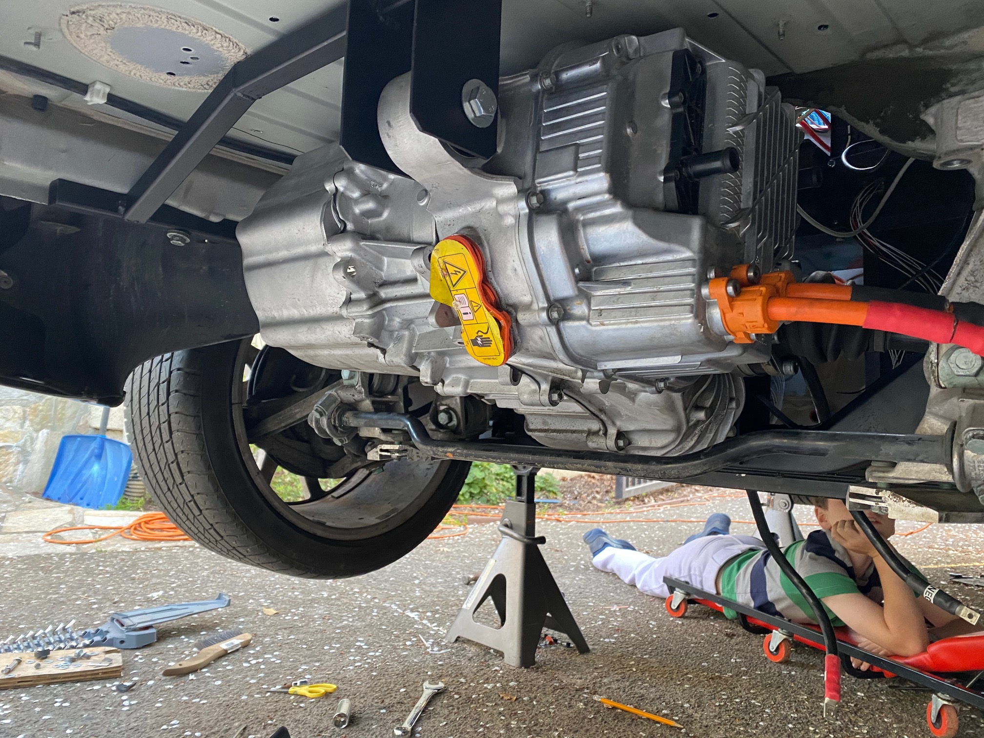

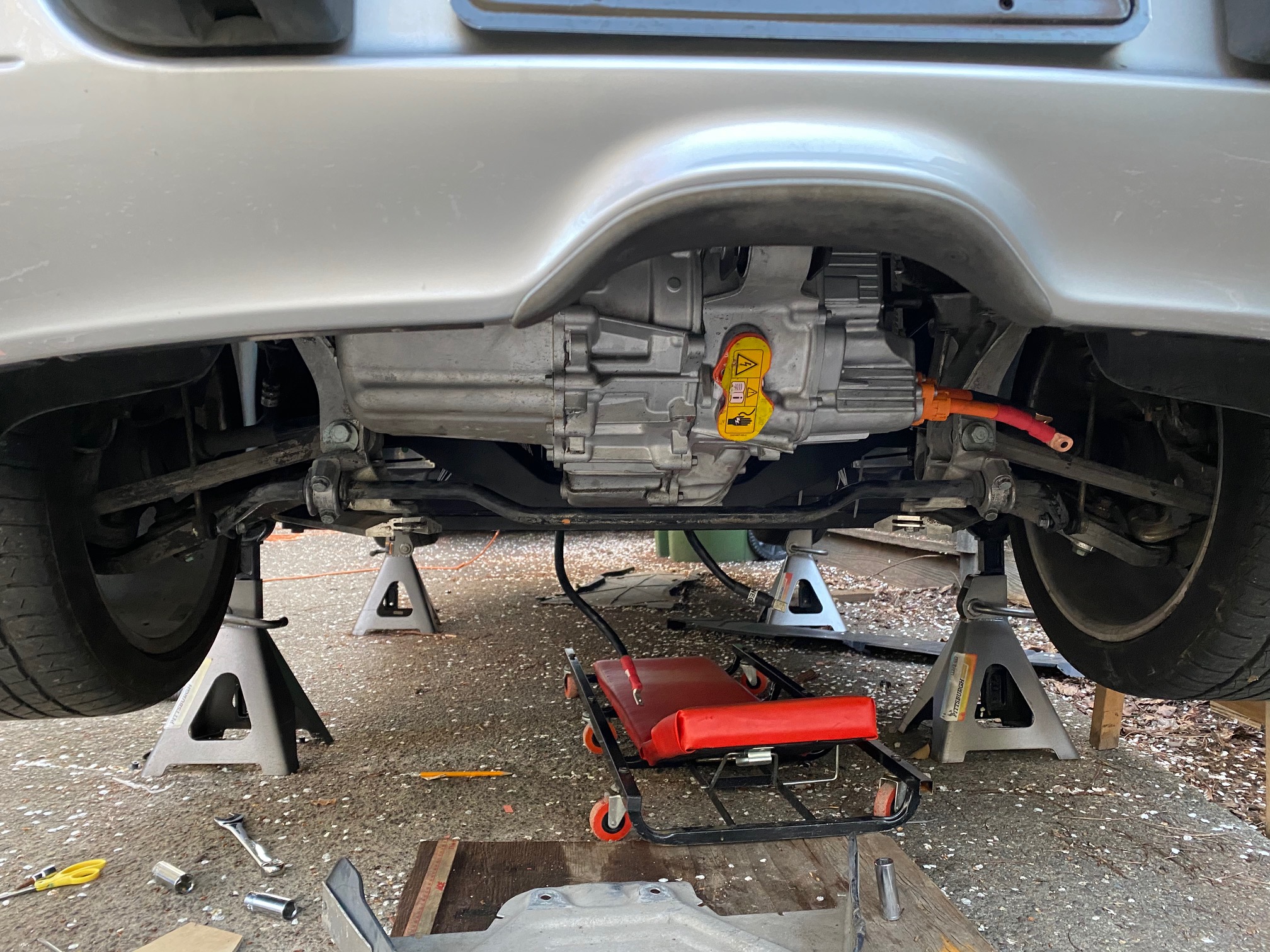

And then today we lifted it into the car. After an hour or so of shoving it around and forcing bolts, it's finally mounted in place permanently (I hope).
Axles are bolted up and fitting properly, HV wiring is complete, and the LV wiring is easily completed. But the batteries need some support, a chassis part needs to be replicated (interfered with motor), and coolant hoses connected. After that is done, we'll be on the road again.
Things are moving along though! It's getting exciting!
