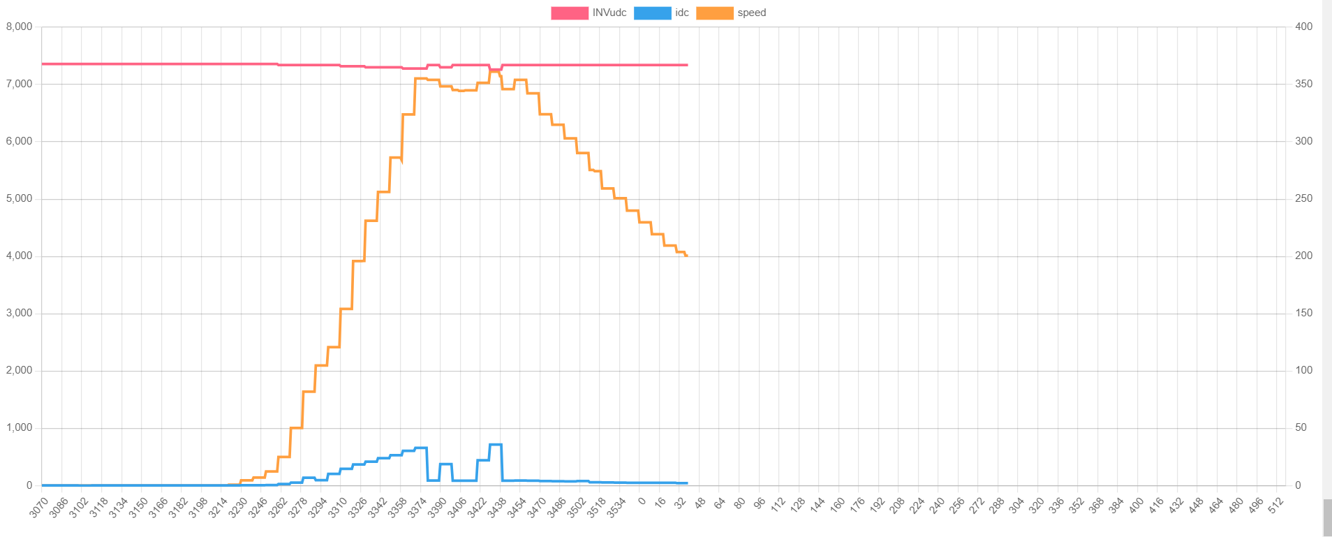

sadly my backs still giving me grief so not much progress built a new board to control the ancillaries and did a little testing
bear in mind this is with the wheels off the ground so no real load this equated to 50Mph

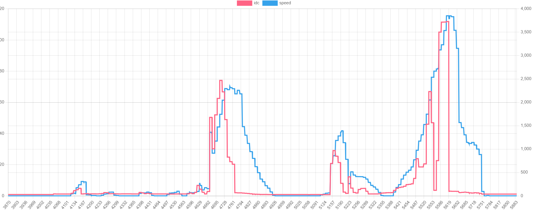

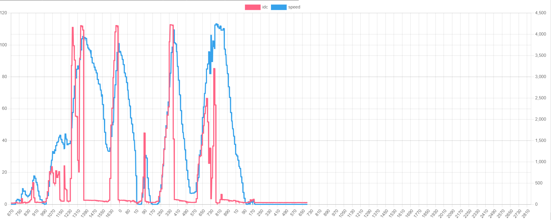

Took the car for a spin on the road today it was only a side road so nothing too enthusiastic I'm afraid
the first half of the first two logs is uphill the second is downhill

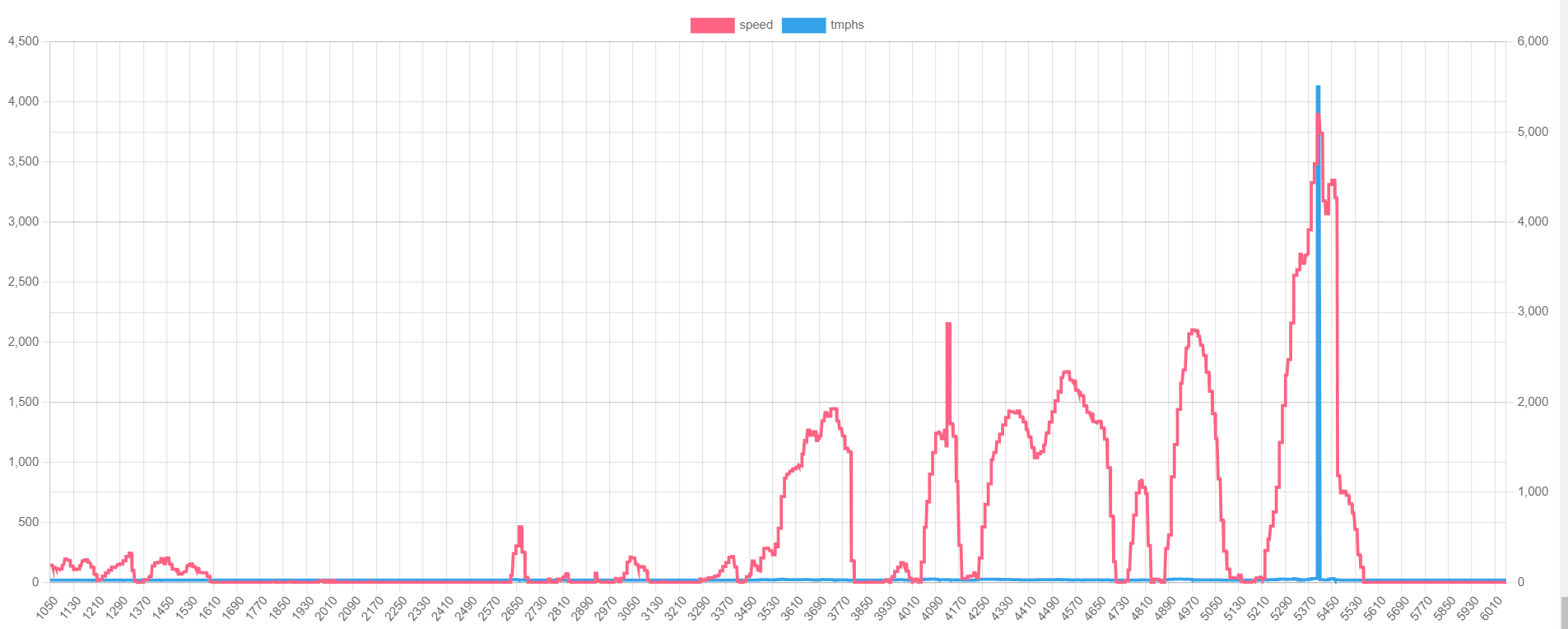

I'm having an issue with some totally unrealistic temperature spikes on the heatsink causing errors as can be seen in this last plot it goes from a stable 18-24 Deg to 5500 Deg which is obviously not a true reading :lol:
I also tested Jamies new code for the brake booster which is working perfectly
as for performance it feels far smoother and faster and quieter than it did with the leaf motor but my Gearbox the leaf was coupled to was shot

andybpowell wrote: Fri Feb 09, 2024 12:35 pm sadly my backs still giving me grief so not much progress built a new board to control the ancillaries and did a little testing
On this wheels of the ground 7000rpm ,
Just confirming
think that is mg2 speed ?
The idc is 700 A ?
Or have I got the scaling wrong

Okay, have seen other scale to the left, hidden when phone viewing..
PHEW
30A looks far more reasonable...
So please correct me if needed,
50mph without road load is around 12Kw (30 × 400v ) from the battery ?

Woodfie wrote: Mon Feb 12, 2024 7:22 pm Okay, have seen other scale to the left, hidden when phone viewing..
PHEW
batt voltage was 355v during tests

Does the heatsink temperature spike happen always at the same speed?
andybpowell
Posts: 334
Location: Southend,essex,uk
Has thanked: 219 times
Been thanked: 257 times
Re: [WIP] BMW Z3
Post by andybpowell »
celeron55 wrote: Mon Feb 12, 2024 8:52 pm Does the heatsink temperature spike happen always at the same speed?
this crossed my mind also, need to do some more testing to check

Post by aot93 »
I have the same temp over read on mine also whilst bench testing.
Temp shoots up once the motor is turning.
I came across some other instances as well notably:
viewtopic.php?p=50409#p50409
I've tried moving the bytes where this temp is taken from in the code but no success, so for now I have just commented it out.
