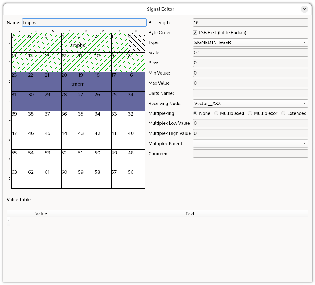

Sure.
Say you wanted to map the heatsink and motor temperatures from an openinverter board to an outgoing CAN message (for a custom instrument display to read for example). You might use a 16-bit length field for each temperature with a scale factor of 10 so you can get sub-degree precision. To put the two parameters in a single CAN message with hex ID 0x100 you would do:
$ oic can add tx 0x100 tmphs 0 16 10
Adding CAN tx mapping with can_id=0x100 param='tmphs' position=0 length=16 gain=10.0 offset=0
CAN mapping added successfully.
$ oic can add tx 0x100 tmpm 16 16 10
Adding CAN tx mapping with can_id=0x100 param='tmpm' position=16 length=16 gain=10.0 offset=0
This will then immediately start sending a CAN message with ID 0x100 (decimal 256) with the two temperatures occupying the first 32-bits of the message every 100ms (or 10ms depending on the canperiod setting). You can list what the device is doing with:
$ oic can list
0x100:
 tx.0.0 param='tmphs' pos=0 length=16 gain=10.0 offset=0
 tx.0.1 param='tmpm' pos=16 length=16 gain=10.0 offset=0
Don't forget to save the CAN mapping to Flash on the inverter:
$ oic cmd save
Command sent successfully

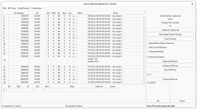

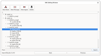

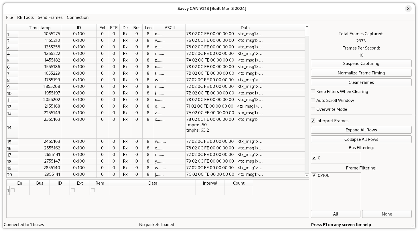

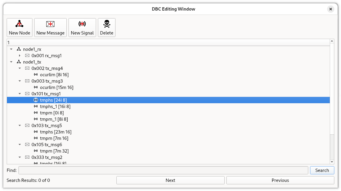

To look at the messages in SavvyCAN you need to export the CAN map:
$ oic can export --format dbc inverter-temperatures.dbc
Parameter CAN message map exported
If you load inverter-temperatures.dbc into SavvyCAN it will look like this in the Signal Editor:
Which would look something like this when running and interpreting the CAN messages:
Ignore the crazy temperatures, I just have a resistor rather than a temperature sensor.

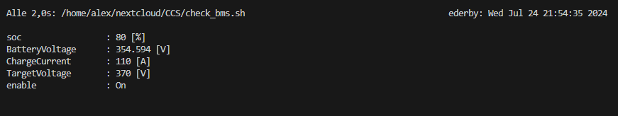

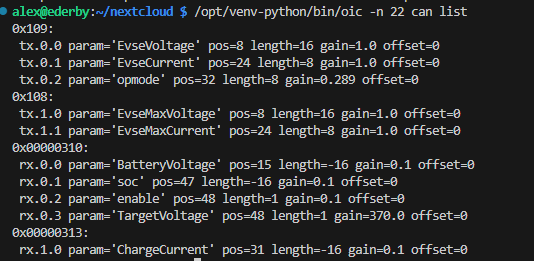

Hey Dave,
oic is a great command line tool to manage my new FOCCCI :) , but i have some issues with the creation of the can mapping for my boostech bms v3.
i used the following command for rx mapping
/opt/venv-python/bin/oic -n 22 can add rx 0xb12 ChargeCurrent 31 -16 0.100000001 0
and get this error output
can_id: 0xb12 out of range. Expected 0x000-0x7ff or 0-2047
It seems that OIC works with the CAN2.0a standard, but boostech has opted for the CAN2.0b standard :? .
The FOCCCI firmware has already been adapted by Johannes aka johu (version 0.40.5.B) and i flashed it onto the FOCCCI.
Here is a short pcan viewer dump to show the boostech can ids and some messages.

When you list the can maps the extended IDs are 8 hex digits in length rather than 3 for a standard ID irrespective of what the ID is. This follows other CAN command line tools like can-tools:
$ oic can list
0x100:
0x00000312:
 rx.1.0 param='ChargeCurrent' pos=31 length=-16 gain=0.1 offset=0
It's worth noting that the tool supports much more capability for creating CAN maps with extended CAN IDs than libopeninv currently supports. It will let you know, politely, that the functionality is not supported where appropriate. For now stick to CAN RX maps with IDs of 0x7fff or less.

hey guys, i wanted to give you a big shout out.
the new FOCCCI firmware and the new OIC version work perfectly together.
